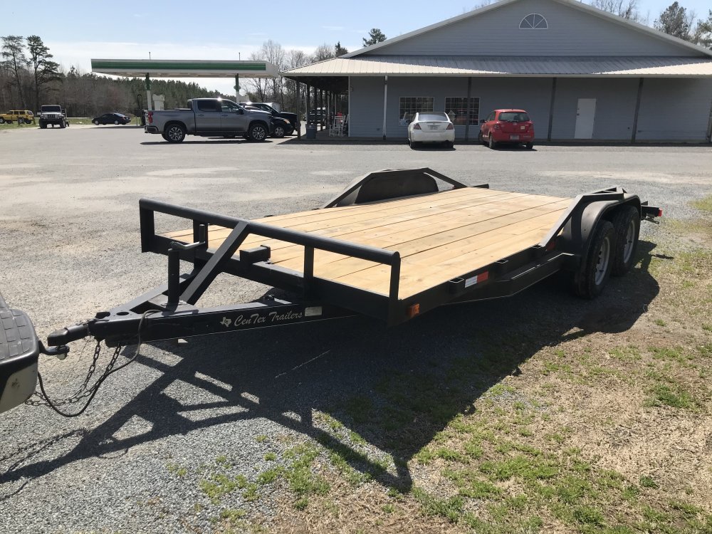

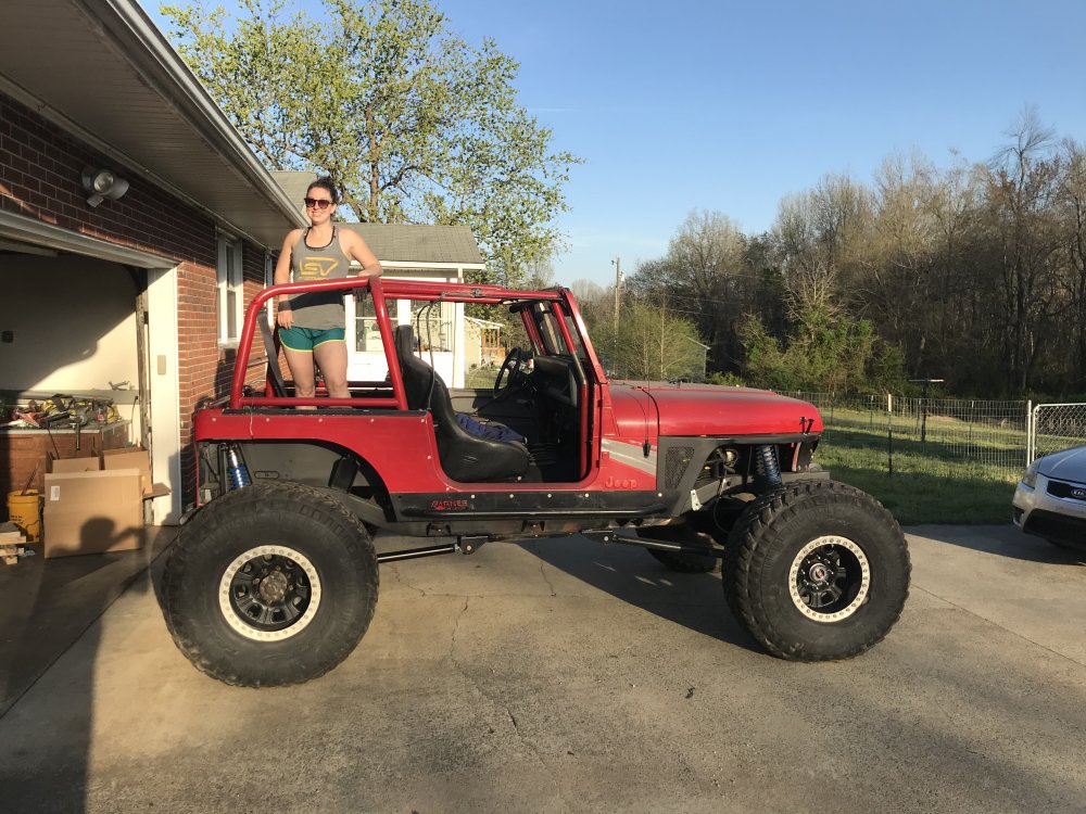

So today was a long, busy day. Picked up a trailer that was forsale on the forum since I’ve been hunting for one for some time now.

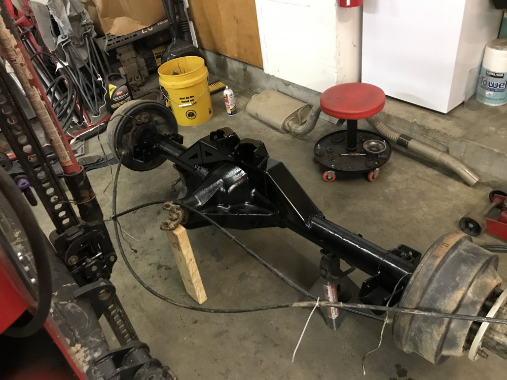

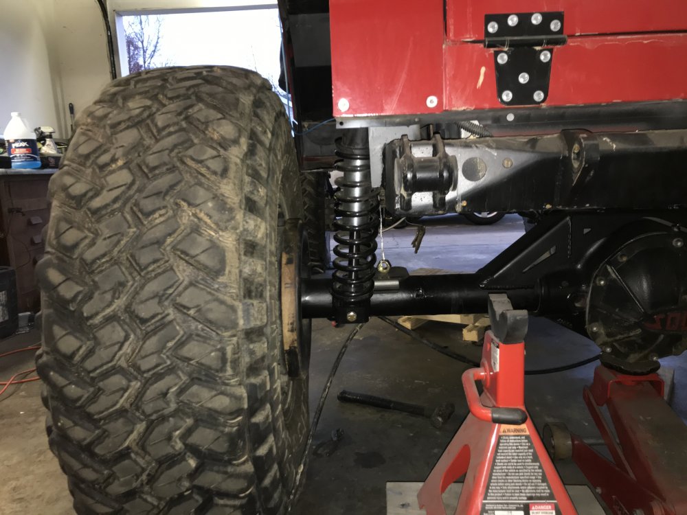

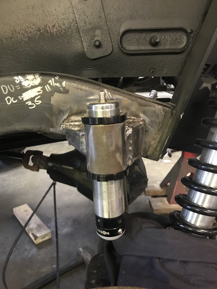

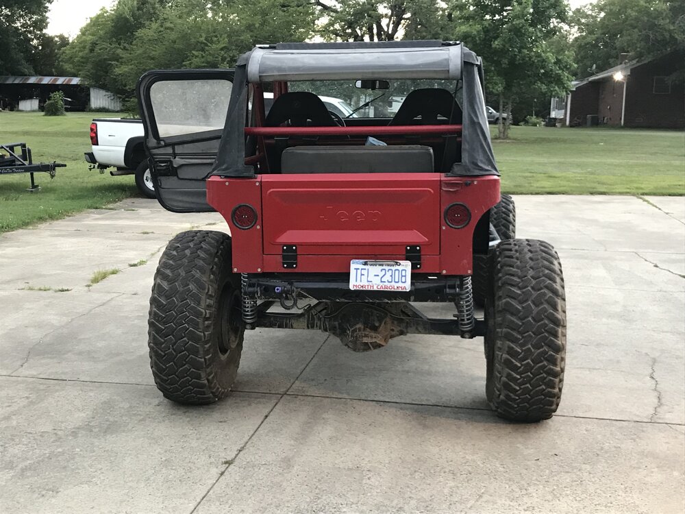

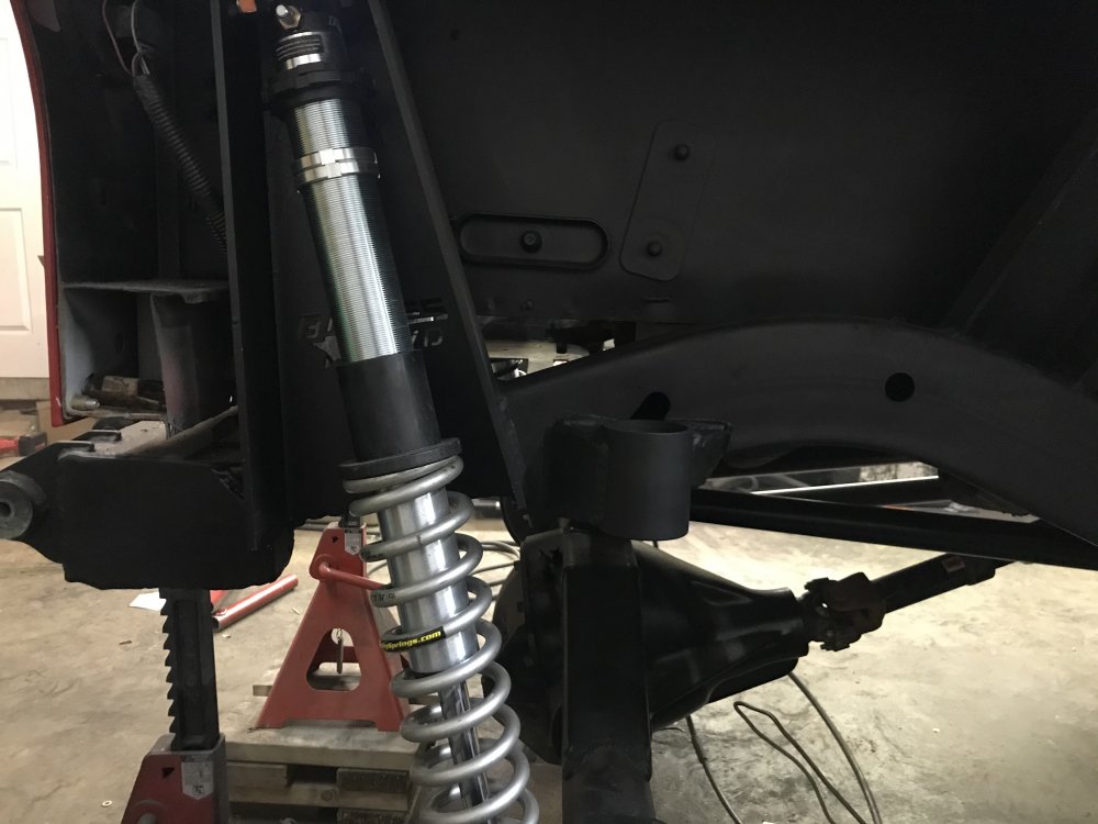

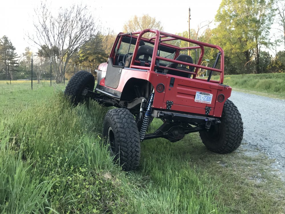

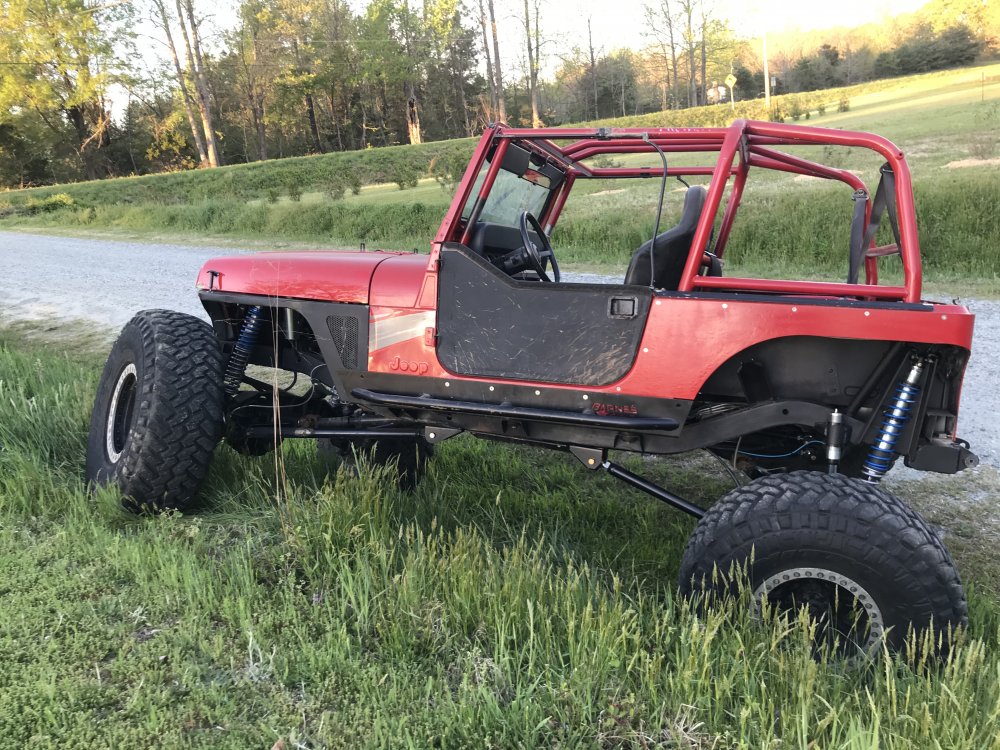

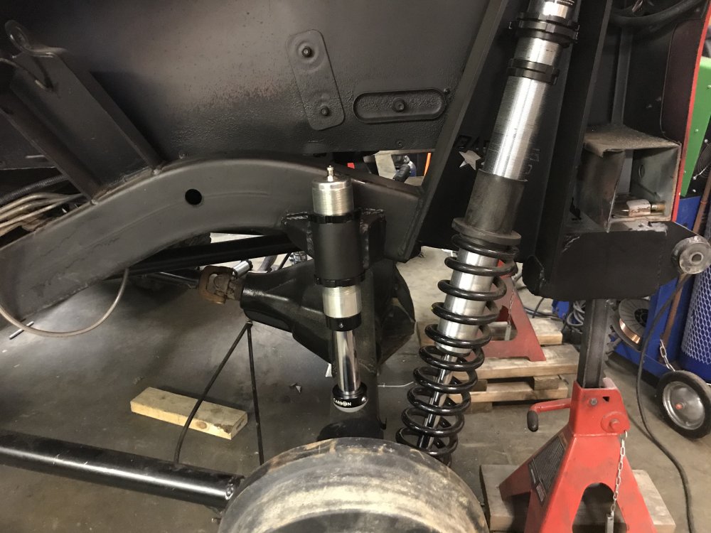

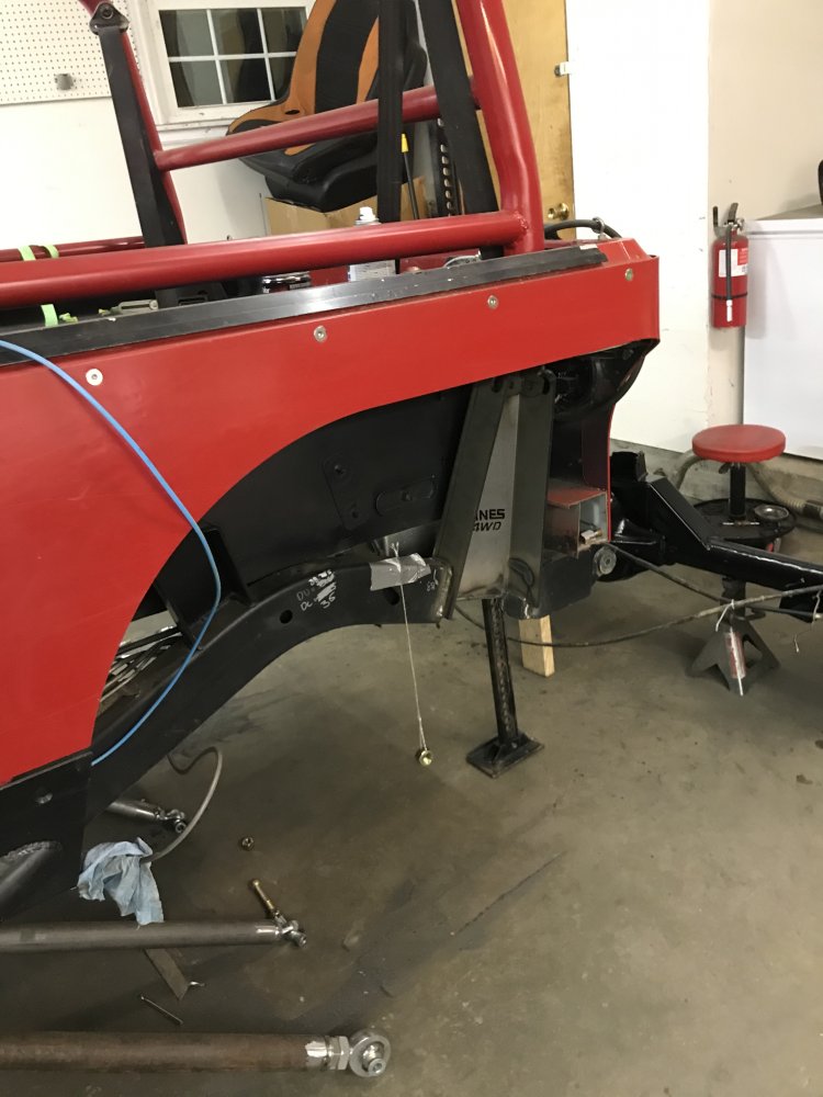

When I got home, work started on the Jeep. The rear shock towers are in, the axle is fully welded minus bump pads and limit strap mounts. The axle is painted and I’ll just spot clean the areas needed for the bumps and straps. Trimming under the tub is done and I’ll be able to keep the fuel cell as it is. I did find that the shock towers I ordered were too short. I had to make filler plates below them in the frame. This also means sacrificed up travel. Without cutting up into the wheel wells, I was only able to squeeze out 5” of uptravel. I’m not overly pleased about that but it’s far better than it was (since the leafs were so stiff) and also much better than the rear of my old XJ where it was only 2-3” at best.
hopefully tomorrow the frame side brackets and links will get fully welded and then it’ll be time to set it on it’s own weight and measure for spring rates. I’m concerned that with only 5” of uptravel, the combined rate is going to be very soft to keep the current ride height. It’s looking like I’ll need a sway bar to help with some of the anticipated body roll that will come with those soft rates.

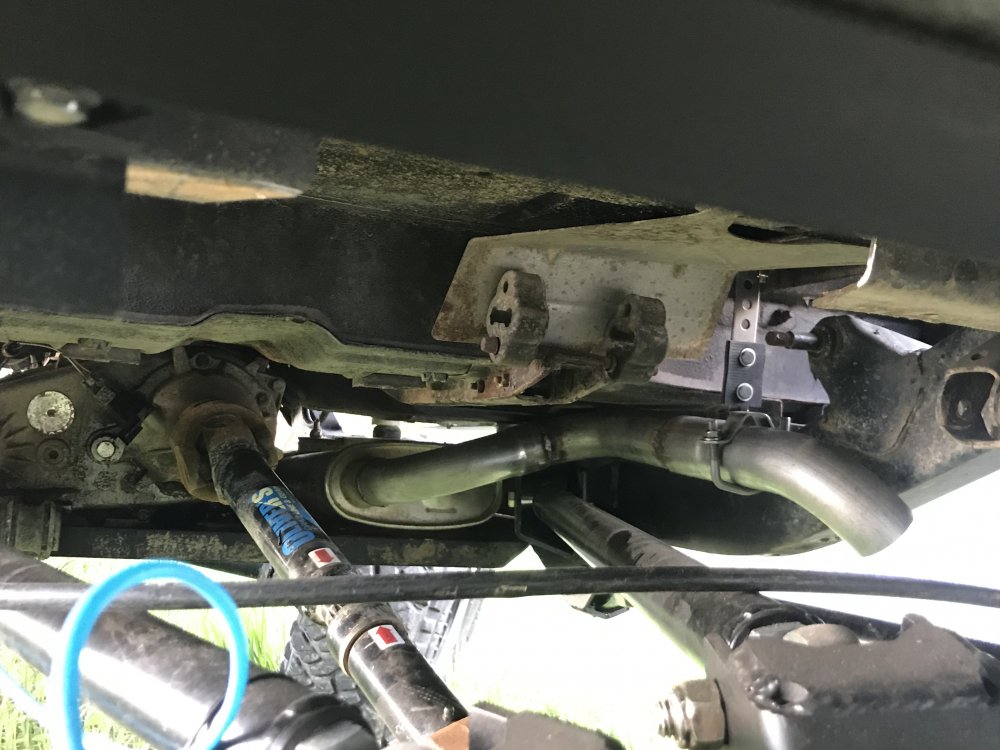

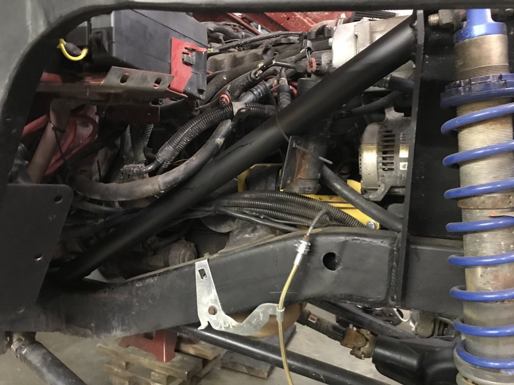

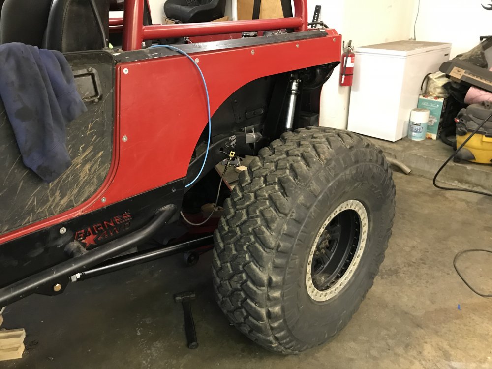

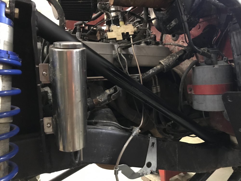

Well progress has been made but not at the pace I was intending. My wife and I have started the search to purchase our first home so a lot of time has been dedicated to that endeavor. But, the rear suspension is now done. The fuel cell and brake lines are on. Exhaust has been welded up, and the harnesses have been reinstalled. Next on the list is to brace the front frame. Harlan showed that I did not brace it well enough and it bent the front (from the motor mounts forward) upward. I’ll be pulling that back down and then running tube from the shock towers to the frame just in front of the first tub mounts. The sides of the frame will also be plated and the two items together should produce a more rigid front end.
Tonight I got the front reinforced from the coilover tower to the frame just in front of the first tub mount. Also took it for its first real test drive. All I can say is wow. Never again will I have leafs. I should have done this from the beginning. Also, I’ve determined I want a rear sway bar. The body roll now is much greater with the rear suspension allowing the Jeep to move freely

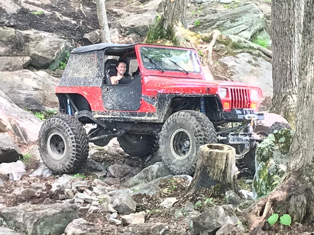

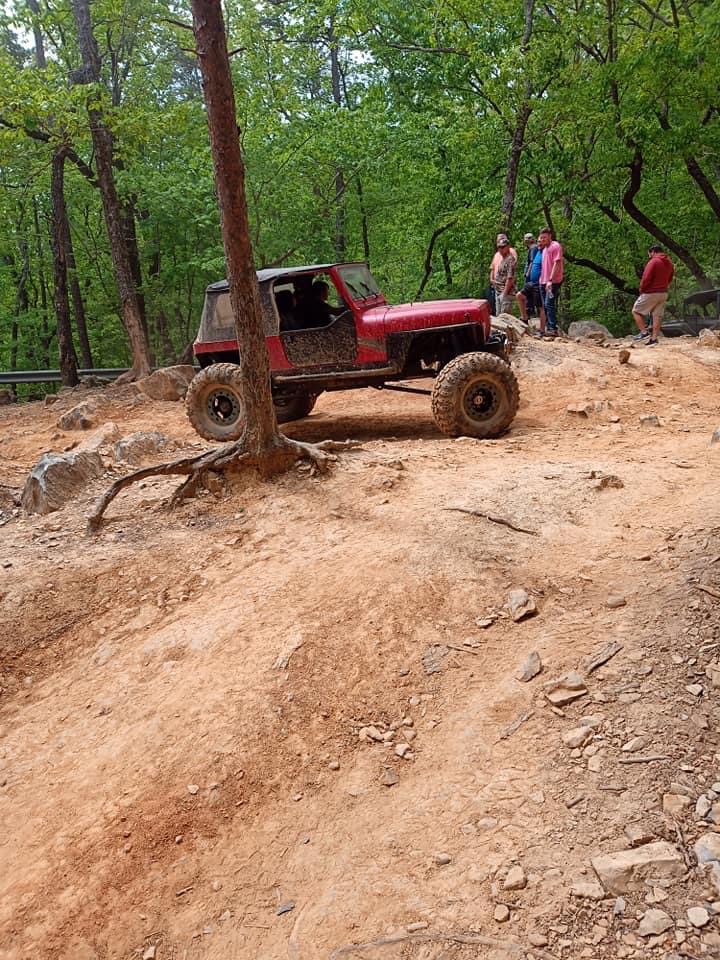

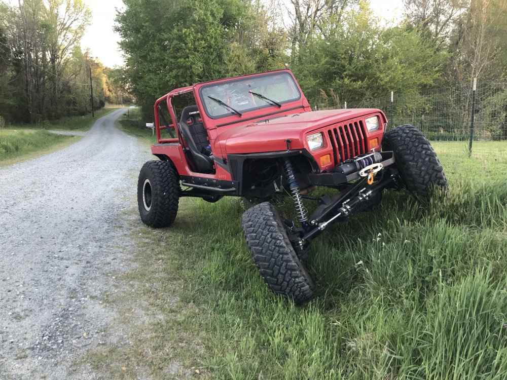

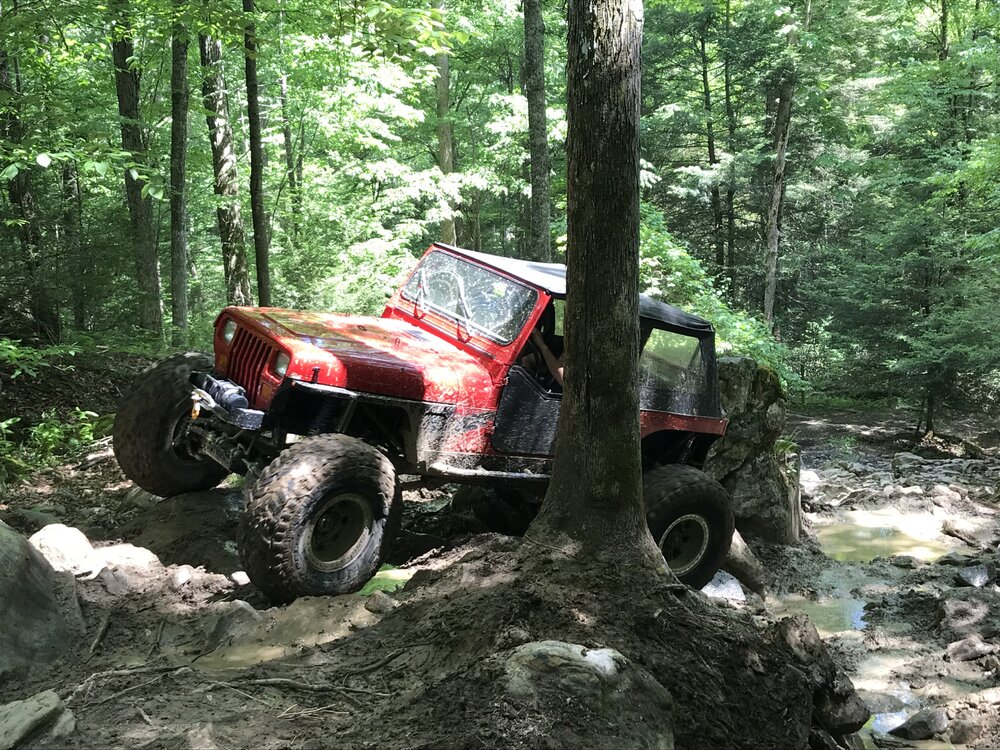

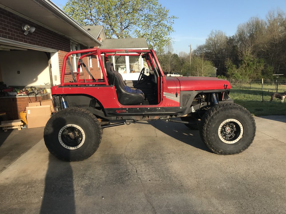

Got out to Uwharrie this past weekend for a shake down run. Learned a ton about this rig and made some changes to the spring preloads which drastically increased it's ride quality. Also learned to make sure the shocks are charged when extended as I only charged them when they were at ride height. Once getting everything dialed in to the best of my ability/knowledge (not saying much there) it was amazing how well this thing rode. Made a couple speed runs from one end of Daniel to the other and it was like riding on a cloud the entire time. I can only imagine what a completely tuned and dialed in suspension would feel like as we only scratched the surface. No pictures were actually taken by our group since we were just enjoying ourselves cruising around but someone did snag this pic as we rolled past.

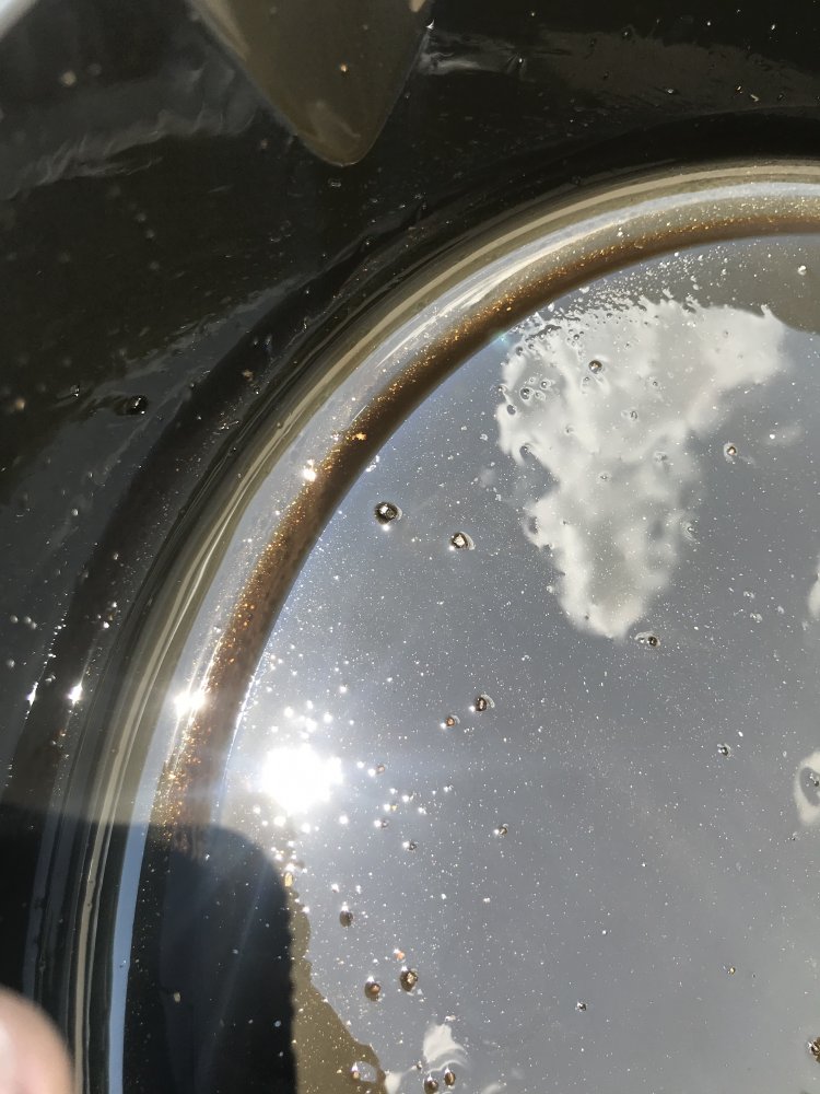

So I replaced the injectors and blew out the return line last week. Out of curiosity, I pulled the dip stick and noticed it was VERY full and the oil smelled of gas. Definitely had a stuck injector after finding that. I then changed the oil and drained 8 quarts out of the motor :eek:. I have a habit of always checking my drain pan after an oil change and this was not a pretty sight. There's no bottom end noise and oil pressure when rolling down the road is good. Hot idle is a little low, around 20-25psi, but I'll just send it and keep an eye on pressure and noise, as well as inspect again at the next oil change (if it gets that far since this oil only had 200 miles on it). It seems my future plans of LS swapping this thing may come sooner than planned.

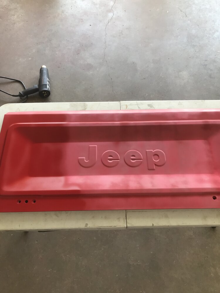

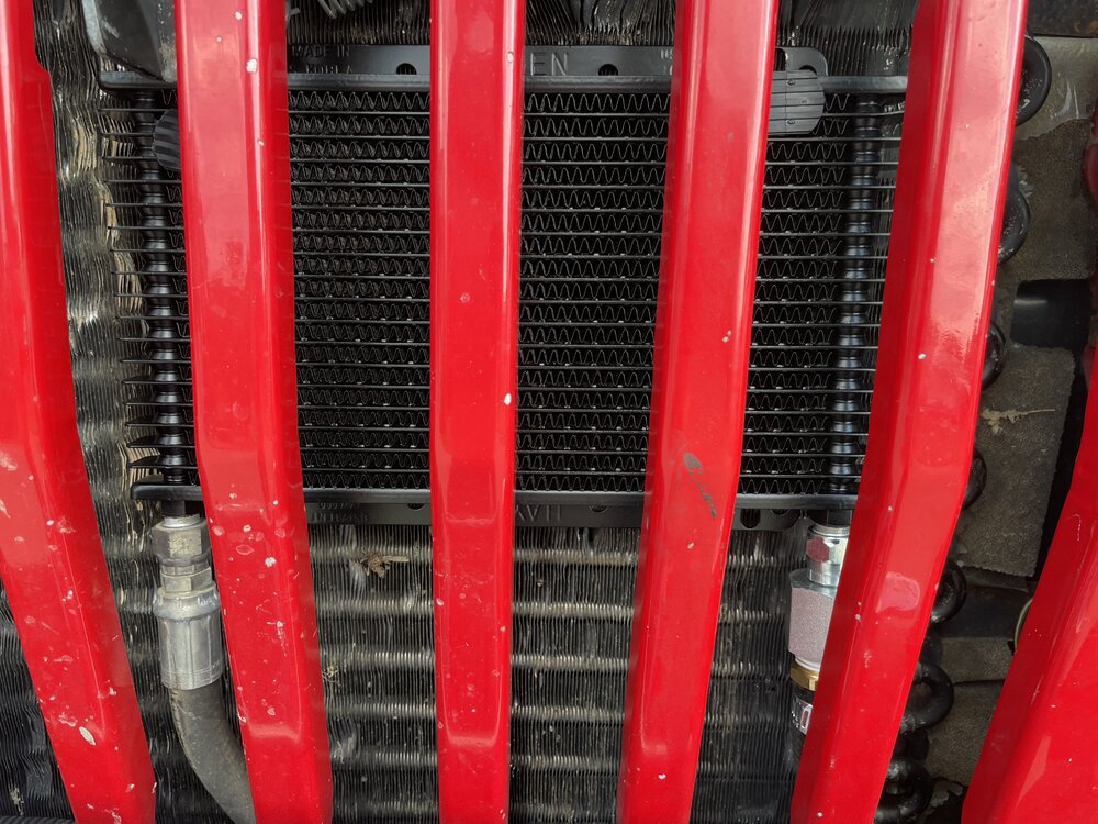

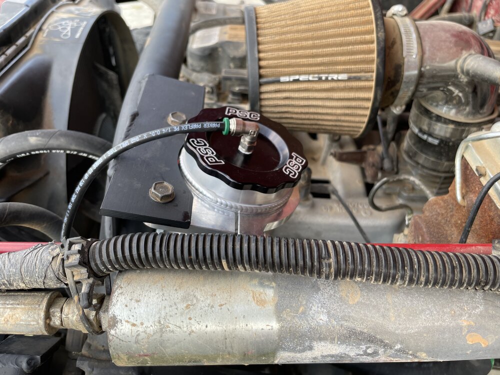

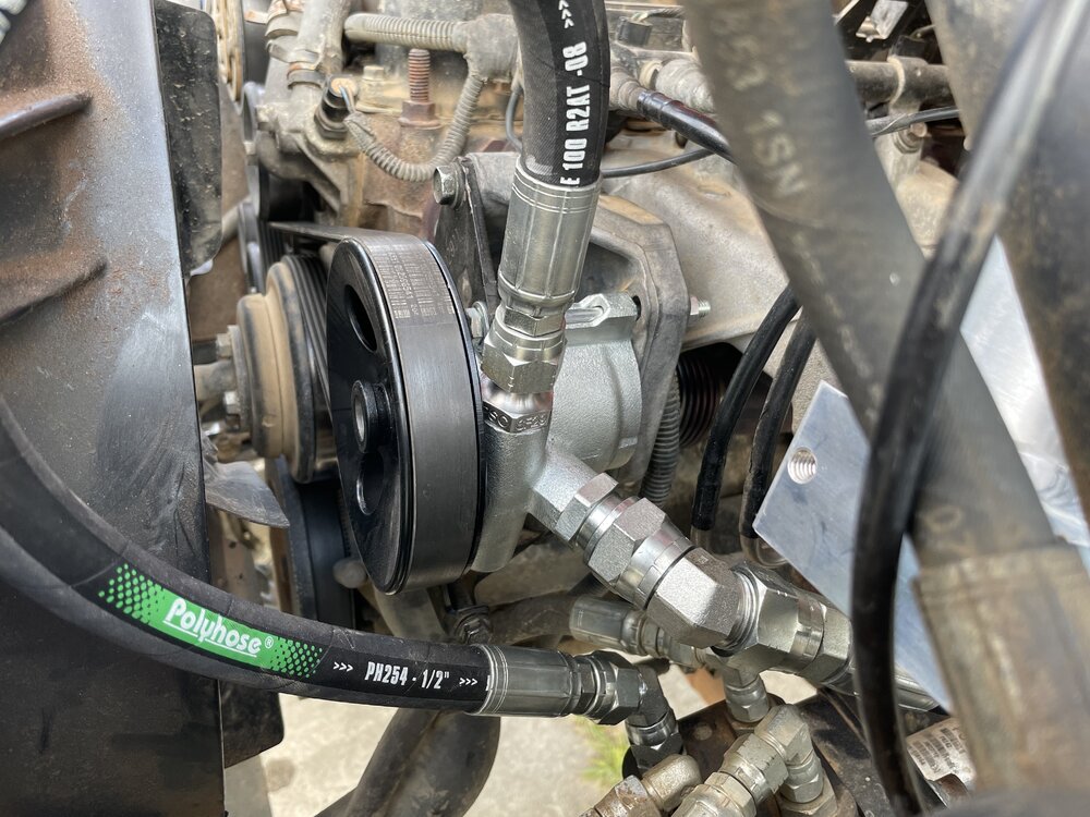

Went to Uwharrie Father's Day weekend and took my parents to ride with me. Was an easy day of cruising the trails. I did notice that the power steering pump as whining all day and it was almost impossible to turn on pavement with the hubs locked. I believe the factory pump is now dead (not surprising because it has never been replaced). So, I ordered a PSC pump and reservoir that should be delivered today (thanks @tobaccoroad4wd) and I plan to install this weekend. I also bought a CJ tailgate and Swag tailgate kit from Justin and got that installed last night. I did learn that painting in the humidity makes for an awful haze in the paint but a heat gun can remove it.

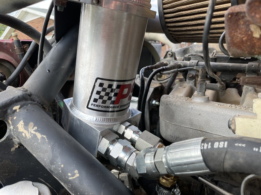

Got the new PSC pump and reservoir installed this weekend. Of course, anything that could go wrong did. First I found out I ordered the wrong pulley and had to get a replacement from the parts store just to get it back together. Then I found out I ordered the wrong steering wheel disconnect and had to order another. Finally, the PS cooler I had decided it didn’t want to come free of the return line and it broke at one of the weld seams so I had to get a replacement. After all the set backs I got it all together today and bled the system. Steering is nice and smooth but still difficult with the hubs locked, stickies, and on pavement. But, the pump doesn’t whine so at least there’s that. The new steering wheel disconnect should be here this week.

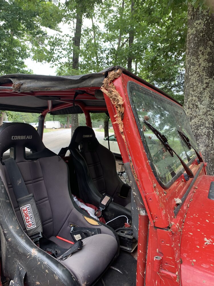

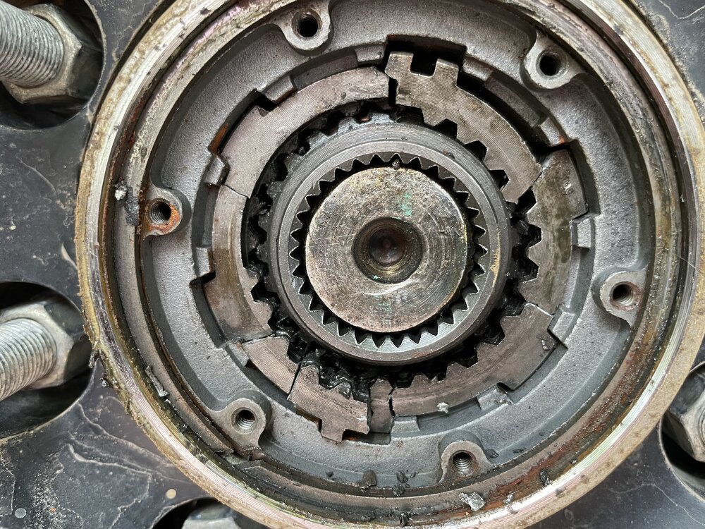

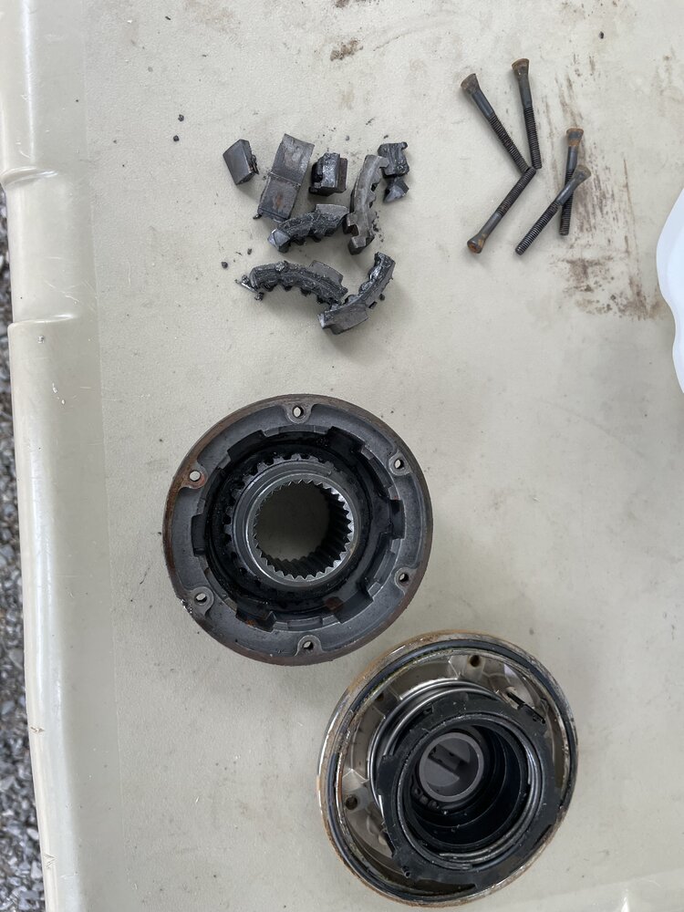

Headed to Kairos this past weekend. Didn't wheel much because the driver side hub decided it didn't want to stay in one piece and I left my spare at home. While winching out the windshield met a tree. Since the trails were ended early for me, it just meant more time spent at the river. It was a blast of a trip and I can't wait to go back (even if it's just to hang by the river). The new steering did work very well so that's also a positive. I've already called G2 and they have a new set of hubs shipping out tomorrow and should be here Friday. I will say their customer service was great.

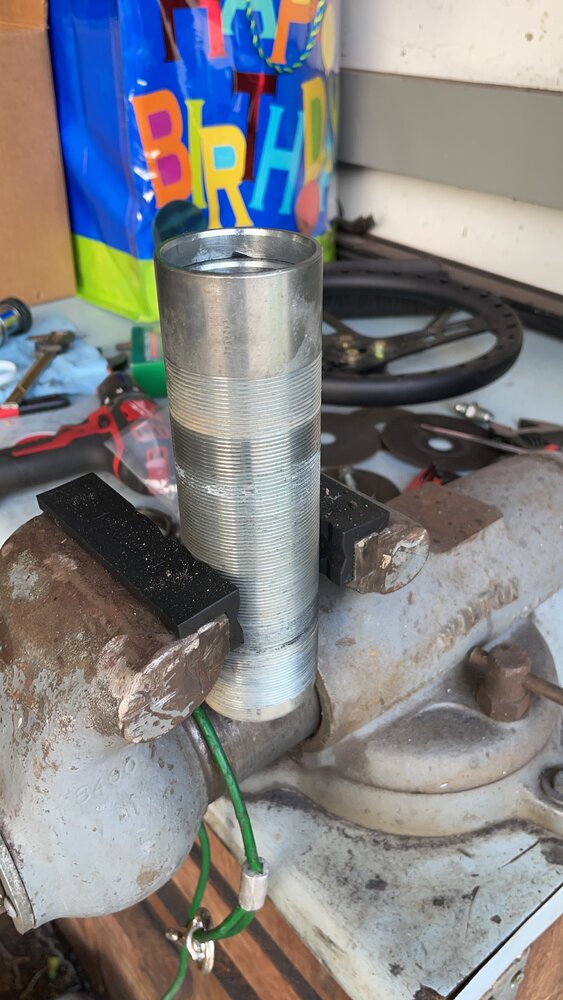

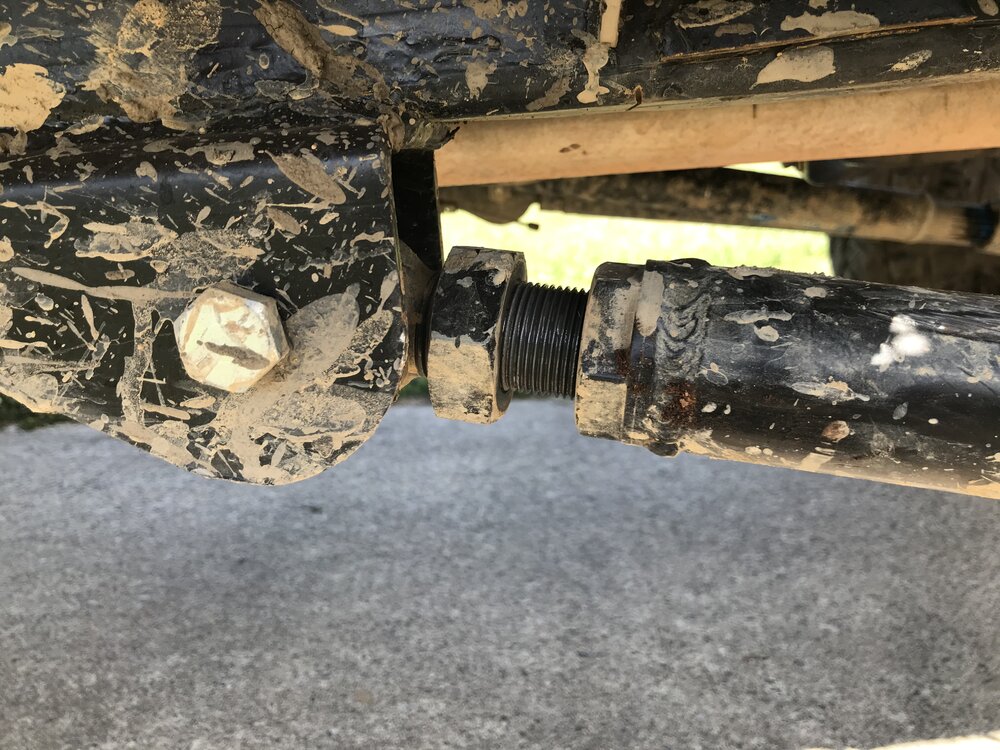

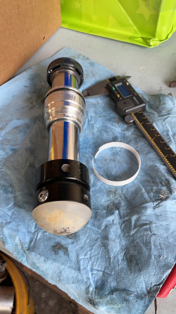

Replacement hubs came in and got them installed about a week or so ago. Since then, the Jeep has sat untouched until today. Had some free time when I got home from work so I pulled the rear bumps and finally pulled them apart. Tomorrow at work I’ll make spacers to limit them. Spoke with the mfg a few months back and they just use 1.75 DOM so that’s what I’ll use. These will be limited from 4” to 2” bumps.
