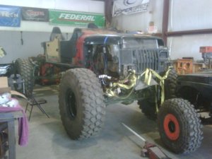

Got dash fabbed up (still have to mold it in later), had to mount cluster in the middle no room above steering wheel:
Interior fuse box mounted & ECM:
Got gauges looking better:
Got seats mounted (front passenger on back order):
Got front Rock & XZL's in place merely for movement to get it to Chris:
more updated to follow...
Got it moving (has temporary blocks for lift) to load up & take to Chris (MarsFab):
(Can't rotate pics now uploading with phone)

holy :poop: its a beast! cant wait to see this thing finished.:beer:
Should be pretty flexible to when I get it back from Chris (& about 8-10"s higher than pics).
I say this thing yesterday at Chris' place, It is ungodly huge. It looks like an unusually long wheel base. Going to be interesting making the tight turn on Daniel.
It should be around 167-170" wheelbase. Moving rear axle up & cutting about 3-4' off the rear Super Duty frame. It'll be a tight squeeze about ever where.
This is not much but for a size comparison the samurai in front of it could drive it's hood under the frame.

Yeah, it's gonna be a big MoFo. I was shooting for something different but still capable of trail/mud use & be street worthy. I've always liked my Jeep (just wished it had more room & rear seats) & always wanted a diesel, so I decided to make one.
