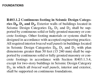

Working on converting a screened in deck into an extra room at our house. Per the zoning guy... since I have a giant live oak next to my house, I cant build on a continuous footer (for the trees sake of course). He says get your engineer to put it on piers, so that's what I did. Dropped by the permit guys desk with my engineered drawings, and he points to the code and says I cant do it on piers.
I see where the code says a continuous footer, but it also says other footing materials designed in accordance with accepted engineering practice. I assumed since an engineer is willing to stamp my drawings that this is in accordance with accepted engineering practice.
Is the permit guy on a power trip or is this reasonable?
