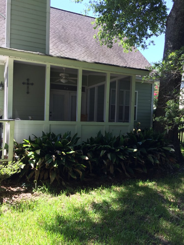

Here's what he's working with:
Existing deck with concrete pier footings already in place and the offending tree.
Dig them 3' deeper, use the appropriate tie down strap the engineer stated and roll on. It's literally going to be the same structure that's already there! Just elevated to match floor height in the house but with windows in it. And they wonder why people don't pull permits........
