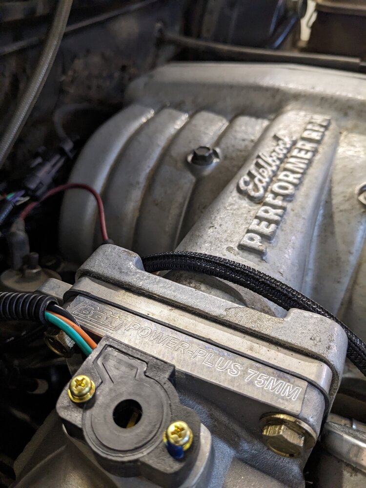

Engine side of the Terminator X is done. Got the new throttle body in, TPS adapted over, throttle cable bracket modded, unused wires sorted and laid aside.

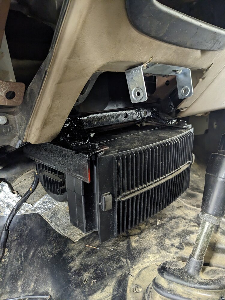

For 5 years, the Mohave heater has been "held" in with 2 Timberlok screws, 2 zip ties and prayer. I made some brackets from angle and tied them into the dash. 4- 5/16 bolts attach it to the bottom of the dash now.

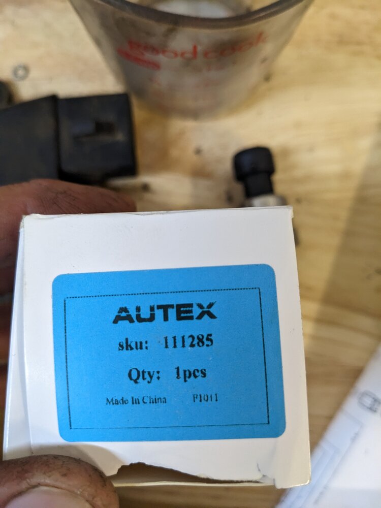

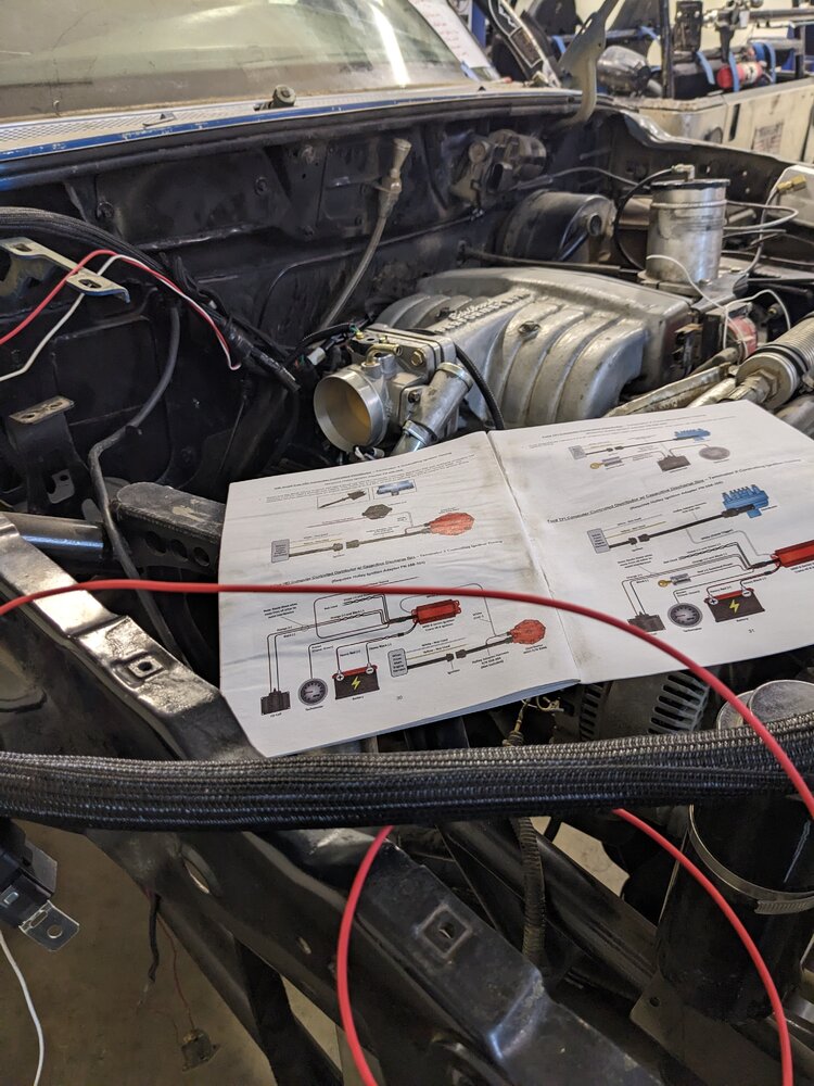

Got the rest of the engine side of the Terminator install wrapped up. In my effort to go gaugeless, I needed a pressure transducer (sensor) for the oil pressure. The Holley one is like $140 retail, so I kept a young Oriental lad in a job and grabbed one from Amazon for $38. It actually has great reviews on some Mustang forums I follow. Works for fuel, oil or whatever fluid pressure reading you need.
Part number below.

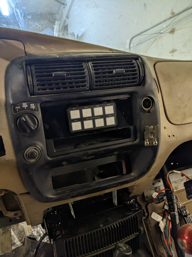

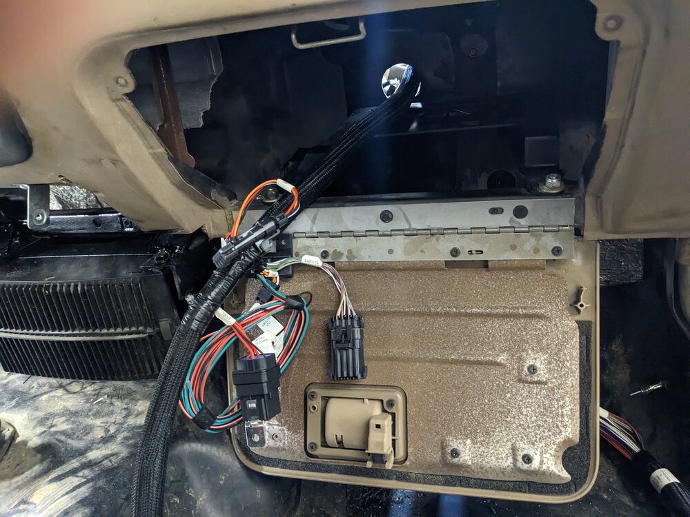

Ran the harness into the cab where it'll connect to the PCM. Mine is a Fox body kit, so it mimics it's routing. I'll have the relays, fuses, etc inside the glove box near the PCM. Got the SwitchPros mounted where the radio used to be. I used my superior fab skills and cut a piece of 2.375" x 7.25" flat stock and painted it black. It's the small touches that separate me from other hacks.
Also ran the heater hoses through the firewall to the Mohave heater. Gotta have warm feet on the trail

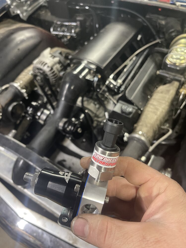

Are you wiring the sensor to one of the spare inputs or was there a provision for it?
There was a provision for the oil pressure sensor. There's also one for fuel pressure but since I have a gauge on the fuel rail already I won't be using it.
Just looked at mine, the ls had stock oil pressure sensor but I just noticed the fuel connector, I’m gonna put one of these inline for that. Wasn’t going to with the cost of Holley sensors but this opens that up.

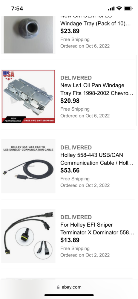

If you wanna run a screen dash the following adapters allow you to use any windows based tablet and still leaves the 3.5 touch screen functional with the splitter. Windows surface tablets refurbed on ebay are about $100 instead of the $700 Holley dash

I got my sensors fuel pressure/trans temp from lowdollar Motorsports
That’s who I was referred to as well, probably all the same. Them, Holley or Chinese lol 😂

Thanks bud.
I'm just gonna take an occasional peek at the handheld like I do the YJ with FAST injection. Good to know I have options if I go full baller eventually.

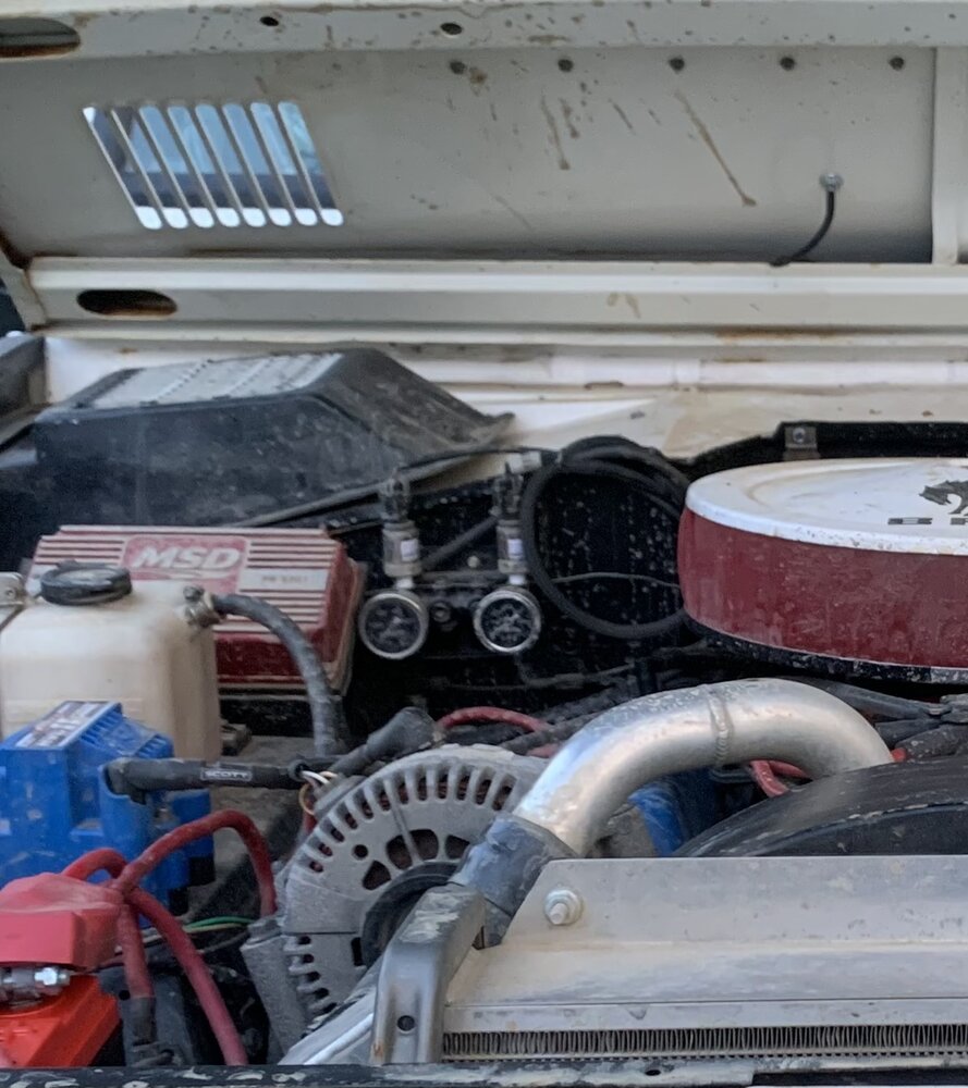

One the tricks the drag guys will do is mount the transducers off the engine to help reduce the vibrations and increase the life of the sensor. It also makes for a convenient place to add a mechanical gauge as a back up.
