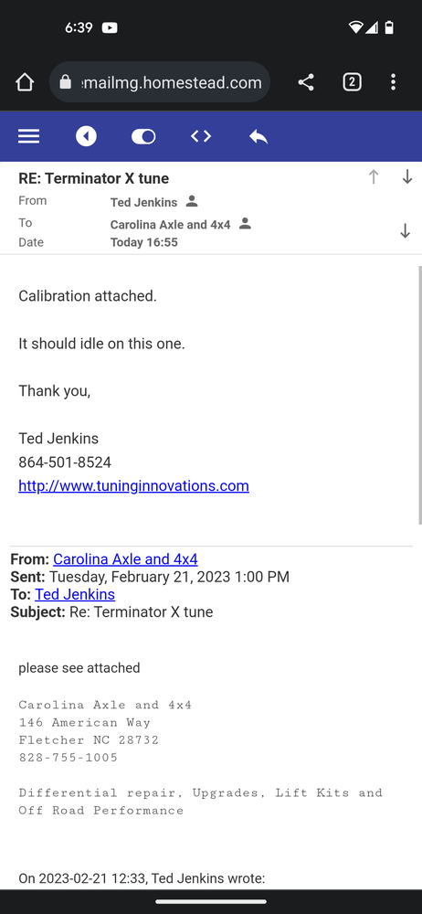

Tuner #2 just called me. Yesterday, I emailed the tune Holley provides. The end user (me) enters info like engine displacement, cam duration, desired idle, etc and it spits out an intial tune that *should* be good enough to start, run, make minor adjustments to, and then be done.
It was totally corrupt. Like corrupt to the point he said it would have likely done major damage under load the first time. Said it's not uncommon at all. He said the timing tables were absolute garbage and that explained why it was acting like it was.
So, he's writing a new tune and emailing it over later today. He'll be up here next Saturday to do the final tuning.

I got the tune uploaded. Dudes gonna call me in the am and walk me through some adjustments I need to make.It’s tomorrow. We need updates!
