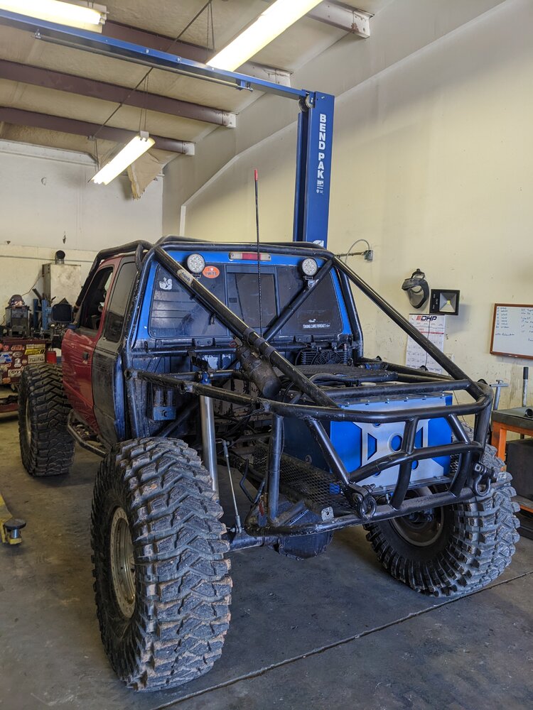

Once he's done (and I finish a TJ on the lift) Ranger goes on the lift to pressurize the air shocks, finish paint and load up for shakedown run

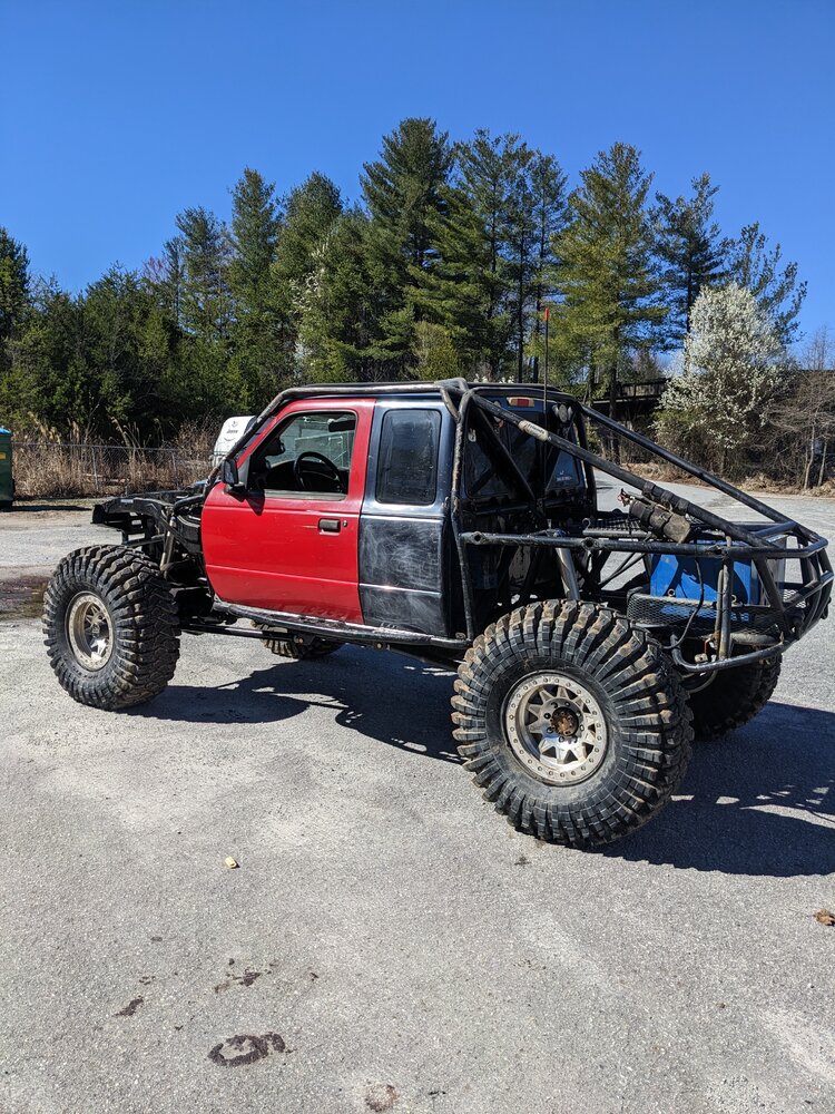

I drove it (like a bat outta Hell) all around my business park today acting like a total Hoonigan.

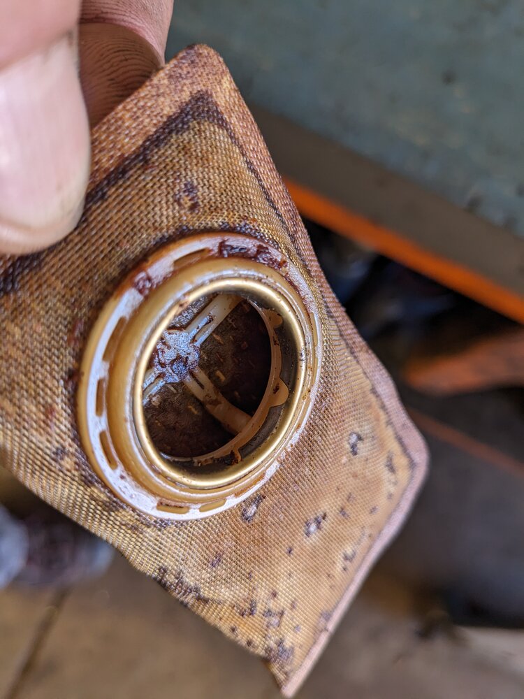

While he was initially starting to tune, we noticed the fuel trims acting all wonky all of a sudden. At the same time, the fuel pump started to sound like a Whipplecharger at 8000 RPM. Pump pressure dropped to 3 psi under load. I pulled the pump and found the pickup sock totally clogged with junk (technical term for shit in the tank). Replaced the pump and sock and all was good in the world again.

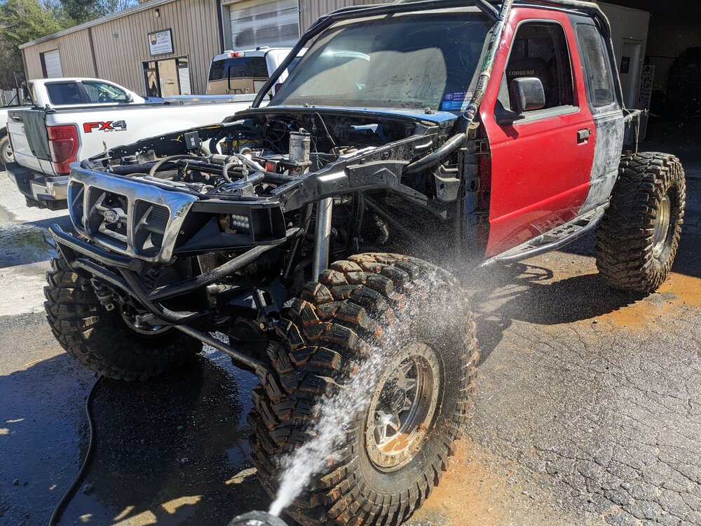

Paid the man (plus a generous tip for driving 1.5 hours each way on his day off) and washed off nearly 2.5 years of stank, grinder dust and neglect.
Got some axle work lined up this week, but plan to button up mechanicals between them. Throw some paint on the cab and take it out for a shakedown in a couple weeks.
