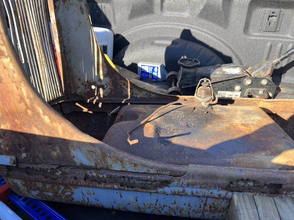

The sheet metal. A little rusty.
So smells like varnish in the tank. Good sign it holds gas. Needs a rim for sure. Starter appears to be locked up. Needs a carb and a radiator. Of course all new ignition parts. Going to be an adventure.
I seent it with my own eyes this afternoon, and it would look pretty darn decent with the sheet metal on and a new right rear wheel and tire. Calcium whatchamacallit must have eaten that wheel up, because the rest of it just looks normal outside tractor rusty.

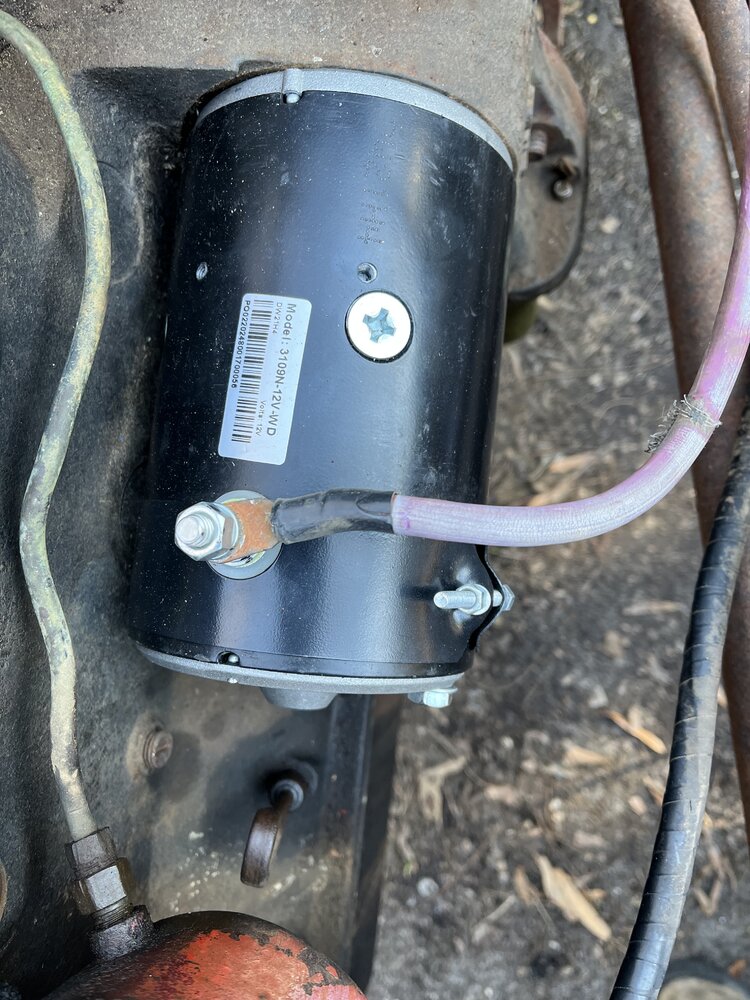

Starter, carb, and tune up parts are here. Installed the starter and put some Mystery oil in the cylinders to turn it over. Nothing but thumping from solenoid. I replaced it

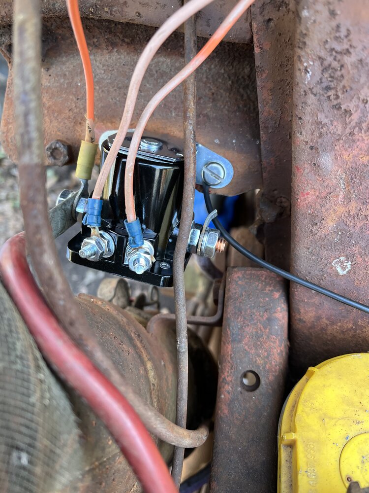

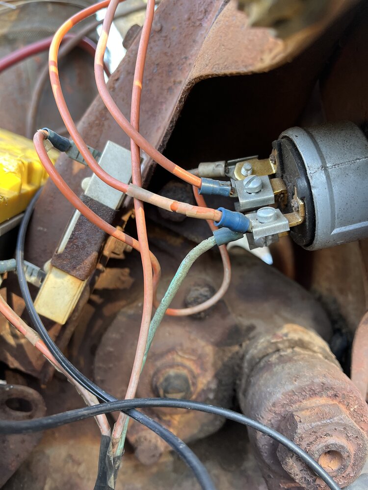

So we have a new starter new solenoid and I ran a ground wire to battery for the solenoid. The solenoid that was on it wasn’t what I was expecting. It also has a keyed starter switch instead of the button. I think the keyed switch is wired wrong to starter and the resistor that is on this one.
New starter installed.

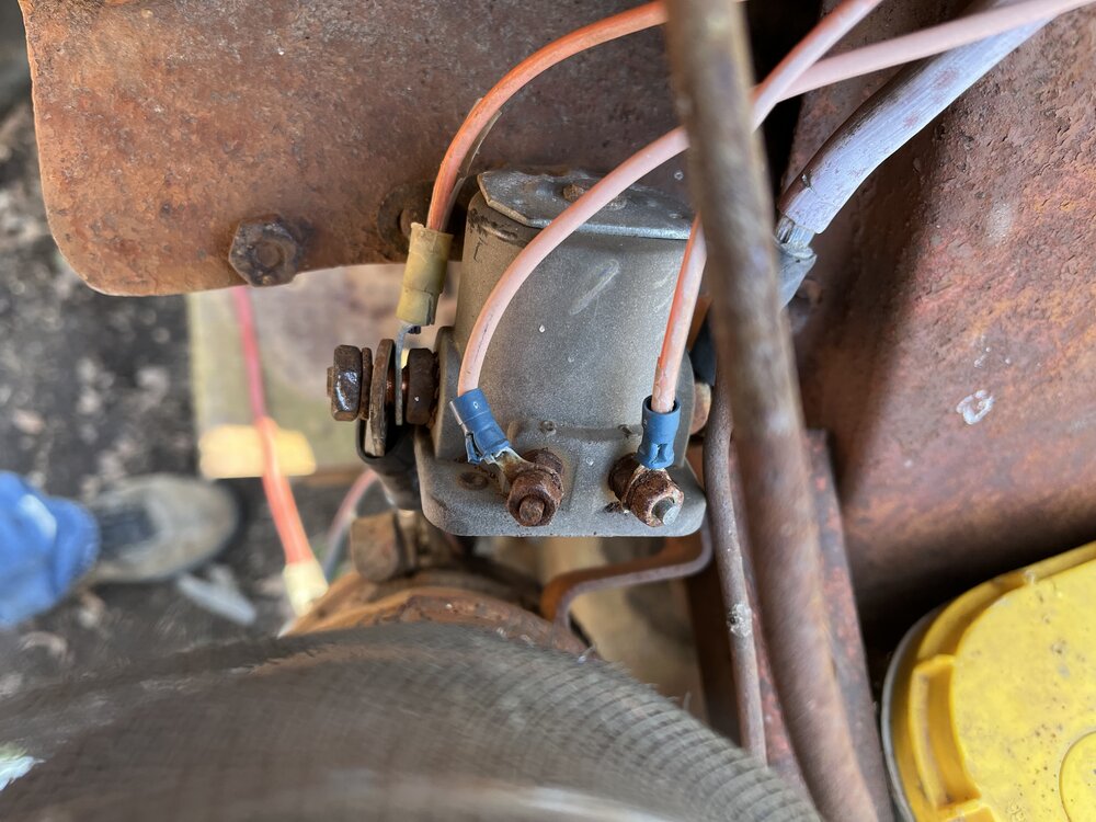

Old solenoid was clicking only some times so I figured I'd replace it.
New solenoid wired like the old one.
Keyed switch. Has a start function and button start is not wired in. I'll trace the wires and figure out where they are all going.
Also the switch has 5 poles but only 3 are used.

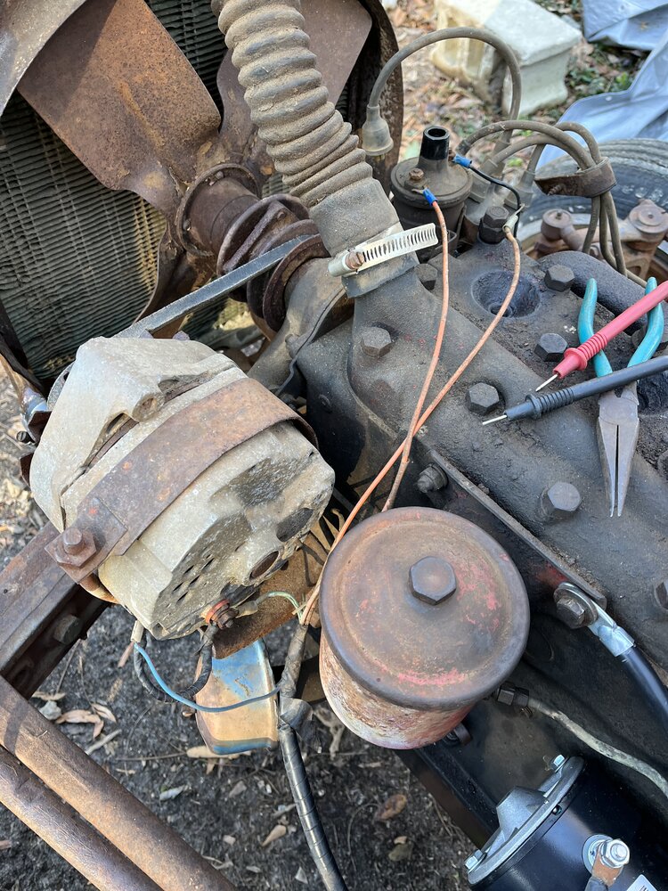

There are two wires to coil one is tied into the hot side of starter solenoid. Other goes to the second post on the solenoid. Labeled I on some images I’ve googled. I’ll steal one and post it.
I would just attach a jumper cable to the the battery and hit the starter terminal with it to see if it is going to turn over. Unless you are specifically trying to turn it over with the key.
Yes my neighbor came down in his WIlly's and we were looking at it and testing things. Ends up the 12.xx volts on the battery were not enough to turn it over. Jumped it with the my jeep and she spins good! We tested compression with a finger and found two lacking. Added some oil and one came back. Stuck valve. After some more looking we think the one cylinder with no compression is a stuck open exhaust valve. For giggles we hooked up two of the wires to plugs and they sparked.... I'm feeling good now about this thing. When I get back at it I'll open the valve adjust part up and see if I can get that one free. Then on to carb and fuel and tune up parts.
