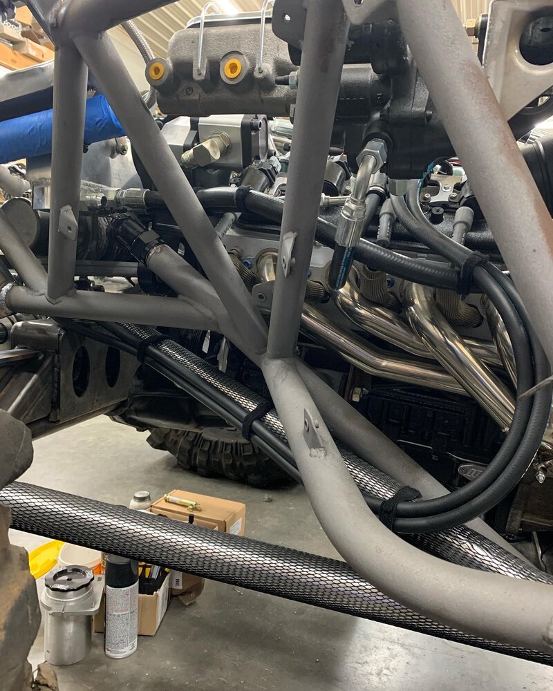

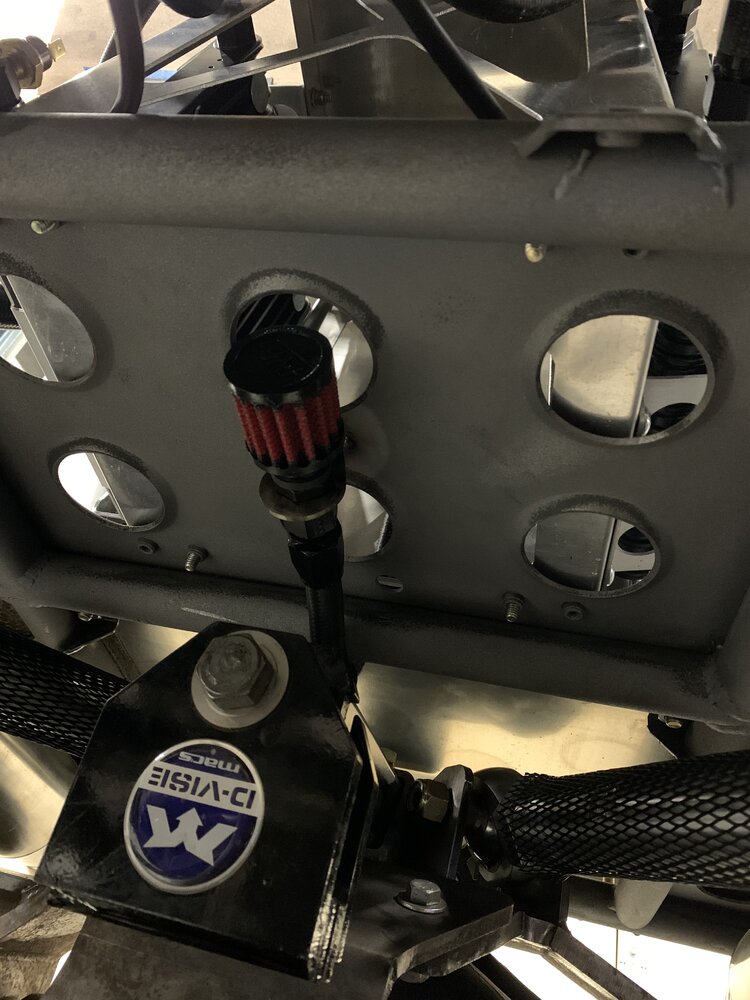

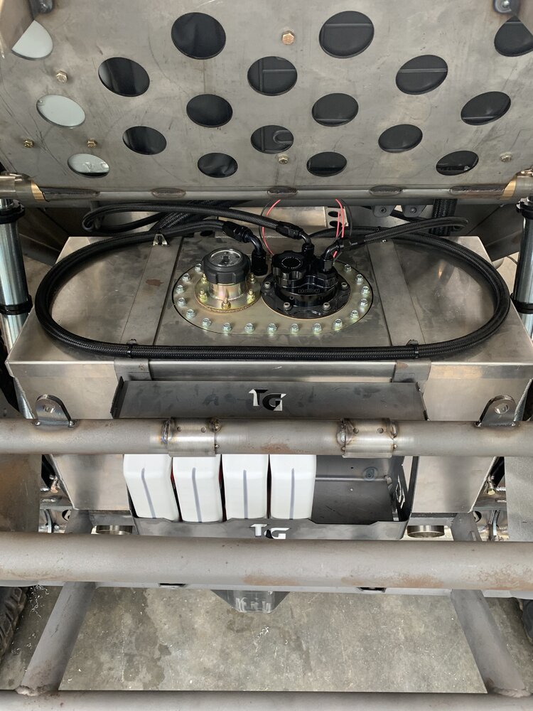

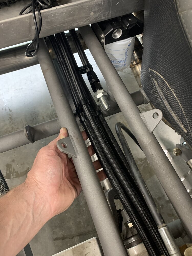

Closer every trip to Mayberry. On this episode @mcutler shop we knocked out another chunk of soft line. Fuel lines are complete with a FATS vent. Transmission, transfer case, and PCV lines are routed.

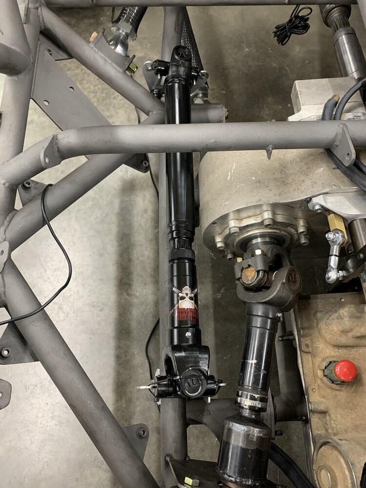

Spare front driveshaft is mounted low in the belly, hopefully, where I’ll never need it.

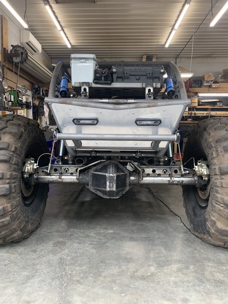

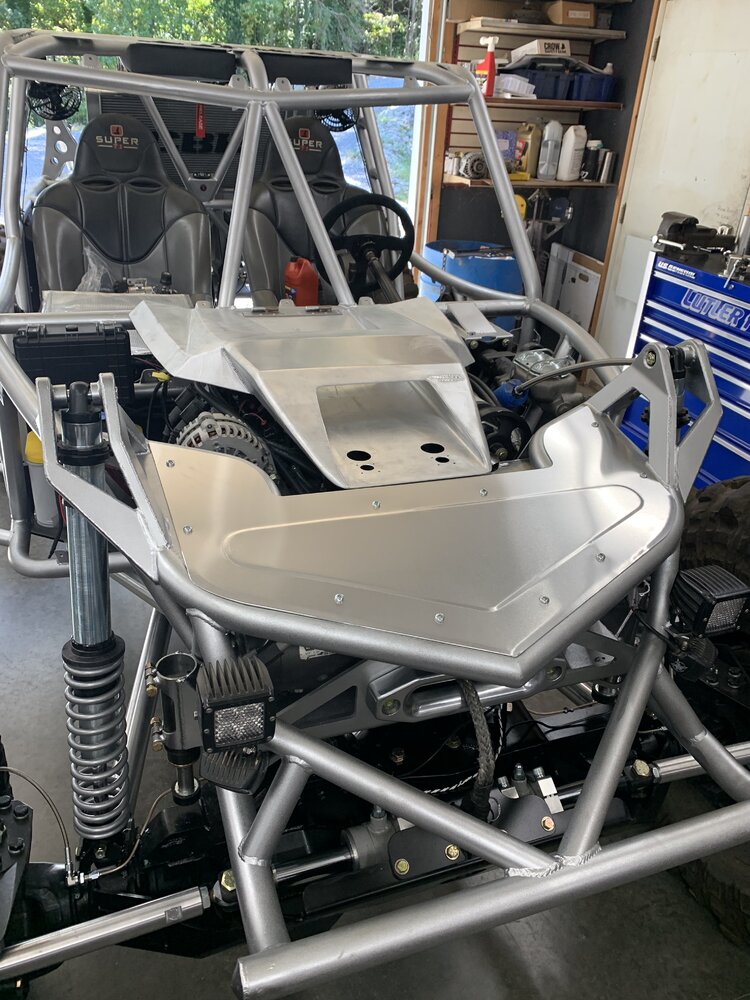

New tail panel is made with the Rigid Industries chase lights installed.

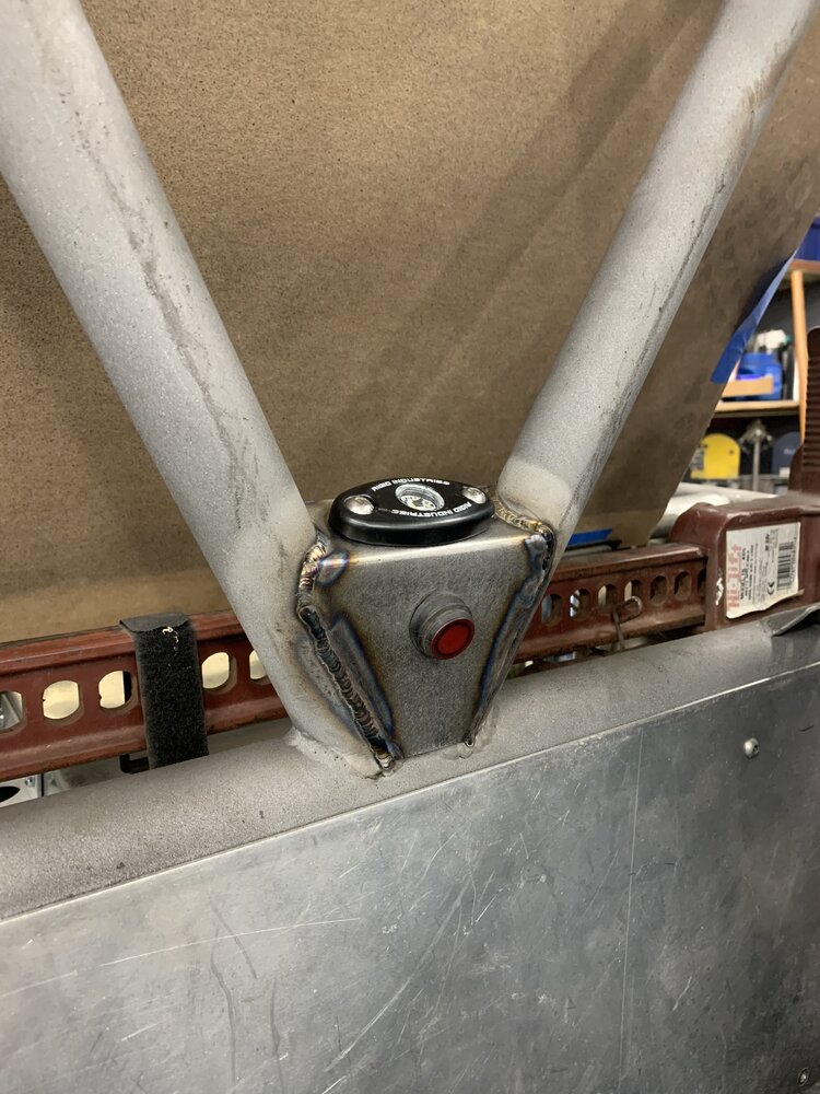

Dome light with switch installed for a promise made to my LilSis for a fancy roof panel.

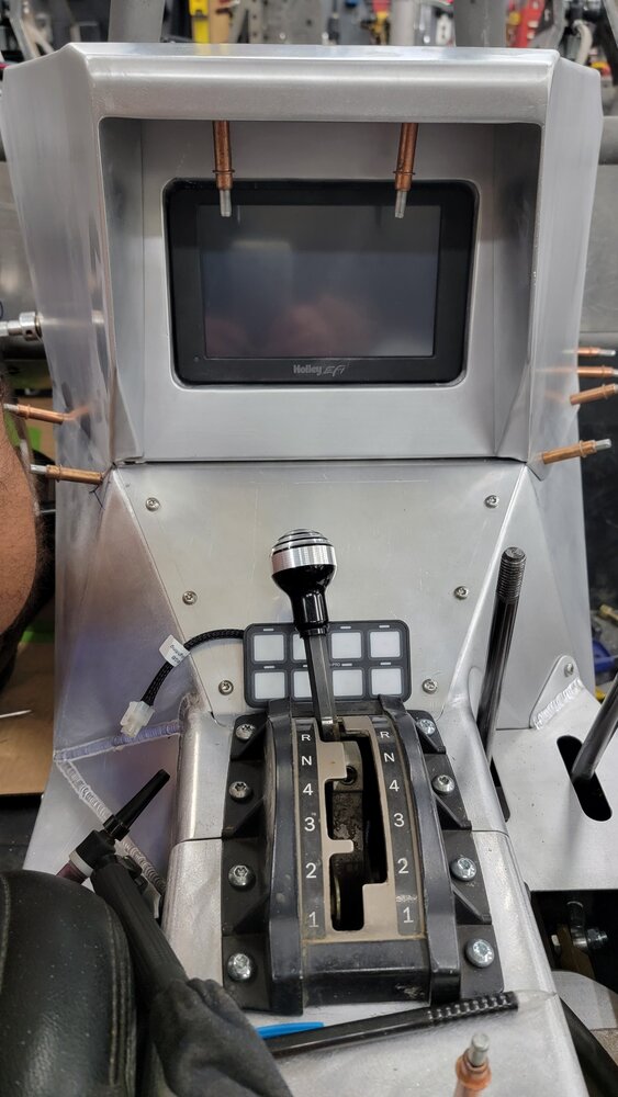

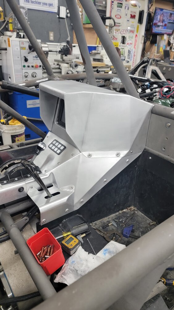

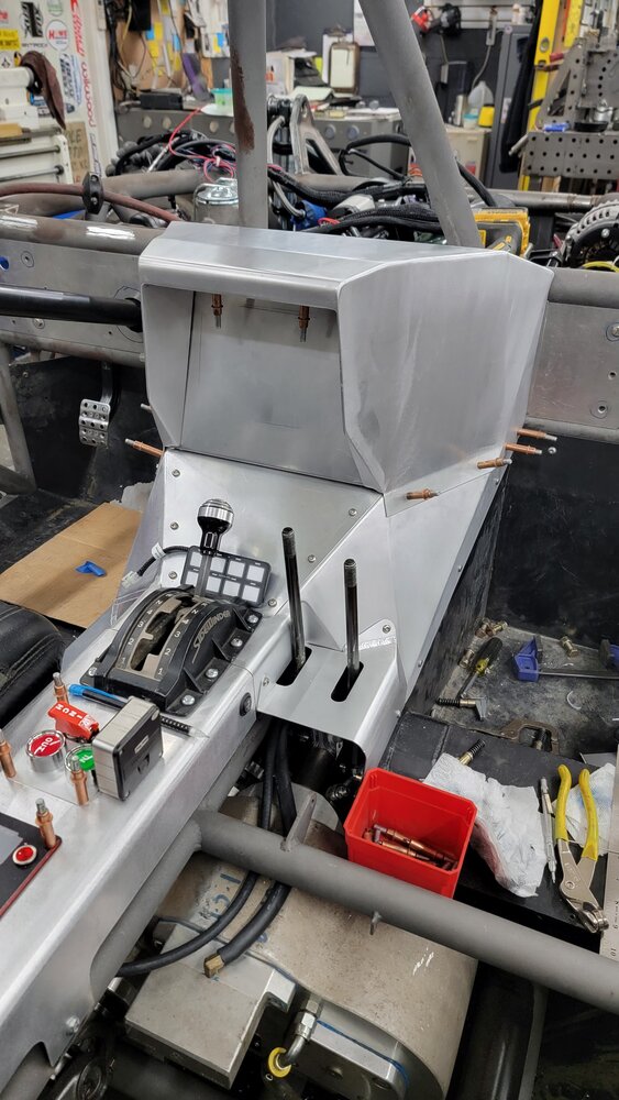

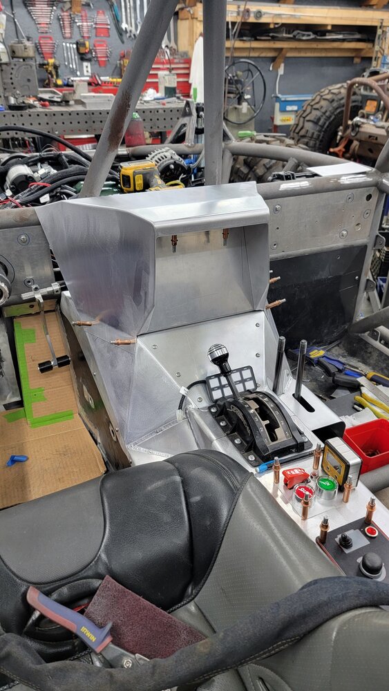

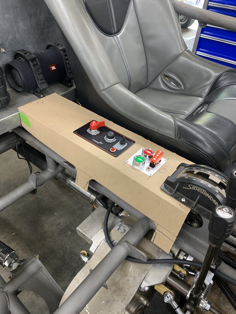

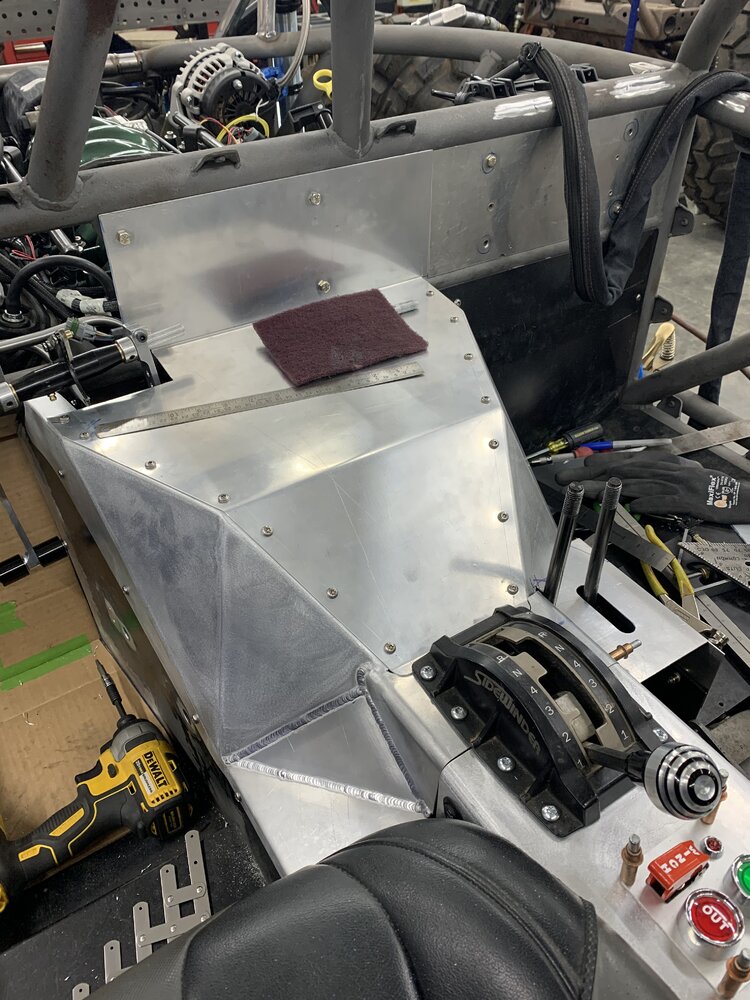

Lastly, got me a certified lesson in CAD (cardboard aided design) and built my first interior panel. Almost ready for my training wheels to come off.

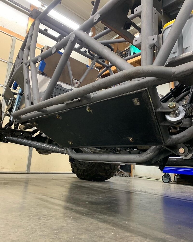

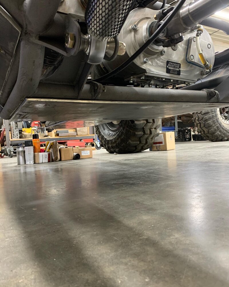

“Slippery as a buttery nipple” is how AR plate was described to me years ago. That’s why we repurposed my S10 belly pan and cut it down to fit the buggy. Nuts and bolts for the boat sides and welded on studs for the belly.

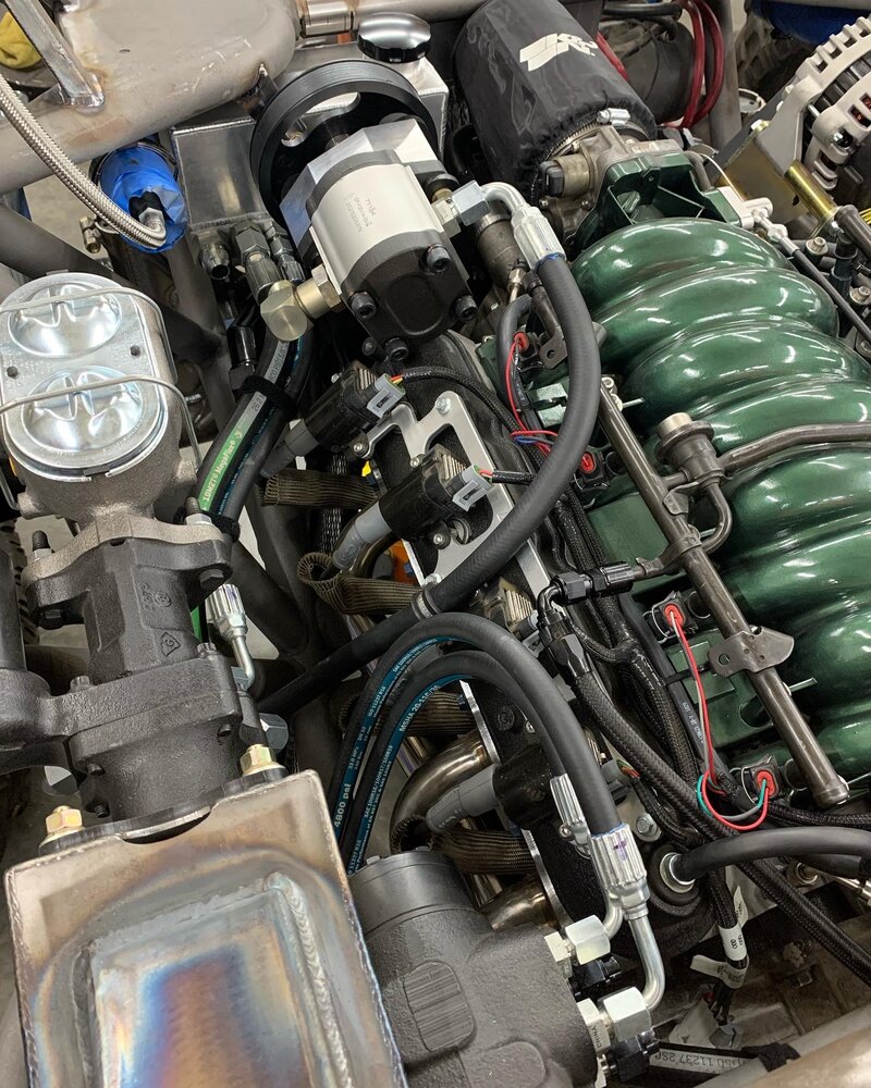

Hydraulic lines are routed. Only a few sections of hard line remain after fittings arrive later this week.

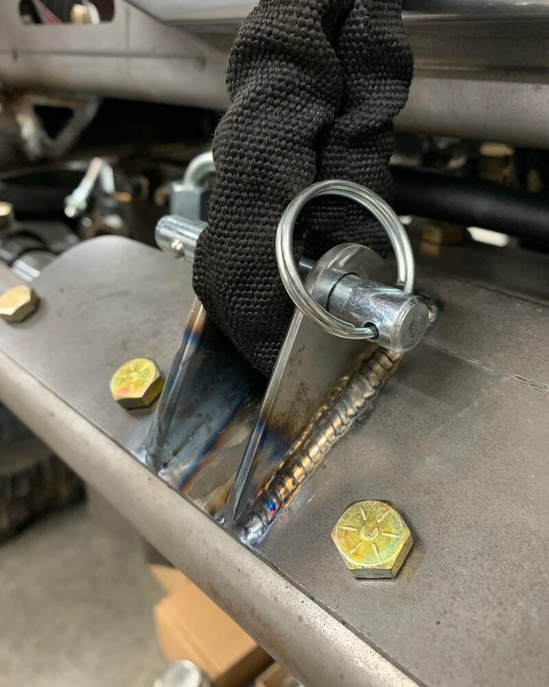

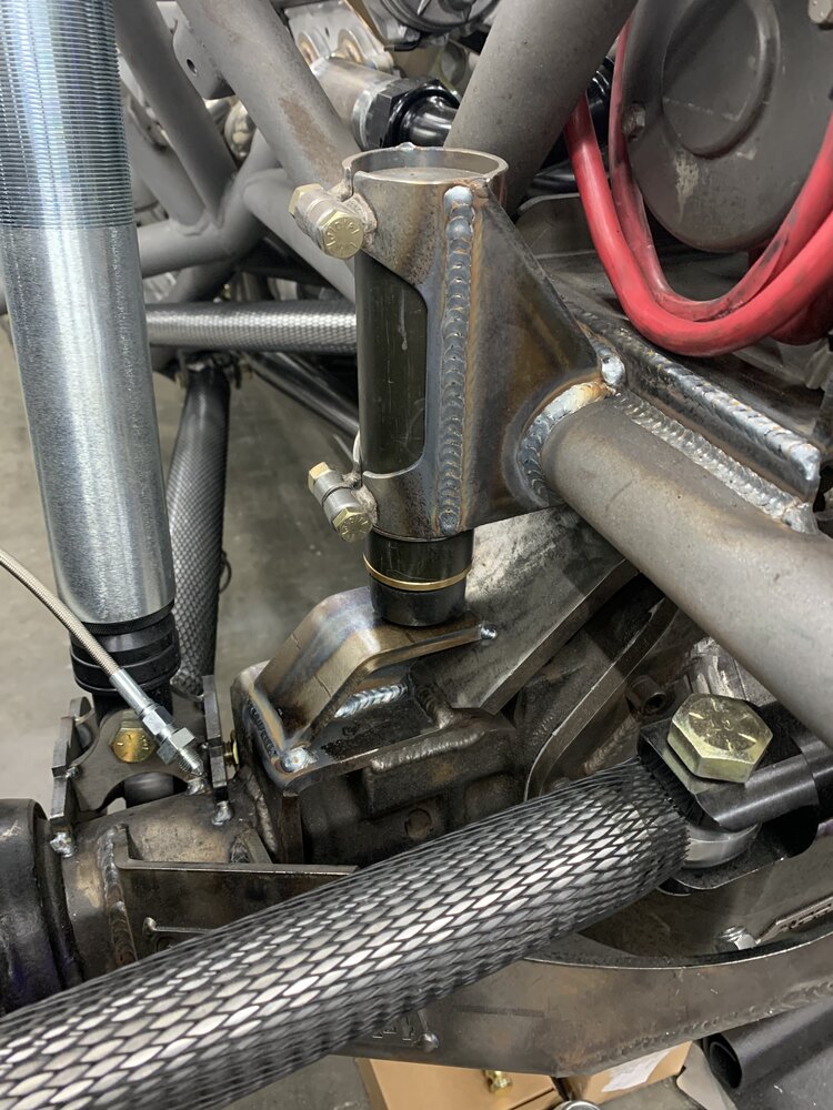

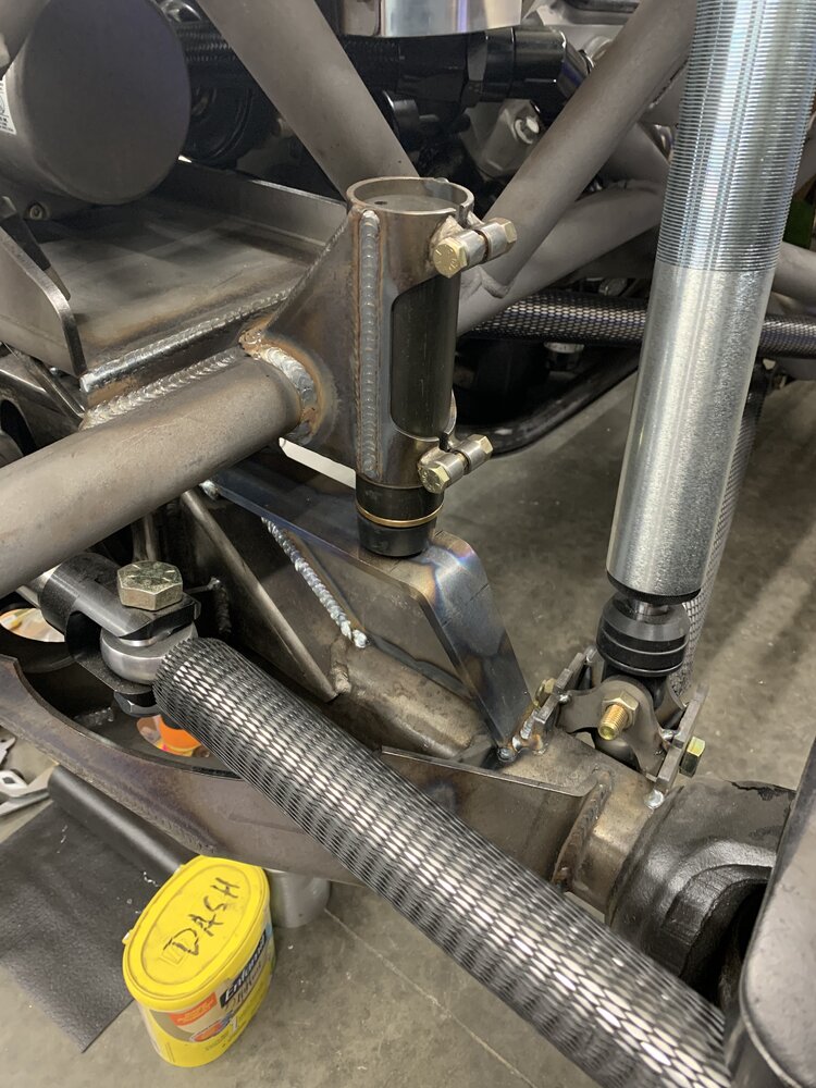

Last picture shows a little TIG action for the suckdown tabs on the D60. Lots more in progress, but not quite picture worthy yet.
No flow divider nor pressure regulator before the hydroboost ?
You'd be the first person I know to try it like that. You're about to send 15+GPM and 2000PSI in the return circuitry. I'm not sure it will hold.
The man smarter than me has been on the phone with the men smarter than him and this is what we’re being told.
Well, can’t wait for you to try cause I’ll have plenty of questions !
I will say that my rear steer valve has the regulator made into it. That’s about the extent of my knowledge on the subject.

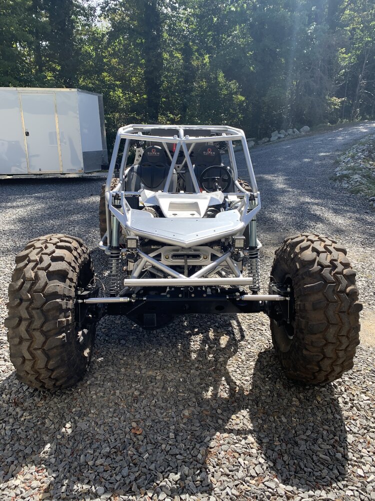

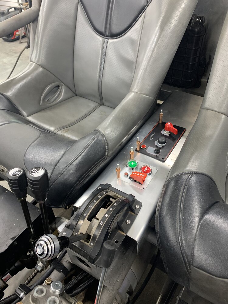

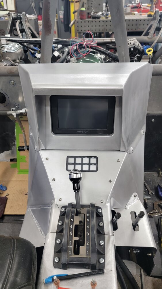

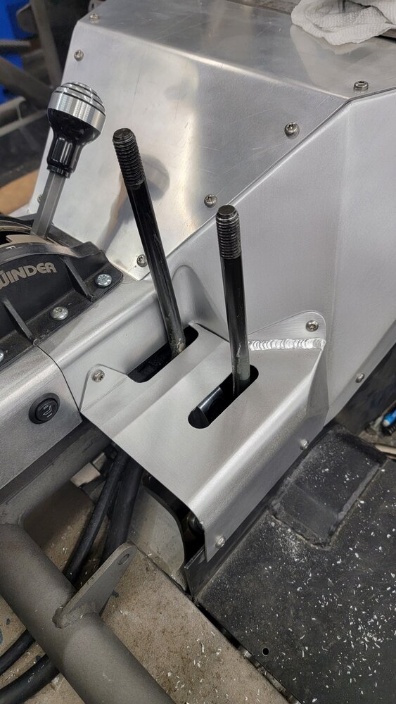

Didn’t realize anybody on here was still following along, but here goes some progress pics. @mcutler worked his magic on the interior. I wasn’t present for much of this because I’d only be in the way or just watching anyway.

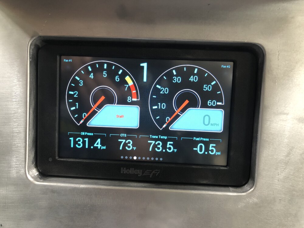

@Bebop helped a brother out and setup my Holley dash, loaded up a base tune, and programmed my SwitchPro.

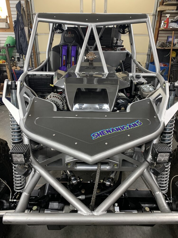

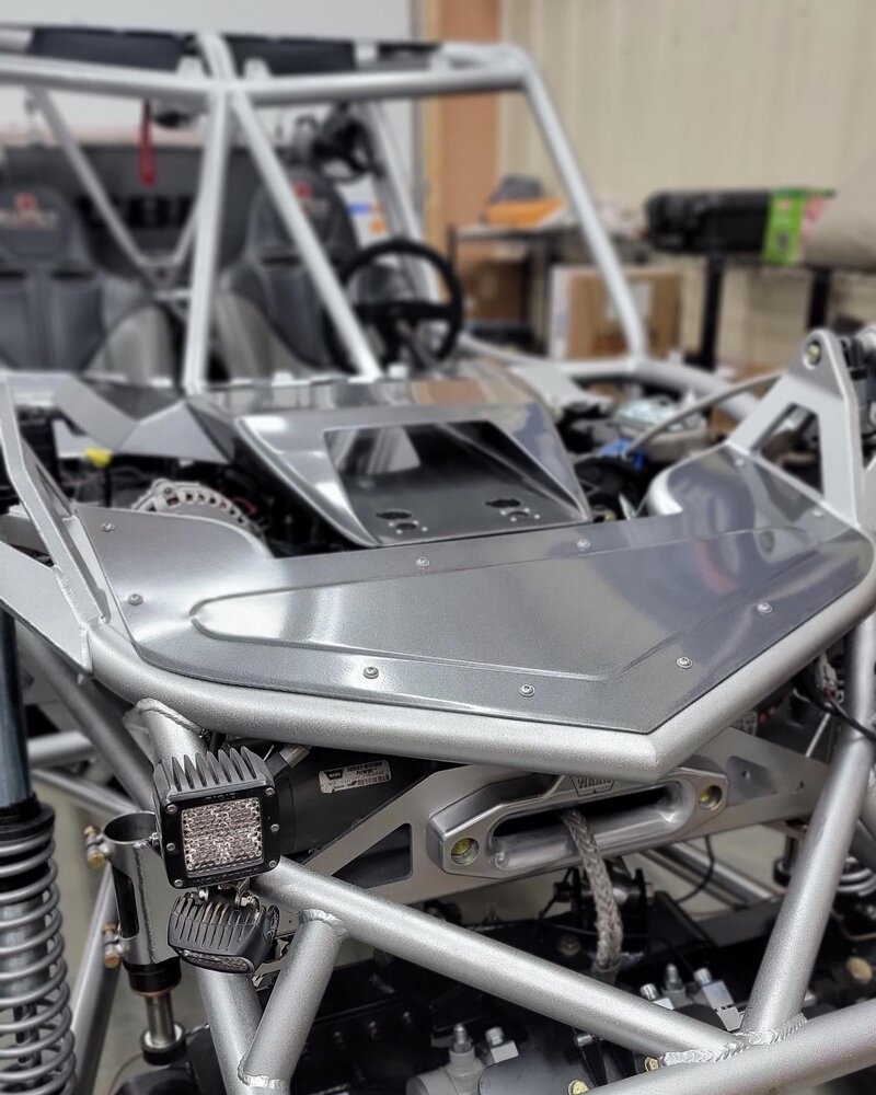

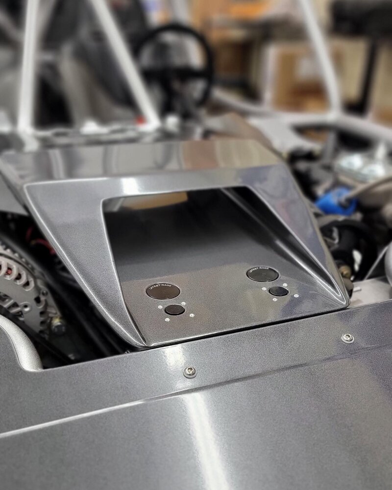

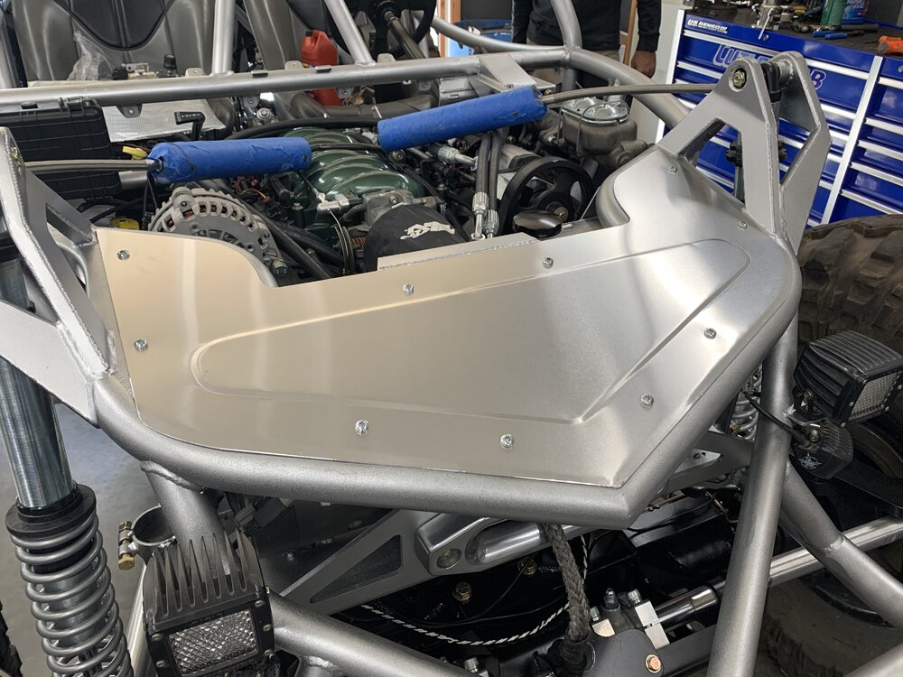

After laying down some sweet Rustoleum Titanium Silver on the chassis, it was time for final assembly. Matt dreamt up this F’n awesome hood!

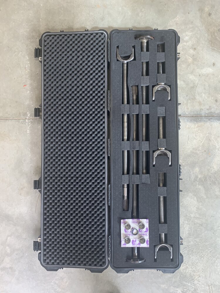

In the downtime, waiting on powder coat to come back, I got fancy with a HF rifle case and organized my replacement axle shafts.

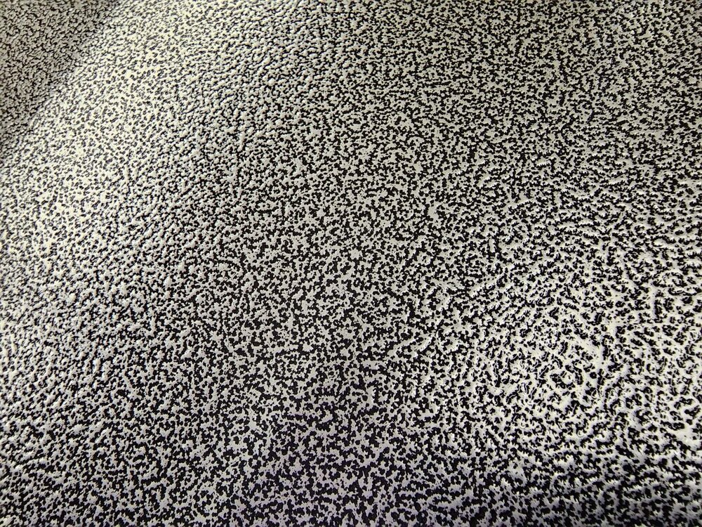

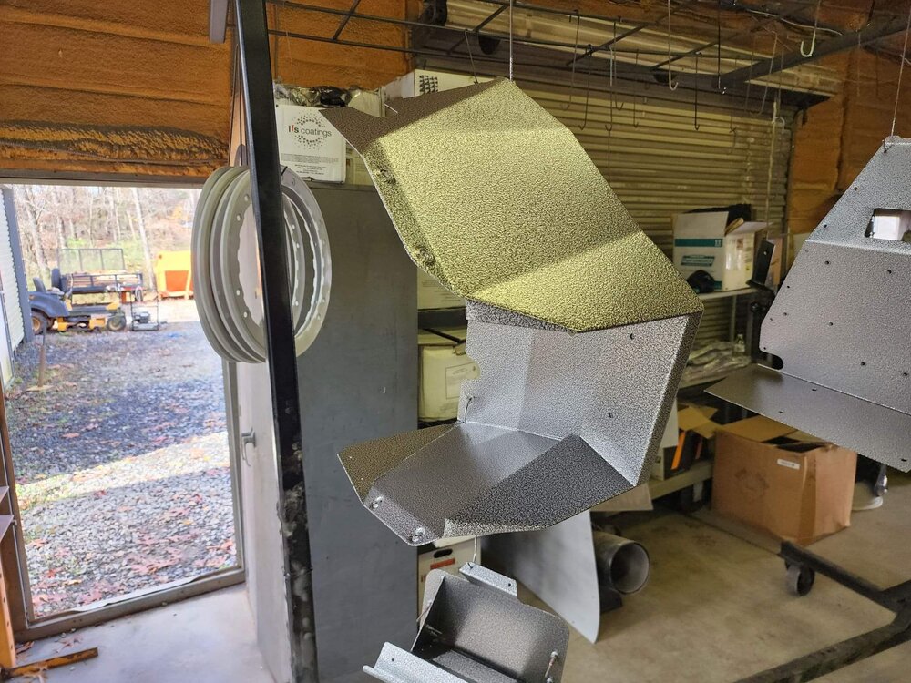

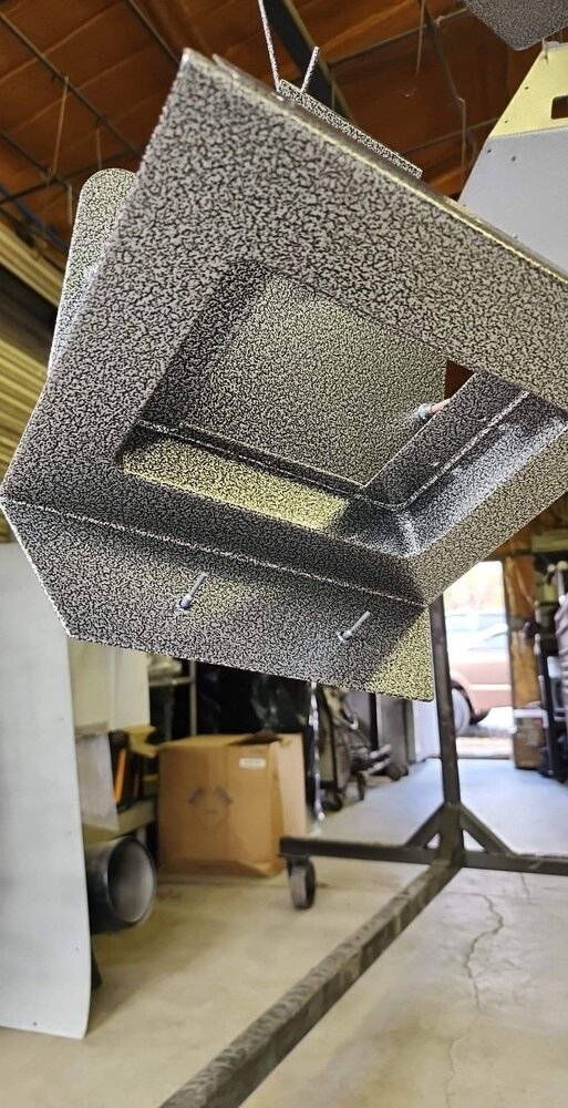

Precision Powder of NC layed down probably the best looking coating I’ve seen on the interior panels. I can’t even take credit. Matt pulled the sample out of a bundle and said “this would look cool”. I couldn’t argue.

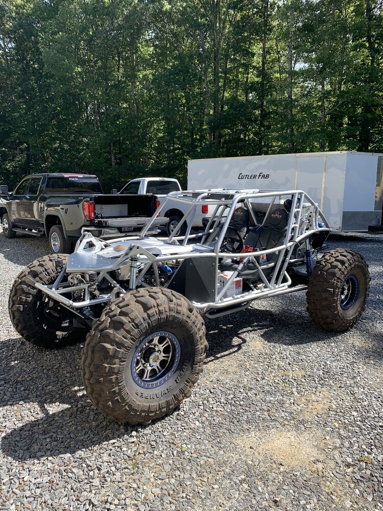

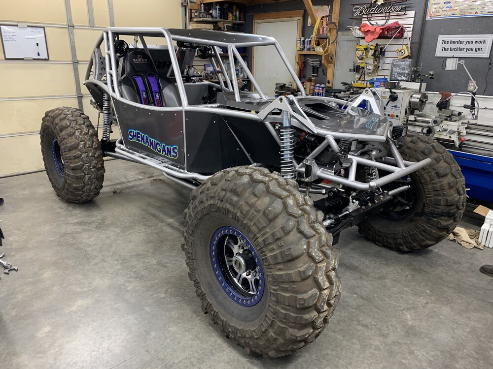

There’s still a few finishing touches to do before she’s done, but this is how I left her last week. Decals are on and Matt has a few more of his logos to find a home for. The date is set for 11/29 to strap her to the dyno and try not to send pistons to the moon.
