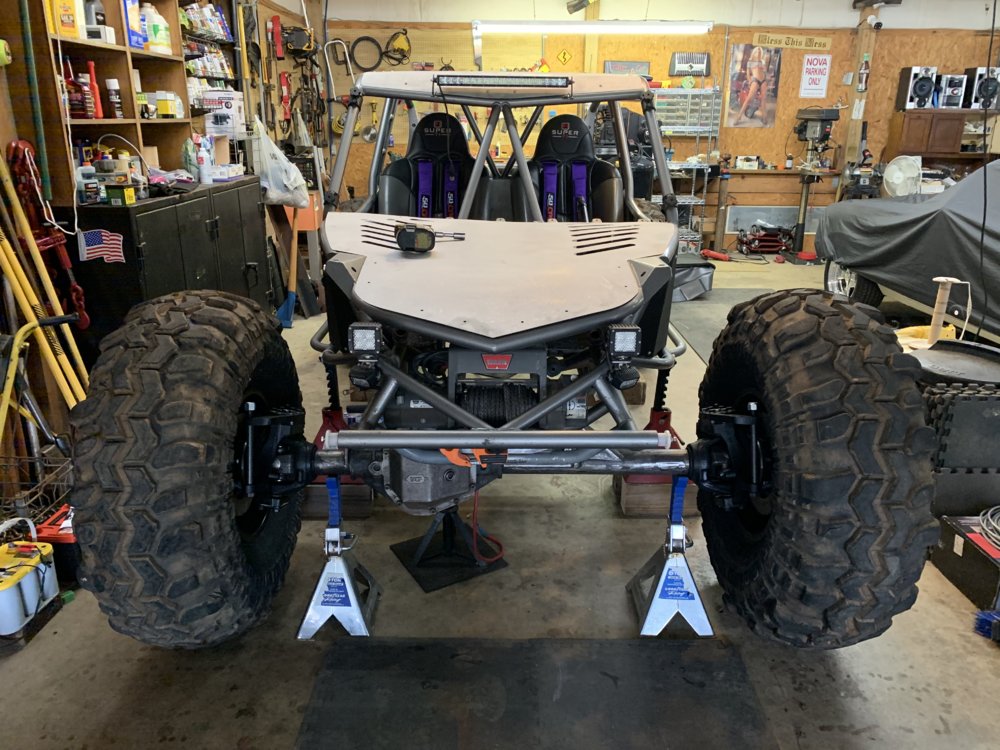

My part of the Dana 60 is complete. Really happy with the way it went together. YouTube was very much my friend though. Not an expert by any means, but I do feel confident that I can tear it down and make repairs if need be.

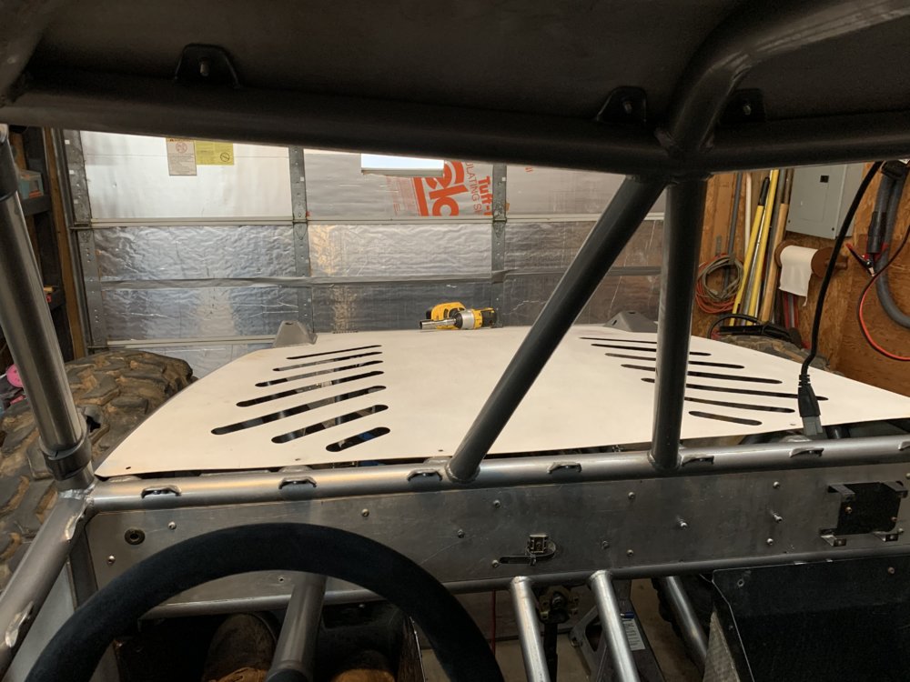

And a shot from the drivers seat. I may have made a few engine sounds. I may be able to see both front tires at ride height. Time will tell.

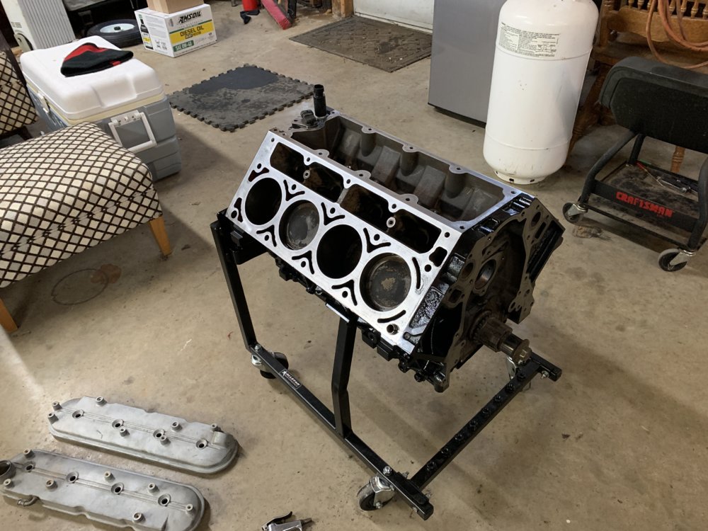

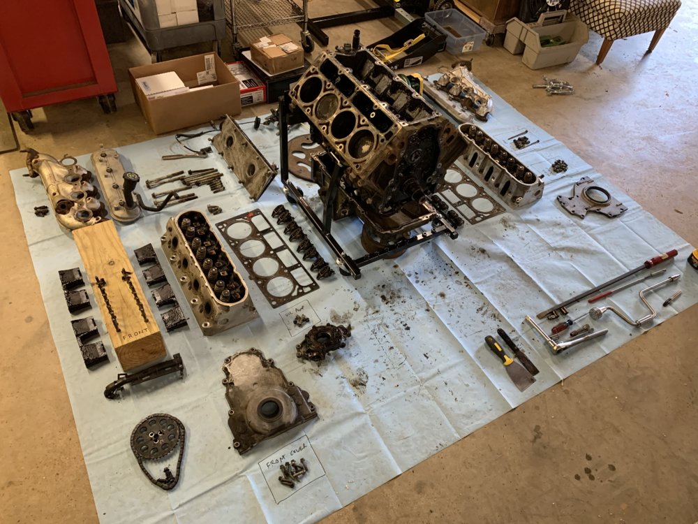

My LS threw up in the garage. Can somebody get me a towel?

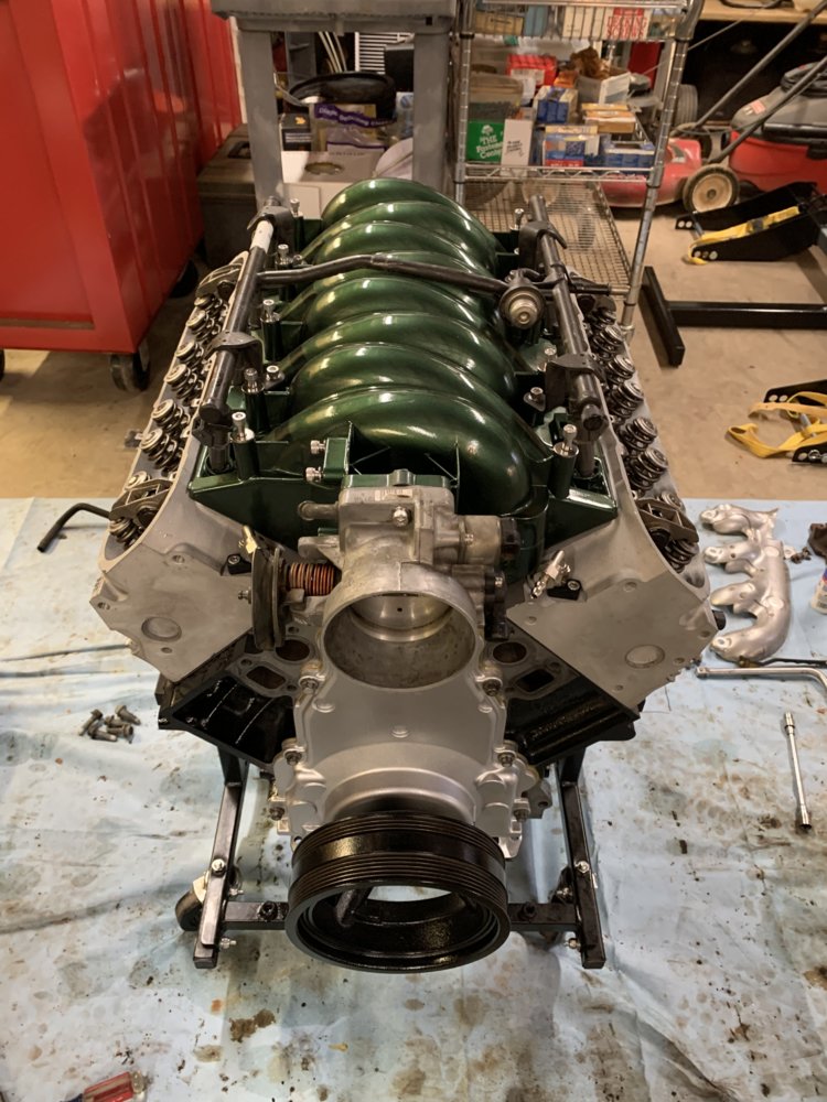

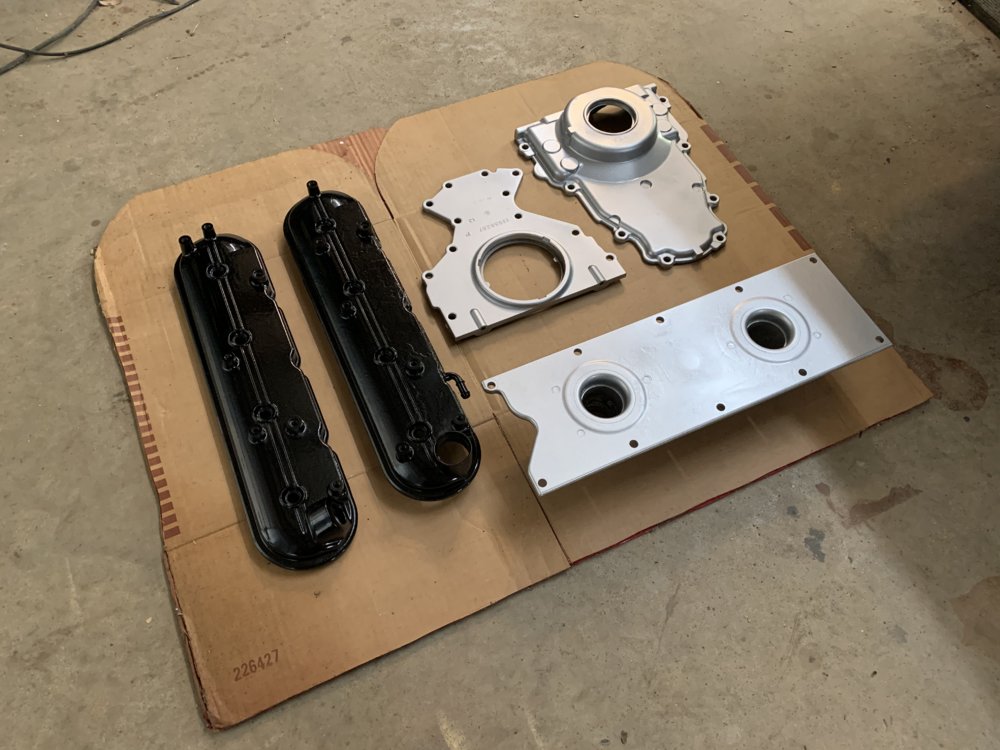

Heads were dropped off at the machine shop yesterday morning. Spent the last 2 days cleaning, prepping, and painting other pieces and parts. Still waiting on a few parts to arrive before I can start reassembly. There’s just a few upgrades going in. For now, I’m just looking for healthy and reliable.

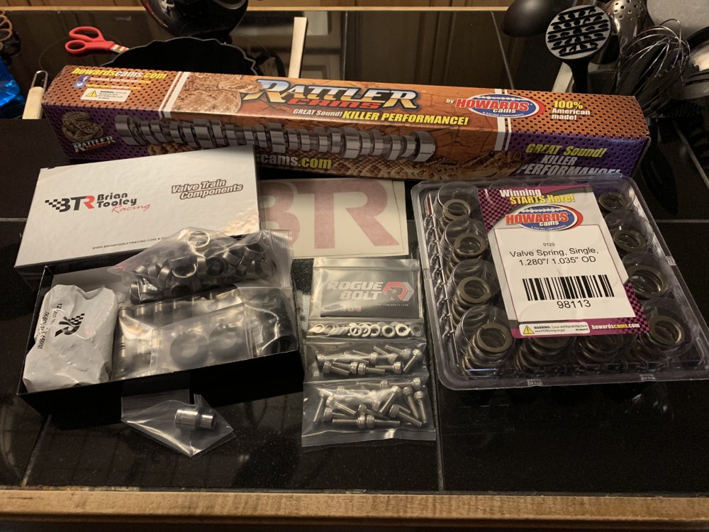

...and speaking of upgrades. @HGSR picked out a new cam and springs for me to breathe a little life in this old 5.3 LS. I also opted to buy a little insurance and ordered a BTR trunnion upgrade kit for the stock rocker arms. All new stainless bolts for the intake, throttle body, and coils.

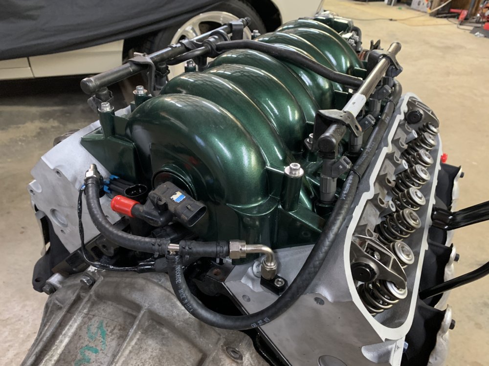

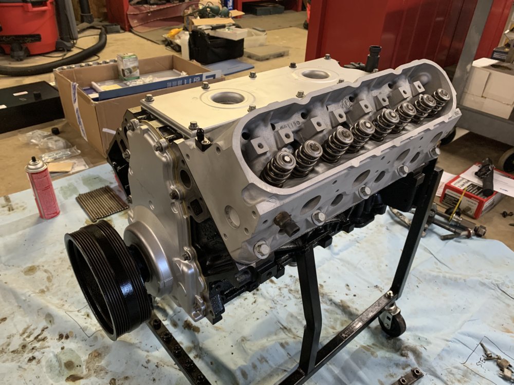

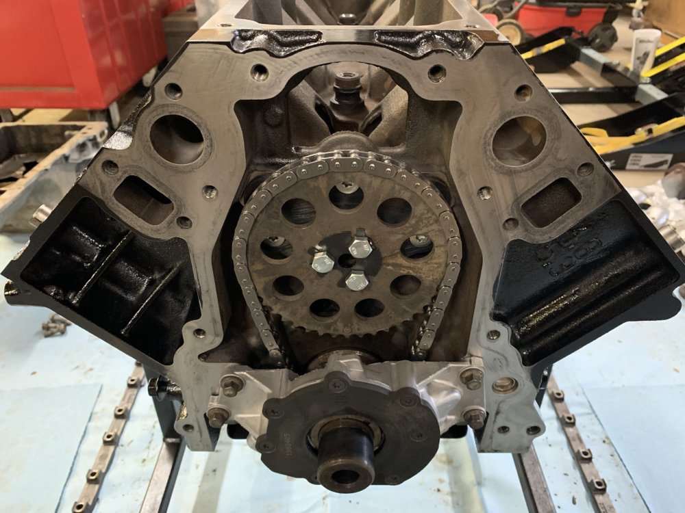

Little progress on the motor today. Got the new Howard’s Rattler cam installed with a new thrust plate. Hinson’s Motorsports C7R timing chain installed behind a new Melling oil pump and pickup tube.

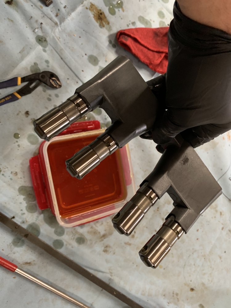

Dropped in the new LS7 lifters which, depending on where you read, rev higher than stock or do nothing at all.

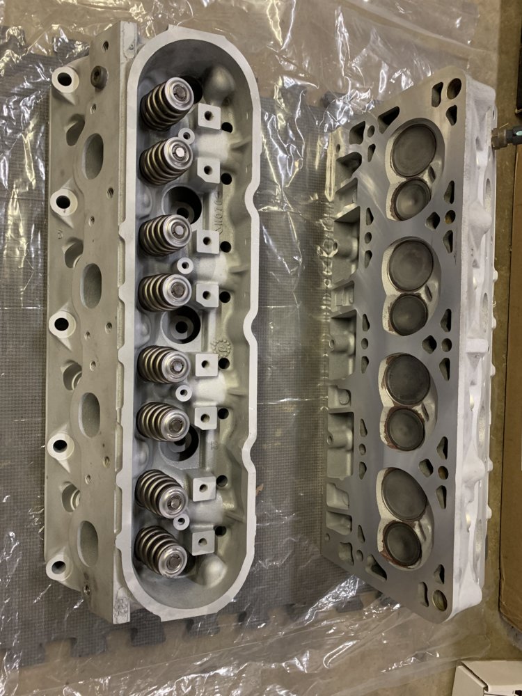

And then I picked the heads up from the machine shop. Got a good cleaning, resurface, and a basic valve job. They also installed some new seals and the Howard’s springs to match the cam.
More tomorrow hopefully.

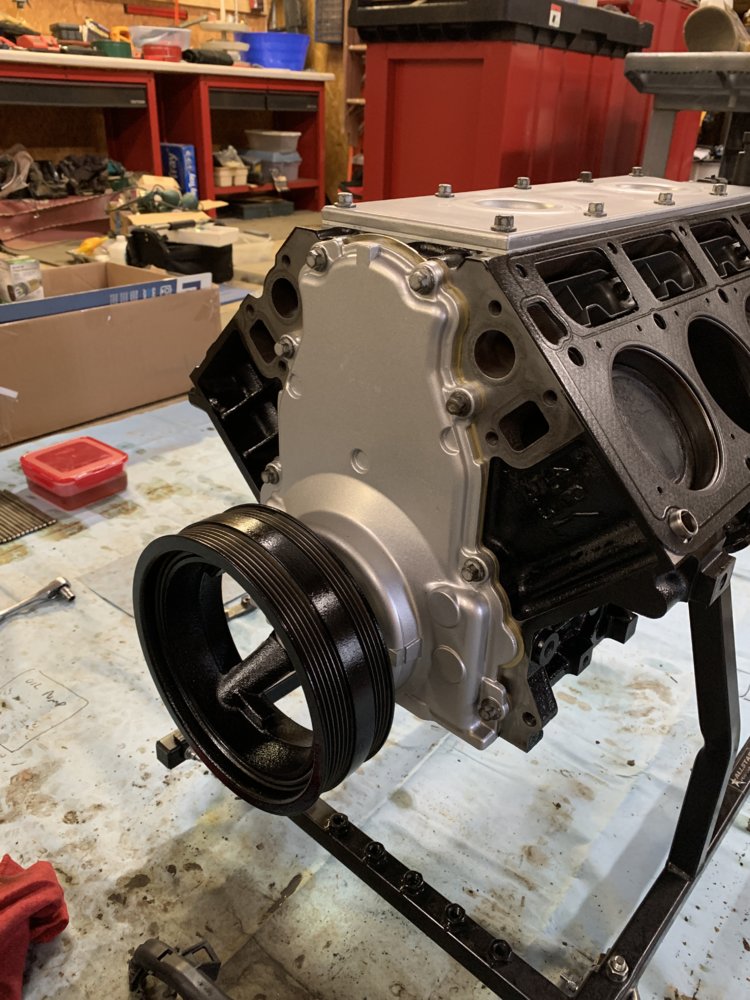

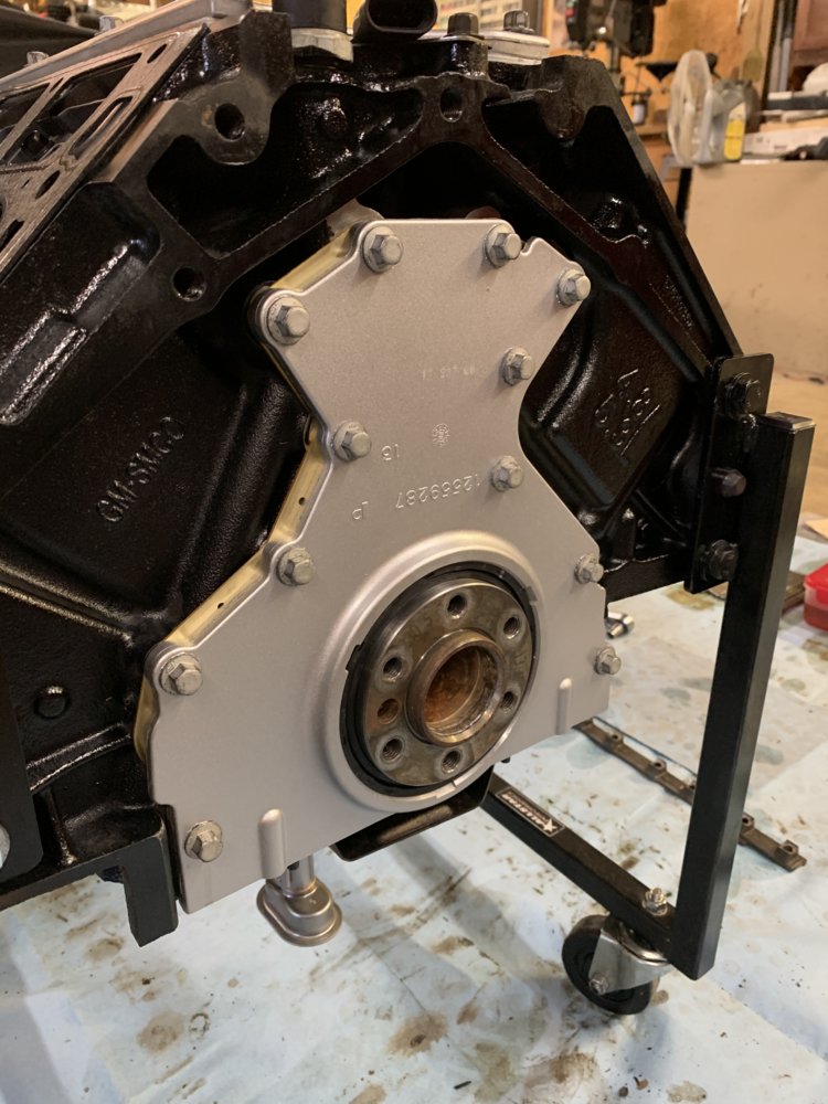

Little more done today. Front cover is on with a new seal and the crank pulley is pressed back in after a fresh coat of paint.
Rear cover is back on with a new rear main seal.
Also got one head mounted and torqued. Can’t do the other side until my missing dowel pin shows up in the mail. USPS lied to me when they said it’d be here today.
what dana 60 brake kit did you go with? entertaining a lightweight/affordable kit like lugnut4x4.
The setup I have came with the SOLID 8 on 6.5 conversion kit. My axle didn’t have any of the OE stuff on it when I bought it. It’s probably the same thing Lugnut4x4 sells as a kit. What I really like about it is that all 4 corners of my buggy run the same rotors, calipers, and pads.

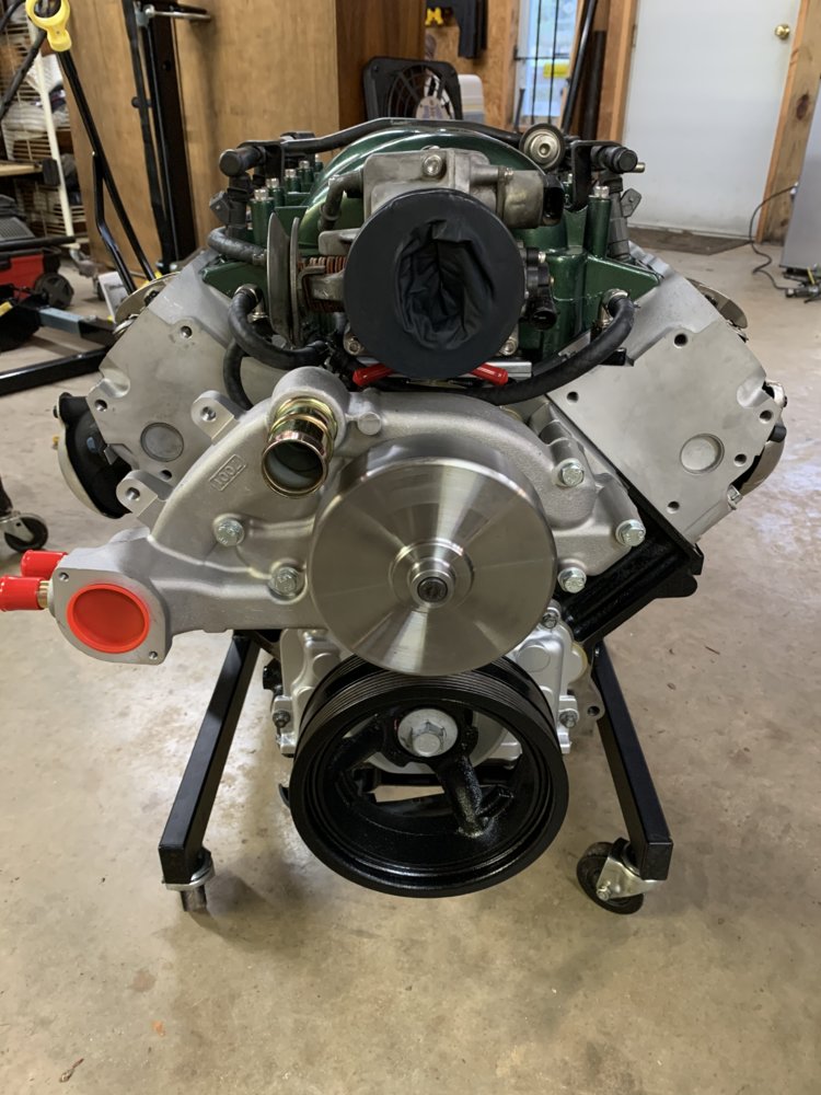

2 steps forward and pause... water pump bolts that come with my spacers aren’t long enough. Lap through town didn’t find any. EBay for the win. Maybe I’ll get it all buttoned up next week.

Such an organized rebuild. Good job !

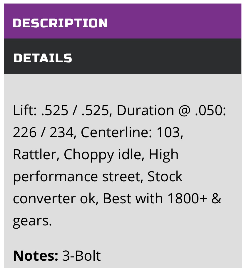

Mind sharing what cam you went with ? I'm looking to throw one in my 5.3 but haven't found something that doesn't kill all torque before 3000rpm.

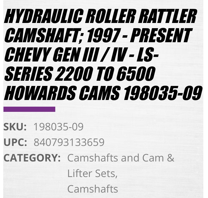

It’s a Howard’s Rattler cam. I trusted @HGSR with picking out my cam and springs. Pretty sure it’s the same setup he has in his hopped up GMC Sierra only in the 4.8 variety. His sounds awesome, has instant throttle response, and pulls strong all the way to the limiter. I’ve got a video of it doing a burnout from a dead stop with no brakes applied. I was impressed and just told him to make my LS do that. Here’s the specs on the cam:

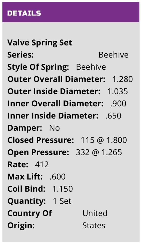

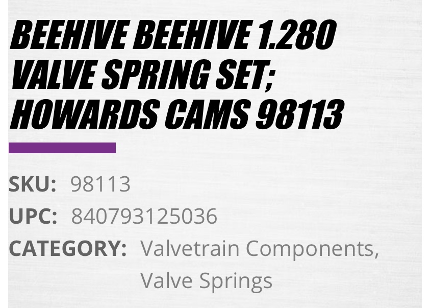

And the springs:

Thanks for the response.
I know comments have to be taken with a grain of salt, but it seems like torque below 3000 isn't it's forte either :
https://www.summitracing.com/parts/hrs-198035-09/
Like you said, grain of salt. I’m going with what I’ve seen with my own eyes. It’ll be a major step up from stock and combined with the rest of my valve train upgrades, should be pretty healthy in the end. You have to consider I’m running a stock, 140K bottom end. Don’t wanna push my luck.

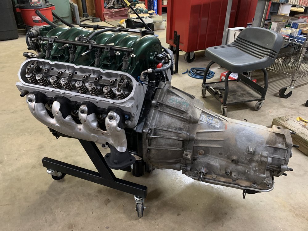

Another productive couple days in the shop. Longer bolts came in for the water pump and spacer. Drilled and tapped the spacer to accept the return from my steam line kit. Got all that routed and secure.

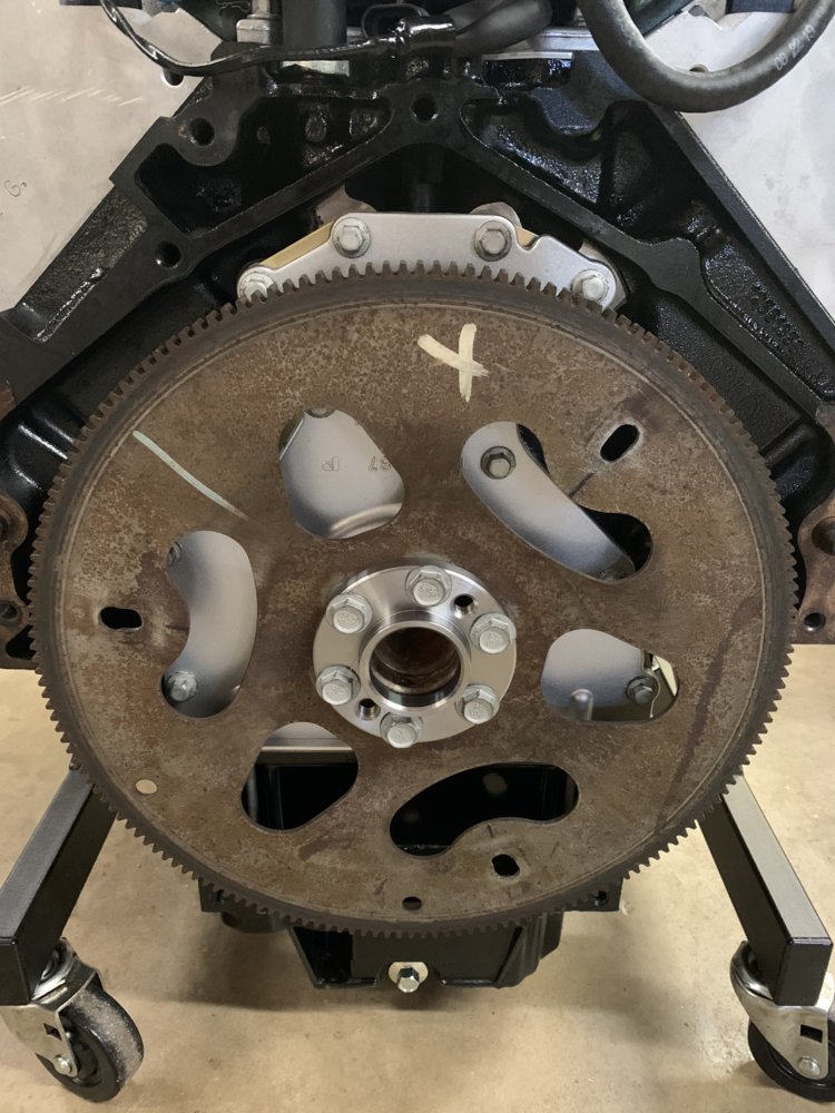

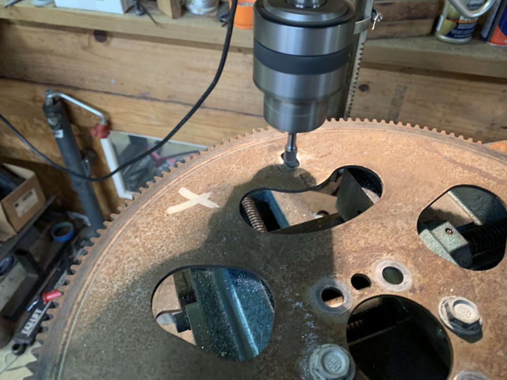

Also had to elongate the holes in my flywheel in order for it to mate up to my 96 4L60e. Got it all installed with the proper spacer.

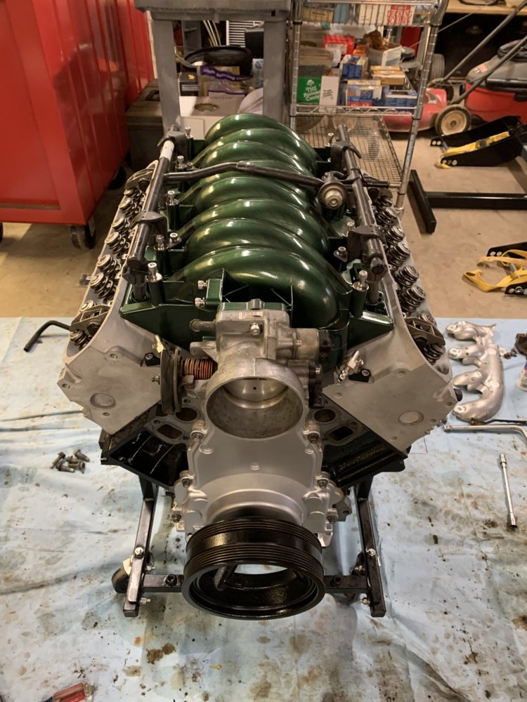

Then married the transmission to engine. It’s a huge weight off my mind to see it all together finally. I also put a fresh coat of 1300 degree paint on a set of Camaro manifolds I picked up.
