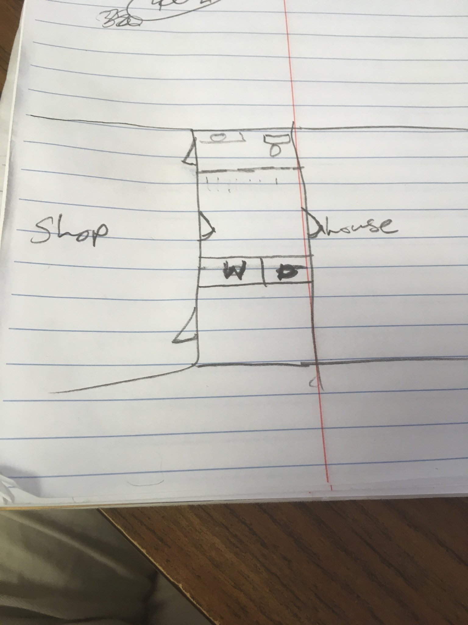

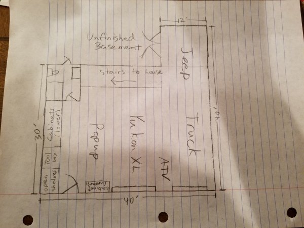

As others have said, go bigger. My garage (drive out basement) is 30x40 with a 12x10 bump out, kinda L shape. It has 2 garage doors and a personnel door. 2 cars wide and a nice work area is about it. I'm able to fit 3 cars because of the bump out, truck and jeep nose to tail.

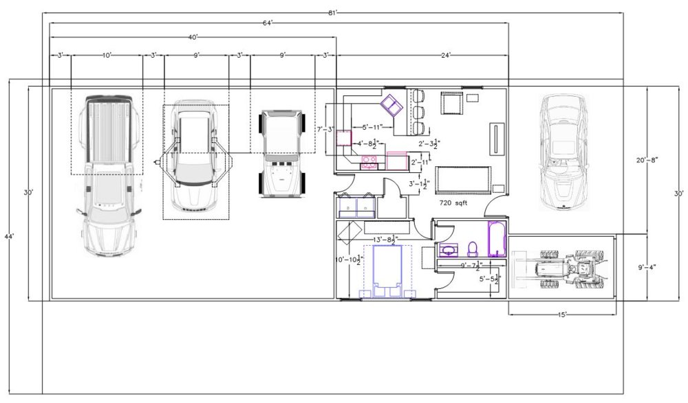

I contacted Carolina Post Frame Construction and asked about a 30 x 40 x 12:

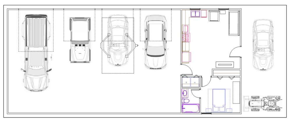

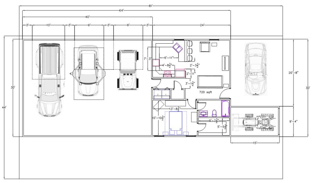

I started with a 50x30 shop, and added what I thought was the MINIMUM for an apartment to the end. Can you read these dimensions?
I would also add another bathroom outside the living area, depending where it is compared to your house. I doubt your MIL will want you coming to read a mag in her house while youre out at the shop.... and plan for double think wall there so you can insulate and work late without disruption.
i always wanted a shop house. that said i would have 2 6in stud walls 6-8ft apart with exterior grade doors on both hall ways. one side can have a shop bathroom only access from shop. other side can be storage or tool room middle where doors are have a mudroom with washer and dryer.
It'll either be a 6" stud wall from floor to roof, or an 8" block wall filled with insulation between the shop and apartment. Neither my wife, nor my MIL appreciate the sound of an impact :rolleyes:
I think that living area is going to be kind of tight at only 30ft deep.
That was the bare minimum (for pricing)

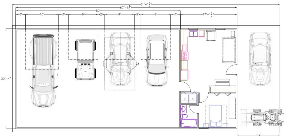

More than likely it will be some sort of iteration of this

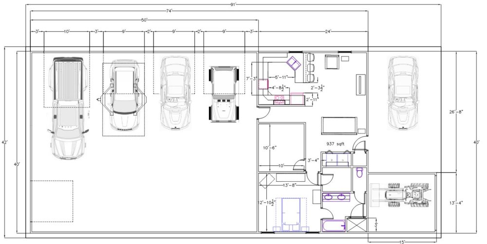

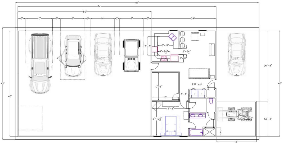

Below is the "shoot for the moon" plan where I get everything I want
Where there's a second room (for guests once whomever gets settled) but would serve as my wife's office (she works remotely) while we were building. Can't put a closet because my septic field permit is only for 4 "bedrooms"
That's also why no second shitter. The house won't be so far away that I can't waddle with my finger up my butt over to the house to avoid trashing "granny's" shitter
only suggestion is to flip the bath and bedroom where it is not against the shop wall. No matter how much insulation, there will still be some vibration transfer.
