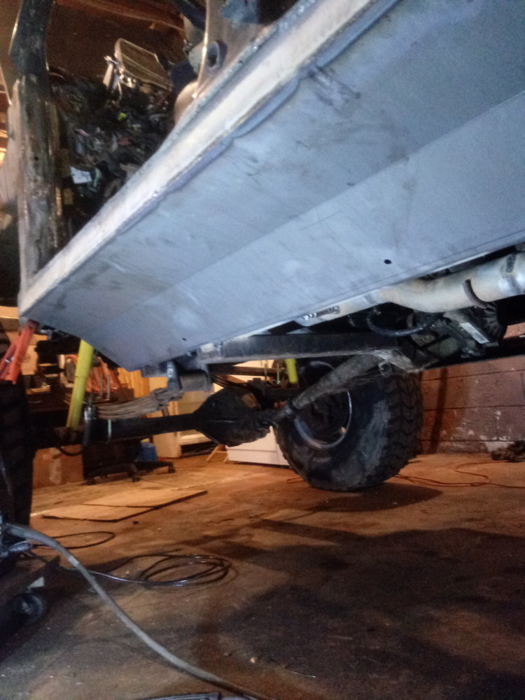

This is my rockers and sliders so cage is tied into pretty stout frame now..first the frame rails have 4x4angle iron 3/16thick then these mold boards which are unfortunately 3/16too...yeah its probably one heavy pig now lol but a tank
