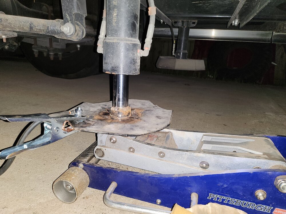

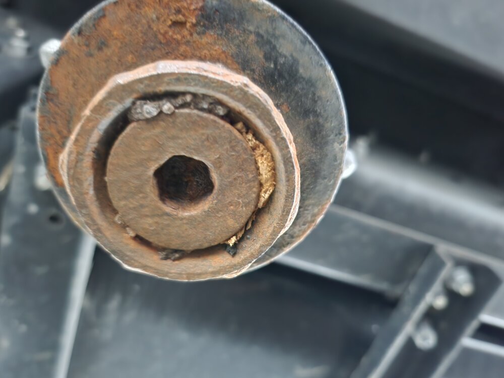

First thing I found was no main battery disconnect so I added one. Also found one of the jack pads was rusted. So I redid that one and welded it back on.
After the trip it went back to dealer to get a few things they promised but we're delayed before trip. New slide out topper, awning lights and a new inverter.
We just got it back this weekend and I found another bad jack pad so I re welded that today also

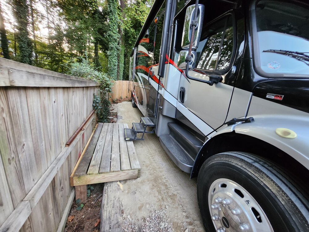

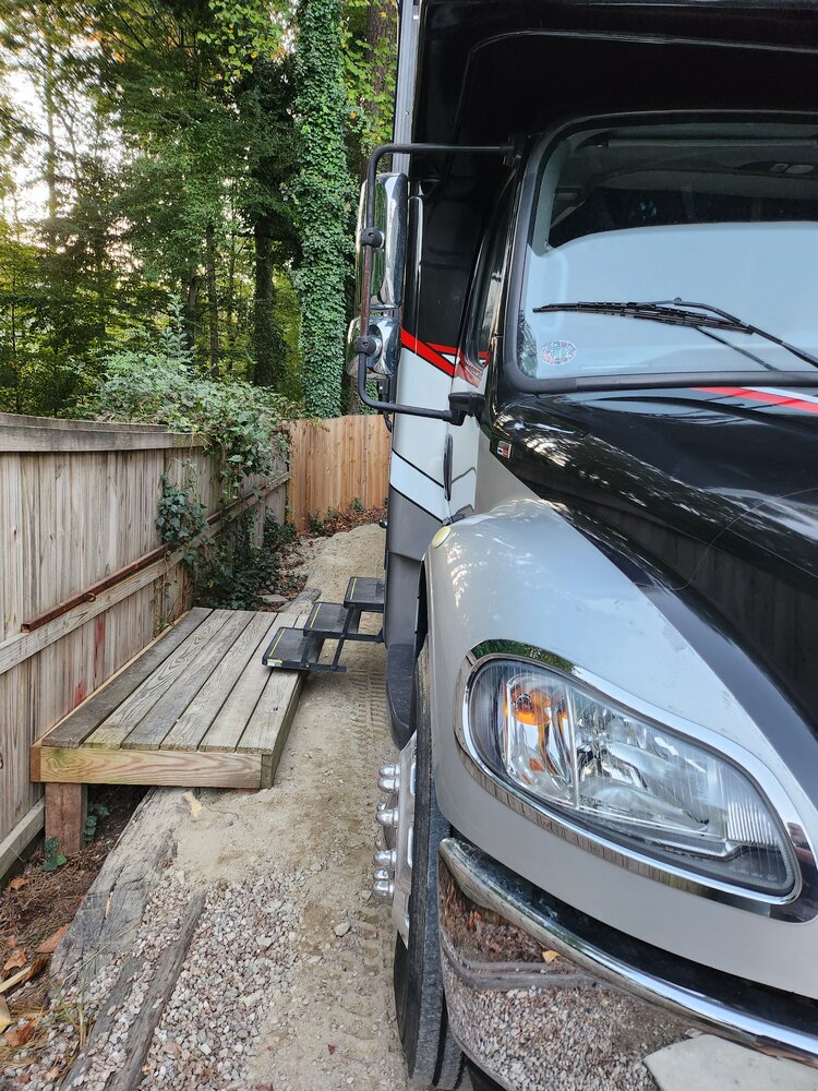

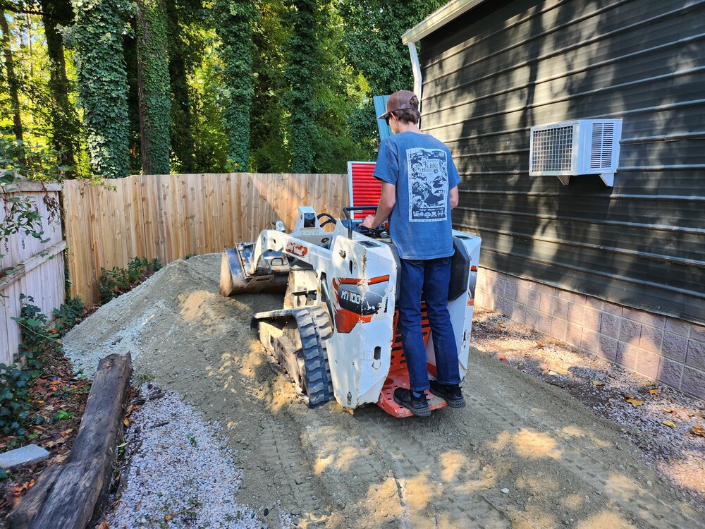

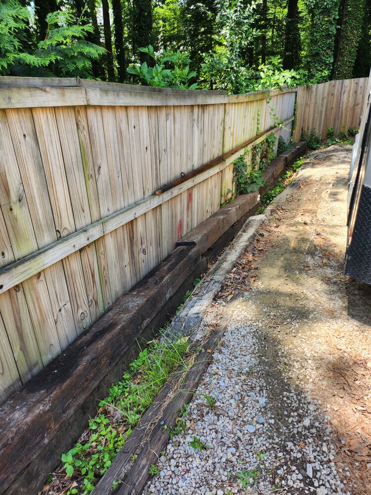

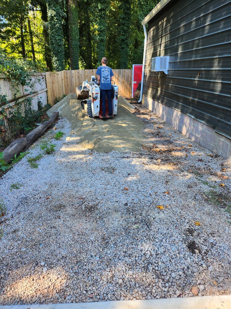

The old parking pad was not level anymore. So my son and I had 6 yards of crush and run dropped off and we spent the weekend making it level.
Also added a small deck to step out onto when parked

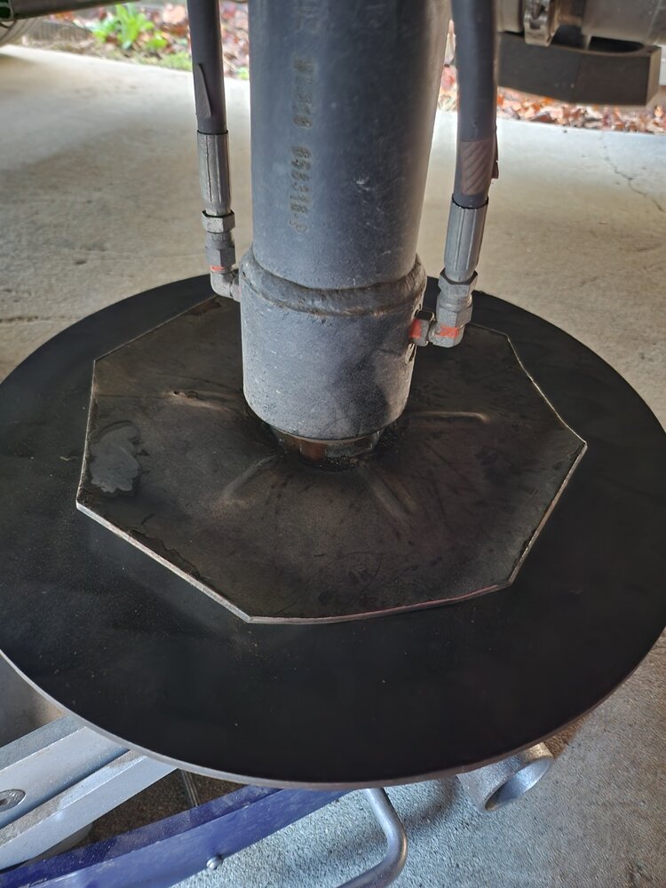

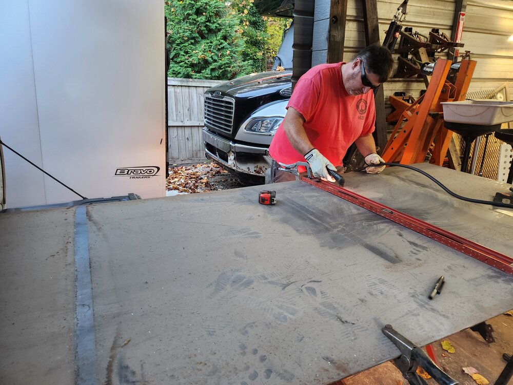

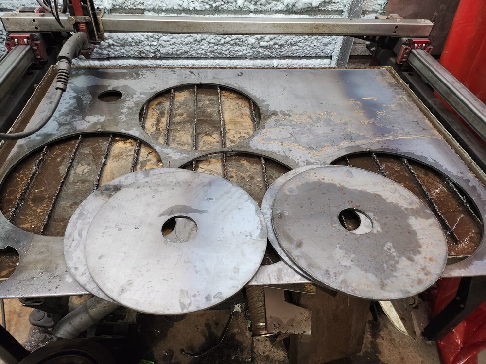

John picked up a sheet ofn1/4" for me so we cut it into smaller pieces to fit cnc table.
Going to make new feet for the leveling jacks. This rv came with snap pads which I don't like as they just hold water which causes rust etc. So I am going to make 15" round feet that will help with stability and not hold water
So what does one of those weigh? Motor transmission combo?
To be honest. I don't know. I will taking it on a trip soon and hope to weight it all
Welded on new plates
We will see if these work or not. Not sure if it will cause more leverage and have issues or not. Time will tell
If nothing else, they look badass. That has to count for something, whether they work better or not!

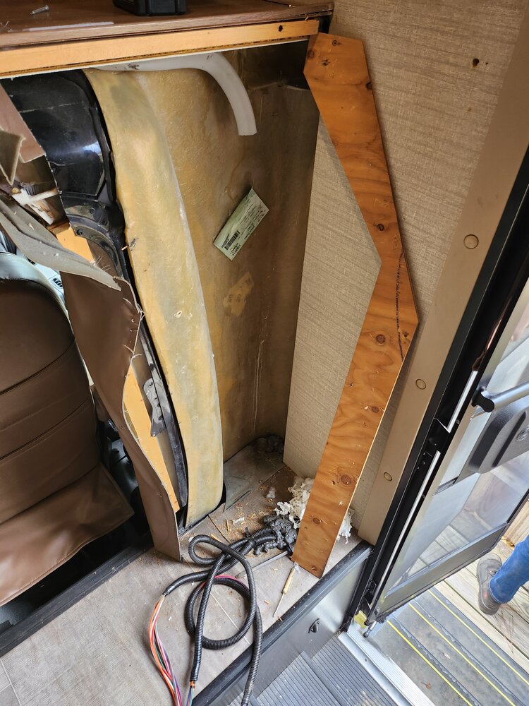

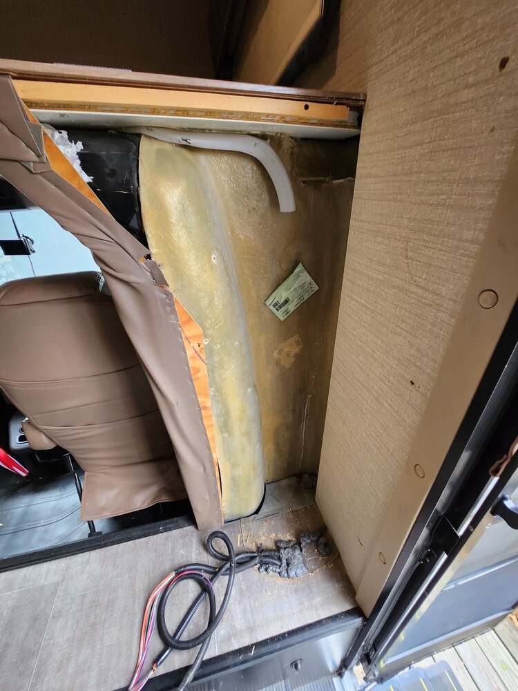

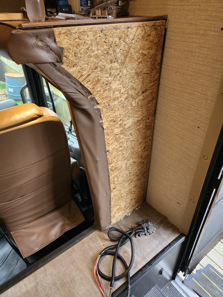

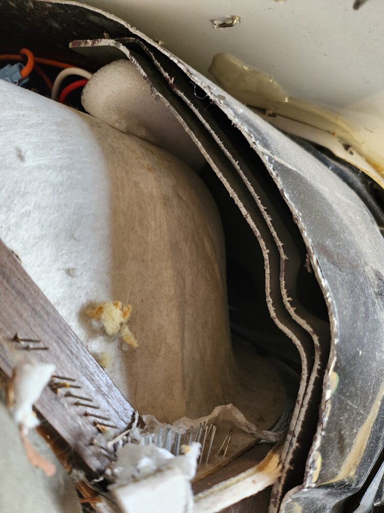

Short story, had to remove cab cabinet and wood, secure fiberglass to cab, fill all holes with expanding foam and make new wood wall and than reinstall everything.
We did both sides and it made a huge difference.

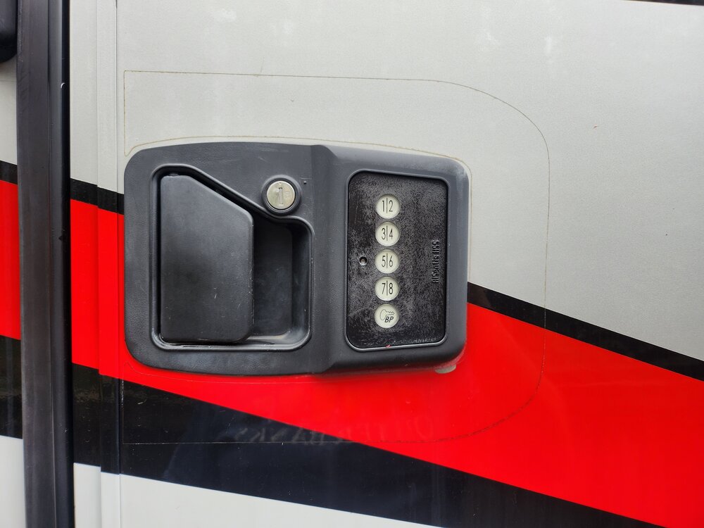

The original door latch also made noise and i found the button did not work. So also replaced that

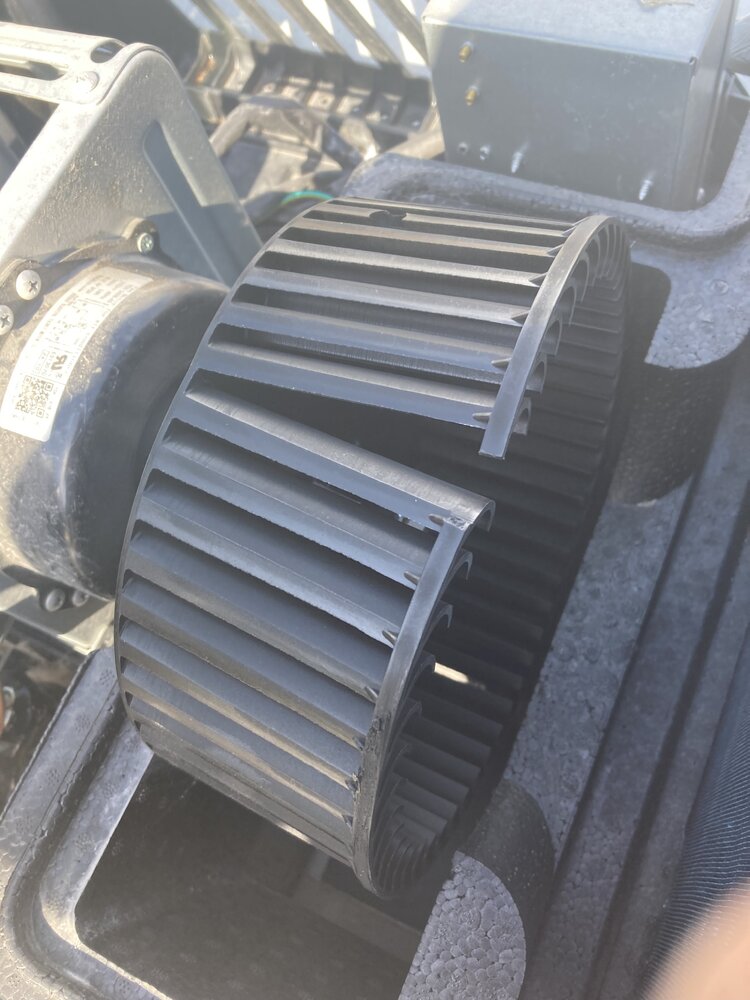

My AC went out late March, service plan covered a new one, installed by a local rv tech. This week the fan decided to detonate. New fan installed yesterday but threads in the collar stripped in seconds. Now waiting for another. Let’s just say the weather now is a bit different than March! Wishing a had two units.

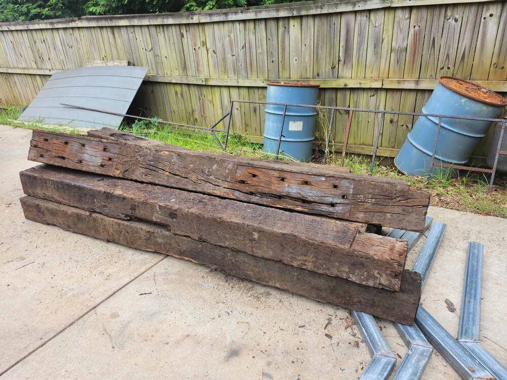

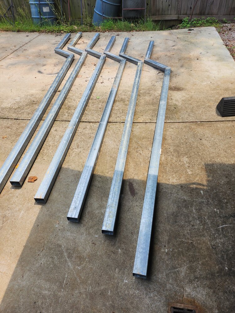

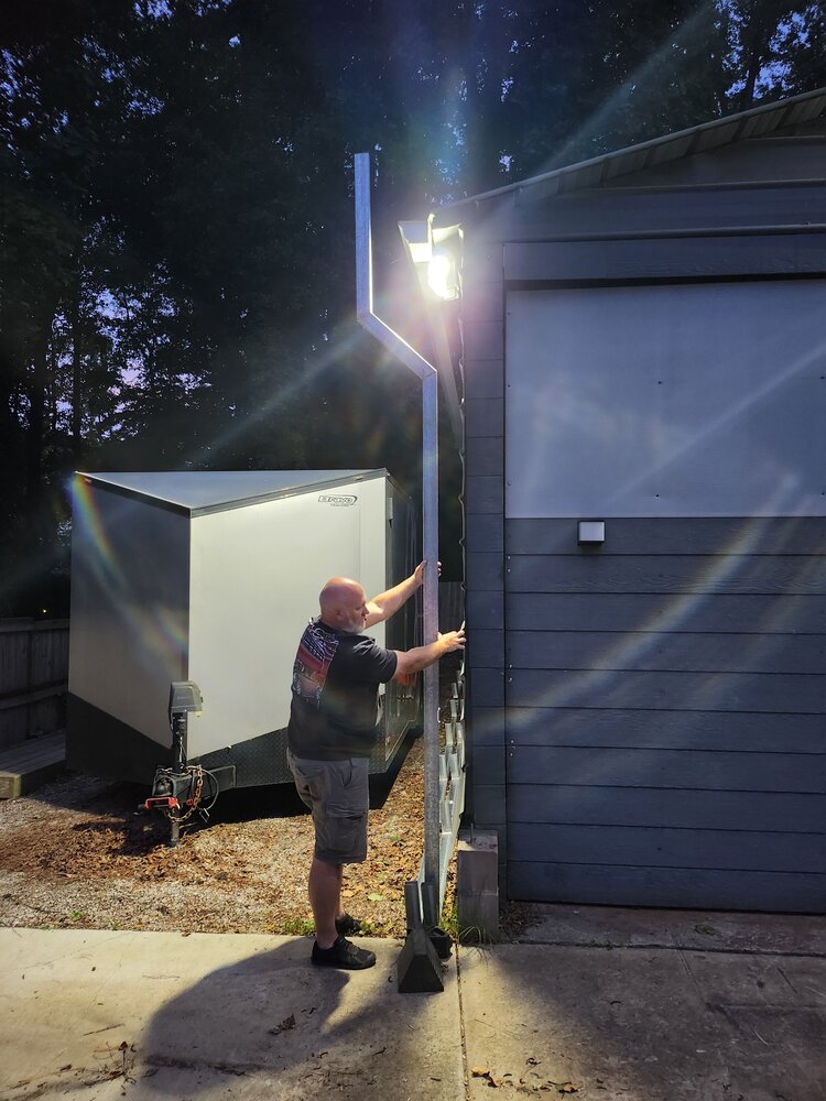

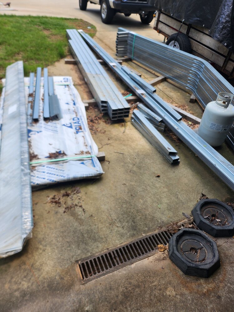

Making a carport for the rv to park under
Trying to keep roof clean
I had to modify side risers to clear shop roof
Having to make a wider pan for rv so carport has support
Fyi these are freaking heavy
