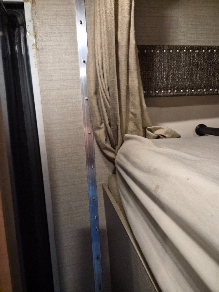

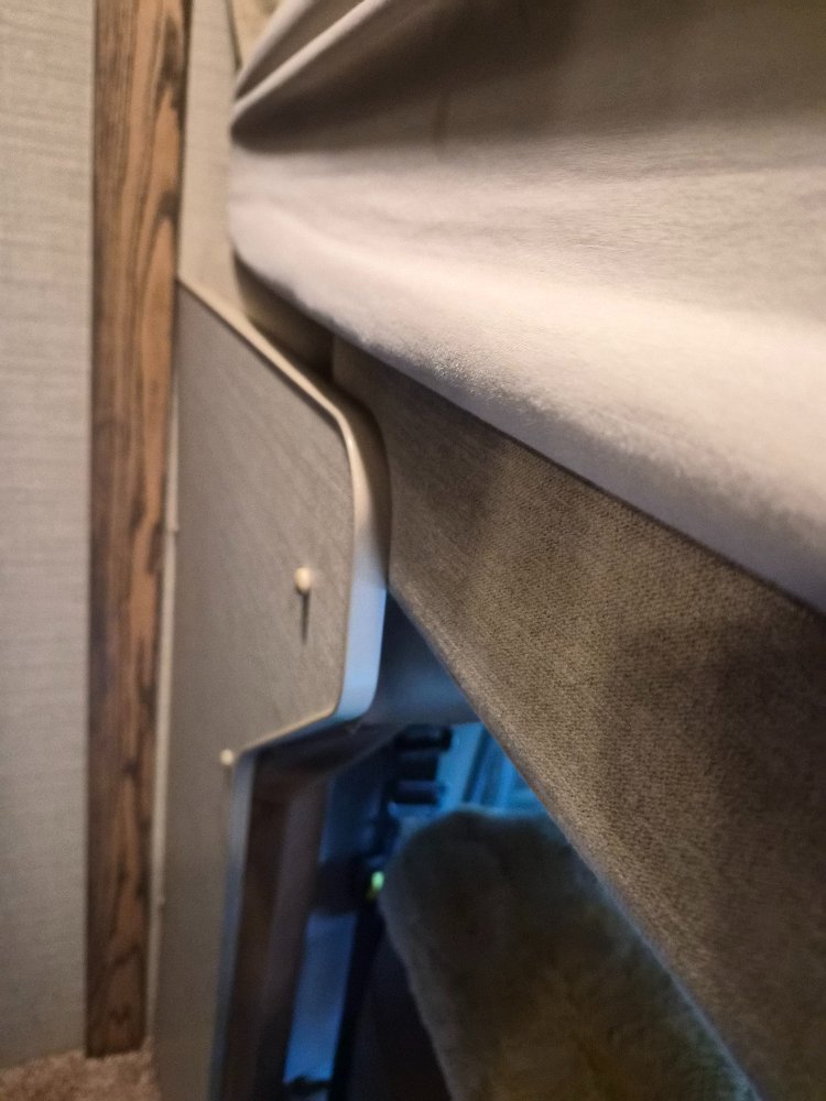

Had to take apart outside and drill all the way thru rv wall added a aluminum strip to inside and bolted it all together. This stops cab seperation
Need to seal the outside and put beauty strip back on. Than I move to passenger side

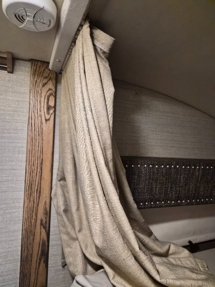

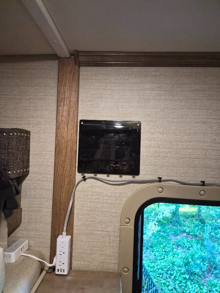

Finally got around to covering the inside

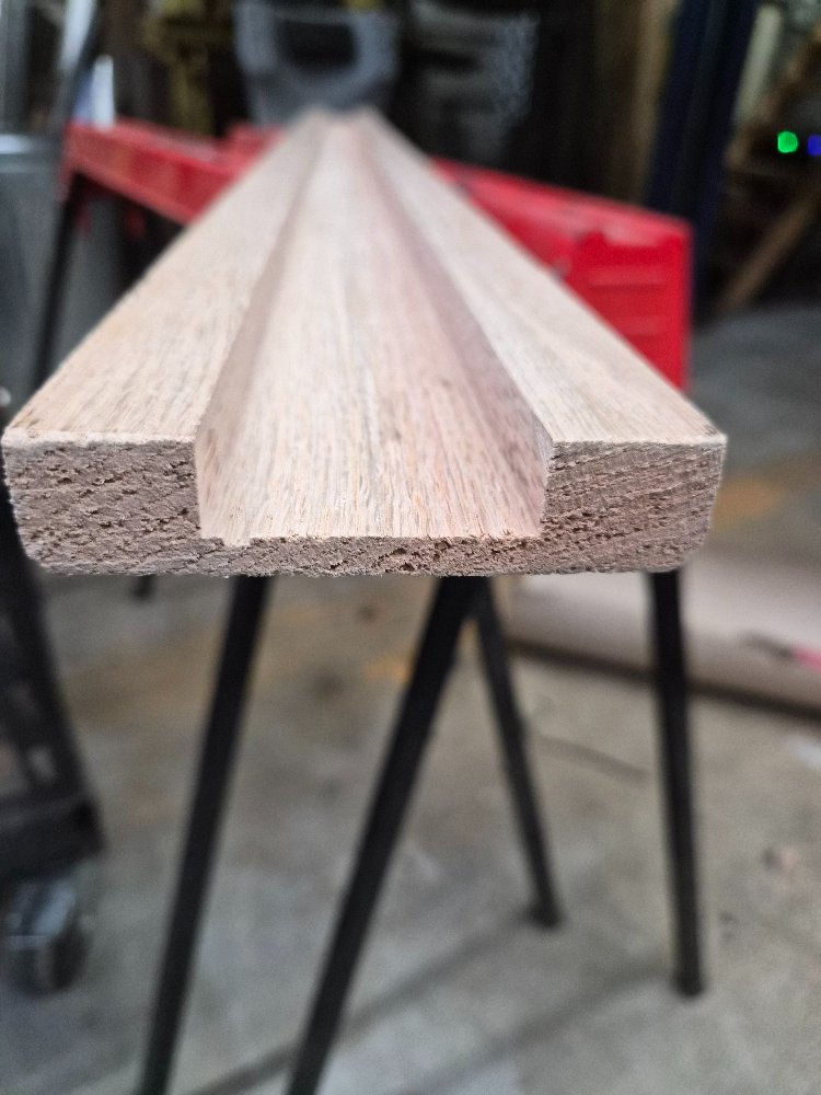

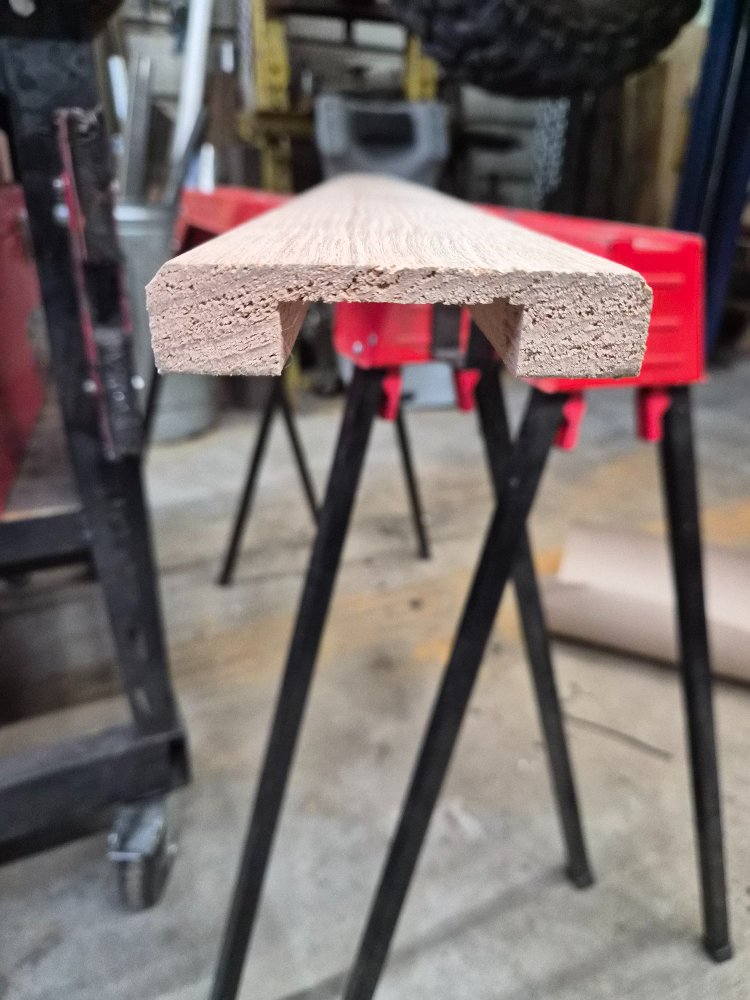

Notched wood, stained it and installed using velcro so I can remove if needed
