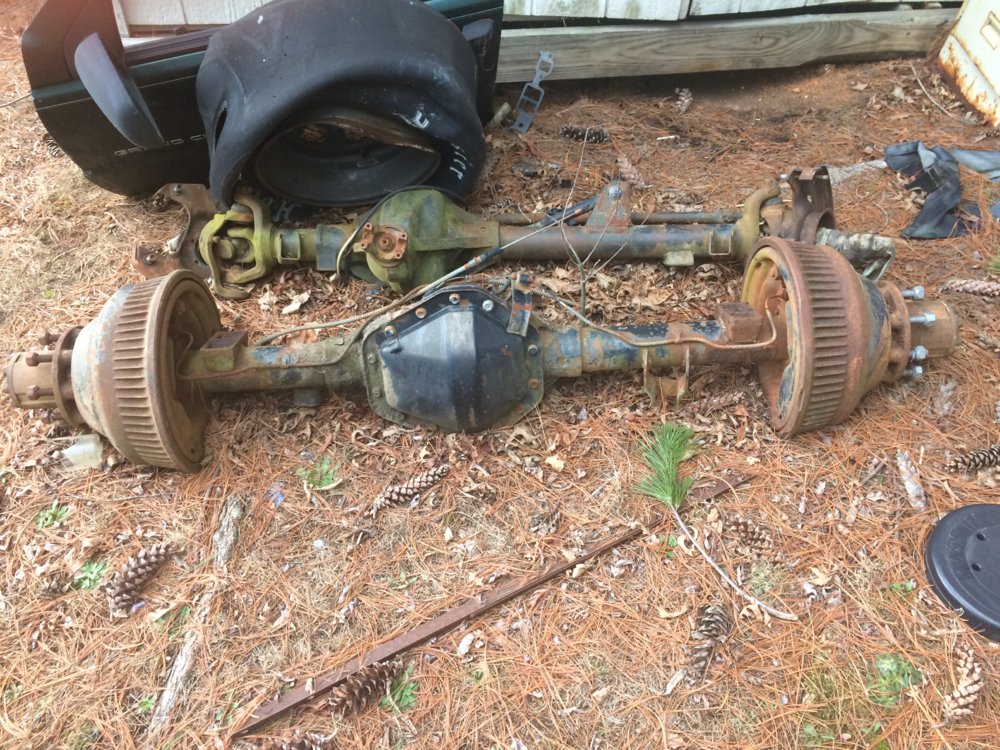

Here ya go this would solve all your problems... waggy d44/Corp 14ff c&c $300
