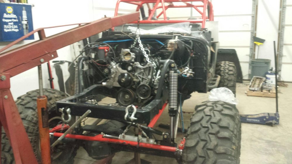

Went and checked this thing out today and I have to say David is doing an outstanding job! I just failed to take any pics of the progress.

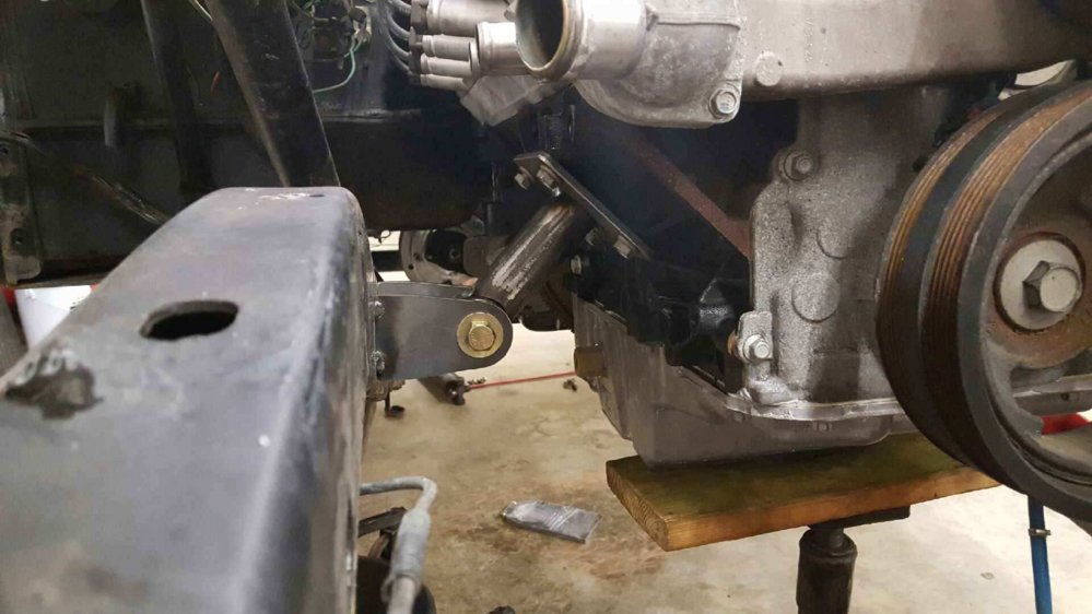

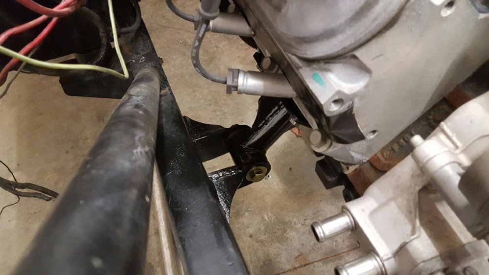

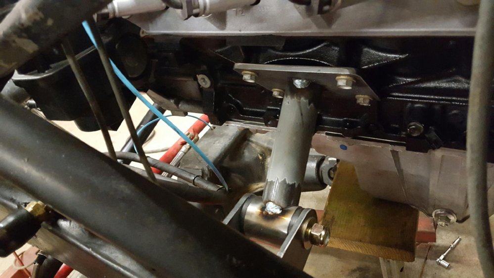

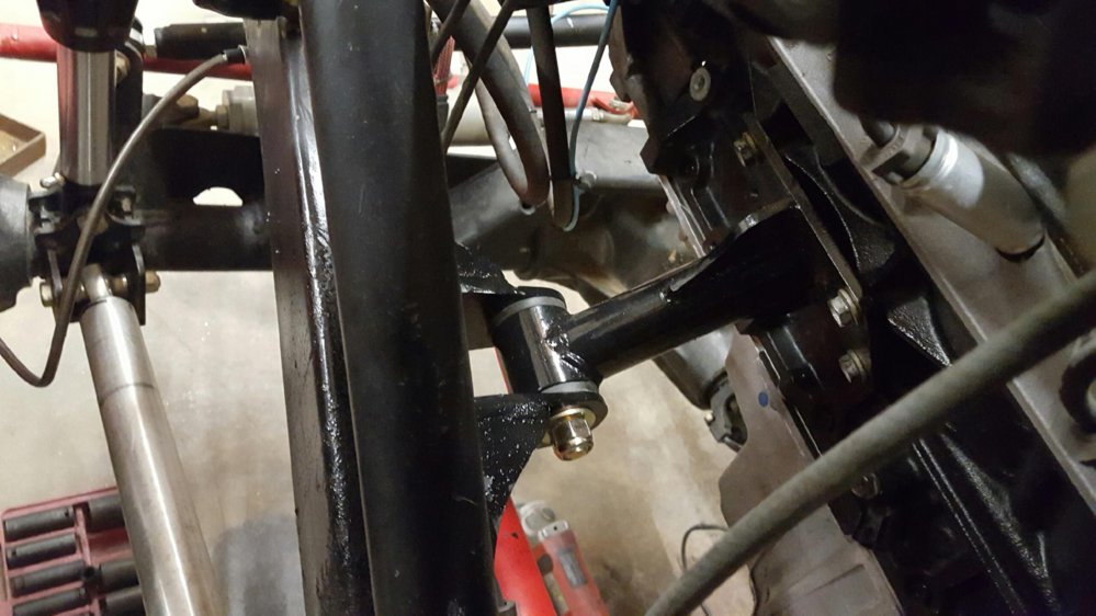

It worked out great to use my original tranny cross member and the atlas cross member and motor mounts turned out awesome.
A week or so on plumbing and wiring and this thing will be ready to fire. I can't wait!!

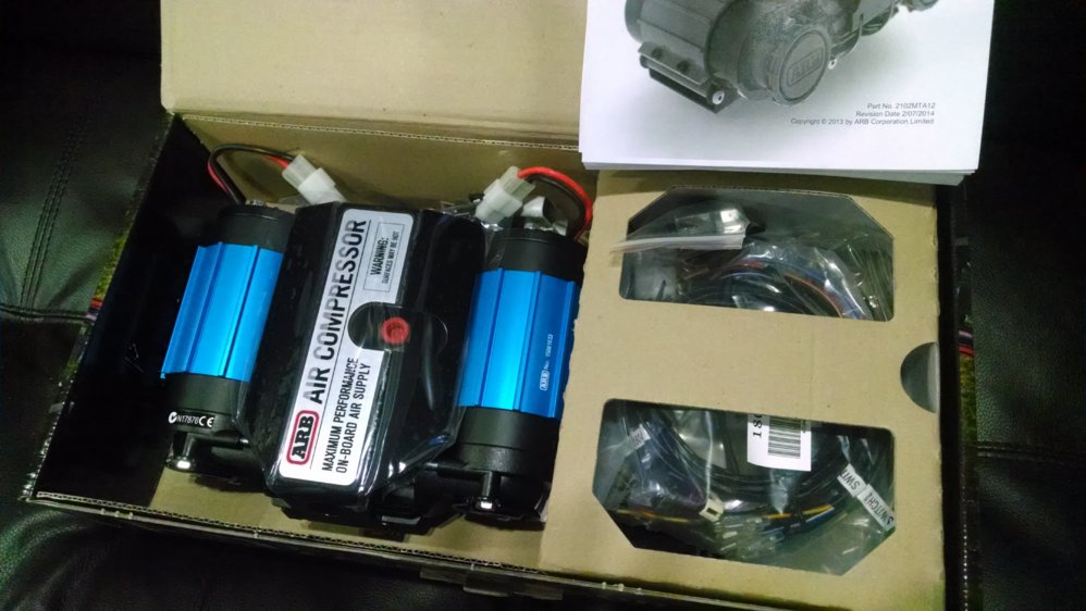

Since I'm changing engines I couldn't use my york210 compressor any more so I had to go a different route. I decided on an electric pump and I definitely wanted it to be very reliable since I run an ARB locker so I decided to go with an ARB dual compressor. I'm hoping it will give me many years of good service. Now I just have to find a place to put it.

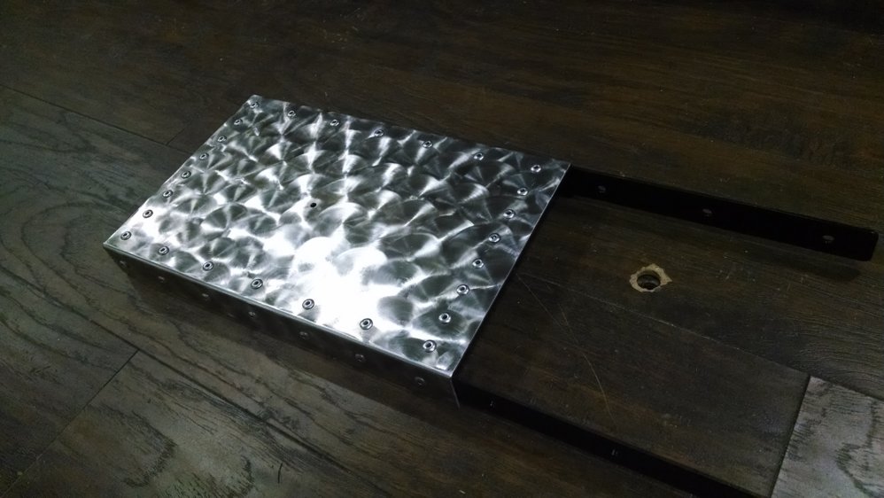

Shifter console completed! Just waiting to cut the hole for the shifter and install it. It will bolt directly to my security console. The cable will need to run through part of the security console.
Hope it looks good in the jeep. I'm not sure.

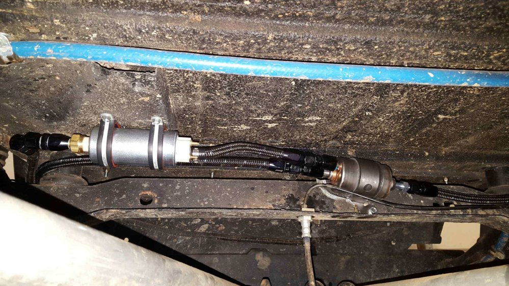

Fuel system is complete and the wiring harness is almost complete. ECM and fuse block are mounted! Hoping to hear it fire this week maybe.

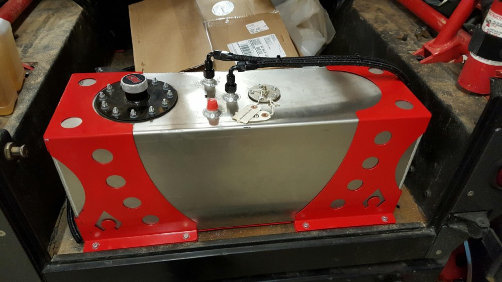

just getting back on here, didnt check the date of last post. was hoping u was meaning fring it up this week. lol . where did u get the fuel cell brackets
Artec
Yeah they are artec brackets. We just welded a piece between the lower pieces hoping to cut down on movement that has been breaking welds on these type of tanks.
Did you call them and get the inner-lined tank? I also think baffles can go a long way in preventing cracks.
