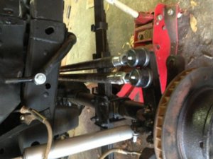

Added my Hi-steer links yesterday and mounted my drive front shock and brake line . Now just got to pick up a reamer from a buddy after work for the stock pitman arm .
