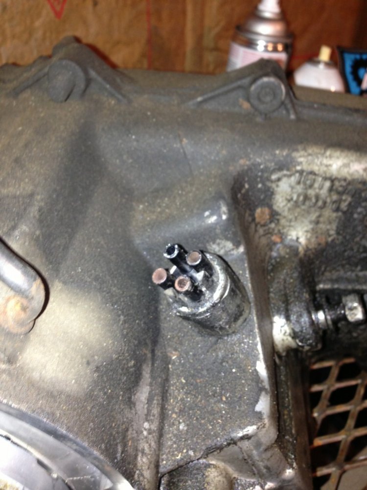

Not a lot done lately cause of Xmas . Pulled the t-case out yesterday and ready to put in the slip yoke eliminator kit. Question , what do you guys do with the vac port in the t case ? Cap it off ? And can I just pull all that vac lines off and chunk them

Not a lot done lately cause of Xmas . Pulled the t-case out yesterday and ready to put in the slip yoke eliminator kit. Question , what do you guys do with the vac port in the t case ? Cap it off ? And can I just pull all that vac lines off and chunk them View attachment 58493
you can just leave it in. I capped my off in th epast, but no real reason you have to. Looking good on the build.
