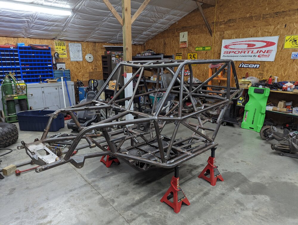

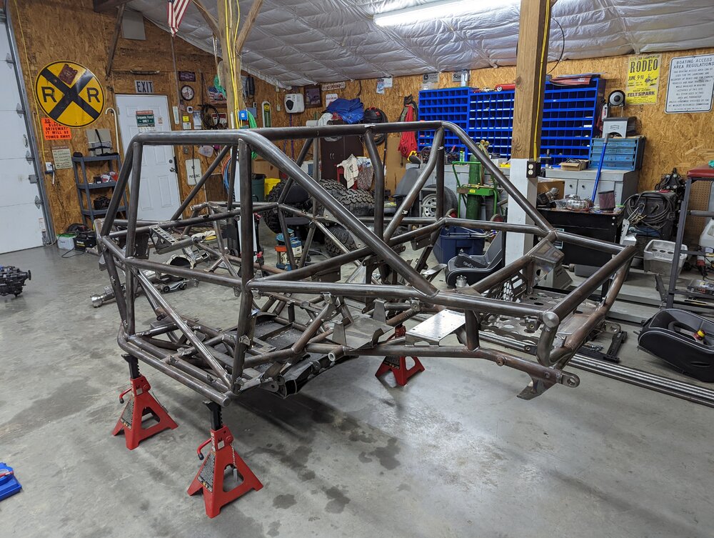

The next couple days will be spent cleaning up my shop so I have enough room to start tearing the buggy down and get it ready for paint.
Please ignore how badly my trailer needs a fresh coat of paint.

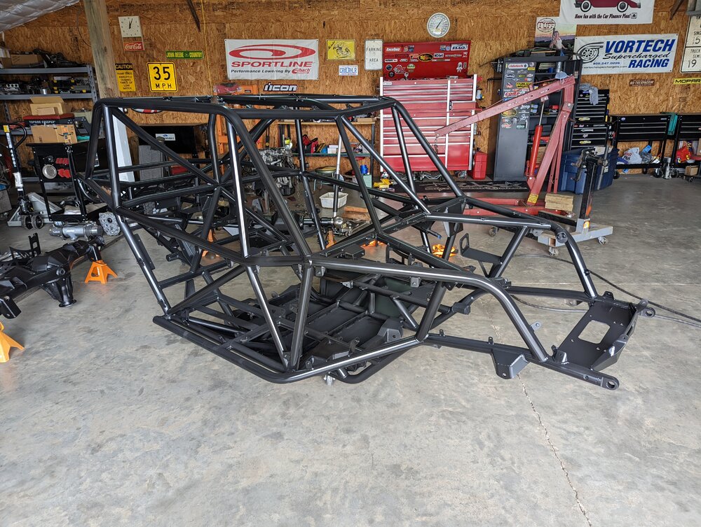

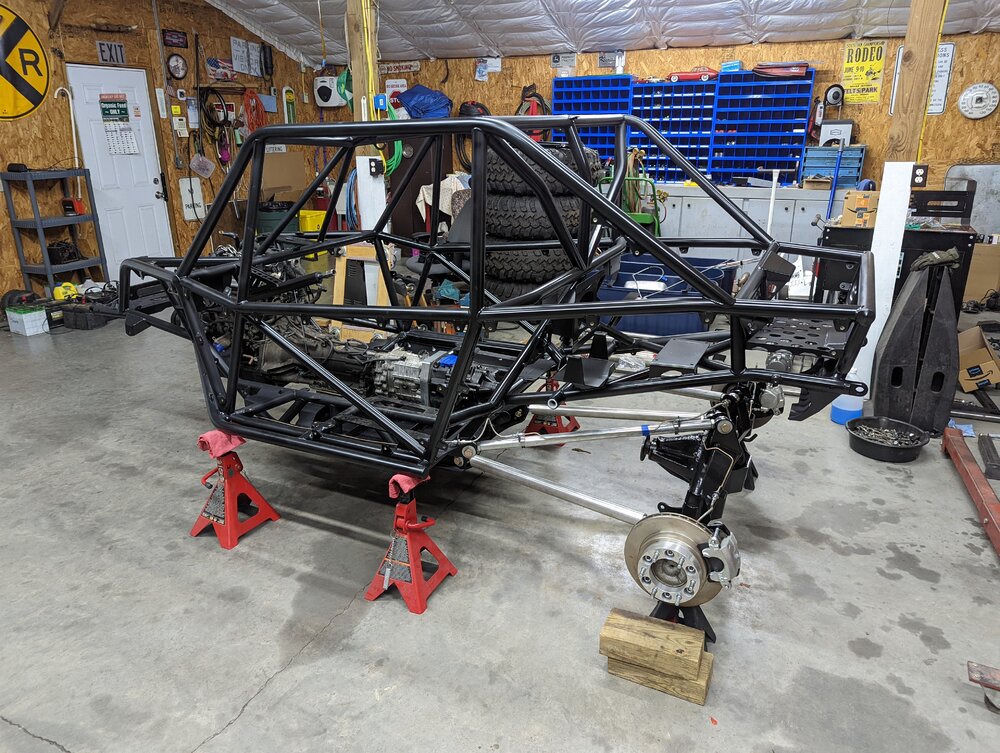

Finished getting it down to the bare chassis today. Got a paint booth lined up in about 3 weeks, got a buddy that's going to paint it. Hopefully get a decent amount of other stuff done between now and then, build the Yota t-case, rebuild the air shocks, replace some gaskets and seals on the engine and trans, etc.
Black epoxy primer from SPI, nothing special. Wanted something that I could touch up easily with semi-gloss black spray paint.
That was the first and last chassis my buddy said he would paint. Took him much longer than he expected.

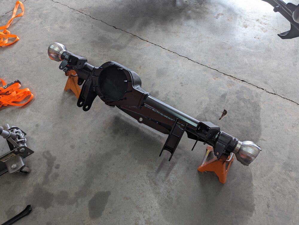

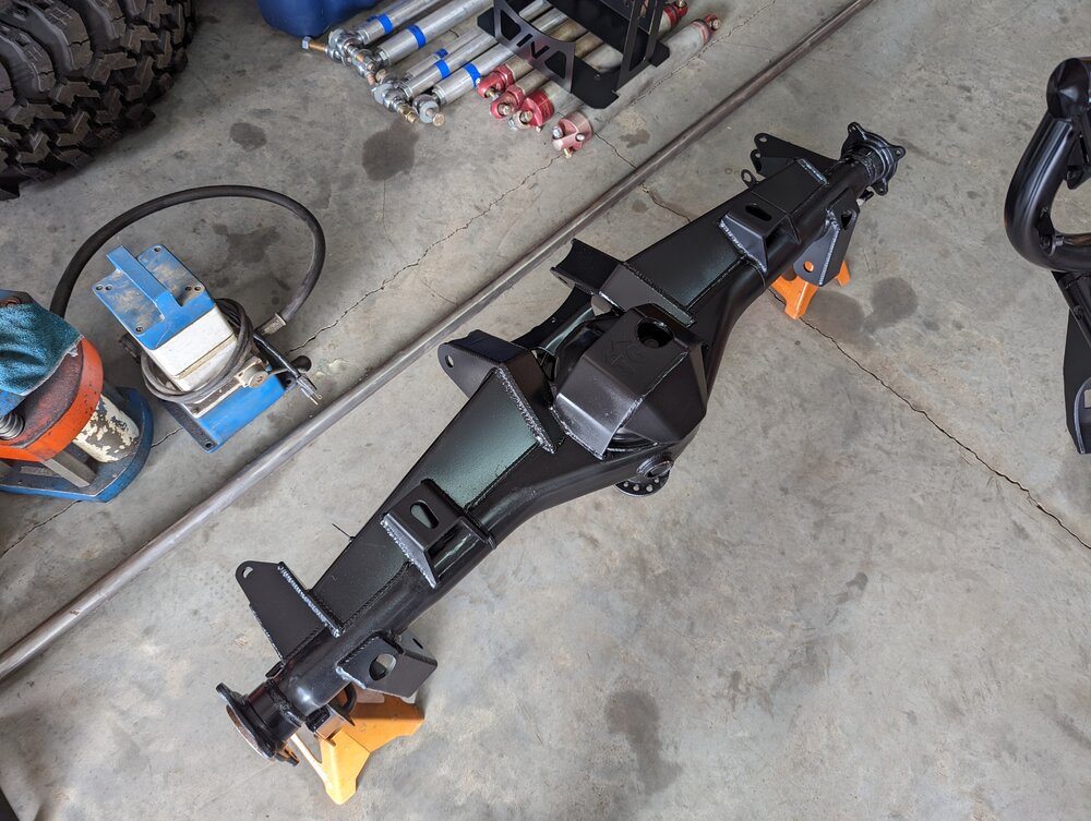

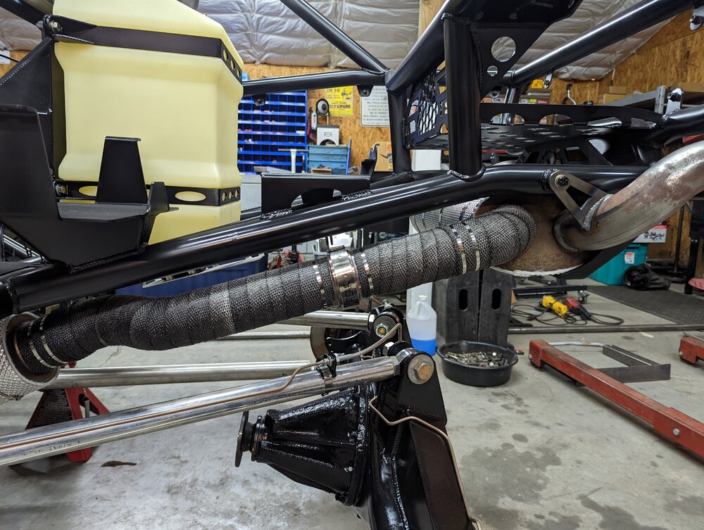

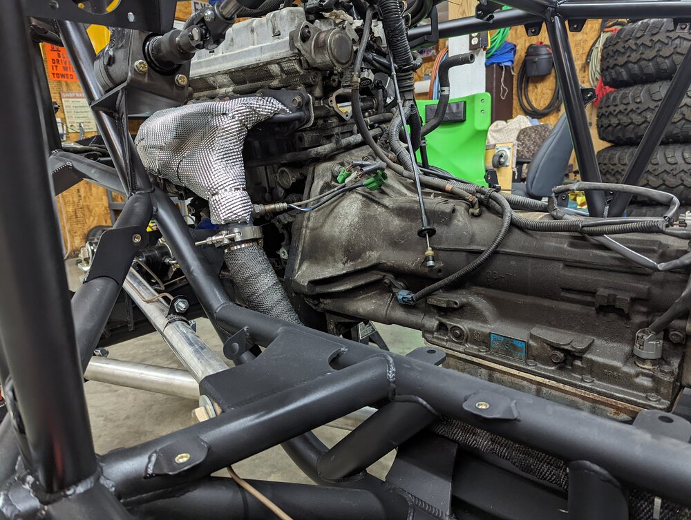

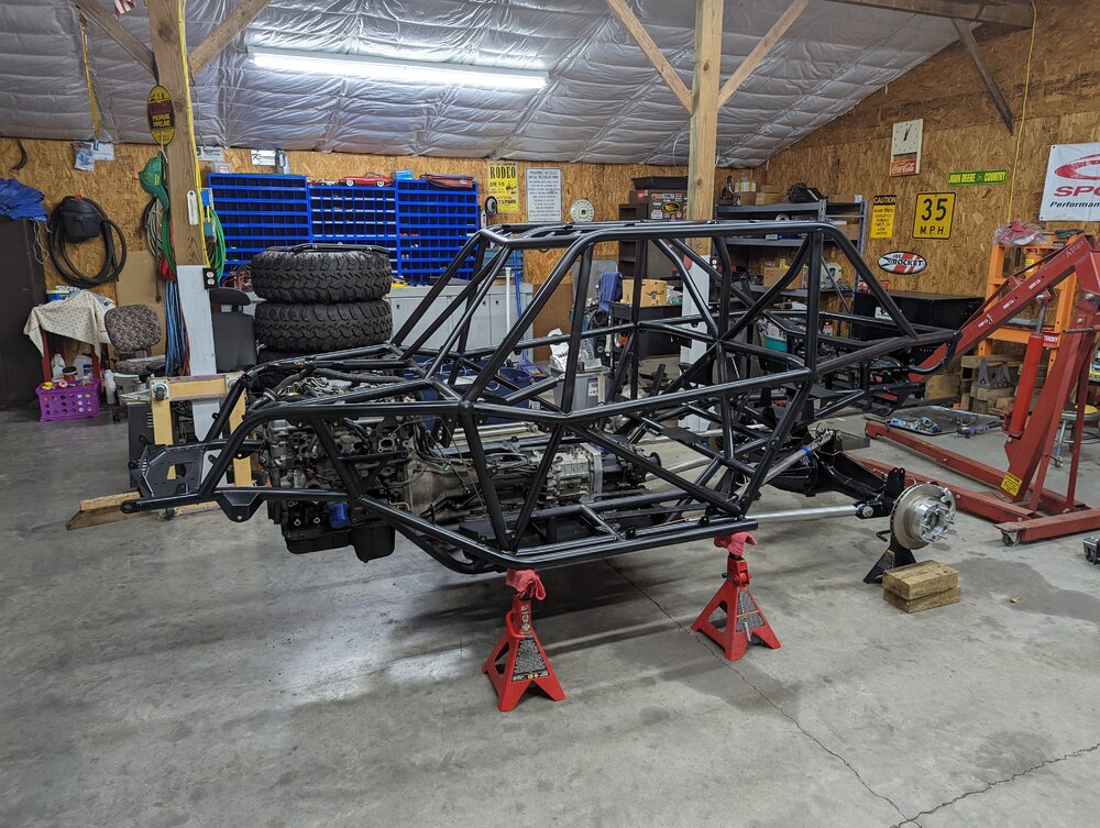

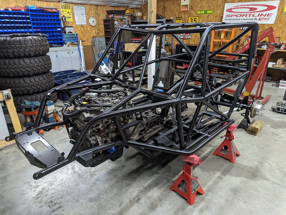

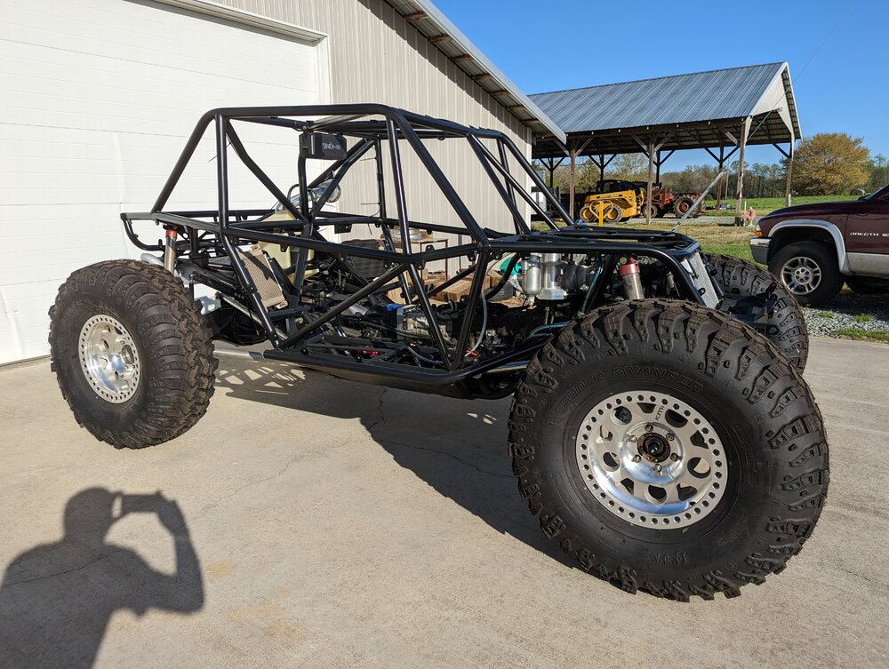

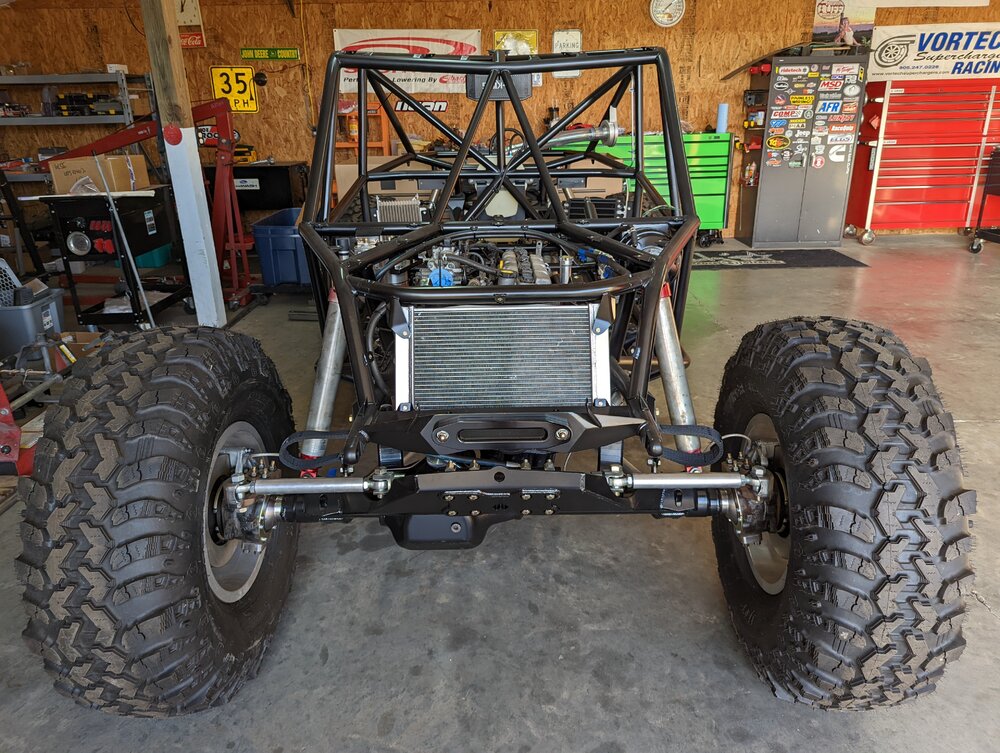

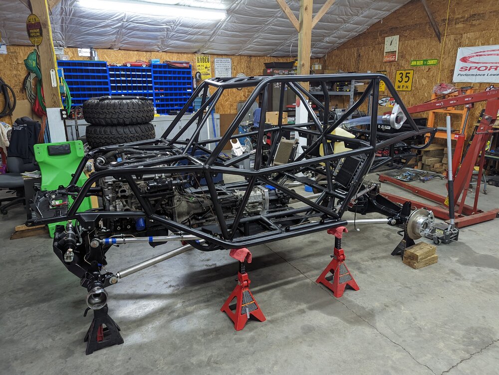

Little bit of progress. Drivetrain is back in the chassis, just need to replace the oil pan gasket but that will be easier now that it's mounted in the chassis. Rear axle is in and rear brake lines are on.

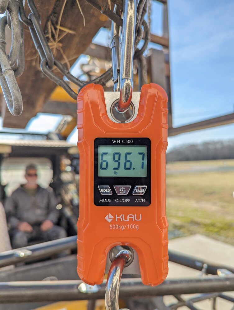

Rear axle complete minus the calipers, caliper brackets, rotors and spacers was 172 pounds.
We’re you able to get it all back in without many scratches?
The belly got a few, it's harder to put the entire drivetrain in with the engine hoist compared to your gantry but we got it. Absolutely a 2-person job to get in and out with the engine hoist, the rear t-case gets hung up on the belly support ribs a lot. In the future when if the engine has to come out, I think I'm going to try separating the t-cases and just pulling the engine and transmission just to see how it works that way.

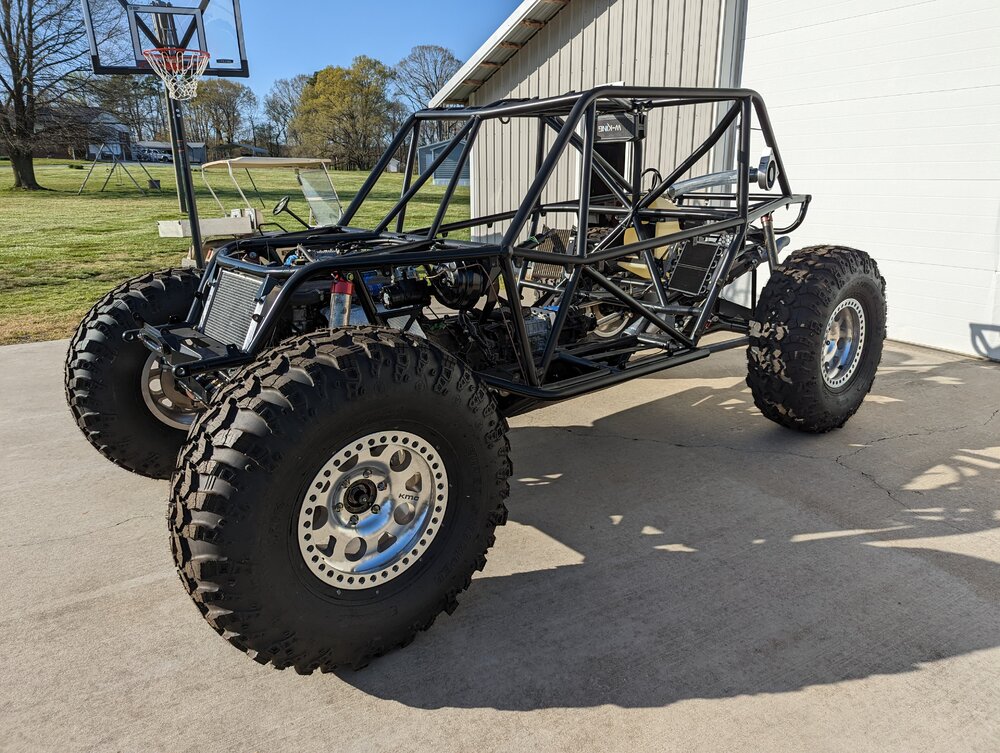

Slowly making progress. Hopefully putting fluids in everything this weekend to start checking for leaks. Vinyl wrap for the panels came in this week. Biggest hurdle left is wiring, @DirkaDirka875 has helped me on that but still have a bit left to do. I'm on a timeline though, our daughter is due the 24th of August, so I've got to have the buggy done, do a couple small shakedown trips and hopefully get out at least once on a big trip somewhere before the little one shows up.

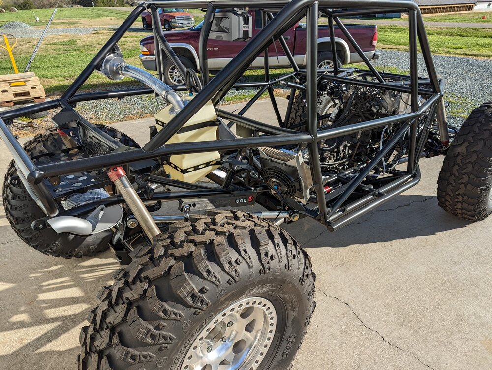

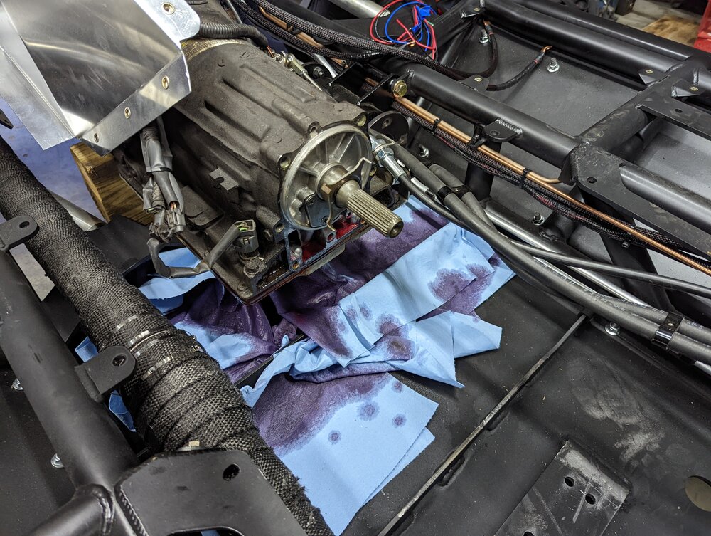

Had a couple setbacks after adding fluids. Had a big transmission fluid leak that was my fault. Couple years ago when I changed from running a Sami t-case to the doubler setup, I pulled the tail housing off the transmission and I never replaced the gasket. And I just forgot about that after all that time had passed. So I had to pull the doubler and order a gasket that came in today, so I'll have it back together this weekend.
Had a couple minor leaks from a few brake fittings and a couple small coolant leaks but nothing serious.

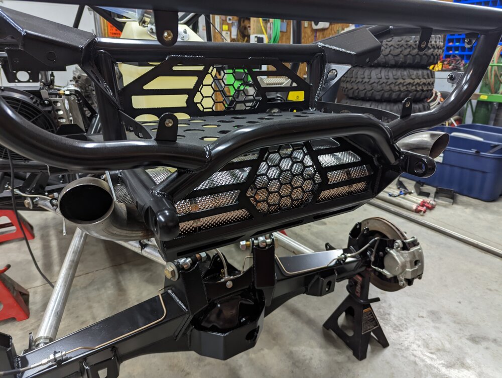

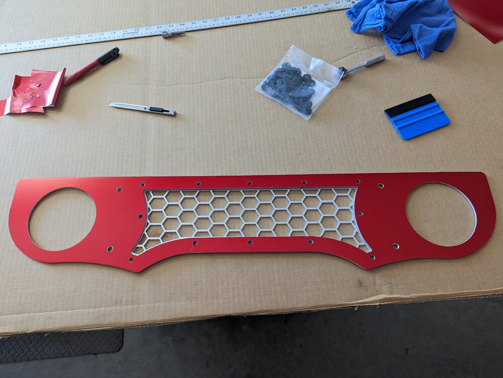

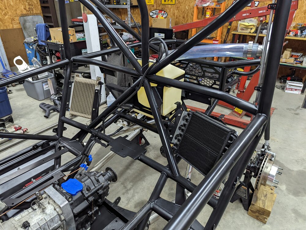

I did get the vinyl in for the body panels. Did a couple small pieces to see how the color looked and to get the hang of installing it. The honeycomb section is painted black now, forgot to take a picture of it afterwards.

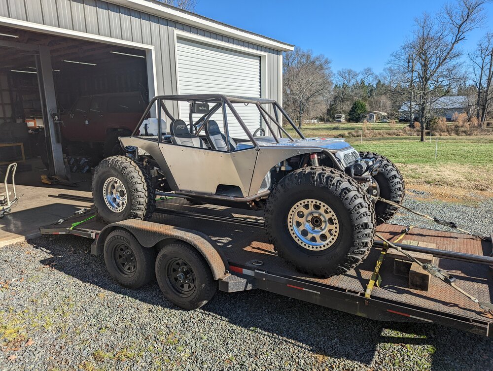

Thanks to @DirkaDirka875 for doing all the wiring. It runs and it drove on and off the trailer when I brought it home.

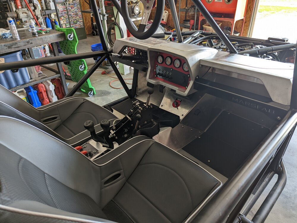

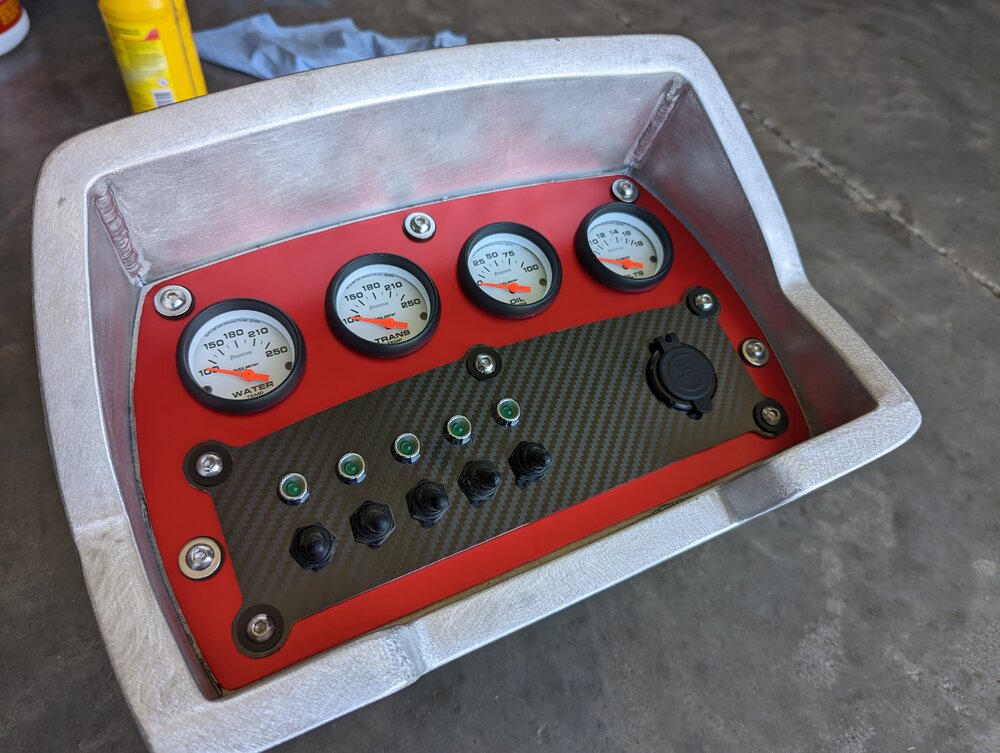

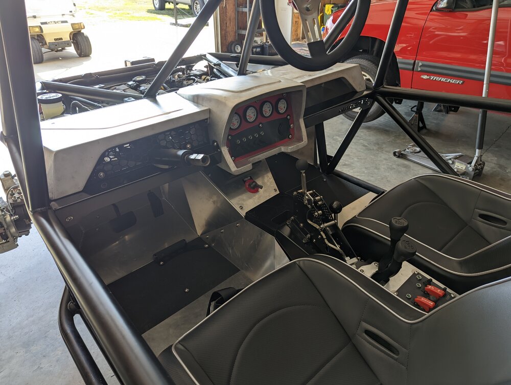

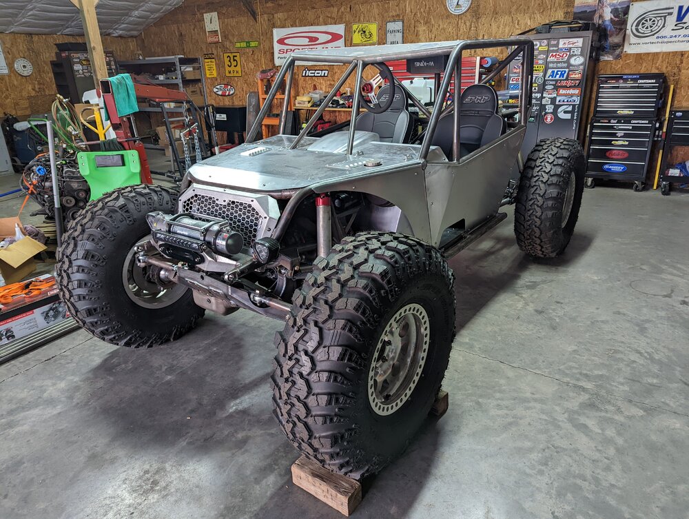

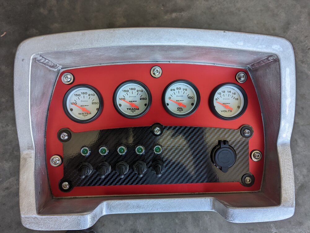

Been working on it when I have some free time since I got it back. Interior is back in. Plan to paint the dash but that will wait until this winter.
