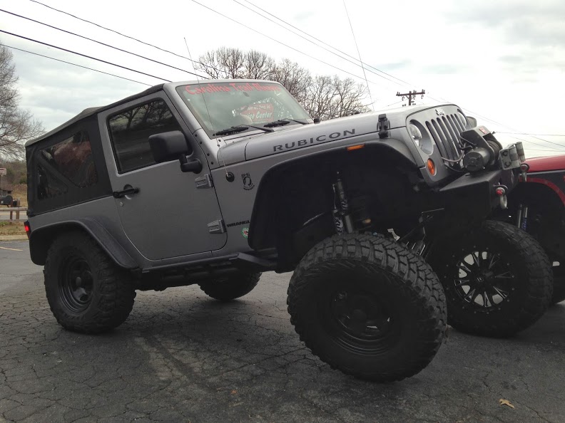

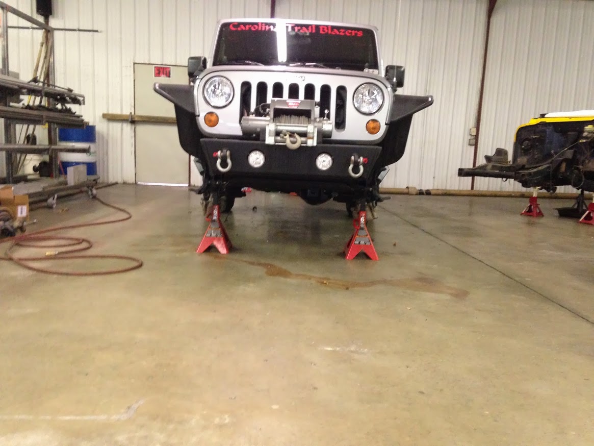

Added new springs to the front for an additional 1.5" of lift to get rid of some of the rake.
alh6.googleusercontent.com__a8wO5SQa_ng_Uq8C2eIupOI_AAAAAAAACGo_1maQ_F0kwDo_w1165_h874_no_JW_JK1.jpg

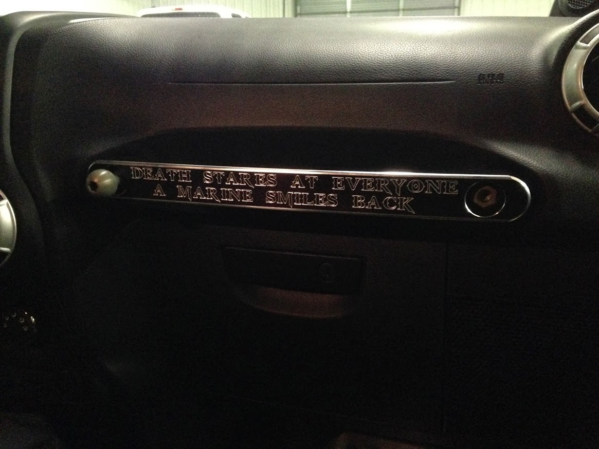

Added a custom grab bar.

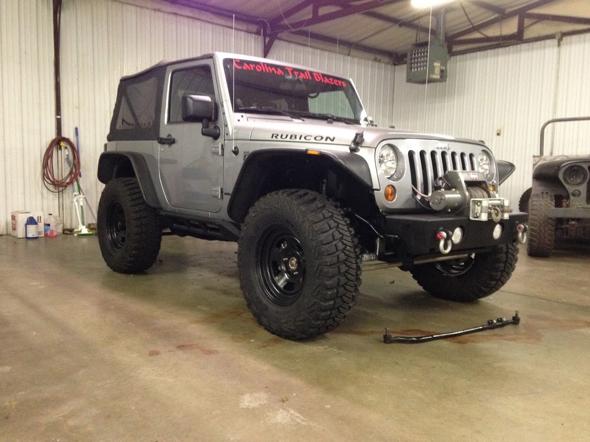

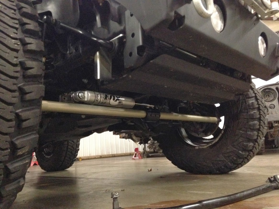

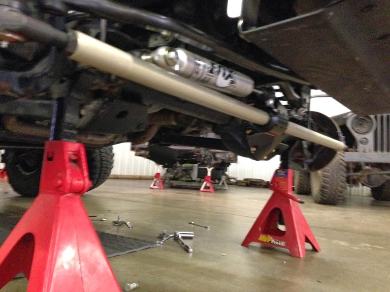

7075 Tie Rod and Fox Steering stabilizer with our 7075 Steering stabilizer / Ram mount
alh5.googleusercontent.com__oQpgMv5wxQQ_Uq8C1QyLtQI_AAAAAAAACGk_m3jPGpOXEIw_w1165_h874_no_JW_JK3.jpg

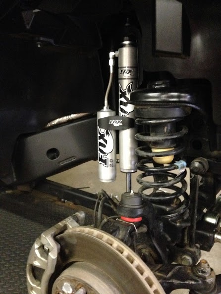

There are also new Alloy USA ball joints installed. We are waiting on some new Fox shocks and a new front diff cover to wrap it up this week. While I have it I'm going to straighten the engine skid and reinforce it also along with building some new front swaybar links so that his sway bar doesn't invert with his added lift and his new longer travel shocks.
Man I cant wait to get it back! Awesome work guys, and that grab bar is just too cool. It looks much better without so much rake and I am sure its gonna drive a whole lot better, this will complete my front end as far as the axle goes. Might throw some cromolly shafts in the rear first of the year. This will be the setup that I will run for quite a while, until later down the road, then maybe 2.5 rockcrawler, 5.13s and 38,s but that is pretty far away.

(Looking good Jason. I like that new beefy tie rod! ) qoute
I seriously doubt I will ever need another one, that's for sure.

-Fox 2.0 Ressi Shocks
-Fox 2.0 steering Stabilizer

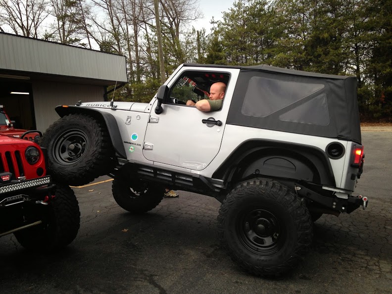

And one happy Jeeper!!!!!
alh6.googleusercontent.com__HMPI4f11Bs4_UrYYZ_n53FI_AAAAAAAACJA_4_k5QiuH5WU_w792_h594_no_JW_JK_4.jpg
alh6.googleusercontent.com__AlZ0lY_reag_UrYYhWLtcLI_AAAAAAAACJY_Ms7csn0CEio_w792_h594_no_JW_JK5.jpg
alh3.googleusercontent.com__gyDGYmnbDdQ_UrYYgo4Hw0I_AAAAAAAACJM_PtDp7fKeRZ0_w446_h594_no_JW_JK2.jpg
alh4.googleusercontent.com__JcFr_Ds4PaE_UrYYg2RxsvI_AAAAAAAACJU_wI8gxabo3e8_w792_h594_no_JW_JK3.jpg
alh3.googleusercontent.com__InpB9IT50NM_UrYYZDr9DPI_AAAAAAAACI8_MlyG222f5ws_w446_h594_no_JW_JK.jpg
alh5.googleusercontent.com__WjClfSJoCh8_UrYYYpc7t8I_AAAAAAAACI4_LeeoIsg1qLo_w792_h594_no_JW_JK1.jpg
Just got it home and what a huge difference all this work has made, steering feels tighter than it did new and rides awesome. I should have done all of this last year before I got to the point of driving bad. If you are in a Jk and just starting to build it up, do not ignore your steering and ball joints, they will not last long.
