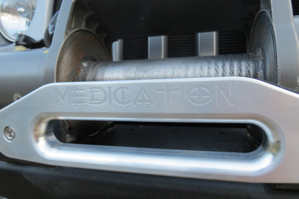

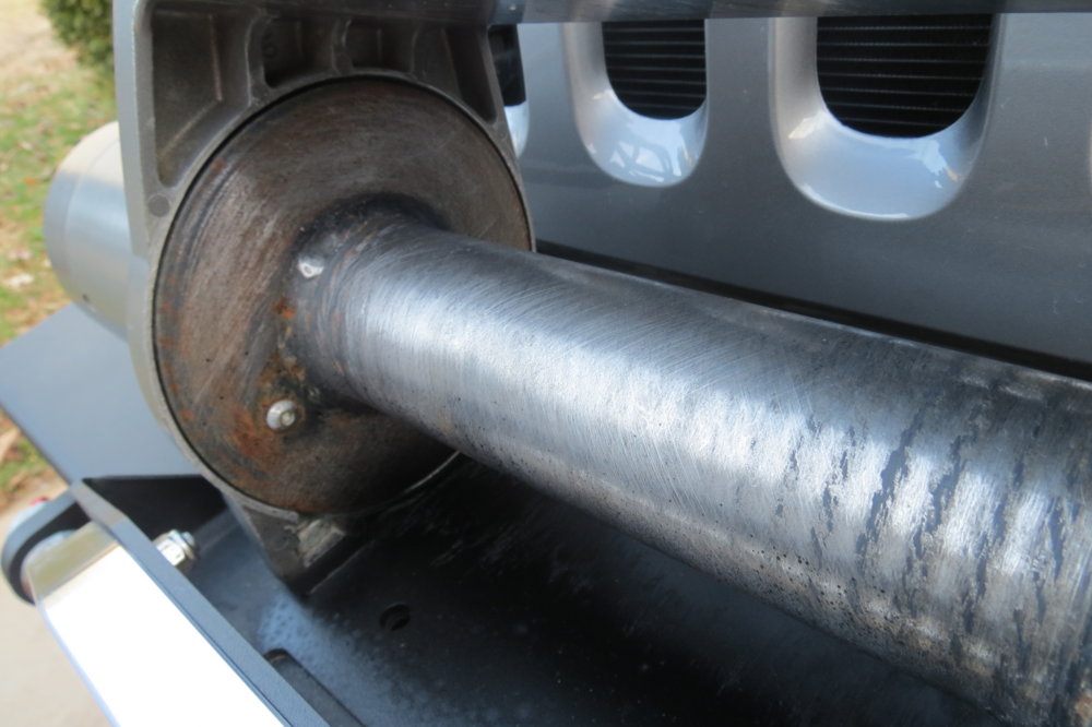

Winch line upgrade time, Ive put it off long enough and the whole safety aspect of it is what finally made my mind up to change too synthetic line. The wire rope on it already had a few kinks in it and that was the second round of wire rope. Took all the wire off and sanded the heck out of the drum to remove all burrs, it really wasn't all that bad surprisingly.
Carolina Metal Masters hooked me up on a custom fairlead as well, turned out really sweat, rope will be here Tuesday, I have 202 class Saturday so I have got to get it on before Friday.

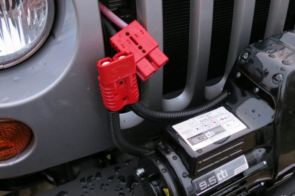

Few other things done, come up with a set of quick disconects for my winch leads, I have allways been wary of something happening(stuck selinoid) or something else that I could not stop my winch. These are SB175amp conectors comonly used on electric forkilfts, I deal with these every day, they are tough and very easy to use.
Do those have any issues with corrosion? New winch looks good. You'll have to let me drive your Jeep to get it stuck and try it out.
I have lifts that they run in and out of freezers all day and some in chemical plants, very rare for one too fail with corrosion.( and thier inexpensive)
