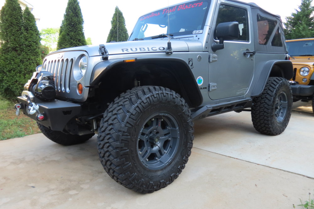

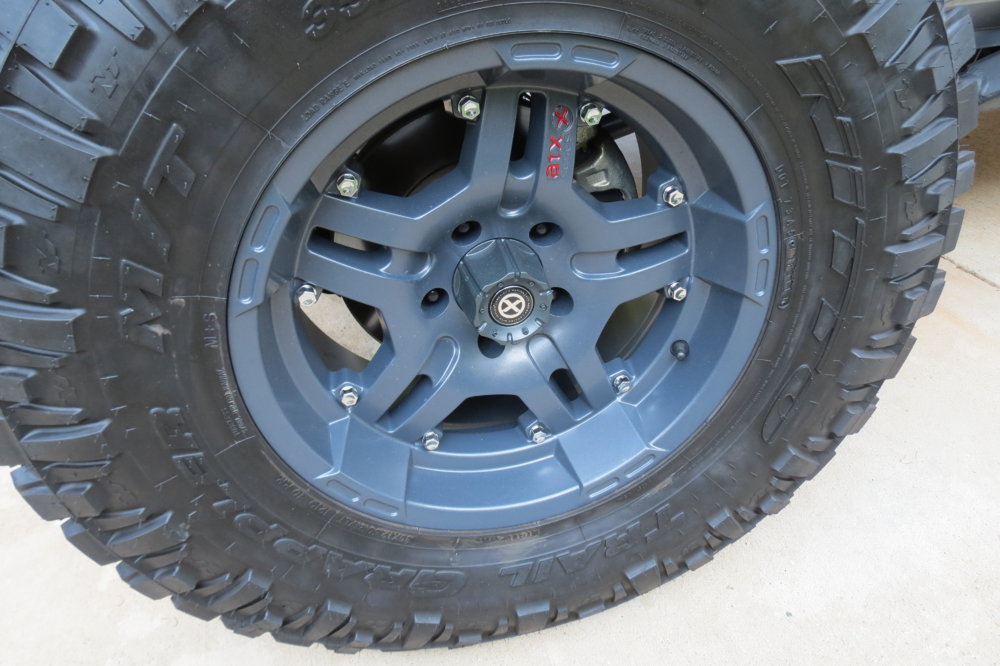

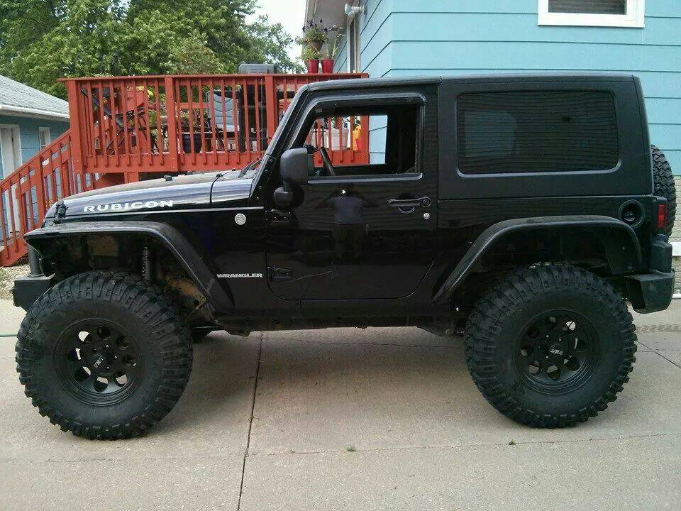

A little change, I allwys felt like I had weird vibes at certain speed, I knew my tires were well balanced but was allways weary about my steel wheels. Since they were knew I noticed that the manufacturing looked rough, welds were rough, lug nut seats looked oblong. When I origianlly bought them my thinking was go steel, there tough and cheap. I bit on a new set of ATX artillery wheels in teflon grey, and what a big difference on the highway, no more weird vibes and got a little more mall credibillity too.
Lesson Learned!
Leaving for Moab in a few weeks, a while after I get back I am going to finish my lift. Currently I have 4dr front springs with a 1 inch spacer in the front, and 1 inch spacers in the rear. Going with the Rockcrawler 2.5 x factor, this lift will be full control arms and progressive springs, I think it will suit me best and will ride nice. My current shocks will work with it just fine.
Looks nice. Your new lift going to be long arms or short arms? You are on 35s right?
Looks good Jason. I can't wait to finish up the lift. We need to keep in mind lead times. RK is running about 3 weeks right now. It used to be 5-8 days but they are now saying 15 days.
I will be sure to call as soon as Im ready to take the plunge.
It will be standard jk mid arm, fourtunatly Jk arms are longer than the Tj arms are, no real need for long arms.
Cool, didn't know that, I am ignorant about JKs :)

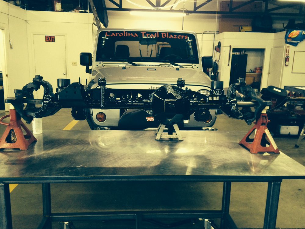

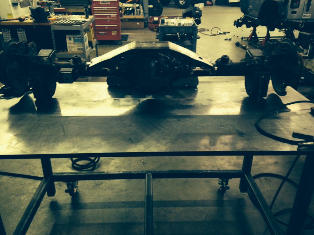

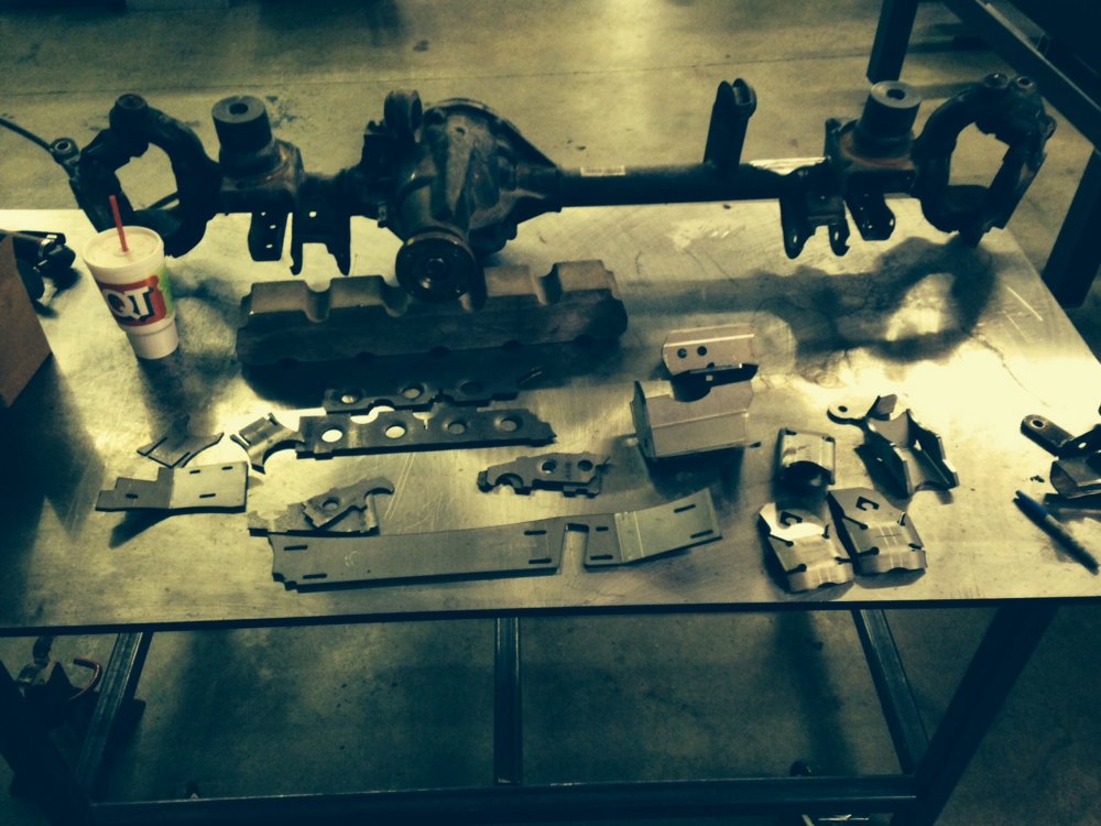

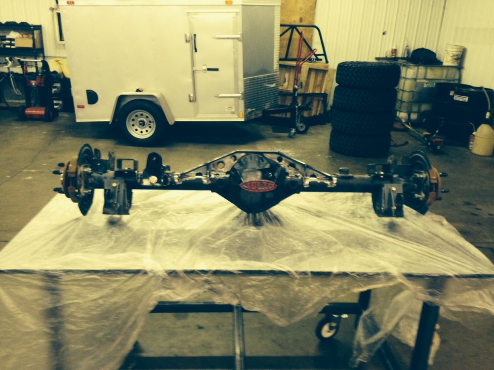

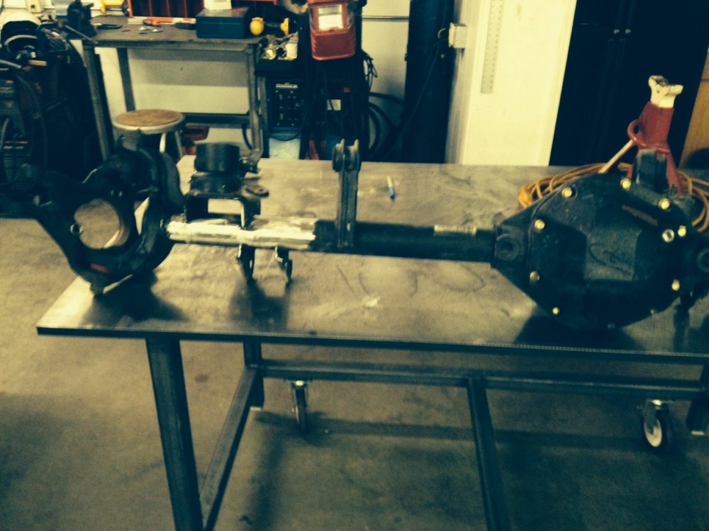

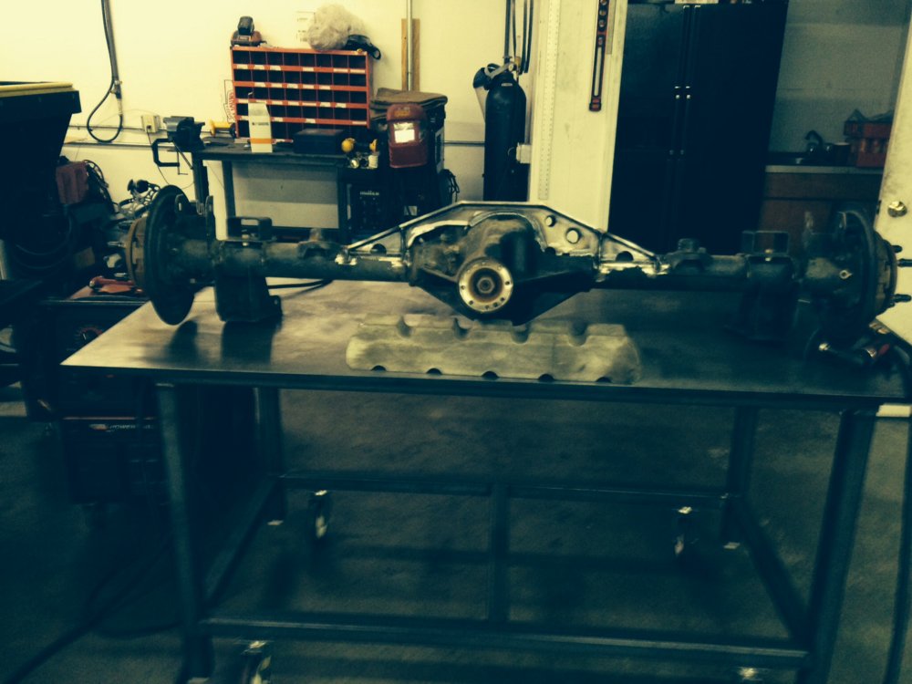

I think I have got the details of what I am going to do to equip for 37,s, and thank to Carolina Metal Masters for helping me hash it all out. Here,s how it looks so far.
37x12.50x17 Nitto Tral Grapplers
Rock Krawler 2.5 x factor, with rear trac bar(front is allready done) rear pushed back 1 inch
Artec truss front and rear
Chromoly shafts rear(front is allready done)
Antirock sway bars front and rear
5.13 gears
Adams Ballistic driveshafts front and rear
Stainless brake lines
Artec track bar bracket
Rock solid performance sector shaft brace
