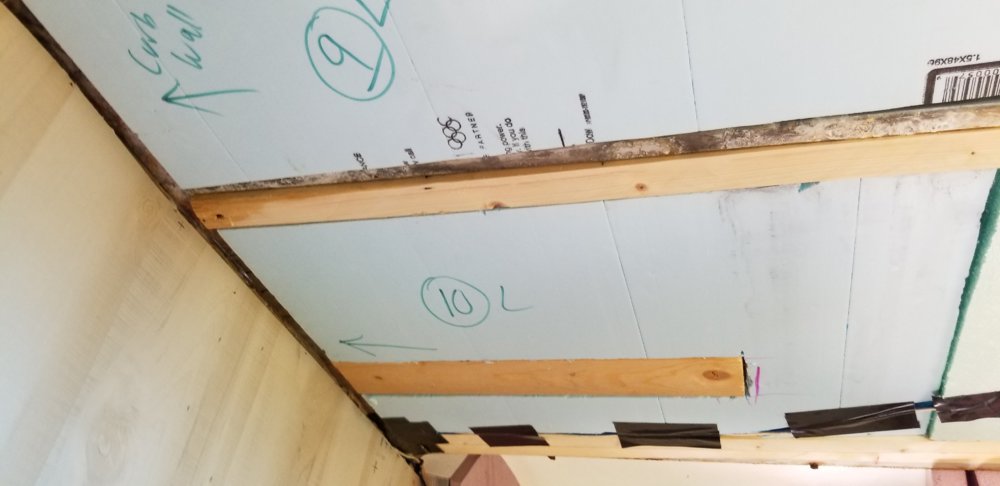

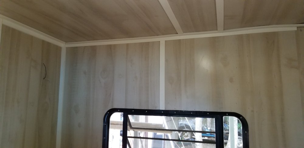

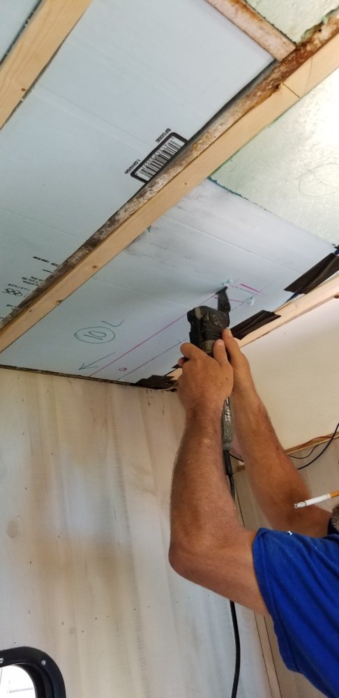

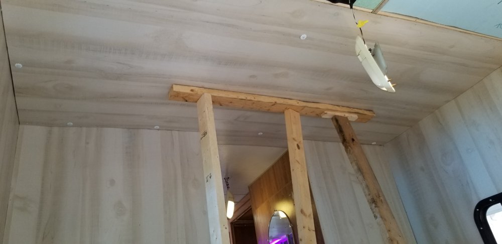

We had already measured and cut ceilings , and were just about to glue and hang them up when I suddenly realized we had not added extra bracing in the ceiling for the ladder mounting points on the roof.
That would have been a mess

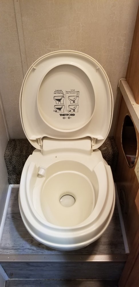

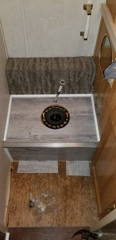

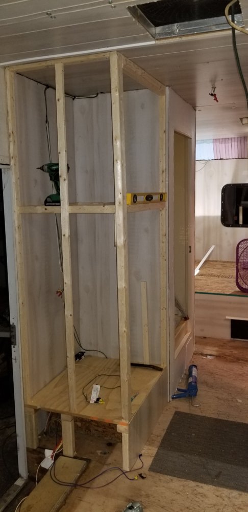

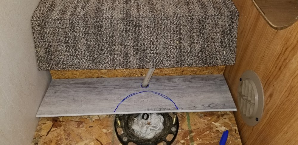

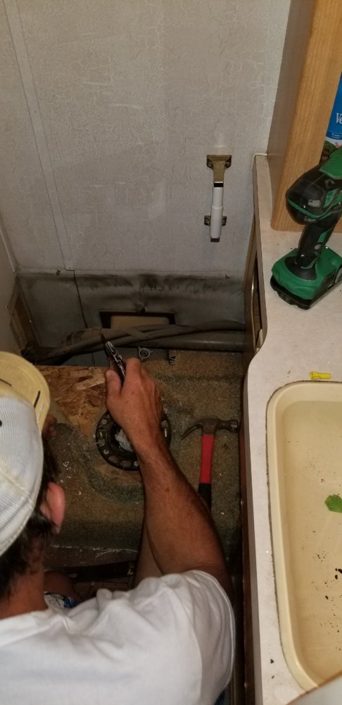

I took out the old toilet and Bobby started tearing out the old carpet that was under and around the toilet.

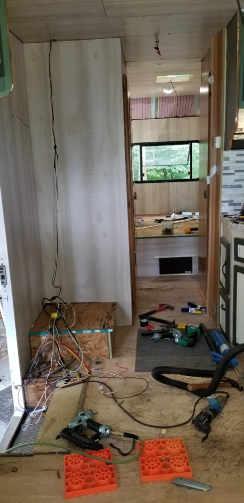

There was a carpet covered wooden thing that covered the back wall and plumbing. After seeing how many staples were holding the carpet to this peice..We tossed it and built a new one.
Then covered it with commercial carpet which will be easier to clean.
Then I covered the rest with new lvt.

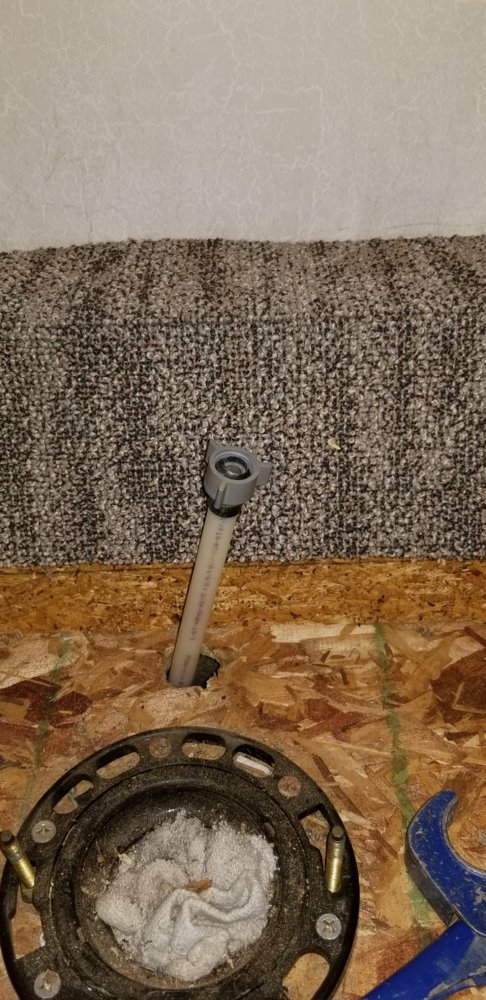

Added some trim , extended the waterline to meet new toilet, added a new swivel and some stair nosing, then called it good.

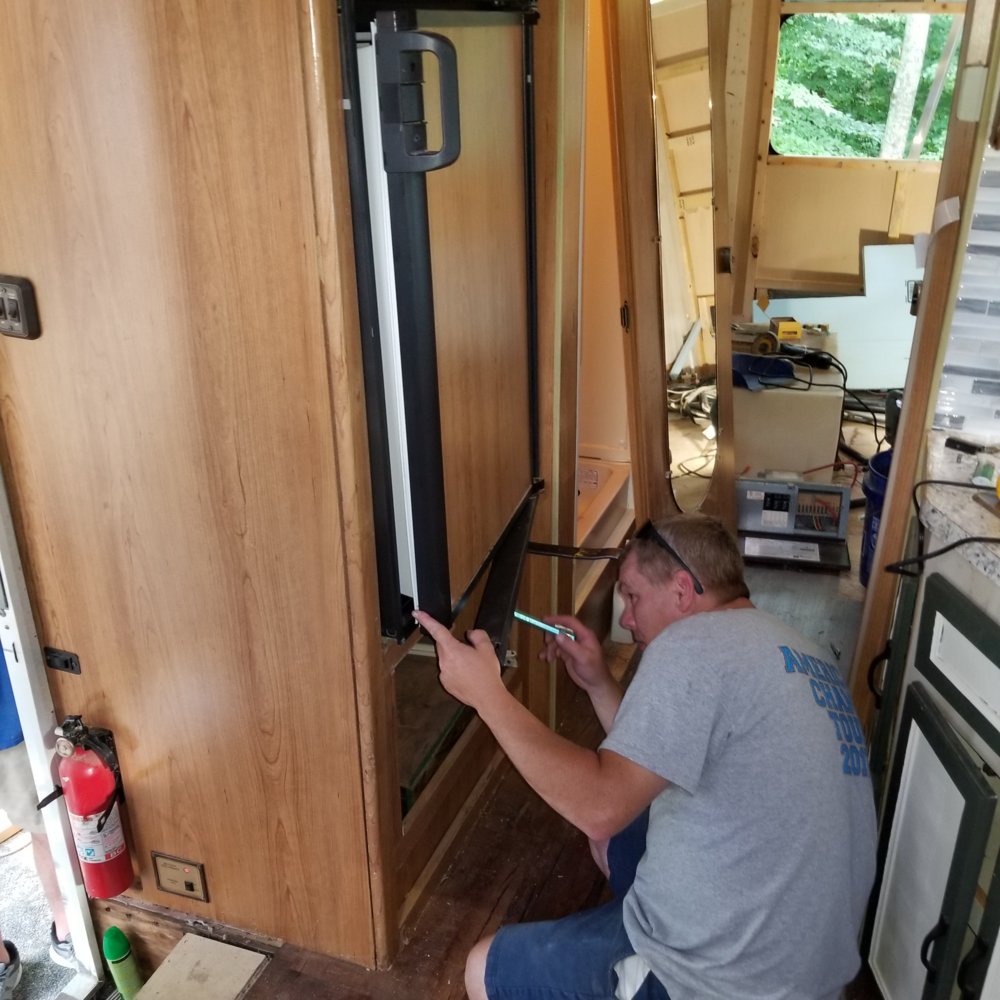

Anyways..Once I had everything in place, and knew what I had to do in the bedroom, but before I had actually done most of it, I started looking into my fridge situation. The old one that was in the rv worked great when I bought it, but seemed to be going on the fritz a bit as of lately. The freezer had stopped working and the fridge was not cooling as much anymore. It might have been a simple fix, but I decided I didnt even want to bother with it. I would just replace it with a new one.
Let's figure out how to get the old one out.

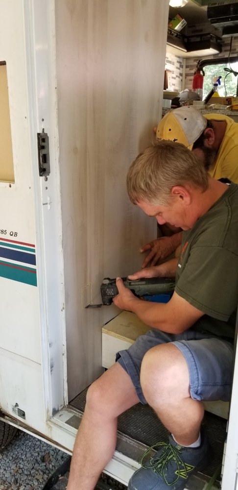

I guess no one took any pics of the pain in the ass process that was fridge removal, but it was very aggravating. This was the worse workday by far. The fridge was dropped, which sent a metal heat shield through the back of the fridge, puncturing the copper and the unit itself. basically rendering it completley useless. Then..the damn thing wouldn't even fit through the door. We needed to remove large window on order to take it out whole.
NOPE. Ain't happening. Sawzall got it out without removing window. (No pics of this)

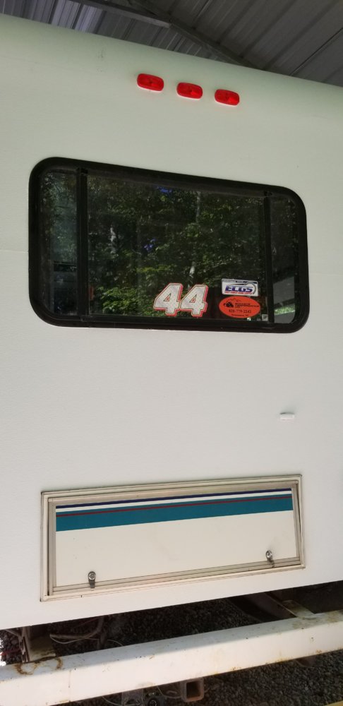

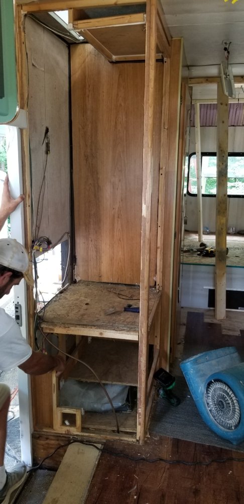

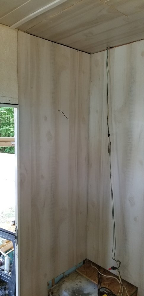

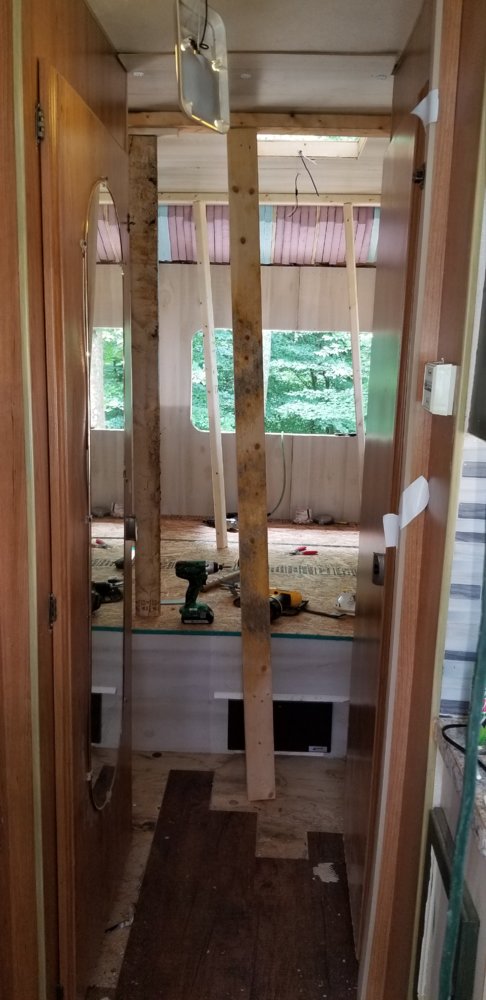

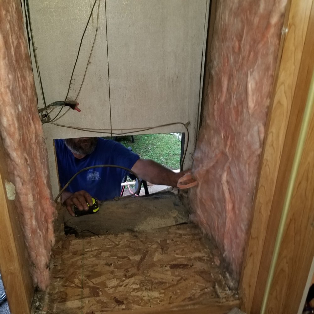

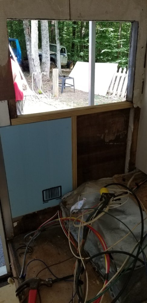

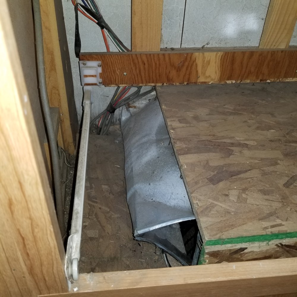

So, this is what it looked like once we removed the fridge. Pink insulation stuck to the walls, lots of bugs( both dead and alive) and 20+ years of dirt and grime. Also, now I have 2 holes to cover. One in the ceiling from the fridge vent and a huge hole in the wall where the fridge used to be.
All of this area below the fridge hole was rotted from where it had leaked through the outside vent.

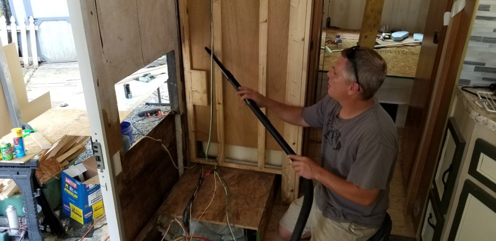

This side wall has to go in order for me to gain hammer access to the wheel well.

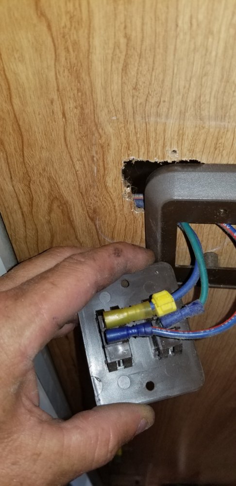

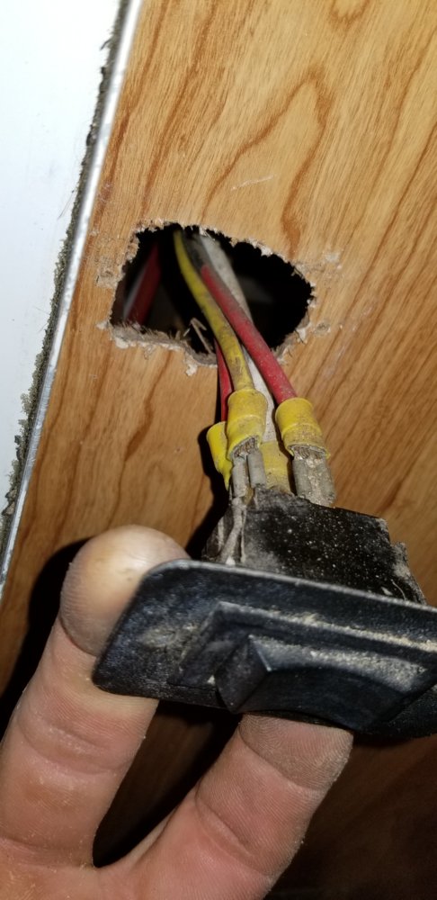

Gotta figure out these switches first.
After that...knocking the wall down was a breeze.
Didnt take long to decide to tear it all out.
I already had a little practice in tearing out rotted walls and rebuilding them, so it didnt take long and we had new walls...again.

Did you figure what the ditch was for? Looks like a momentary switch.

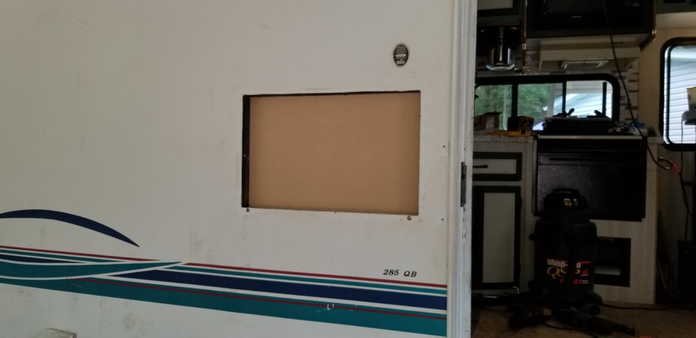

This is the hole in the wall I was talking about.

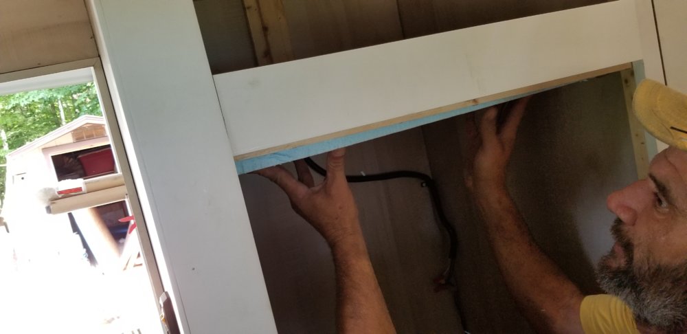

It's all good on the inside, I just need to fill this hole with foamboard and add a patch. I'm still pondering ideas.

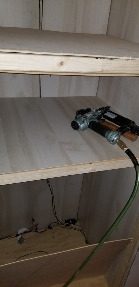

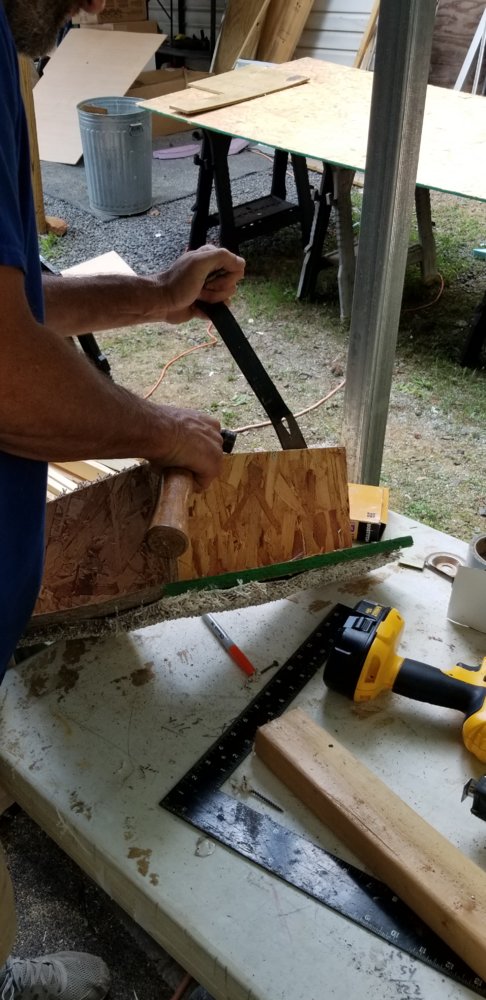

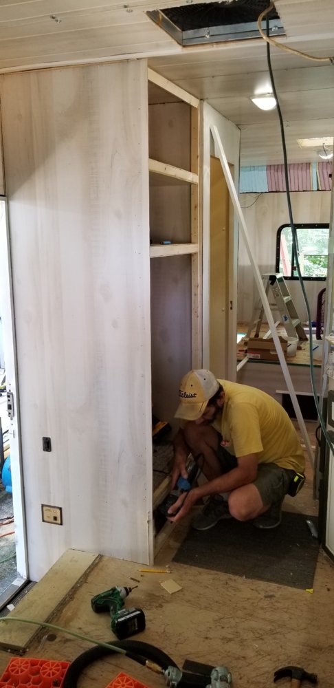

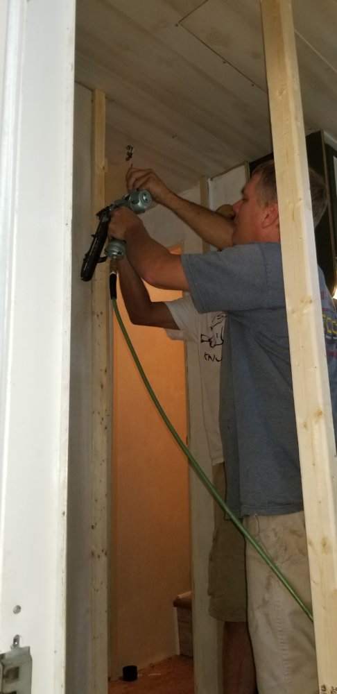

Here Bobby is working on screwing things together.
We've added foamboard in between the panels of the shelf. Now they wont sag.
I capped the shelves with white primed 1/2 inch cabinet styles and added my corner trim.

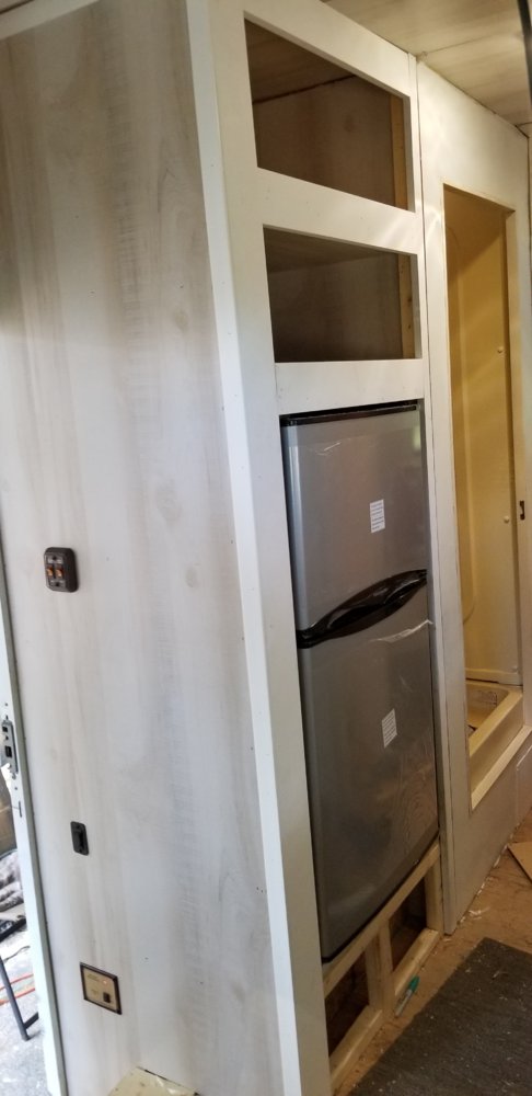

Oh yeah...got a brand new freezer/fridge squeezed in there.( we fastened it down before we added the sidewall)
