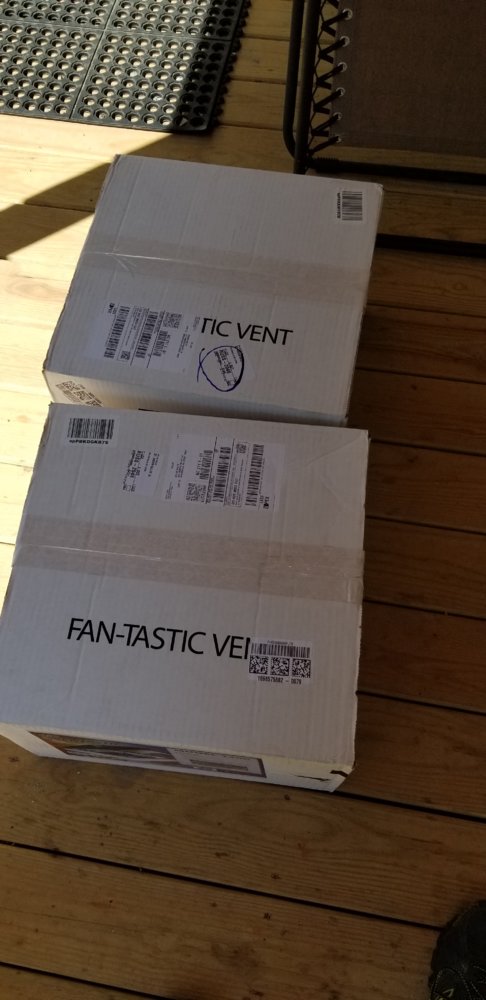

I took the advice of @shawn and others.

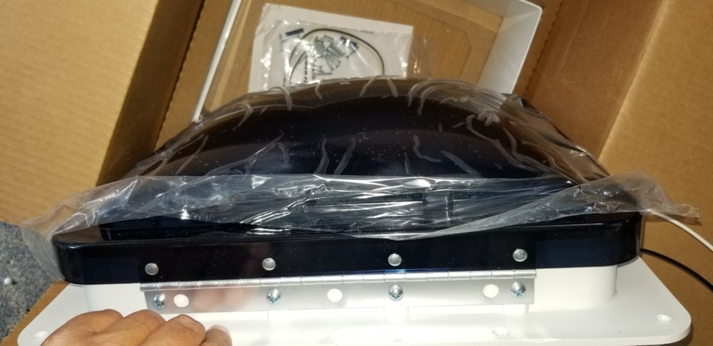

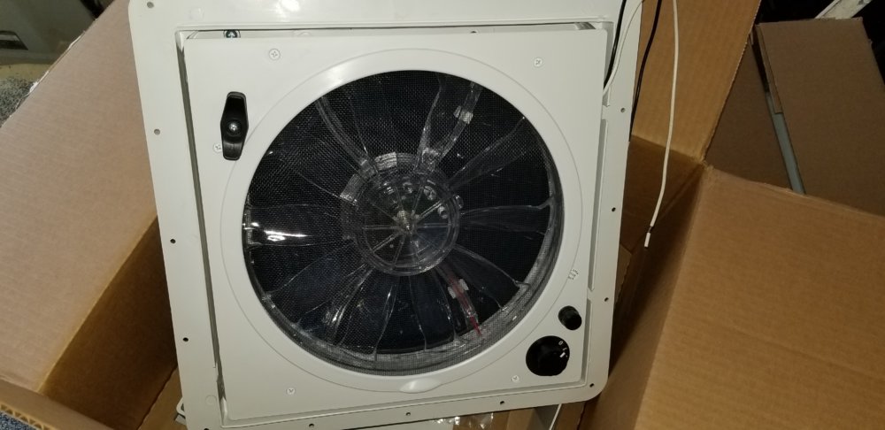

These showed up a few weeks back. I just found these pics.

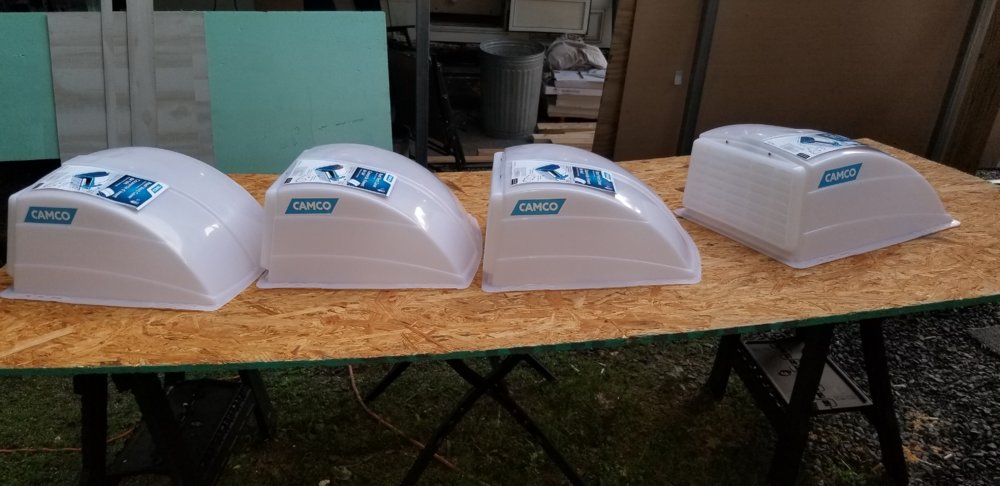

I had already purchased 4 cheaper vents (2 plain,2 with cheap fans) so now the 2 w/o fans wont be used.
The good ones will be in bedroom and living room. And the 2 cheaper fan units will be in Shower and bathroom.
I don't think I can send the plain vents back now, it's been well over 30 days. Anybody wanna buy two new vents?

These showed up a few weeks back. I just found these pics. View attachment 297314 View attachment 297313 View attachment 297312

@Dylan W. its not a bad thing to keep a spare vent lid in the camper in storage. They aren’t the toughest thing in the world and if you’re out and about it’s nice to have an extra if a limb comes through one in a crappy rainy night or something. They are pretty easy to replace in a pinch as opposed to having to wrestle with a tarp to stop the rain or whatever. The FanTastic vent lids are poly- carb and much tougher so no real worry there.
Not trying to take away from @BRUISER but I’d keep one as a trail spare.
Just a thought

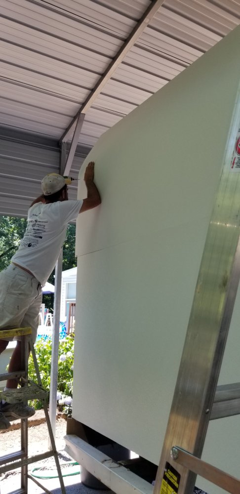

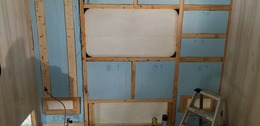

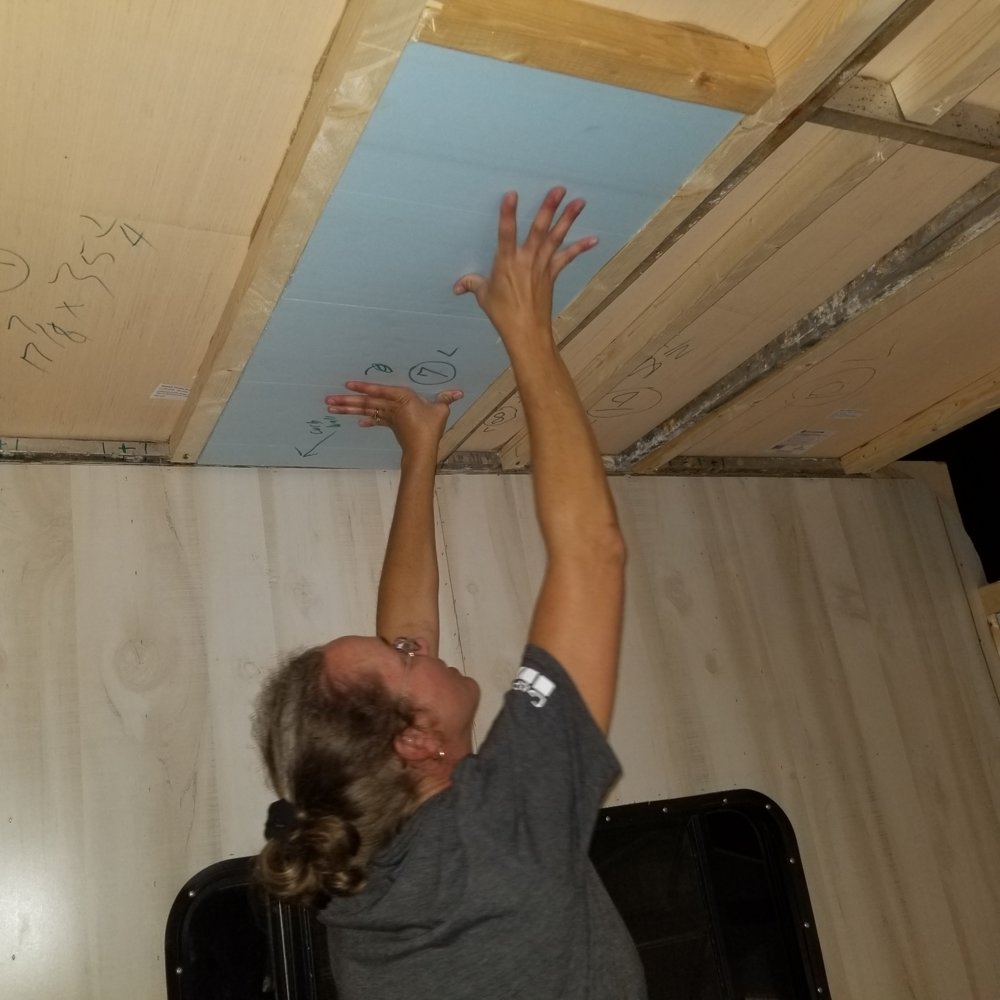

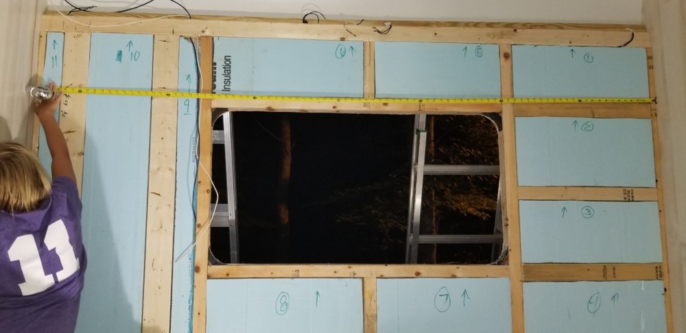

Brooke helped me with the cieling foamboard work. We had already cut it, so all we had to do was glue it and stick it up against the new roof luan.
Brooke is no good at running the glue trowel , so she was chosen to reach up and mash the glued foamboard into its numbered spot on the ceiling. (And before the short jokes fly..I could reach it if I had to...Brooke could just reach it better );)

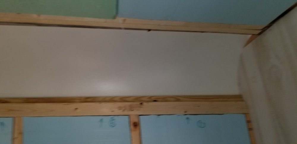

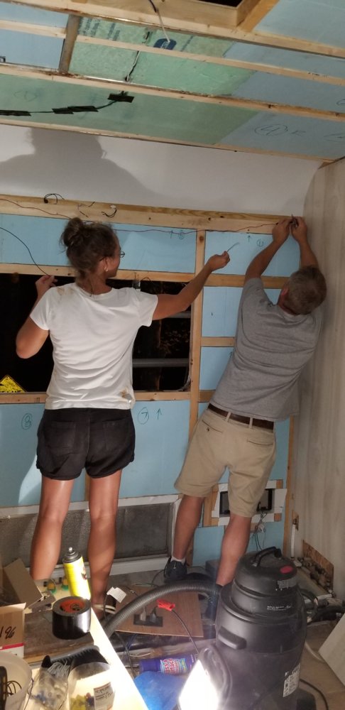

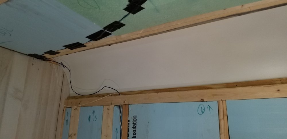

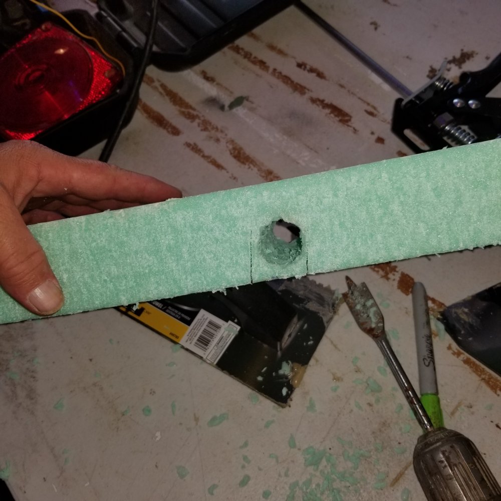

Drilled some wire holes in a few..

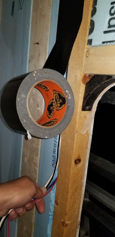

And performed some advanced arch wire trenching on others....I'll stick the wires up in here, and holt it with a bit of gorilla tape until cieling panels go up.
Needed a few holes for
wiring

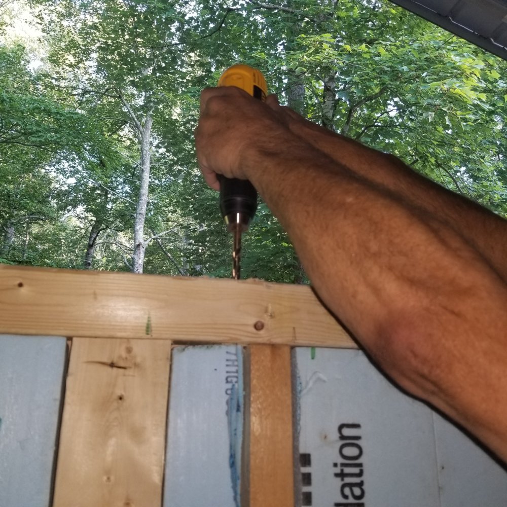

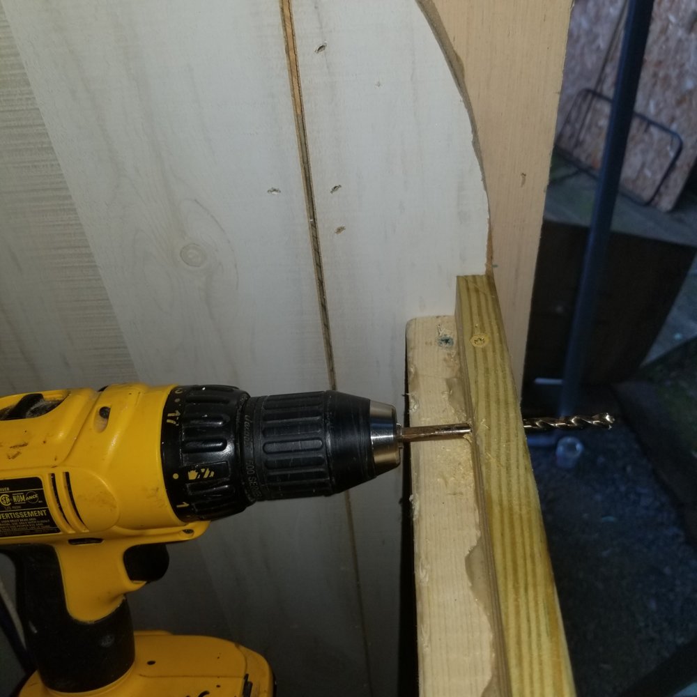

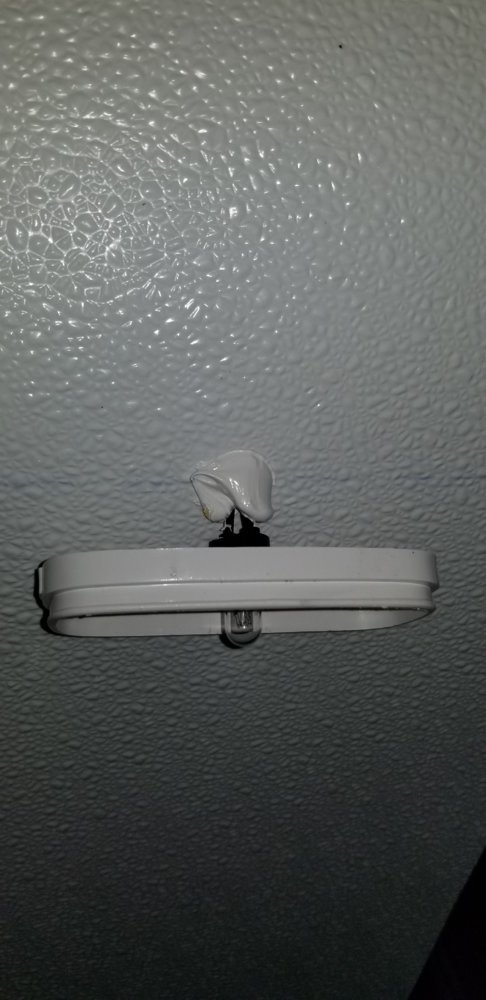

I ripped a piece of treated deck flooring and glued and screwed it to my top wall joist. This is what the running lights will attach to.
Pre drilling for 5 rear running lights.
It was easier to measure and pre drill these before the rear outside frp goes on. Once frp goes on, I'll re drill through these same holes.

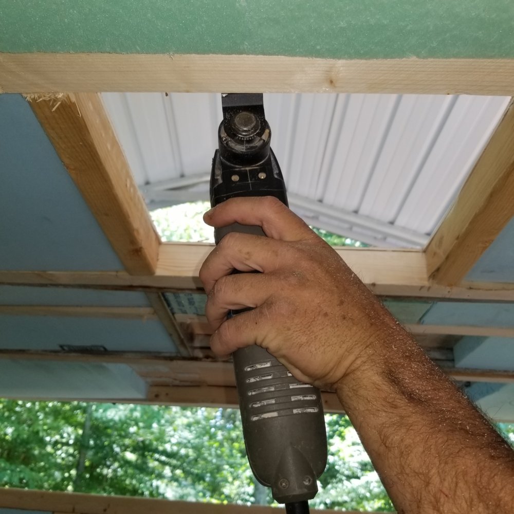

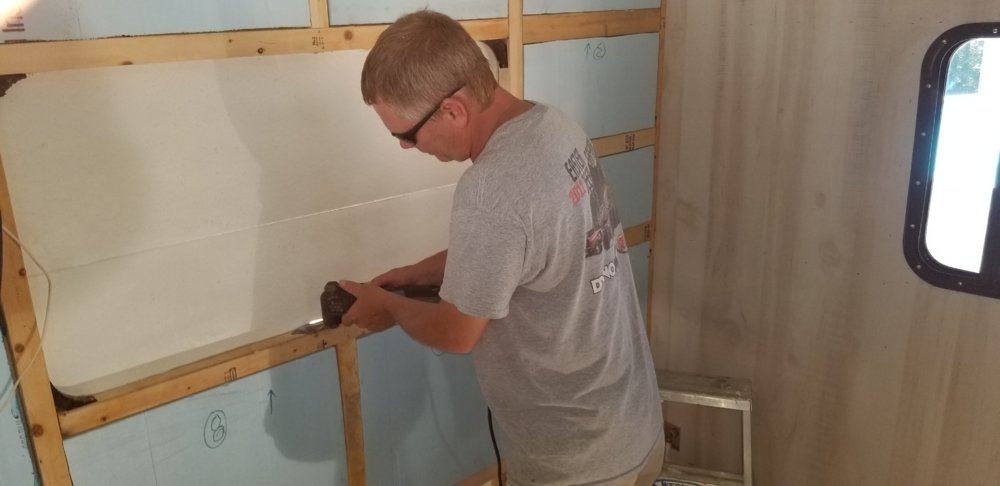

Cutting out the hole for bedroom FanTastic vent!!

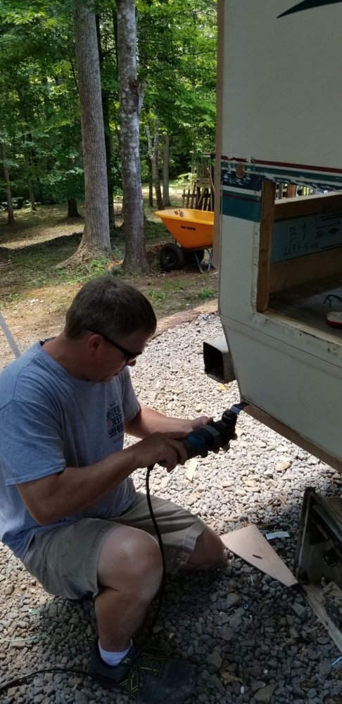

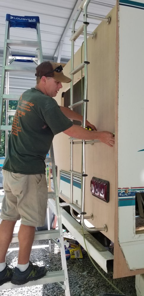

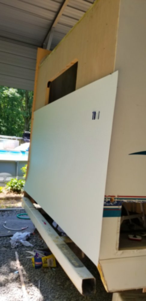

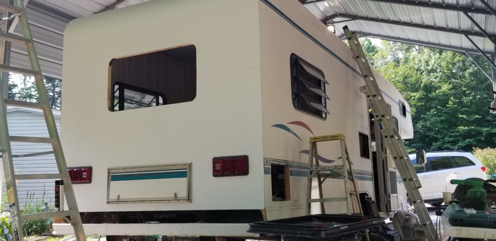

Re checking ladder location before starting on the rear frp siding.

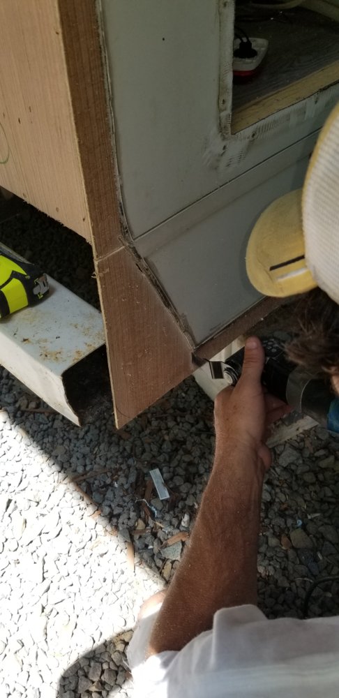

Then it was time to start trimming to match the outside skin.

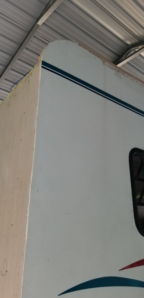

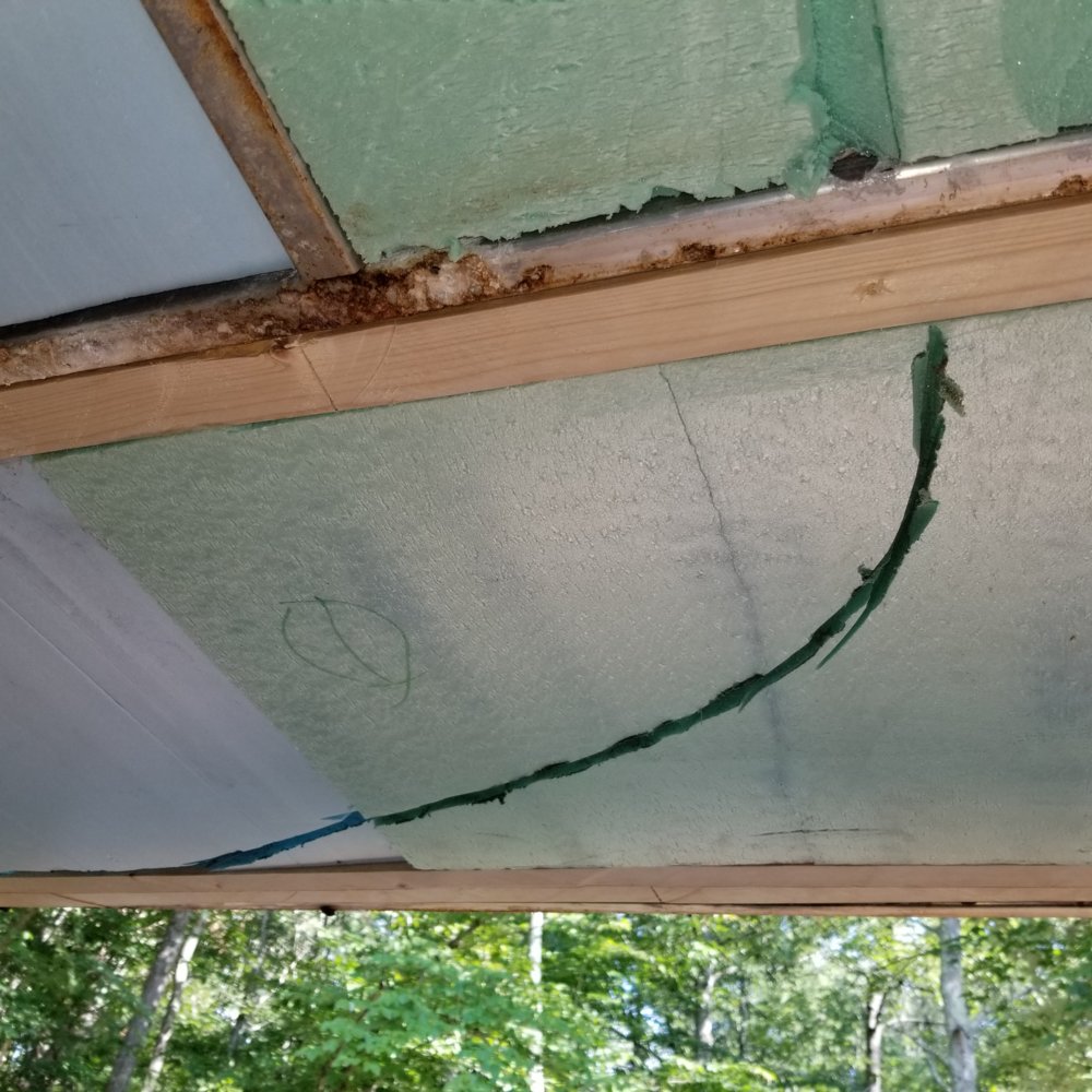

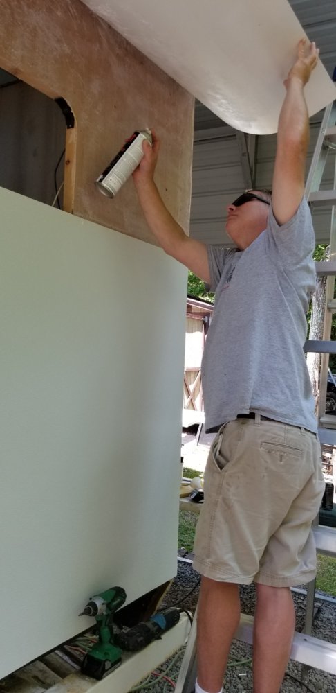

Mean while.....let's get these roof edges cleaned and buffed up..

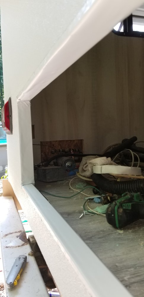

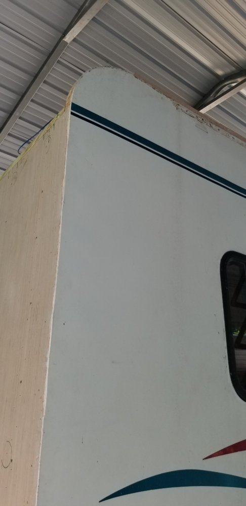

After trimming one side, we have a pretty good looking curve going on. Should make for a nice corner for the frp to roll over.
Long story short....

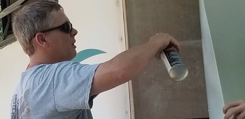

Glue..
Stuck!

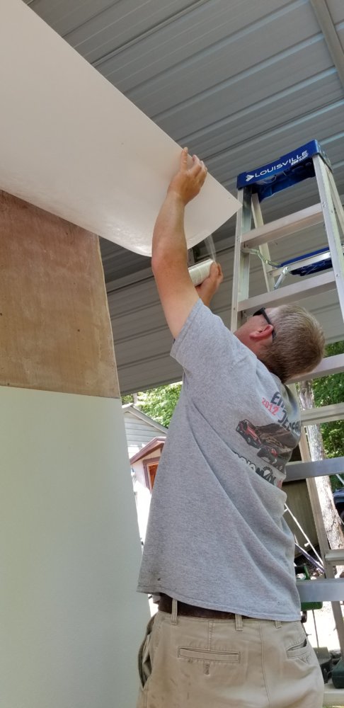

Top piece..
Glued...

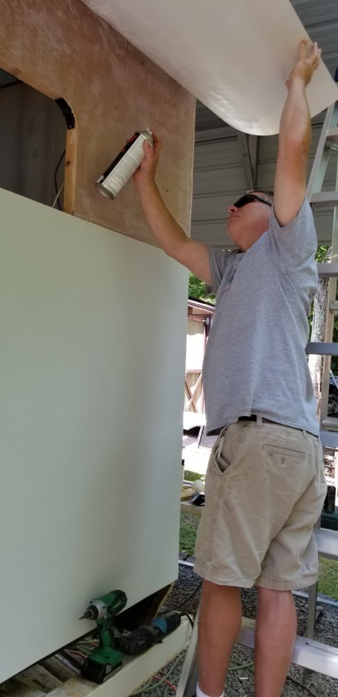

Glued some more, but on the other side....

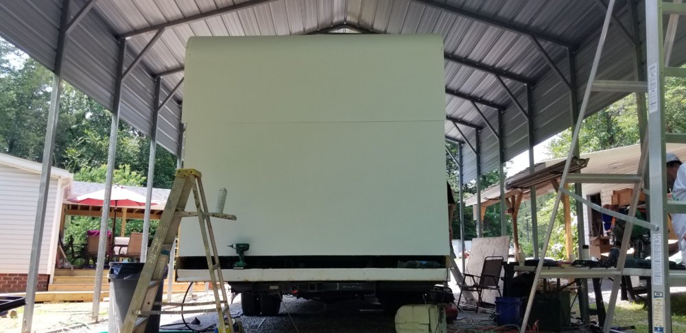

Here we go! Mash it flat meow
Let it sit for a spell.

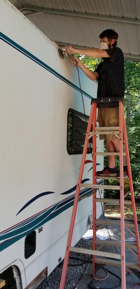

Re checking ladder location before starting on the rear frp siding.View attachment 297408
Then it was time to start trimming to match the outside skin.View attachment 297409 View attachment 297410
Mean while.....let's get these roof edges cleaned and buffed up..View attachment 297411
After trimming one side, we have a pretty good looking curve going on. Should make for a nice corner for the frp to roll over.View attachment 297412

Glue..View attachment 297413
Stuck!View attachment 297414
Top piece..
Glued...View attachment 297415
