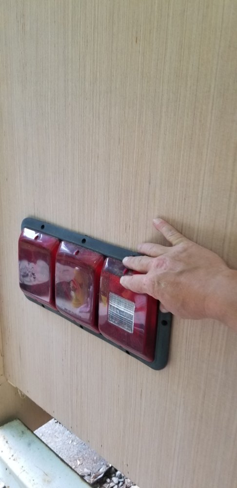

If anything just swap the bulbs for LED when they give out. Problem solved. This thing is coming along so amazingly!!
Probly more serviceable that way, long term, anyway.

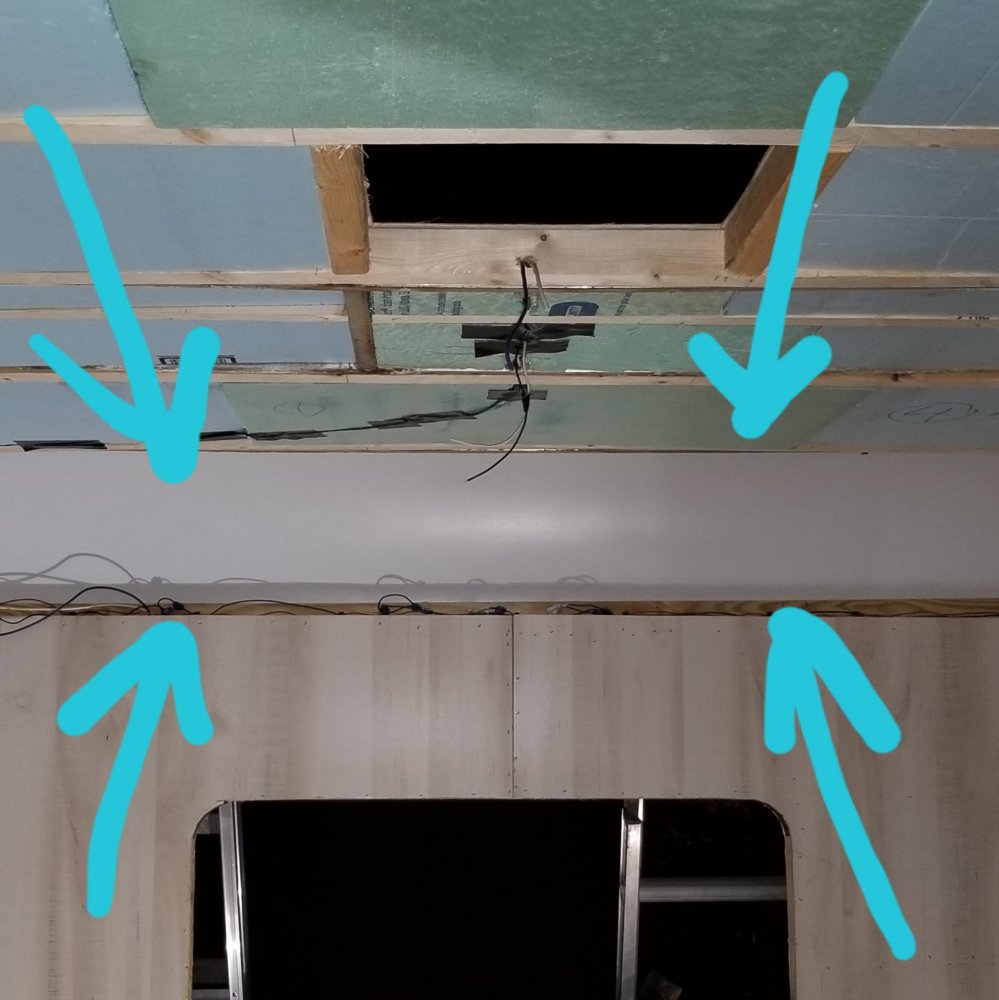

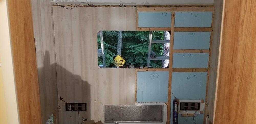

If you guys remember the rounded wooden blocks we made for the front and rear upper corners, you might remember that my buddy Kieth used a few cans of expanding foam to fill in the voids. Not only does it act like insulation, but the foam also helps strengthen the outside frp. Making it more solid on the inside.
That was the front end and it will work.

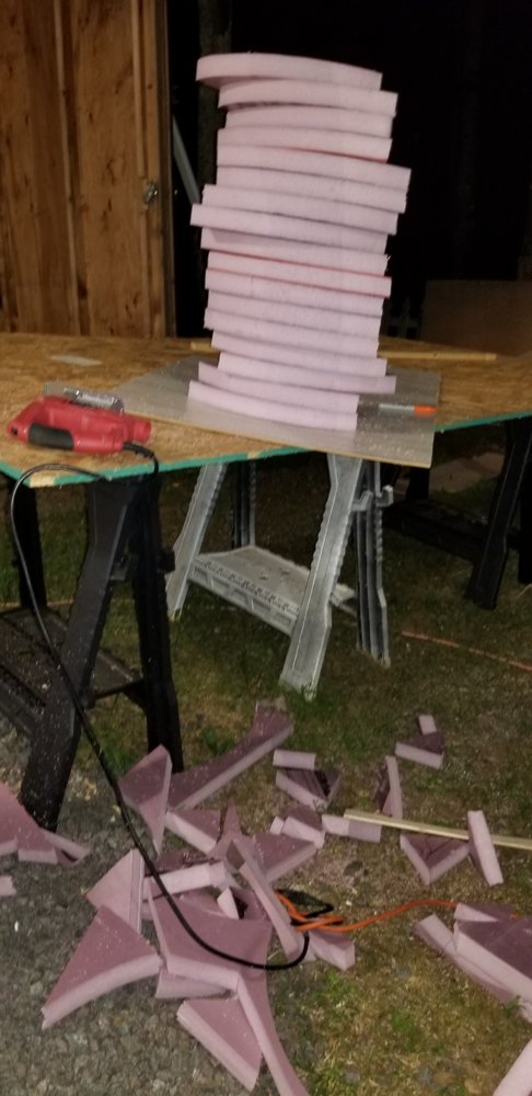

However, that was months ago. Now it's time to do the same for the rear. After looking at this section over and over during work on the walls.. I had a brilliant idea literally hit me in the back of the head.

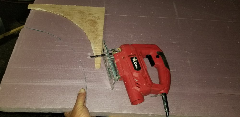

While cleaning up one day, Bobby threw a small chunk of foamboard out of the rear window. I was under said window changing the trash bag in the can below the window.
Bobby said" what are you going to do with all of that leftover foamboard?" (I still have several 4x8 sheets of it)
Suddenly...I knew what needed to happen.

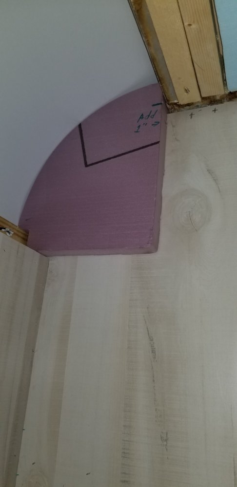

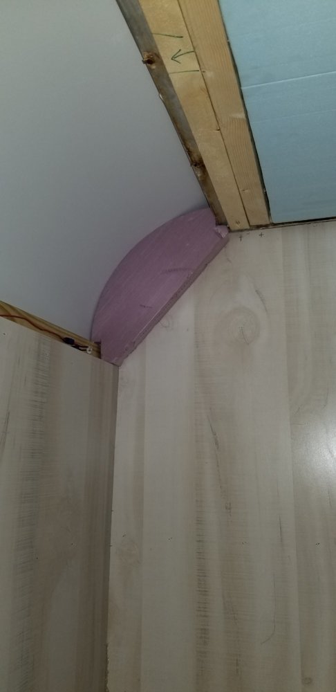

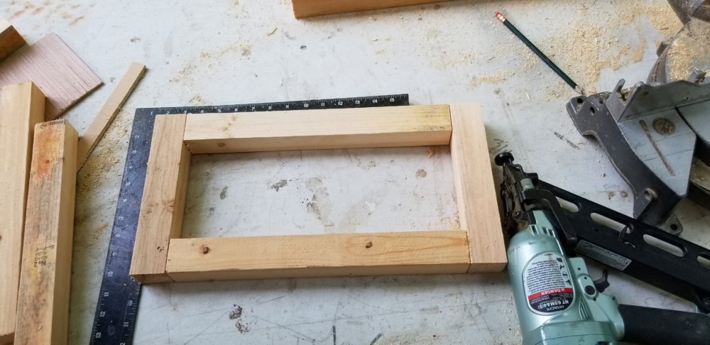

I cut a chunk of it and used the pattern I had to make it round on the edge..then fit it into position.
Next, I just whittled it here and there and made it into the final shape I needed.

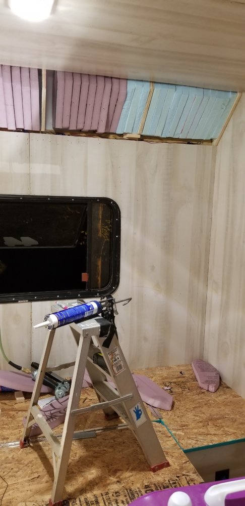

Then I marked and cut about 50 pcs.
I cut some plywood pieces into the same shape.

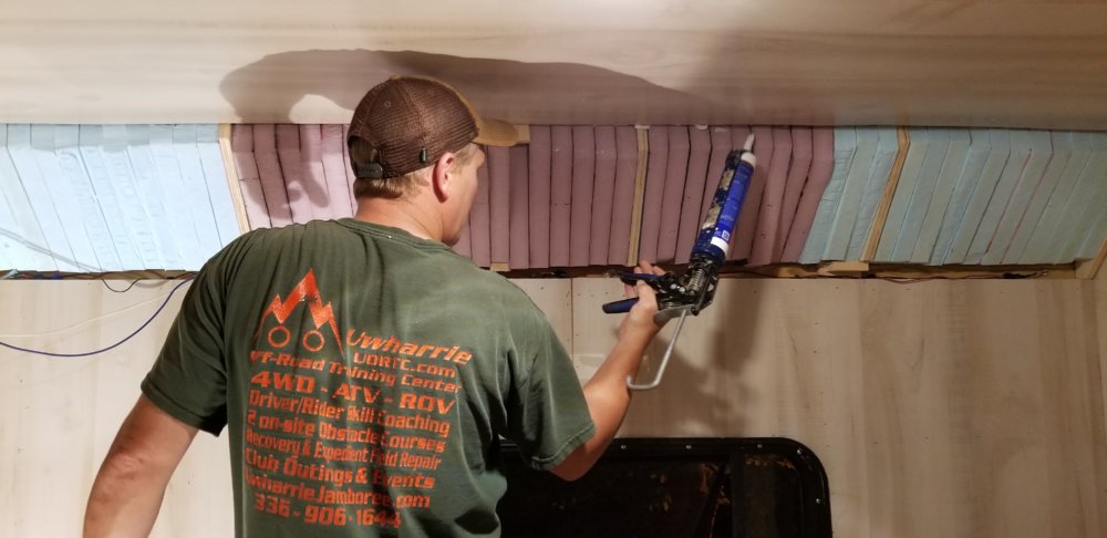

I used glue in between every piece . This made it pretty ridgid.And keeps it from SQUEEKING!
Now I have a solid filled round back part. No expanding foam mess. And, I used up a bunch of foamboard. I was rather pleased with how this idea turned out. Even if it did take forever to accomplish.

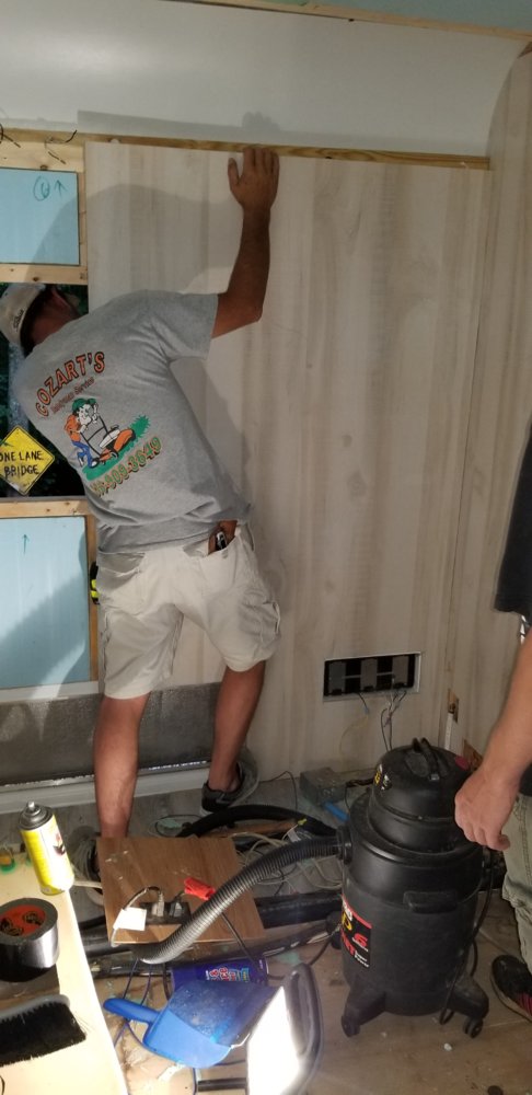

I cut a piece of paneling to cover it all up. I used the wooden peices on the inside to screw my paneling to.
Keep in mind, this section will never be seen again once the bedroom shelves/cabinets go in. So dont mind my uneven looking screwso_O

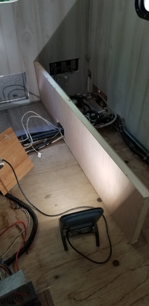

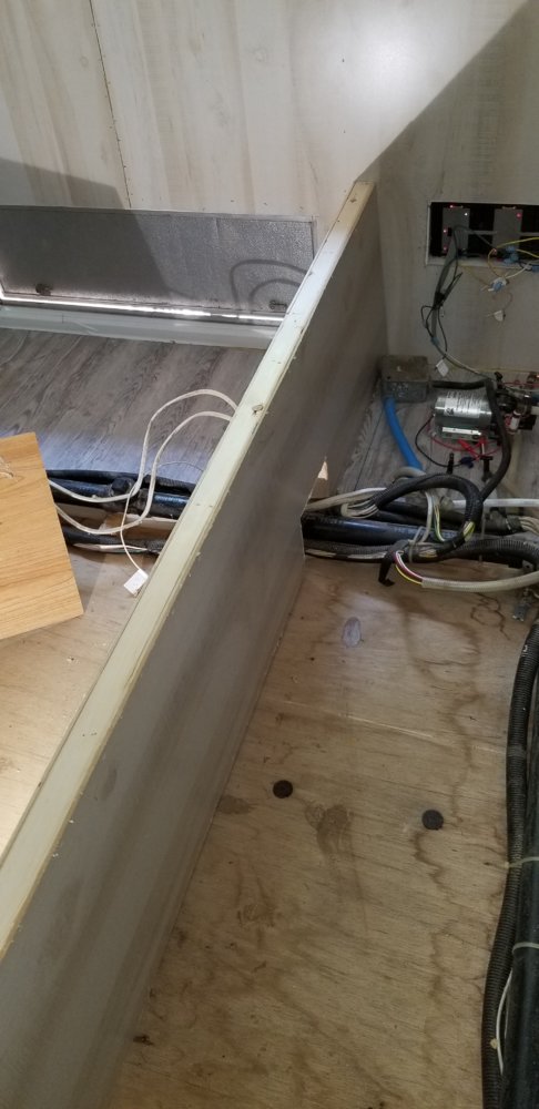

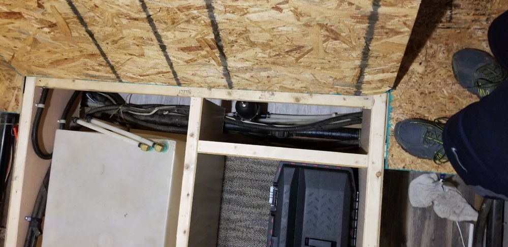

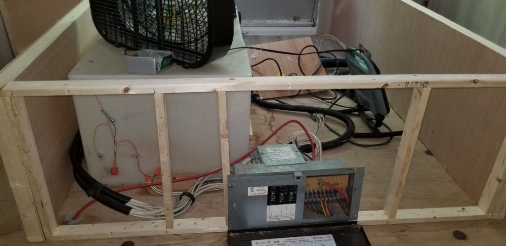

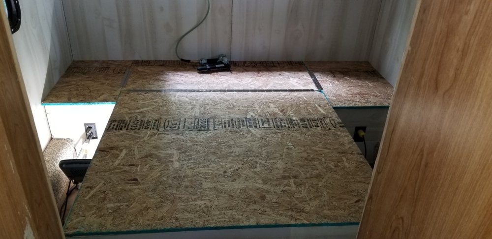

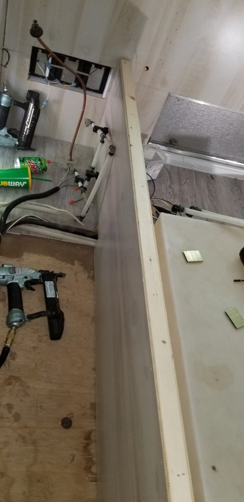

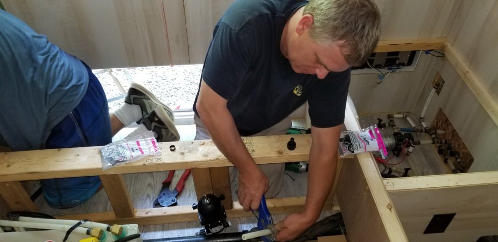

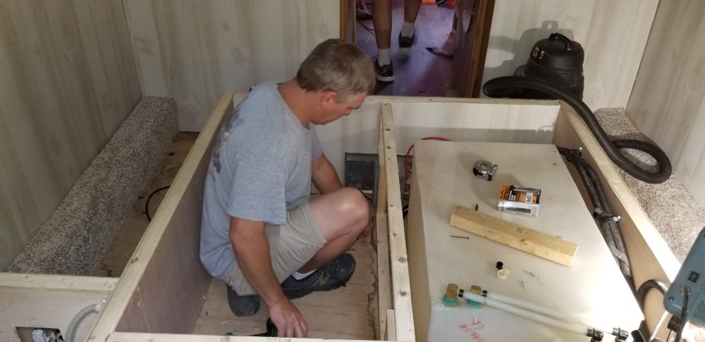

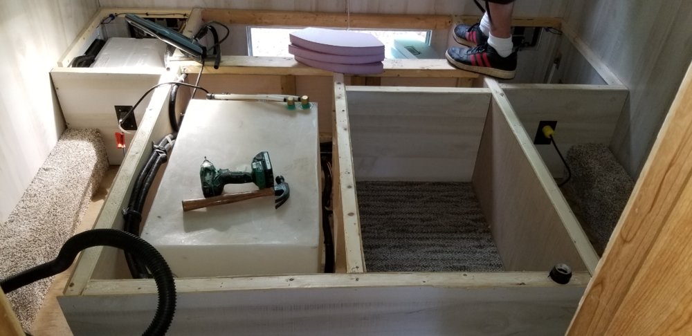

I tore out all of the original bedframe/storage area etc.. in the back bedroom. Now it's time to rebuild. Building it all new, out of scratch will allow me to make all the plumbing more accessible.

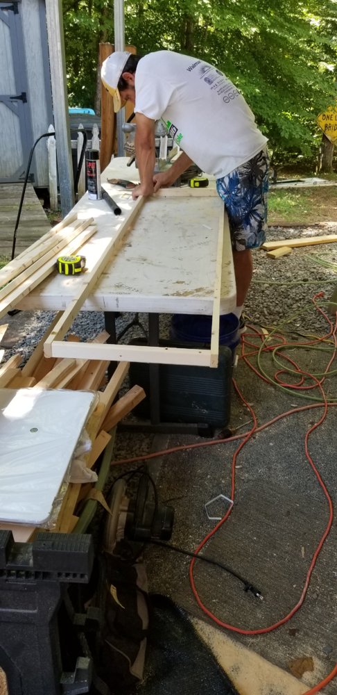

First up..frame work. 17" tall will give plenty of room to clear the fresh water holding tank.

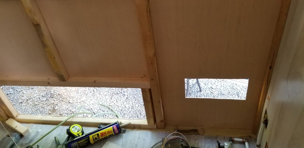

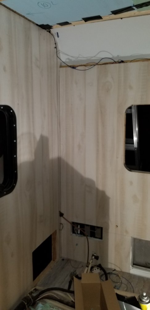

Adding paneling to both sides of the framework completes the look and also makes it strong.

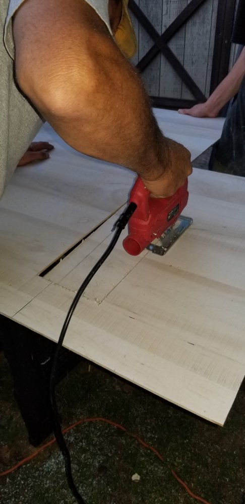

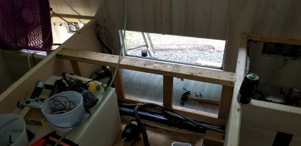

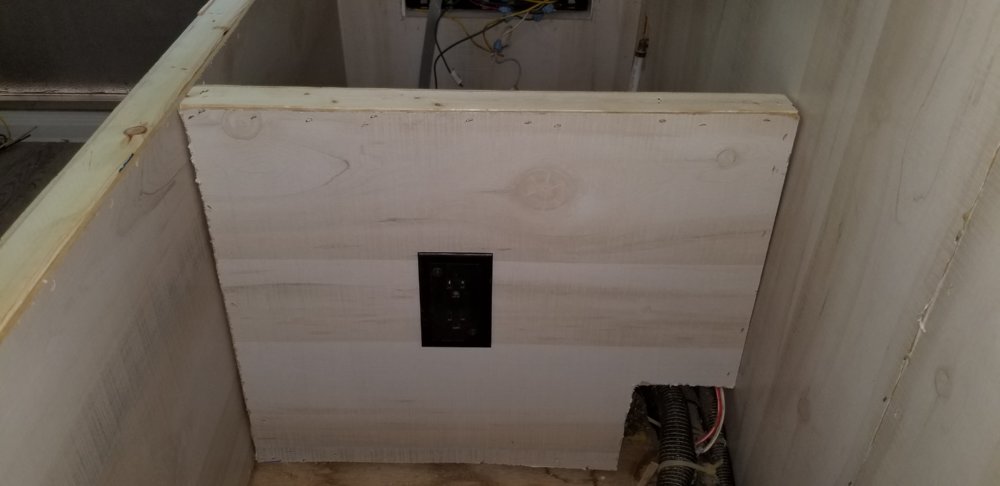

Next..its time to cut out some sections that will allow passage for my plumbing and electrical.
First wall in

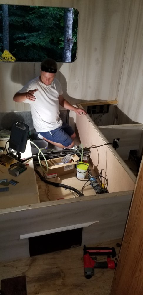

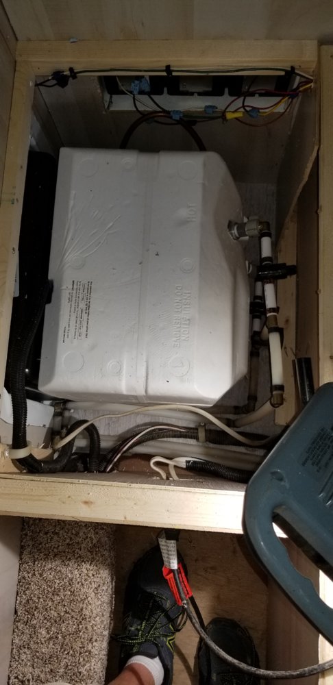

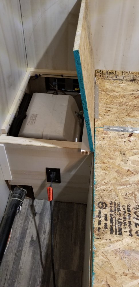

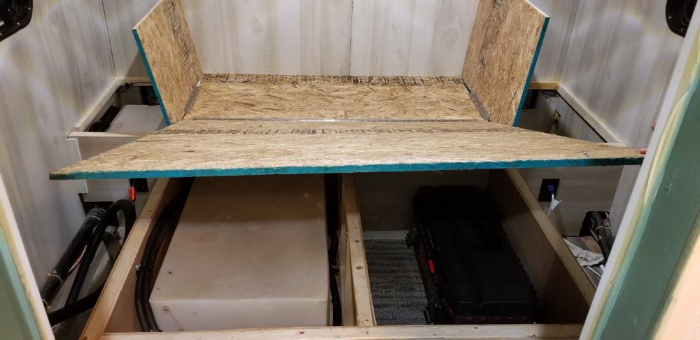

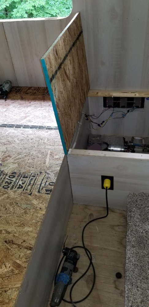

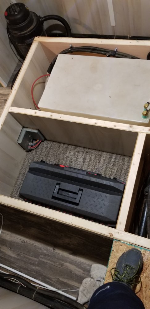

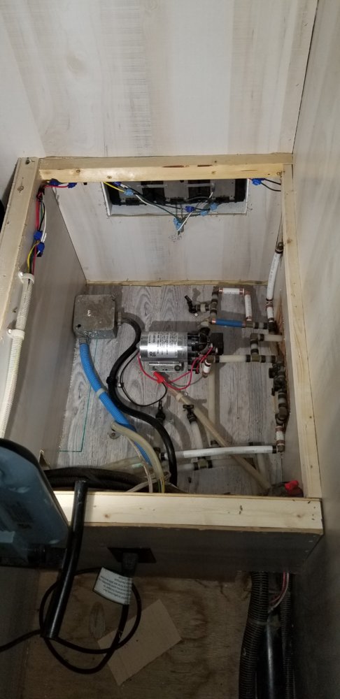

A couple glances inside.

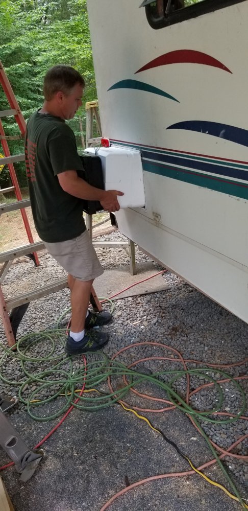

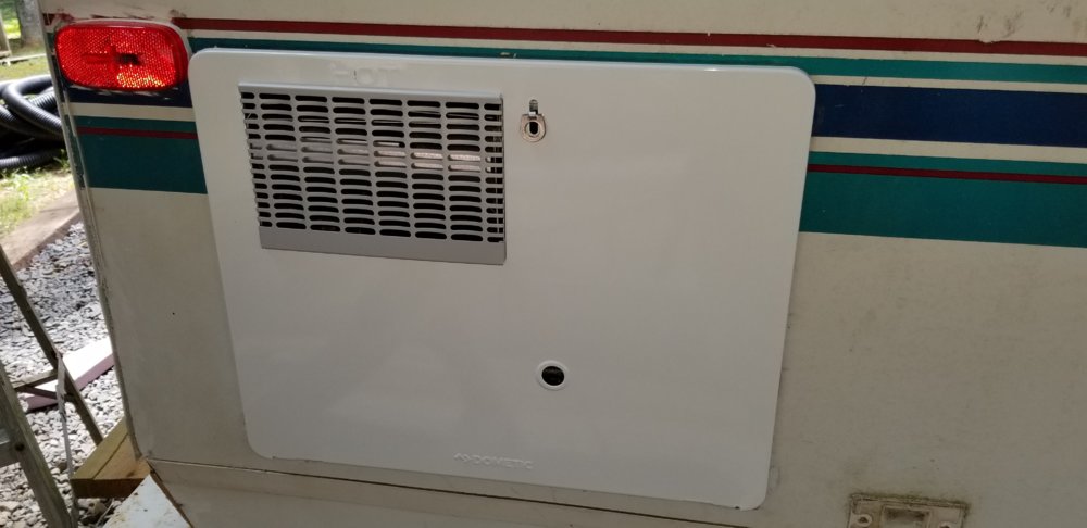

Water heater hole
Fresh water tank and storage area.

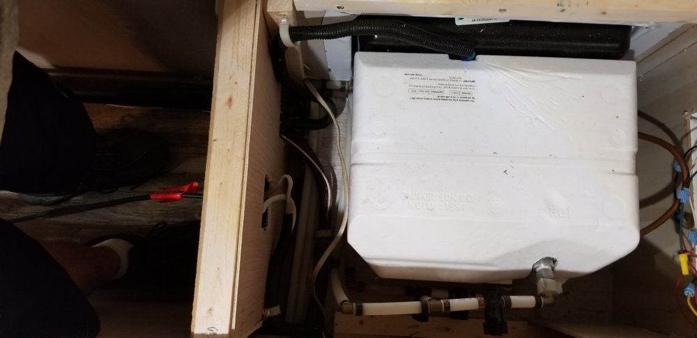

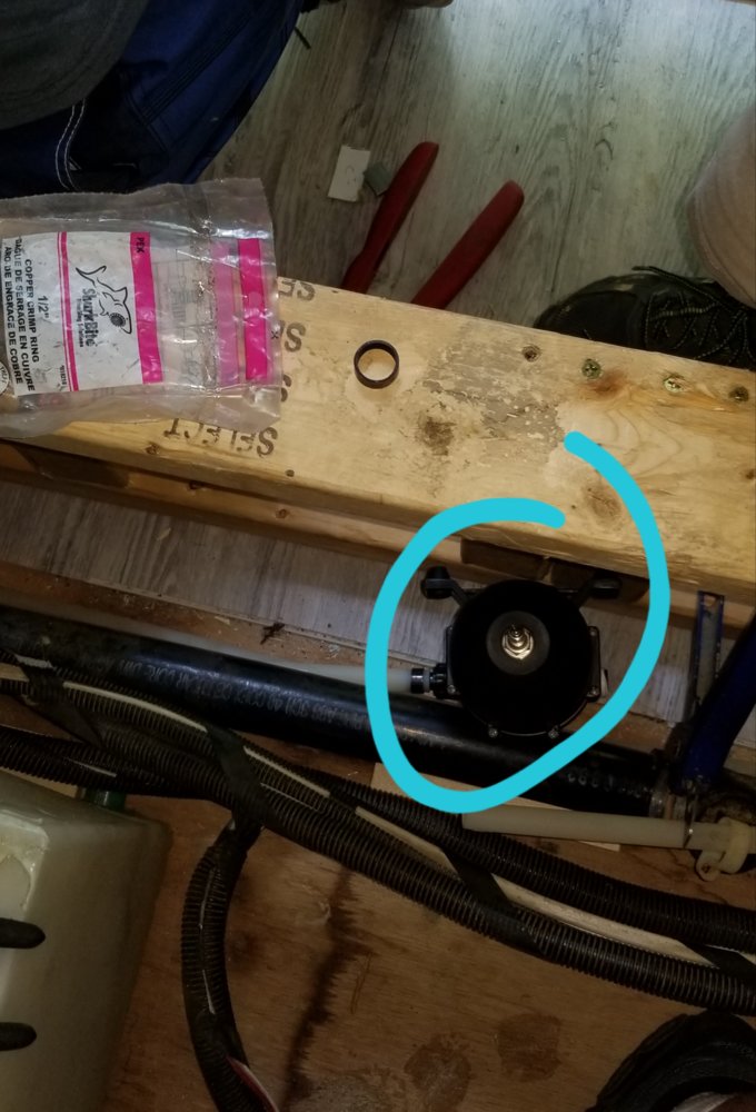

Little in 'between' tunnel. Crossover plumbing, electrical and water accumulator are in here.
get some nice trunk struts to hold the bed up when putting stuff inside it.. it will get heavy with a mattress on it.
