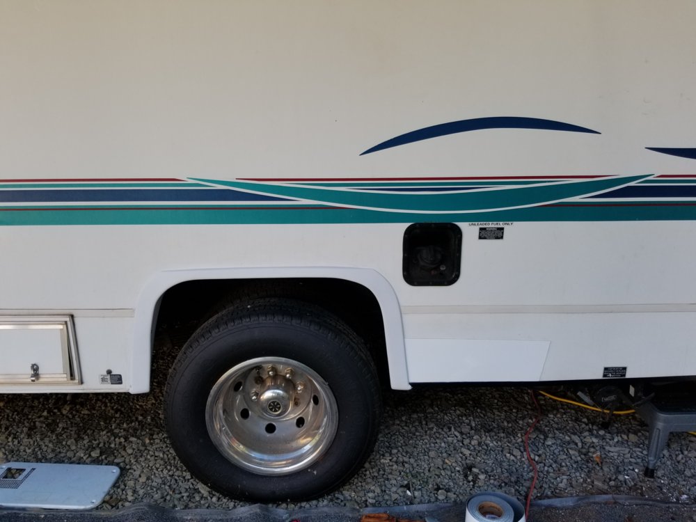

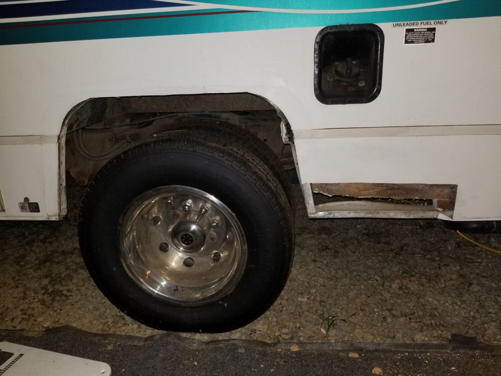

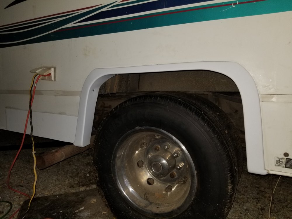

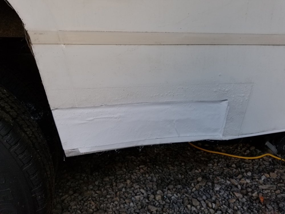

Next small project was to repair exterior blow out damage and replace fender flairs on both sides.
I had already cut away the damaged skin..and straightened out the aluminum frame as best I could .
Next, I added externabond tape, foam and glue to patch the hole from the inside out..
Then I cut a peice of new frp and glued it over everything. Its tight!
When that dried, I installed the new fender flairs. It ain't perfect, but its good enough.
Drivers side

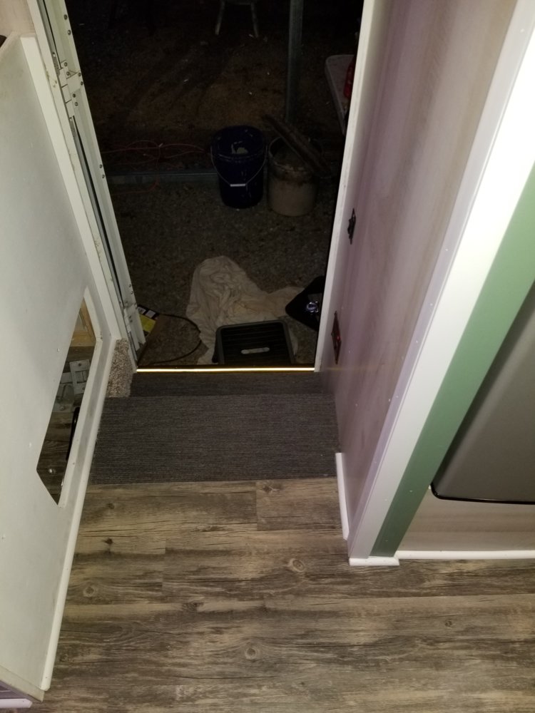

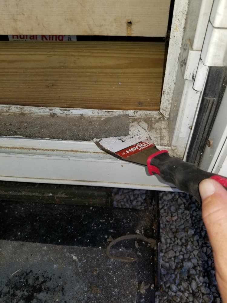

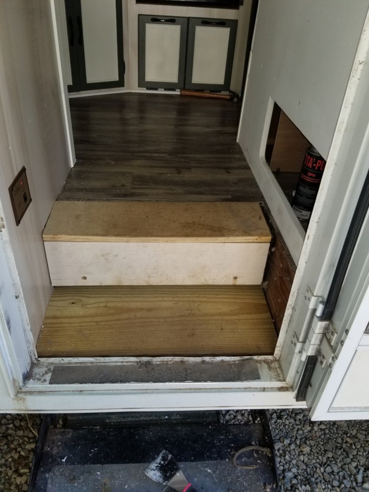

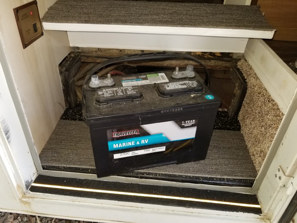

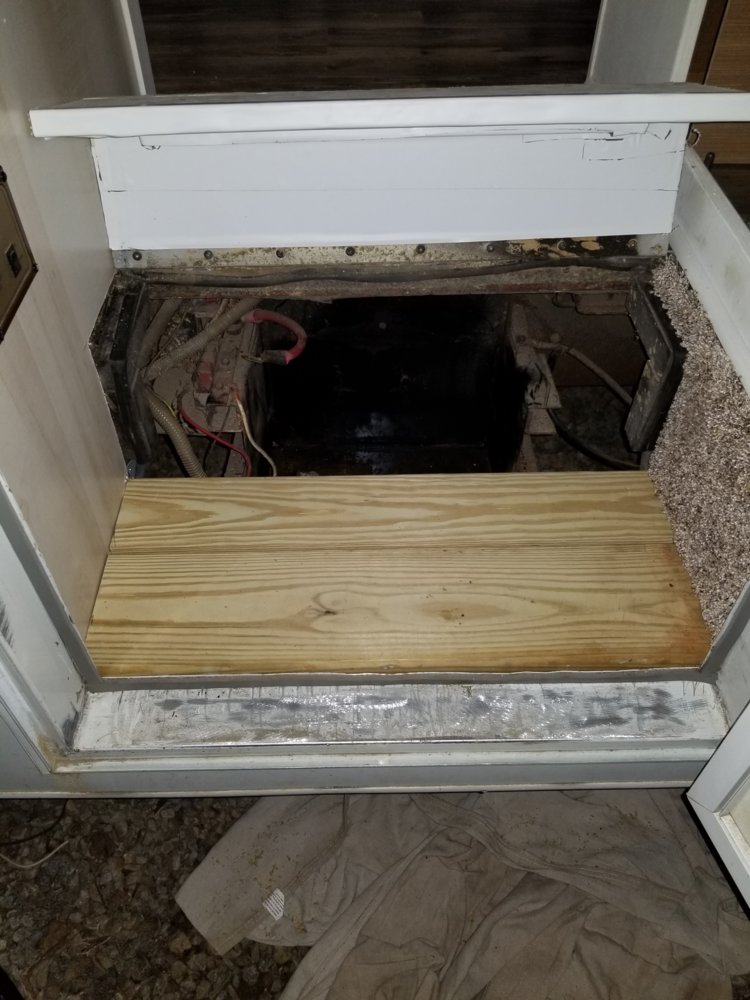

I started working on my entry step. For now, I have removed the mechanical step. I tried working on it, but it needs new stuff. I'll get that later.
Dug out all the rotten, added new treated wood then wrapped everything in water proofing eternabond tape.

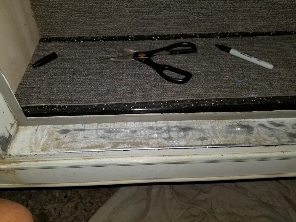

Scraped of the old grippy tape

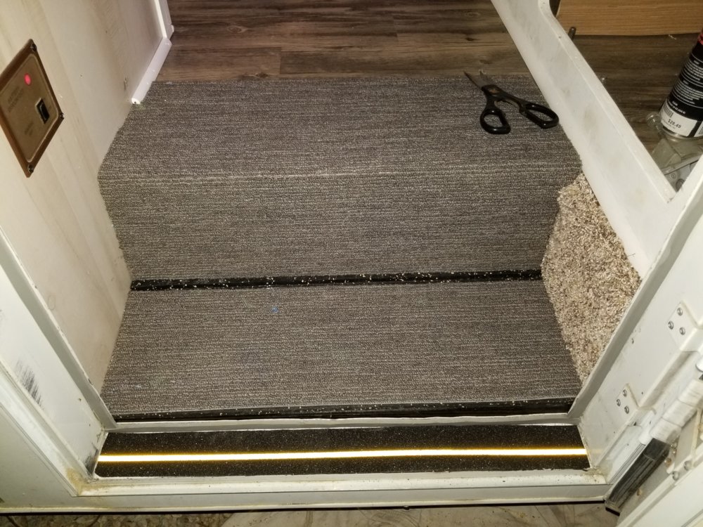

Cut out some thick rubber gym flooring for the main step, added carpet to the sides , stuck on some new sticky tape and called it good to go.
They grey carpet is all easy clean, easy replace stuff.

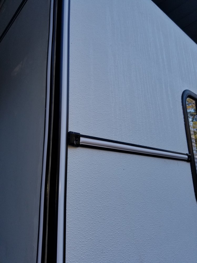

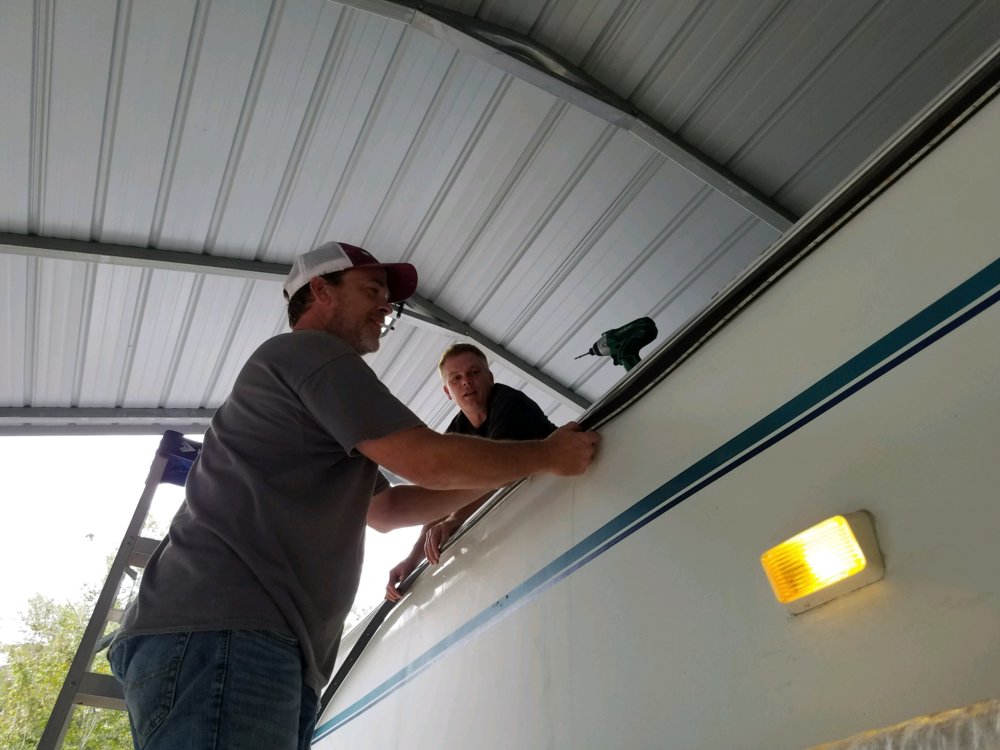

I havnt updated this thread in quite a while. Work has slowed on the rv, as it is almost done. We have all of the trim in place, screwed down, and all trim inserts have been added.
There is over 300 linear feet of new outside trim work on this beast.

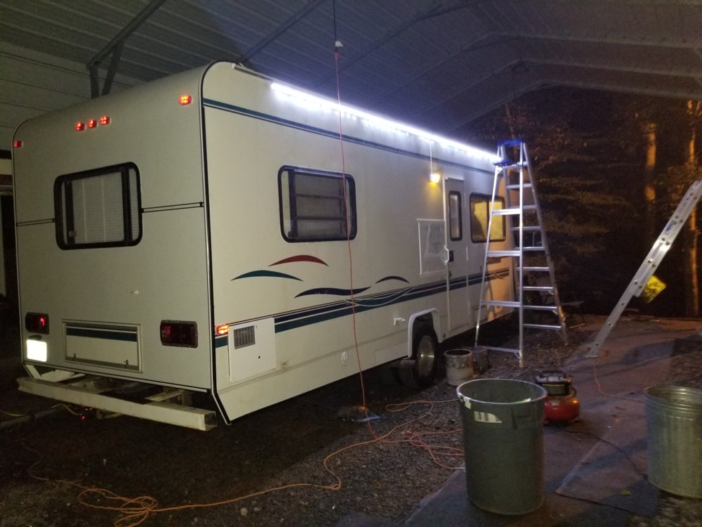

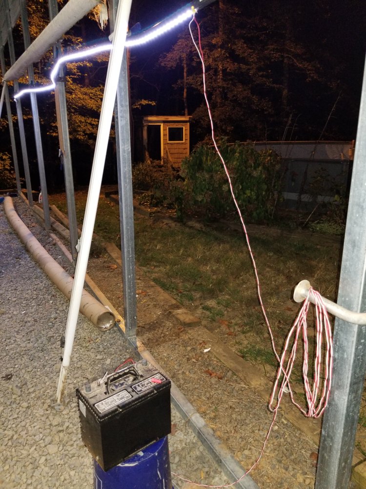

This long LED light strip was included in all of that rv stuff I bought cheap from campers inn. I hung it up on the shed and rigged it up to a battery for testing. It works!
So we hung it up just below where my awning will eventually be. I'm yet to purchase my awning but I will soon.
Then..waited till dark for the reveal pic.
I wired it directly into my porch light, so they come on in unison.
