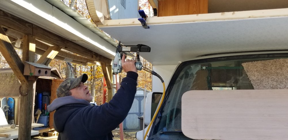

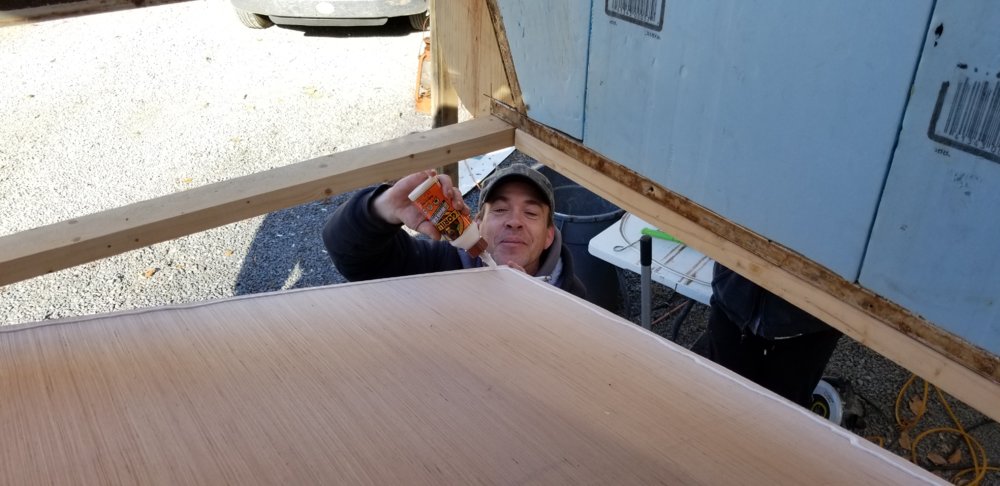

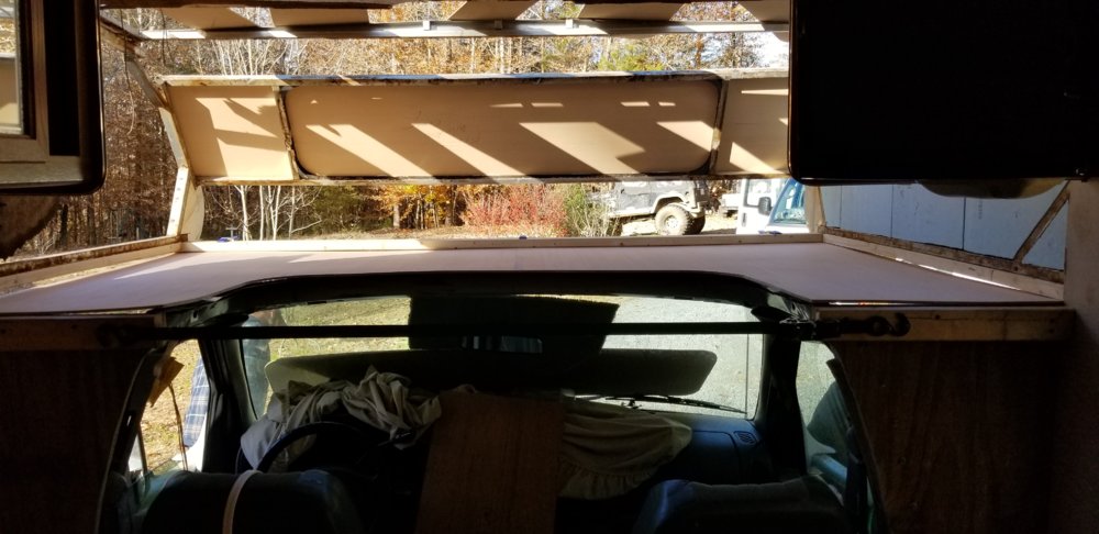

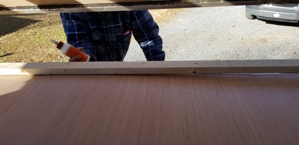

glad you like it!Sugarland - Stuck Like Glue - YouTubeNow that we have the framework squared up ish..the big panel aka Ella's bedroom floor, is ready to be installed. This will help tie in the front and both side walls.
Everything has to be tight and right. With the installation of this panel, along with the 2 side panels, we are sealing it all up. With Butyl tape and rubber seals in the middle, this panel will be sandwiched between the van roof and a 2x4 frame that will be built on top. View attachment 280988 Every thing lines up as it should. It's time to add more glue. I'm
tired of glue. I've bought too much glue..I'm tired of glue. Glue glue glue...View attachment 280989 fits perfectly!View attachment 280990 Time to staple the edges! It's gonna be stuck now.View attachment 280992 Looks like the plan is working out. Looking good on the outside.It's time to add more glue. I'm tired of glue. I've bought too much glue..I'm tired of glue

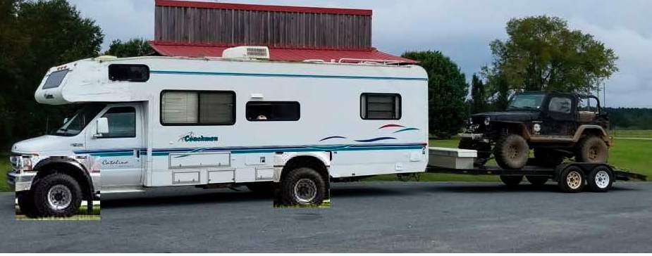

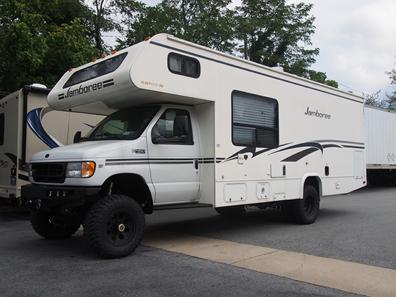

Since this a 4x4 site and with all the mad skills on display, I am sure it would very do-able to install an xfer case and a different front axle.
The end result could look something like
Just an idea...![]()
