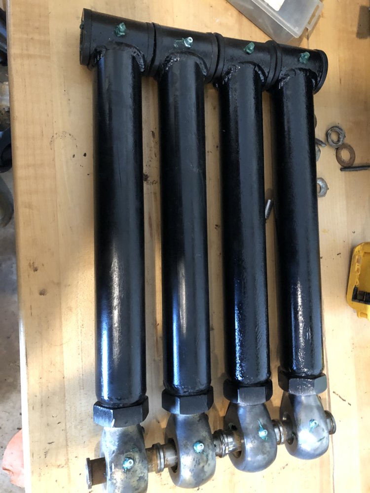

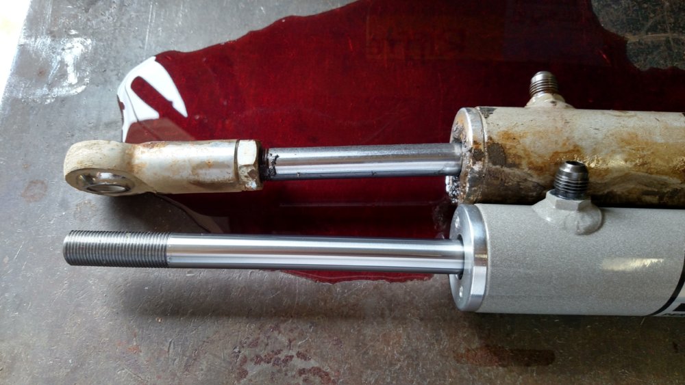

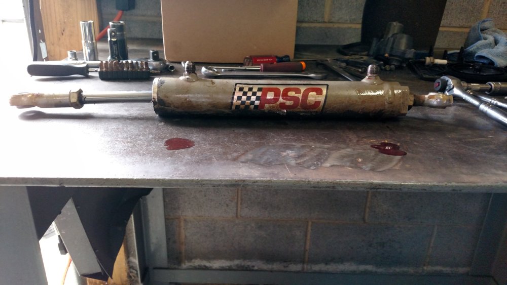

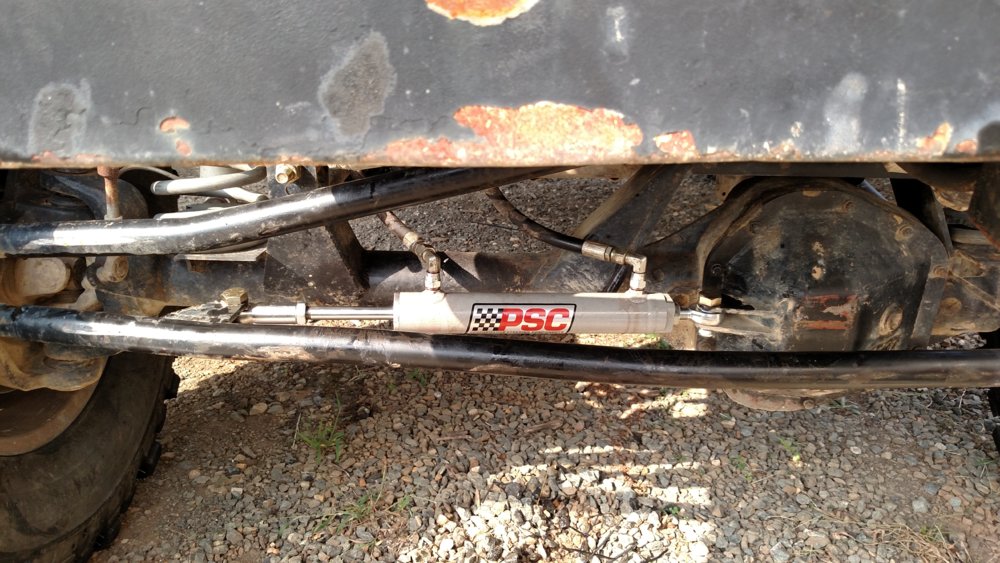

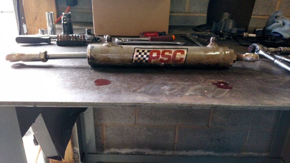

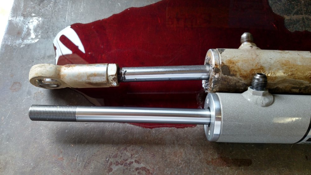

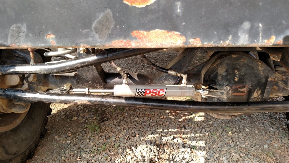

Spent Friday evening replacing the ram I busted at Harlan on upper damnation. Then went wheeling in the waries.
View attachment 302959 View attachment 302961 View attachment 302962 View attachment 302963
It ain't broke yet.That tie rod tho! You could patent those custom bends!
Damn I can really see it here. It didn't look that bad in person.Spent Friday evening replacing the ram I busted

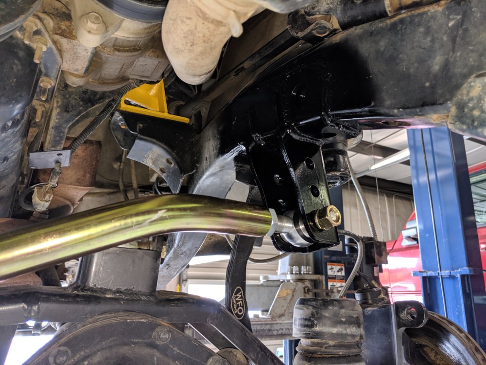

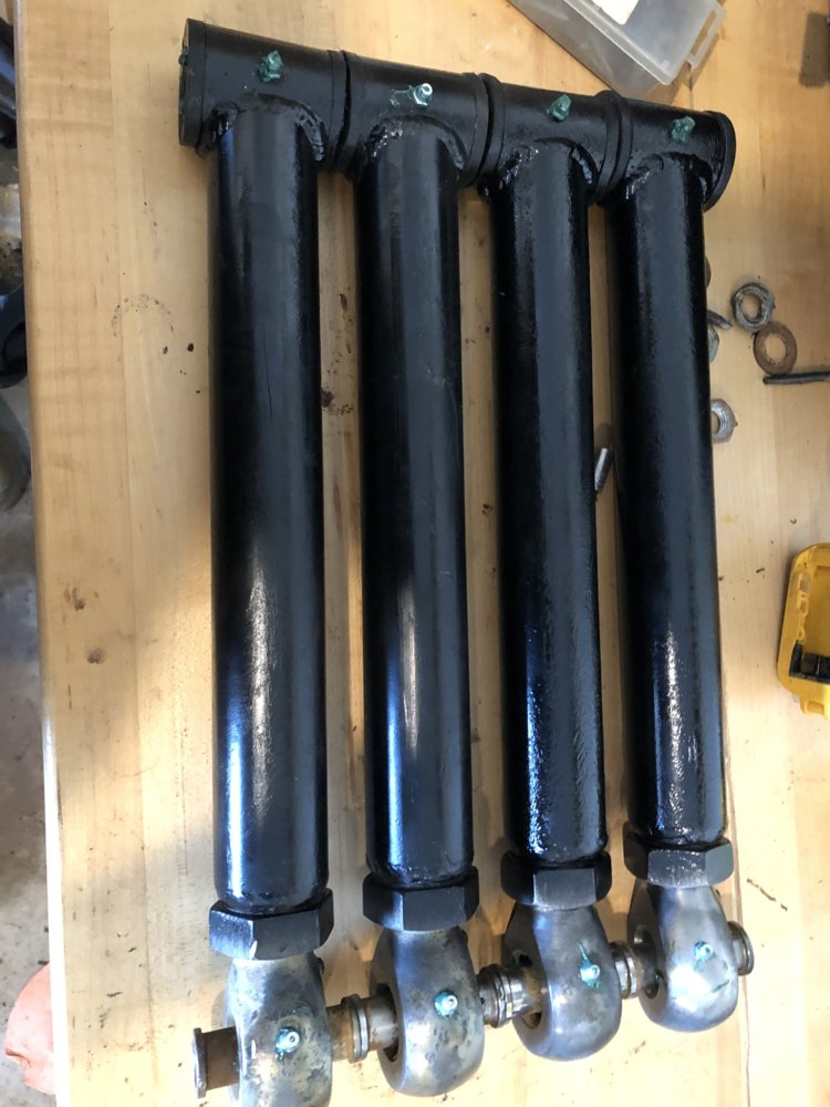

Looking good! That's all they needed was a little tlc. Now you got some bombproof lowers!Cleaned up some control arms and greased them getting ready to install the 8.8
It ain't broke yet.
Just a temporary fix for now. Going to full hydro it like I should have to begin with.

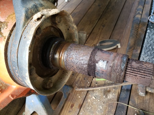

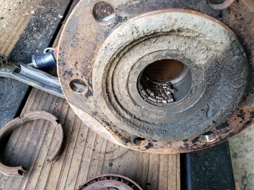

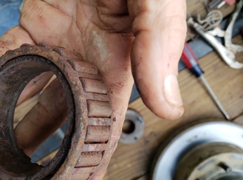

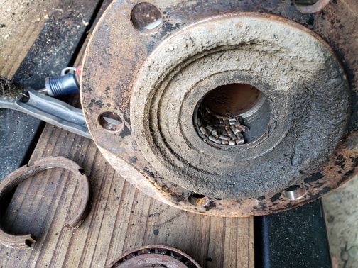

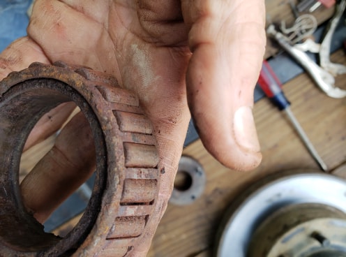

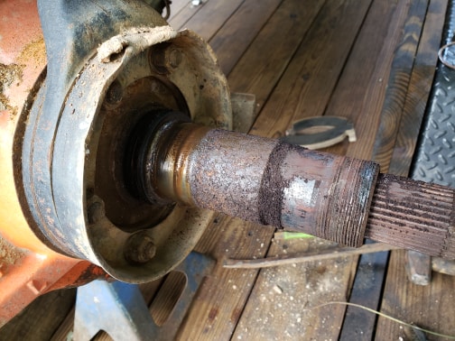

When at Harlan, I was having a rotational noise. Checking everything, diff fluid way down, didn't have but a QT,(Borrowed) and still way low, so it got some 10W40 engine oil. Figured some lube better than no lube. Cracked opened the diff cover today to check it. BTW first time doing this on mine, and found that gear oil, and engine oil, do not mix, or if it does, it separates, soooo Anyway, we checked the gears, and bearings, no sign of anything out of the ordinary.
Super joints had already been greased and eliminated as the source of the noise. So, I jacked it up, put it on jack stands(while still on my trailer), I took didn't like the look of what I saw, as soon as I got the cap off the hub. Started taking it apart, very dry, lots of dust/grit, all the things you do not wanna see. Got to the last nut that goes up against the bearing, and, it was fubared. It had split. I took a screwdriver and put in the crack, and it opened up and came out fine. Outer bearing, looks like it never had grease! (I know it did) Long story short, it will need bearings inner and outer, new seals, new(different) spindle(threads messed up) And new spindle bearings. They we in there, just in a lot smaller pieces!
So tomorrow will be getting new parts to put it all back together.
The good news, in all the bearings I had in a bag, dated 1998, I did find a new outer bearing and bearing cup, so, that saves me a little money.
View attachment 302978 View attachment 302979 View attachment 302980
Better now than off the trailer at Dixie Run.
Change that spindle bearing to a uhmw bushing. Never have to worry about it again.
never heard of that, you have a link ?
There are a few places to get them, but ECGS has them: DANA 60 Spindle Bushing
They are a little pricey compared to a spindle bearing, but they should ever fall apart or wear out.
