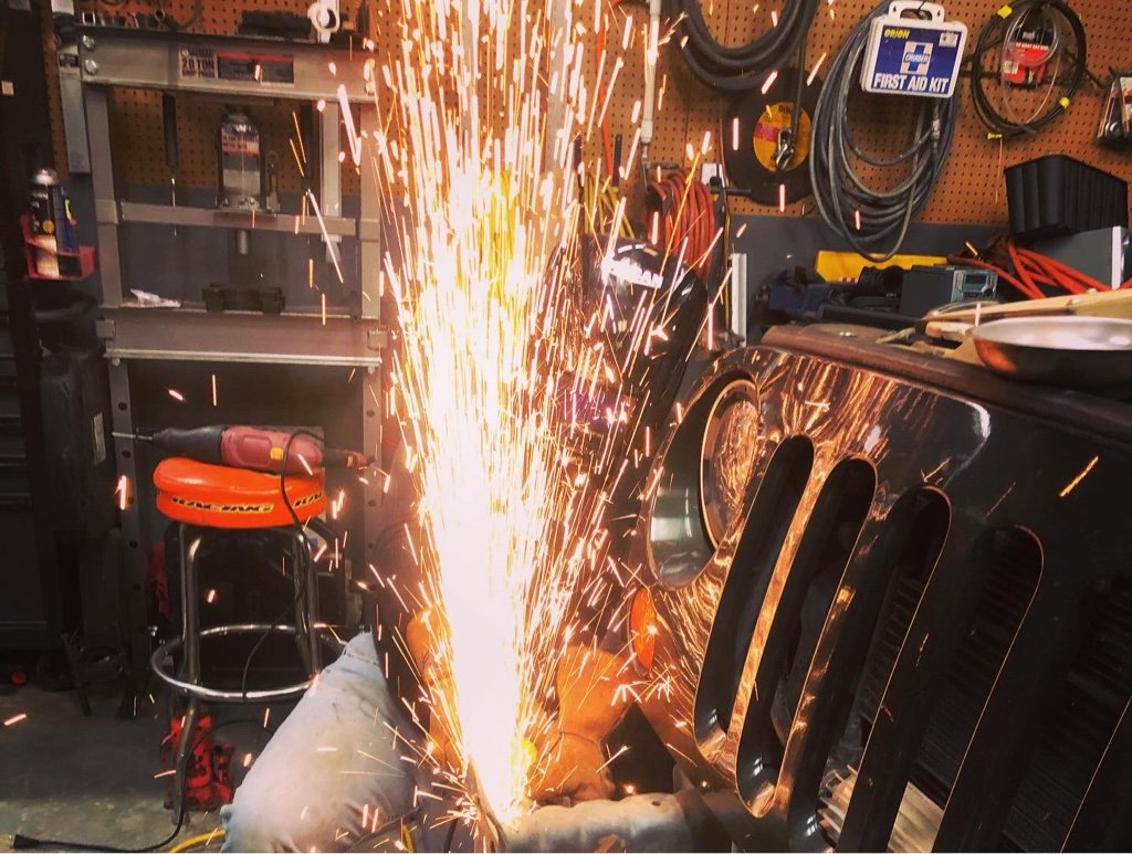

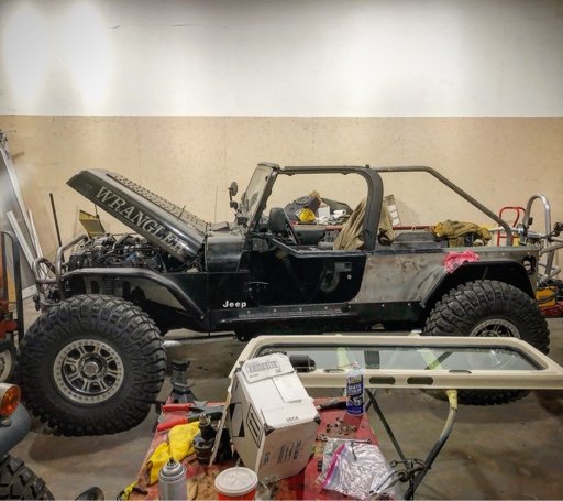

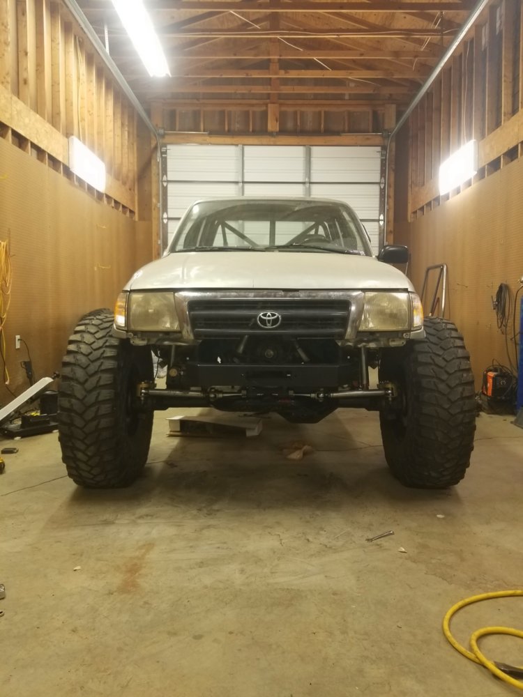

Started bending some tube for my cage.
You collect windshields?Started bending some tube for my cage.
Yeah, this is semi put together at full bump.Anymore pics of this Tacoma?

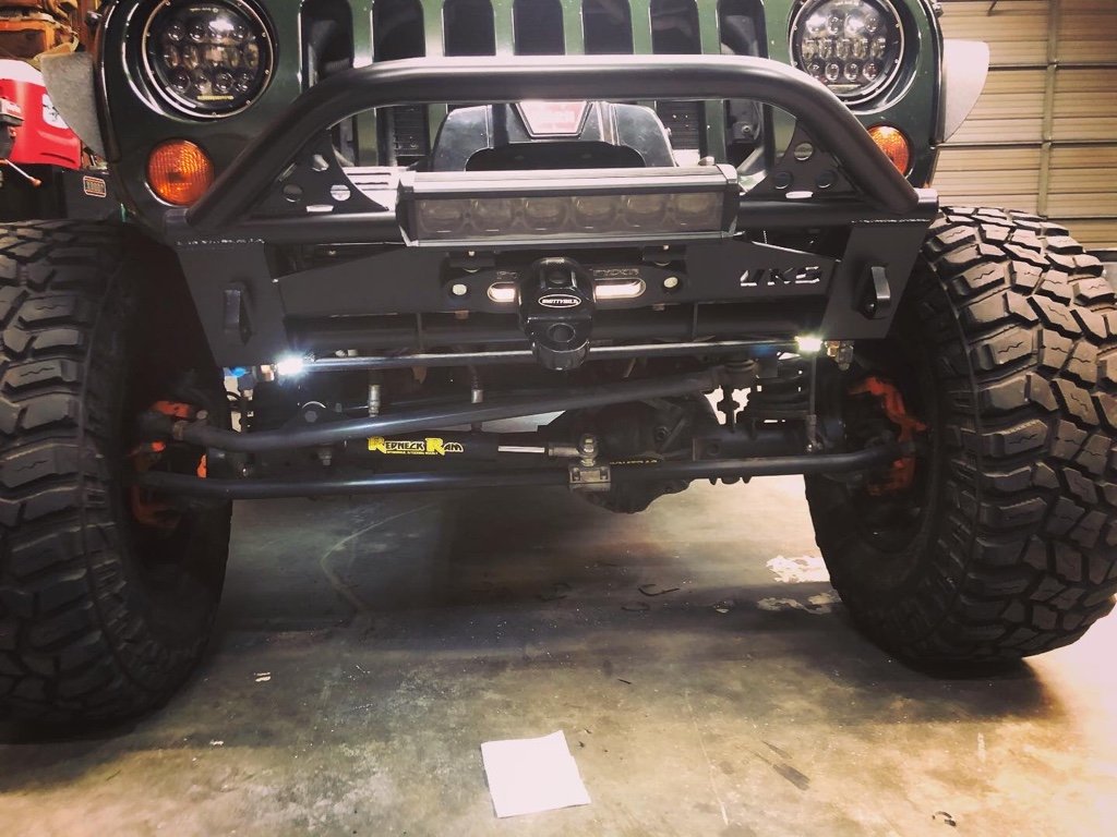

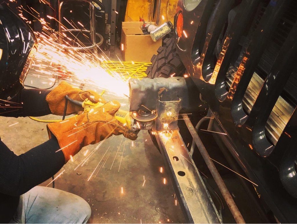

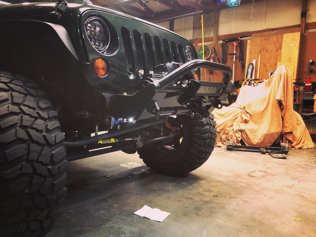

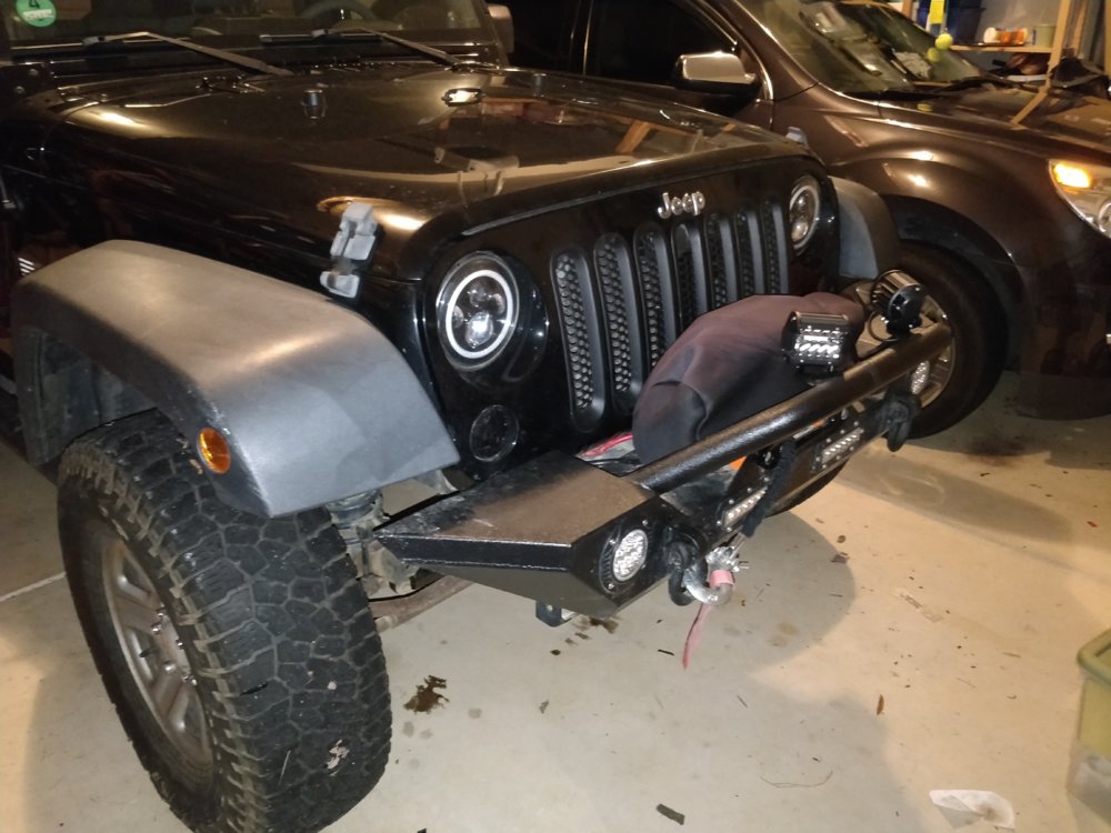

Holy Bat-Sparks, man. That looks glorious. All I did was install a leather steering wheel cover....Last night installed the VKS prerunner bumper on the jku. Had to cut frame horns off and eliminate the crash bar. 2-3” gained plus a better approach angle. The light bar will be taken off and the thimble replaced with the flat link. Next is to install the Detroit in the front. ARB has been removed.![]()

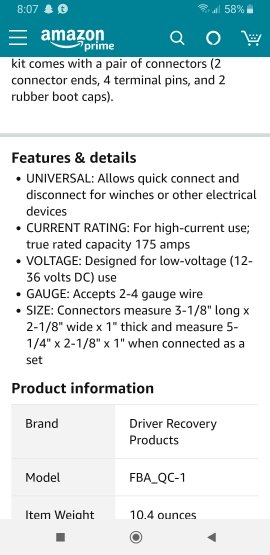

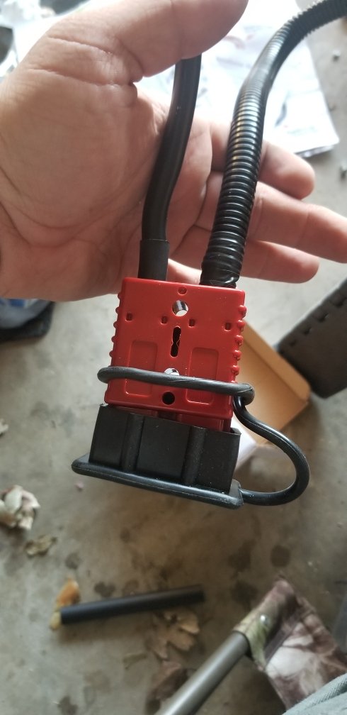

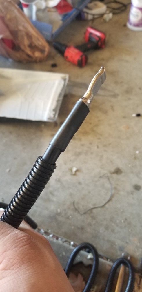

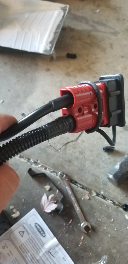

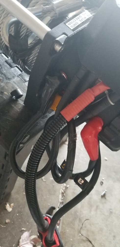

175a qd?Got the quick disconnect wired in and the solenoid on and wired up. First off those colored boot things were a pain. The quick disconect is probably the cleanest electrical install I have done. I used heat shrink to secure everything along with crimping the metal finger things. I did use electrical tape to hold the abrasive sleeve thing in place. I hope this looks right.![]()
Thanks, I remeber you talking about them with someone. That's why I decided I get them and wire them up.Looks great kieth, I have seen situations where the user wished those connections were there as it sucked the hook through the fair lead and busted the drum on the winch while he watched helpless, (stuck contact)
