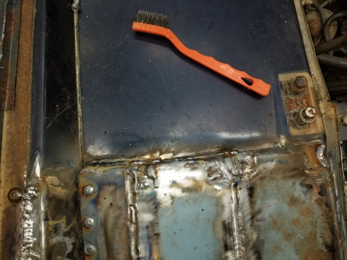

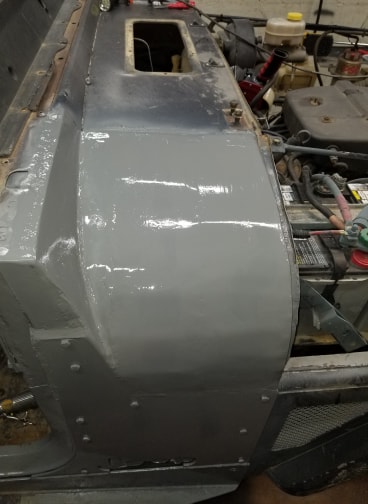

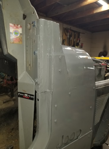

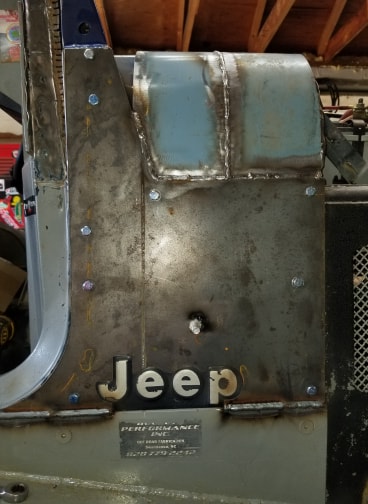

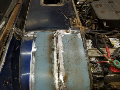

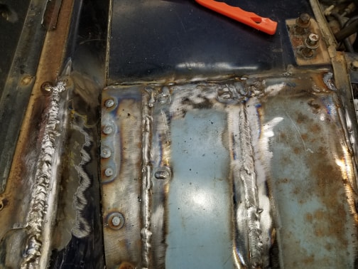

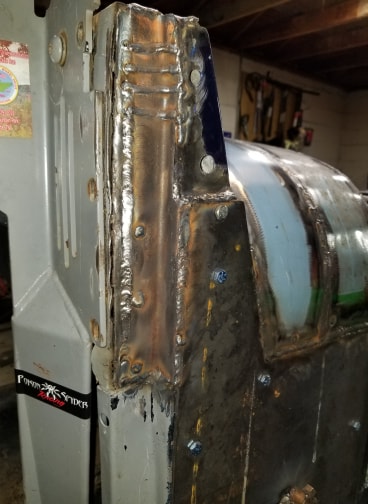

Still working on fixing my Cowl on the Heep. Pictures to follow, but keep in mind, There are not done by a professional body man. And just in case I forget to say it later. Welding thin stuff sucks!
3/16 plate on the side CNC plasma cut, ~ 1/8 plate wrapped around the cowl, double thick, and plate also welded to the corners where the windshield hinges once were. May not be Berit Jackson pretty, but, it will hold up to the rubbing that tends to get that section of every CJ, YJ or TJ that is wheeled hard. Other than fixing the gapping hole that was there, making it stronger was also one of the goals. Passenger side is done, drivers side is almost done. Also, while all of this was taking place. The heater box was removed. Found that the TBI computer was just kinda wedged in, so now it has a mount. The wiring under the hood had became a mess with add on's and such, so that was all cleaned up. Also made a battery mount to hold both batteries down. Before it had a ratchet strap. It worked, give no issue, just didn't like how it looked. I cut a pile of wiring out, to clean it all up. It's getting close. More pics to follow as soon as it's completed.

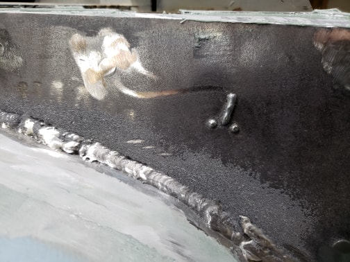

But thankfully @josh$$ is good at welding thin as well as thick, and also can weld decorative penis' in places you may never find :huggy:
Even he has cussed this project because of the thin shit LOL
I tried my hand at it, and gladly handed the torch back off to him!

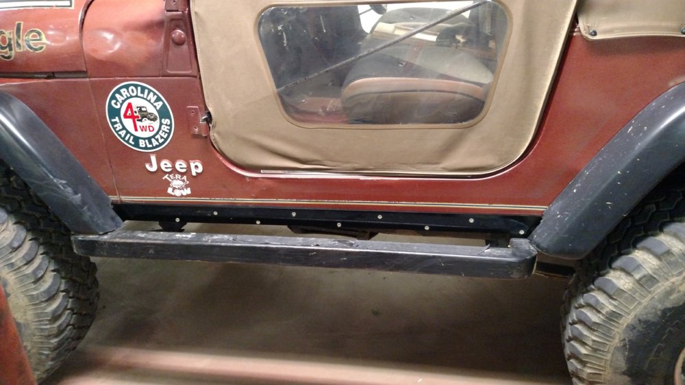

I've often wondered why there's not a commercially available piece of armor for that area.
There used to be several companies that provided for the flat side, above the aftermarket rocker armor, but I wasn't able to find any. So had a friend to cut it for me. He also did the squared off triangle part above the flat, since it was in the same plane as the side. The Curved part, AFAIK, no one has ever made a piece for that. That's why I used 2 thinner pieces (doubled) so we could get most of the curve bent around it.

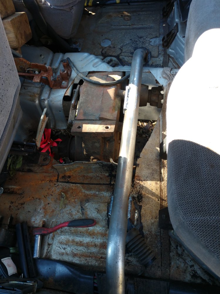

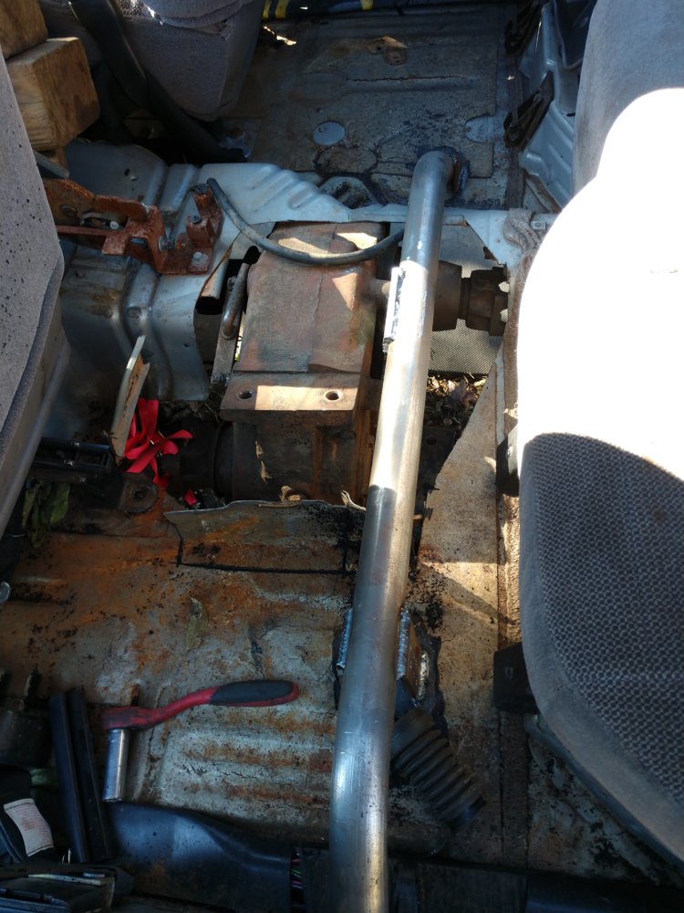

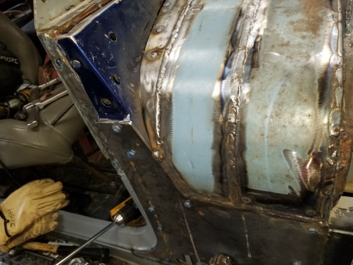

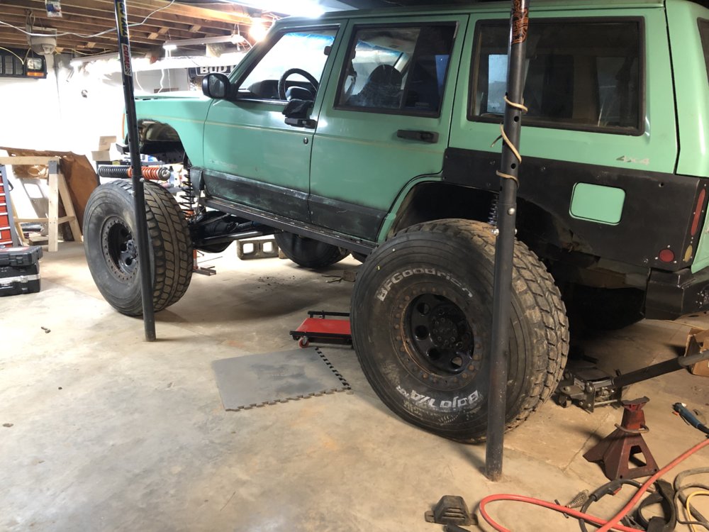

Did you just weld the tube to the floor? If so it wont take long for the twist to remove it.
Just temporary. Gonna be tied to cage and poly mounted when all done
Are the wooden blocks holding anything? Do I see welding spark burns, on the seat backs?
[Damn! Where's that fire extinguisher]
lol nope. those are that rubber floor covering crap that doesn't come off worth a darn all over the seats and inside and my face lol..and the slightest bit of it gets anywhere near the weld puddle and holy cow, it's like the california wildfire
