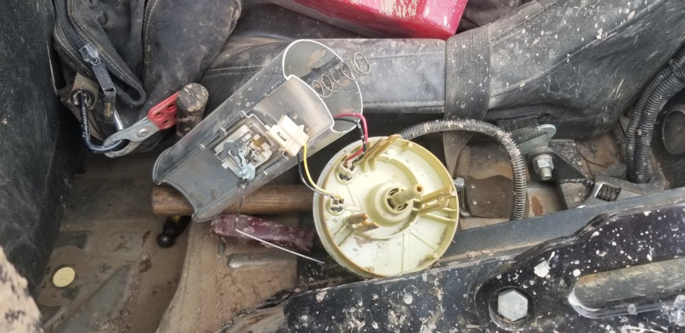

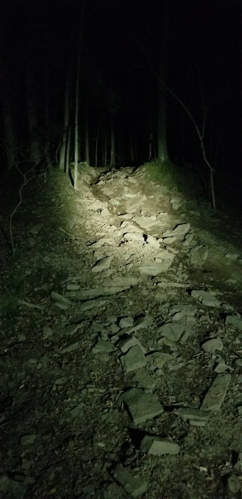

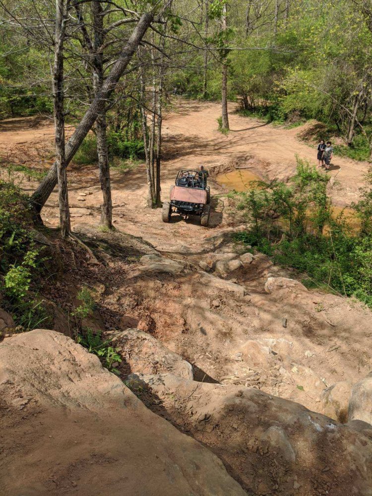

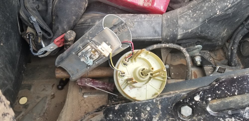

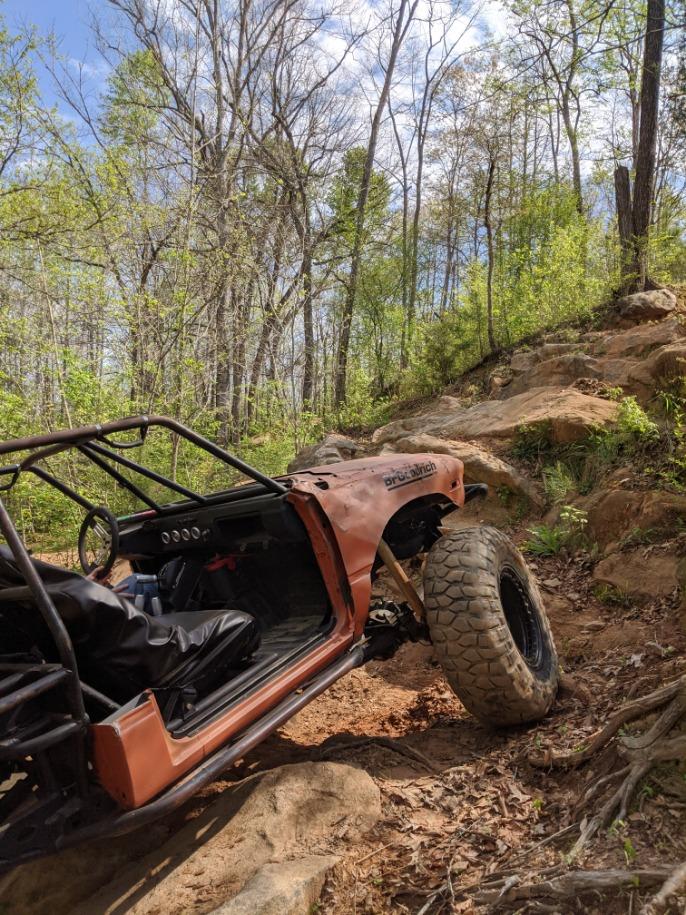

No pics but finally put a new fuel pump in it.....in the dark......in the middle of the woods. Hit a hill climb at full send in 2nd gear, jumped the Jeep and when it landed she cut off. It broke the fuel fuel assembly off in the cell, definitely a crazy break.

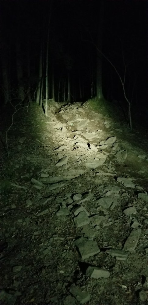

Said hill.
The fuel pumpo_O
No pics but finally put a nee fuel pump in it.....in the dark......in the middle of the woods. Hit a hill climb at full send in 2nd gear, jumped the Jeep and when it landed she cut off. It broke the fuel fuel assembly off in the cell, definitely a crazy break.
Said hill.
The fuel pumpo_O
Said hill.
The fuel pumpo_O
Does the cell not sit on the bottom of the cell when installed? Weird break, may need a better bottom support

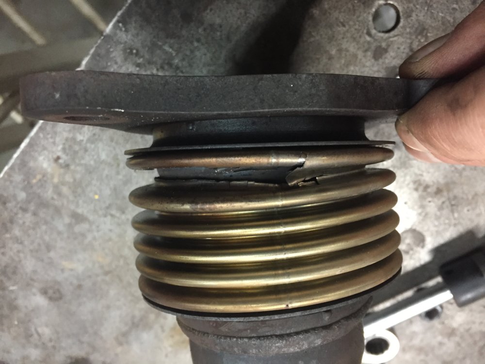

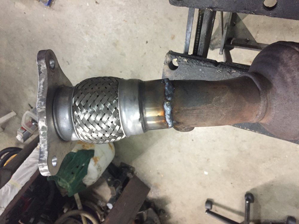

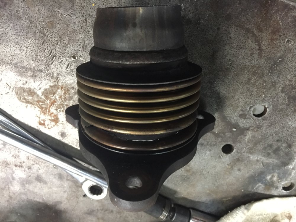

My HHR started sounding like like crap when I fired it up, the longer it ran the better it sounded. Found the expansion joint was cracked/broke. I guess when it got hot, it would close up some. Instead of buying whole assembly with cats, found a new style repair part. Out with the old and in with the new. $27 repair.
Old part
New
I don't think it sits on the bottom I'm gonna look into. It definitely is a weird break and I can't be the only one with a Motobilt cell that wheels slightly harder than a grandma.
How much fuel was in the cell? A good slap from the slosh of the fuel and the shock of the hit could probably wipe out the brittle plastic on that pump?
About 3/4 or so, from a brief bit of research Pirate showed some threads about this back when the RCI tanks were the rave. I think it may have been hurt for awhile, thing wouldn't hold prime anymore so I'm betting all those Sunday drives to church did it in.
