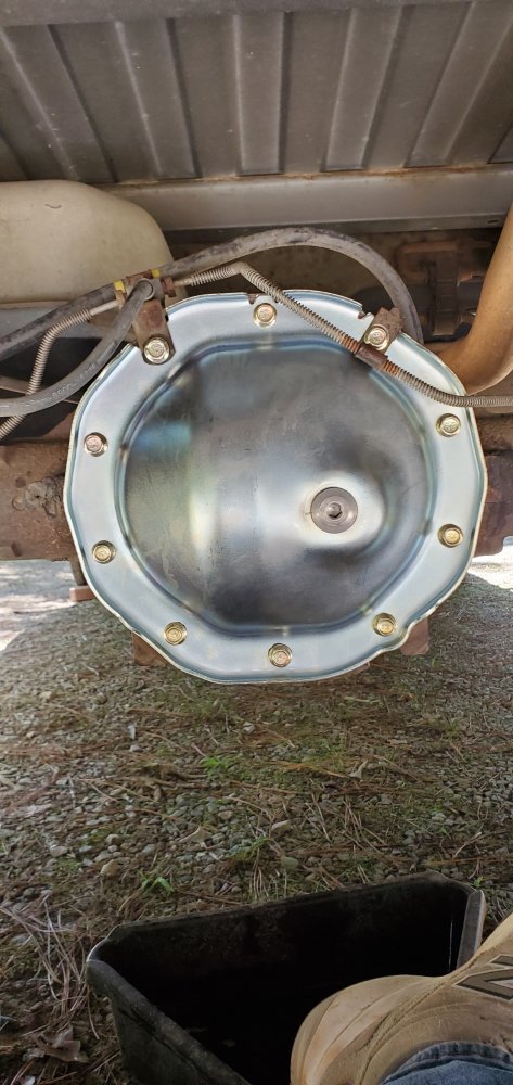

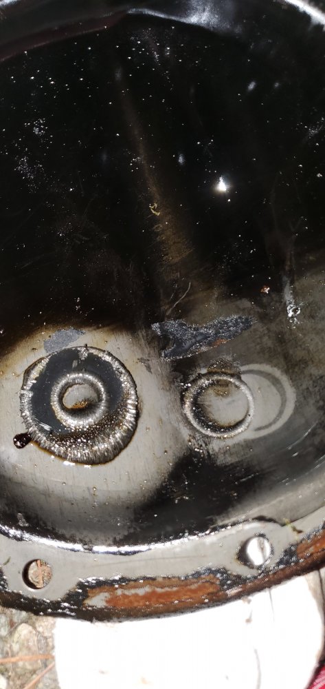

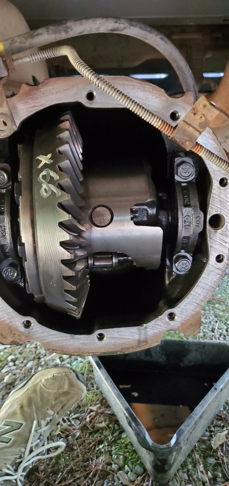

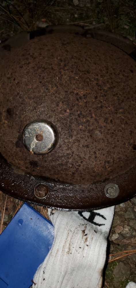

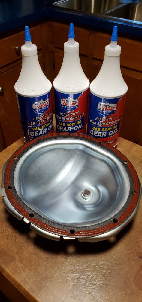

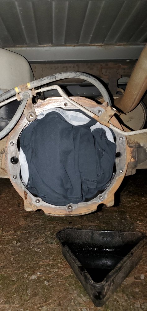

I cracked my rear end open and let it drain and stuffed some underwear in it so the scabs would not get in my rear end
Then I scraped most of the dingleberries off my rear end.There is some metal in the cover, I added another strong magnet bout 6 months ago and you can see what it sucked up, I moved it about 3 months,you can see the ring to the right of its position now beside the factory magnet....

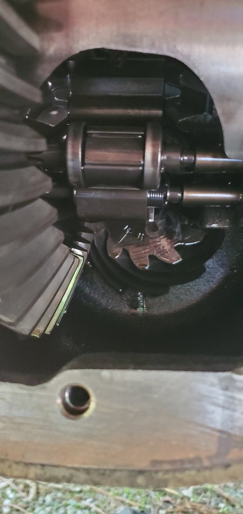

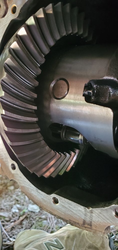

It's a G 80 in there and it looks pretty clean inside, pretty tight too.gonna slap a lubelocker and new cover in the morning.
I hope when my rearend shits the the bed I can reuse the lubelocker.

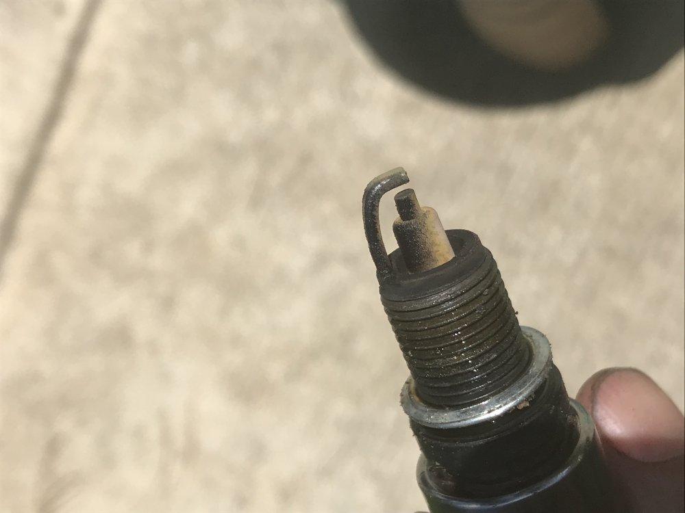

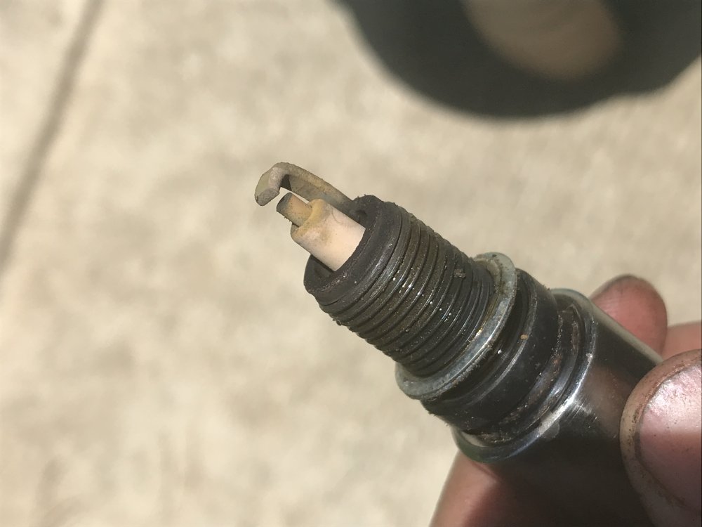

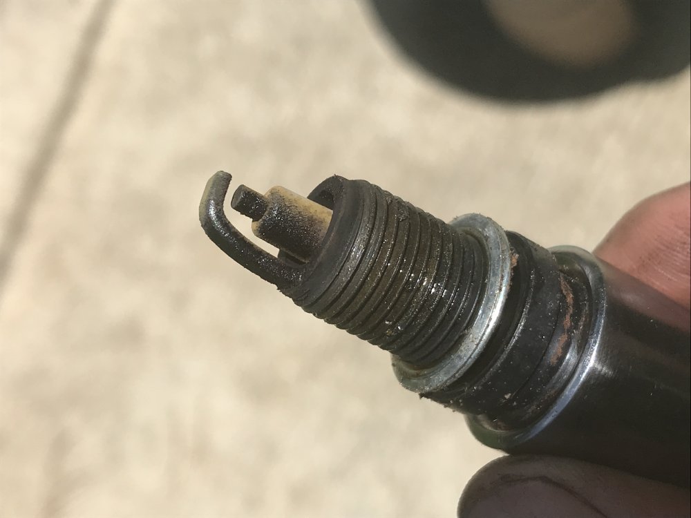

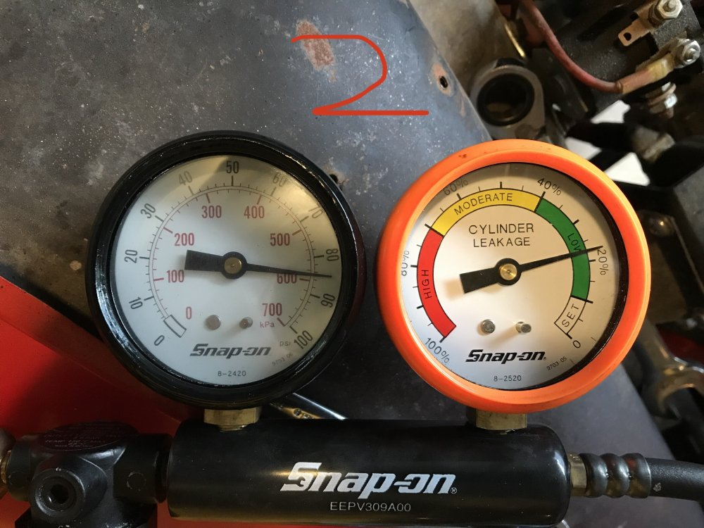

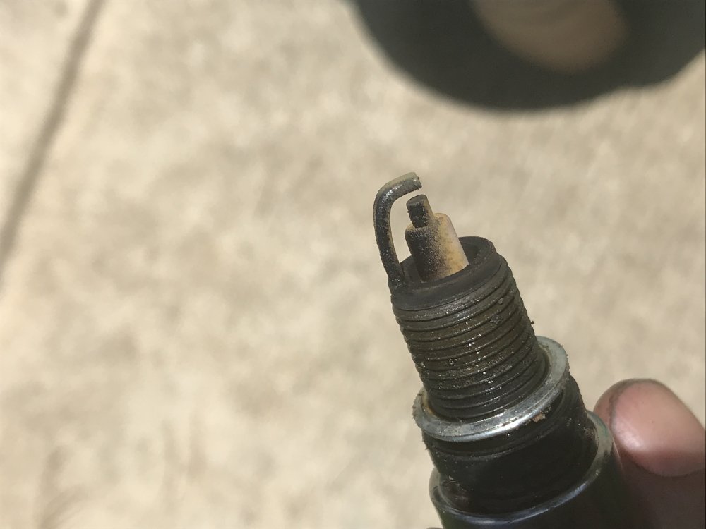

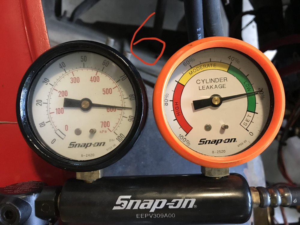

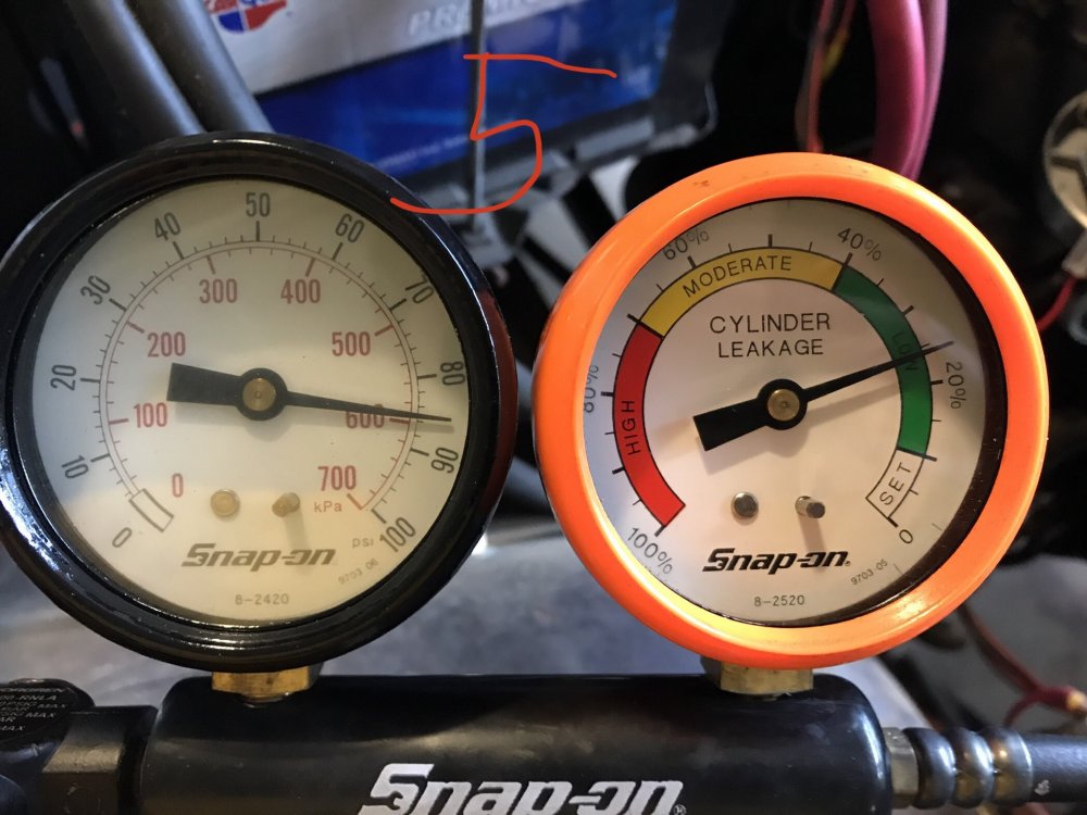

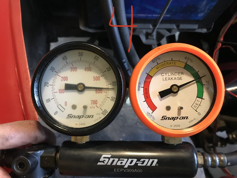

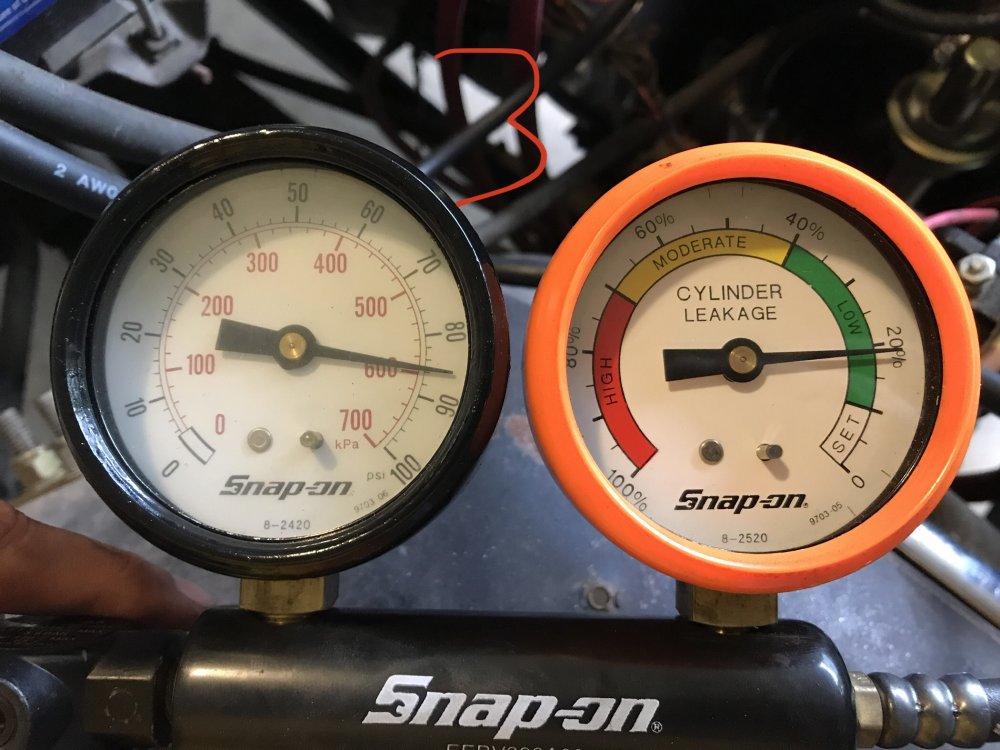

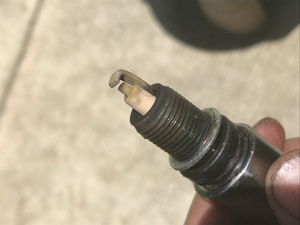

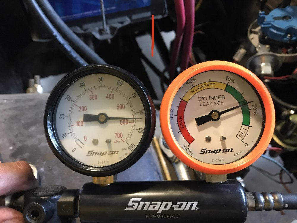

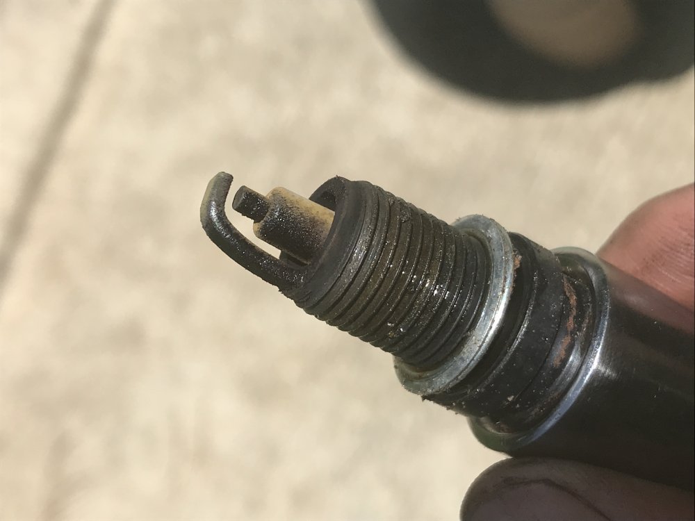

The clean plug looked decent. The oily/carbonated ones, not so good. I've got low compression on 1 cylinder, where the plug show some oil, but not as bad as yours. Had 1 engine years back that due to overheating, it Cooked the rings. Added 2 Qt.s oil with every fill up! Plugs looked more caked with carbon, than oil, but it was sucking oil. I don't know much about the Leak down test, but it's confusing you have near same reading on all test. :confused:

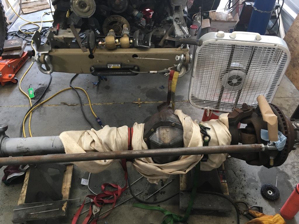

Welded the tubes to the center section on my super booty Dana 60. The drivers side has the casting cut off so I wasn’t going to leave it alone. Not really inclined to put a truss on this since the housing is massive.
Preheated to +400 degrees F then hit it with 3 passes of 7018 on the ol stick machine. Post heat and wrapped up for slow cooling. Would have liked some nickel rod but this should be good.

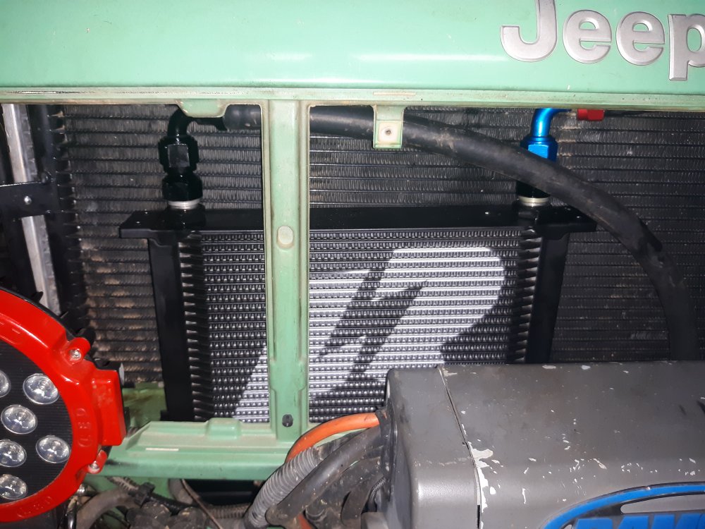

PSC CBR pump, all lines sized to psc specs, 30 row cooler up front, anti splash vent thingy..even added a temp gauge. The new pump has way more power. Hopefully it will last a while

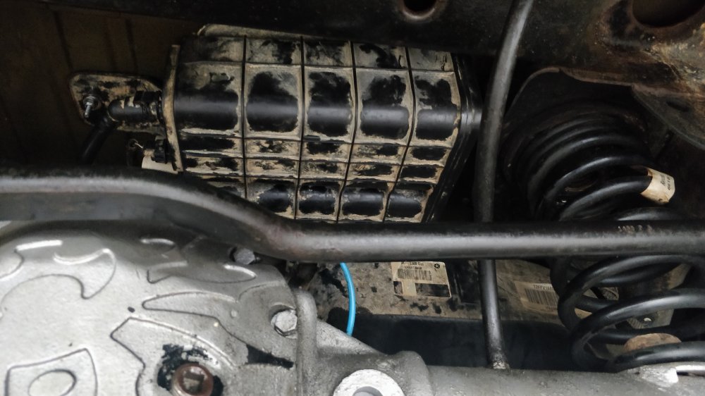

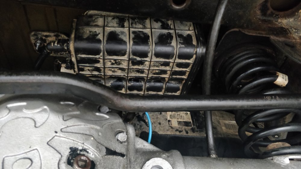

Relocated the Evap Canister on the Jeep. I don't know why Chrysler thought it was a good idea to mount a plastic box on the lowest point of an off-road vehicle.
Safely sits over and behind my rear diff now.
I did the poor man method and mounted it directly to the tub. I painted the holes I drilled to prevent future rust. All told 3xbolts, washers, locking nuts and one foot of 5/8 fuel hose. Dirt cheap mod.

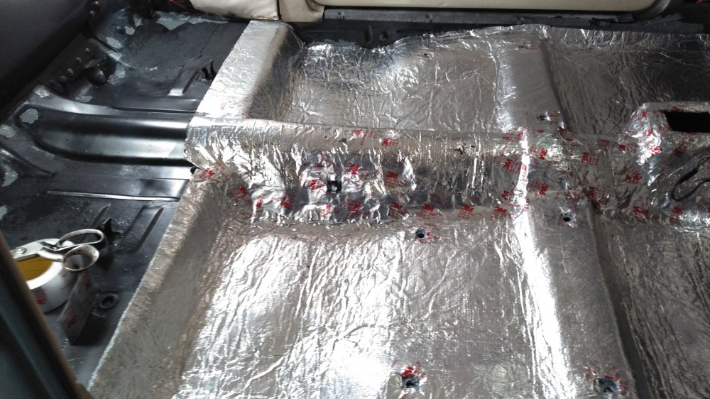

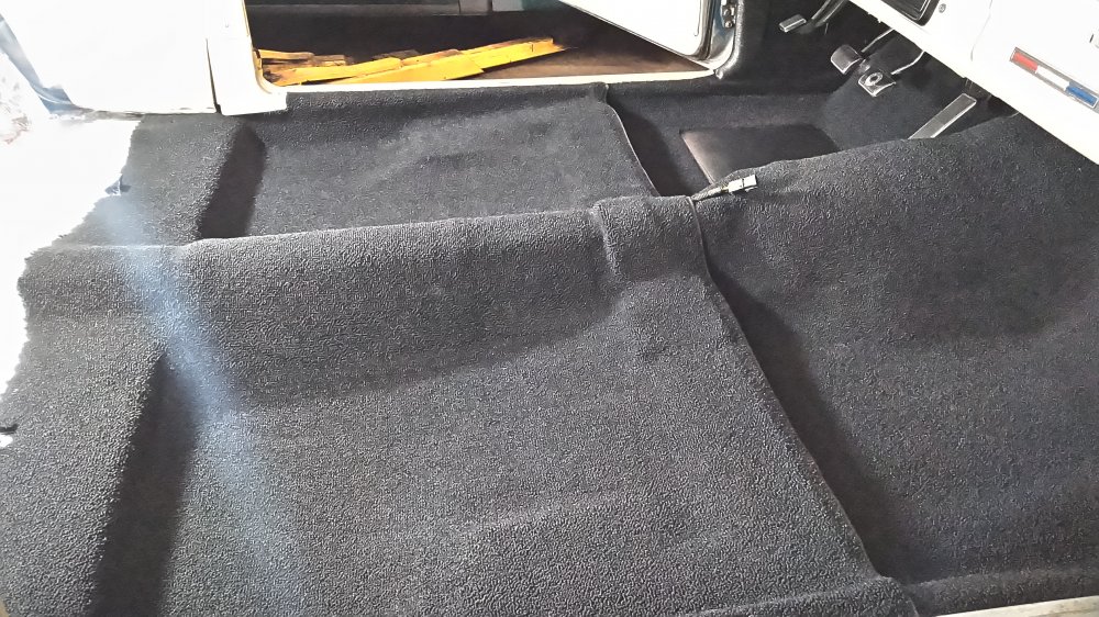

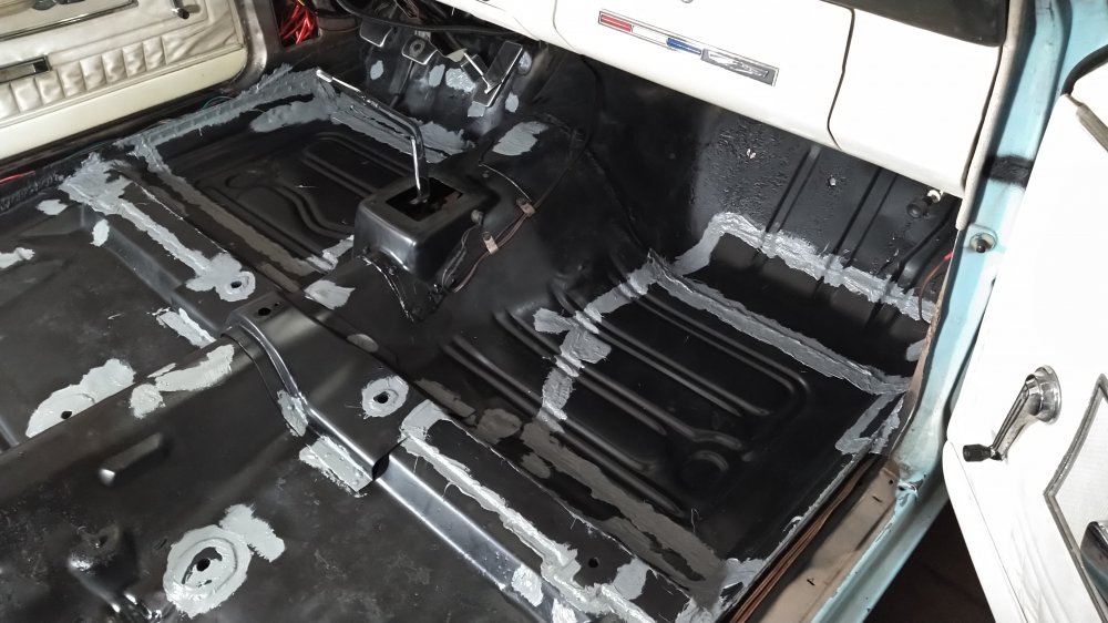

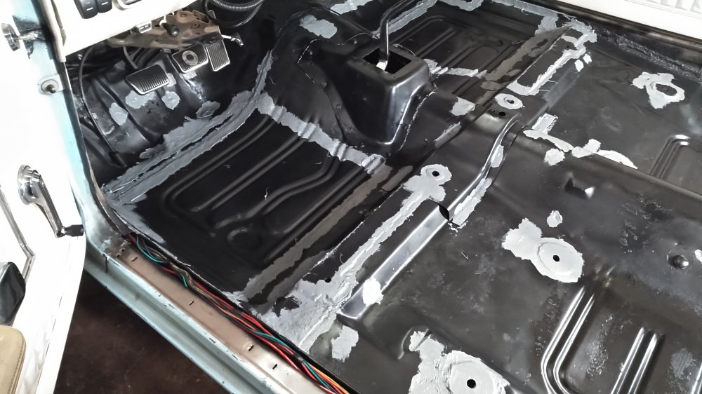

Not the 4x4 but I got the new carpet/floor pan patches finished up on my Fairlane. I'm going back with stock interior, removing the roll cage and shitty racing buckets.

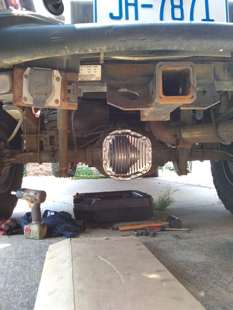

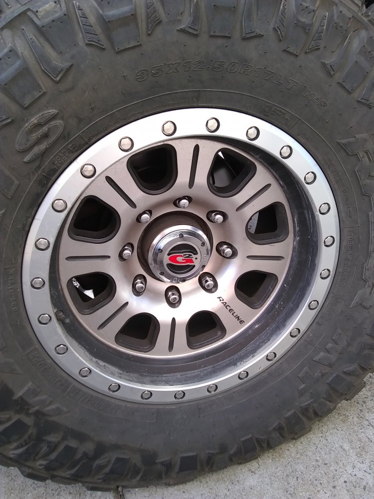

Threw some bling and hopefully some more reliability at the ole F-350 recently. Did an 08+ aluminum diff cover and lube locker, with some G2 hubs to replace the factory plastic ones. For less than $50 on the cover it seemed good enough deal to try it out. And $130 for the hubs was a smoking deal on Amazon that @adamk told me about. Thanks again holmes. :rockon:
That hub and wheel combo just looks amazing. So much better than the stock hubs
In all fairness, whoever said JKs were off-road vehicles?
But I thought that's what the "Trail Rated" badge meant?
You mean that's just a marketing ploy that they stick on everything (including a Fiat err... Jeep... Renegade)?
I feel lied to... Damn it, now I need to add more parts to my JK to feel more secure in its off-roadness... Skid plates should do the trick! And more LED lights!
Damn you and the Crocs you walk on!

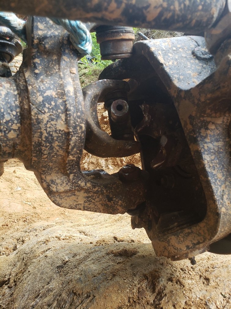

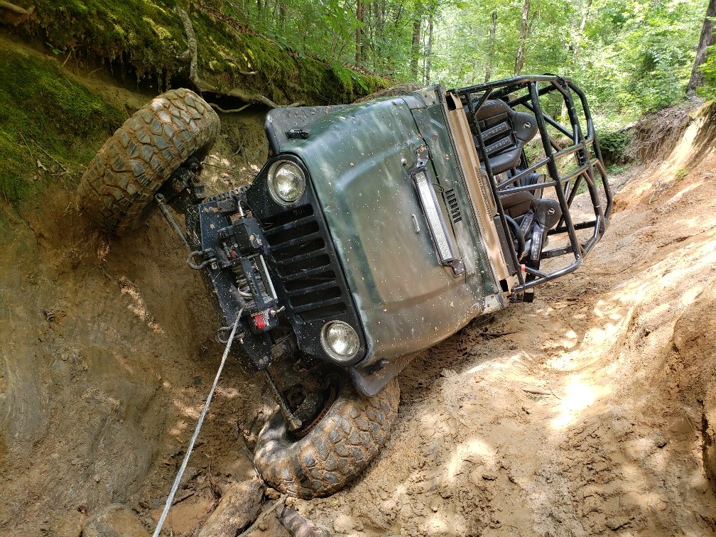

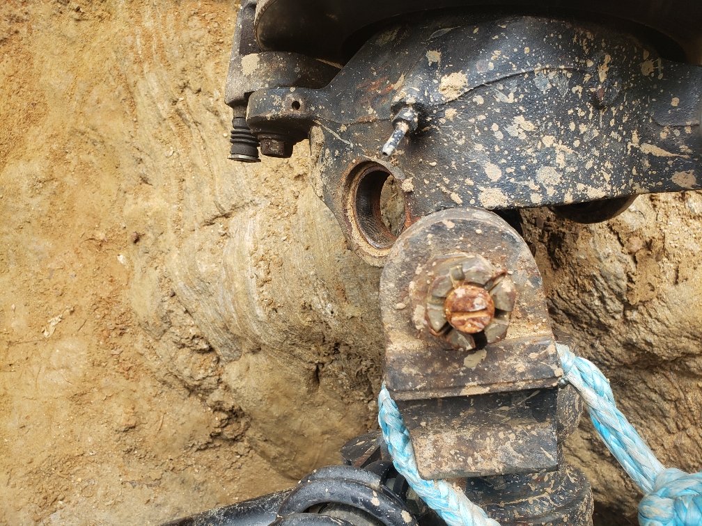

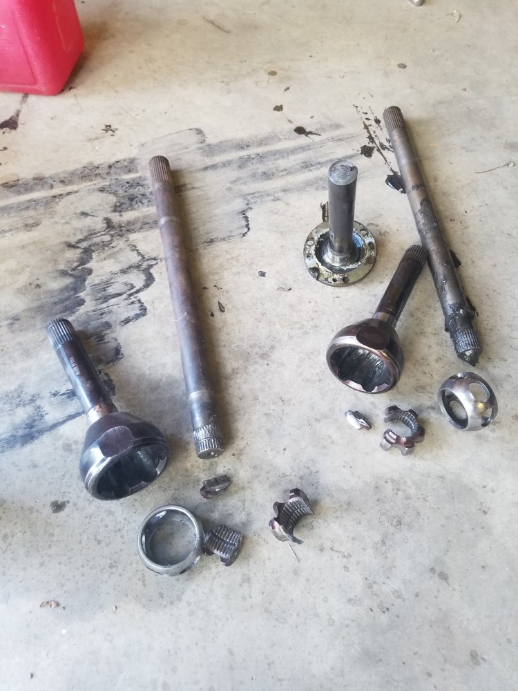

Just an FYI, if you break a shaft on a BJ super duty 60 you also lose the ball joints and the knuckle falls off. Ask me how I know lol
Sent from my SM-G965U using Tapatalk
BJ eliminators solve that. The ones for a 60, not getting married.

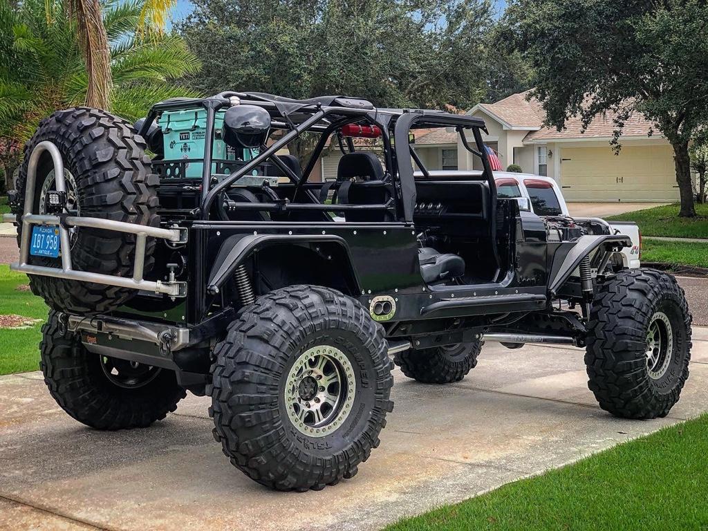

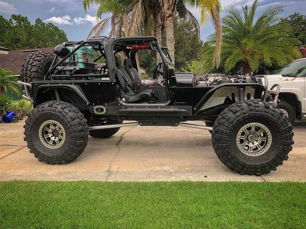

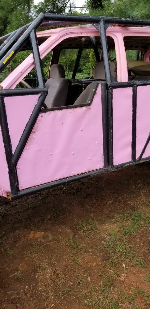

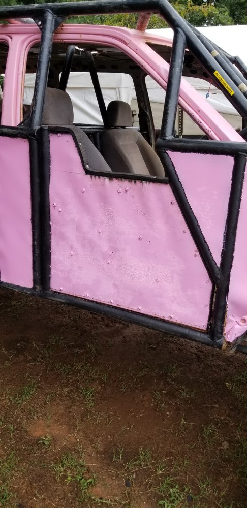

Got me some cool doors made on my rig, love working with square tubing, so much neater and cleaner looking.
