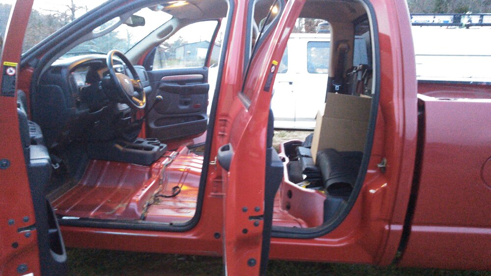

Replaced heater core in it and cleaned out more dog hair and nastiness that was behind the dash while I had it torn apart Monday. Pulled fronts seats/carpet this evening to see if that gets rid of the remaining stank. The carpet did have water under it in passenger side even though it hasn't rained significantly in a long time....thinking I want to put vynil back in its place. If it still stinks in the morning guess I'll pull er thang else out 😩

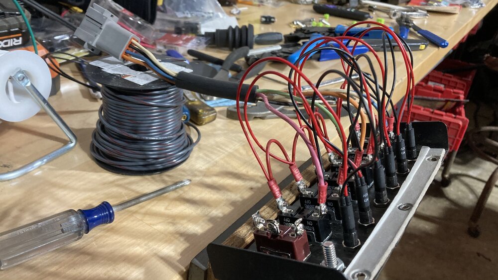

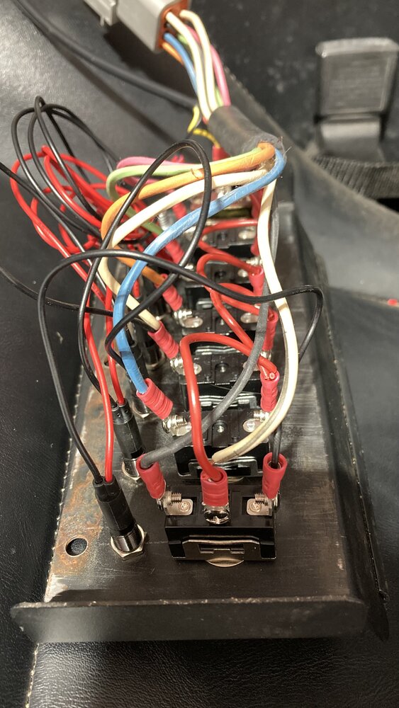

Finished the switches and whatnot in the cab.
I’m not that happy with how I ran the wires, but it was convenient. Last thing to do is the final terminations.

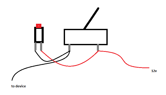

Somethings screwy somewhere.

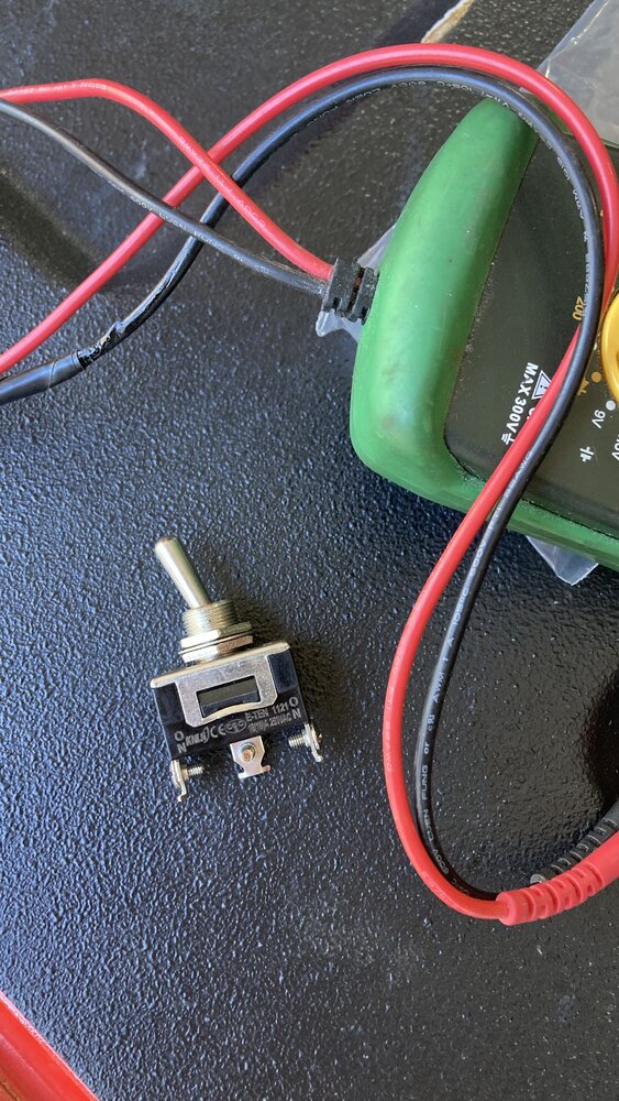

I've started doing final terminations at devices, so far I've only made it the to the two relays under the hood. When I put power to the switches (keyed source) the LEDs that coincide with those two switches are ON when the switches are in the OFF position and OFF when the switches are in the ON position. I know the switches are wired correctly as the relays are operating correctly, but somehow the LEDs are operating in the reverse.
I think my issue is how I've wired the LEDs, below:
Currently I'm thinking I need to run the LED from the "device" side of the switch to a ground instead of running through the switch like I currently have.
Thoughts?
Thoughts?
You will want the led powered from the device side of the switch, and the other side grounded.
