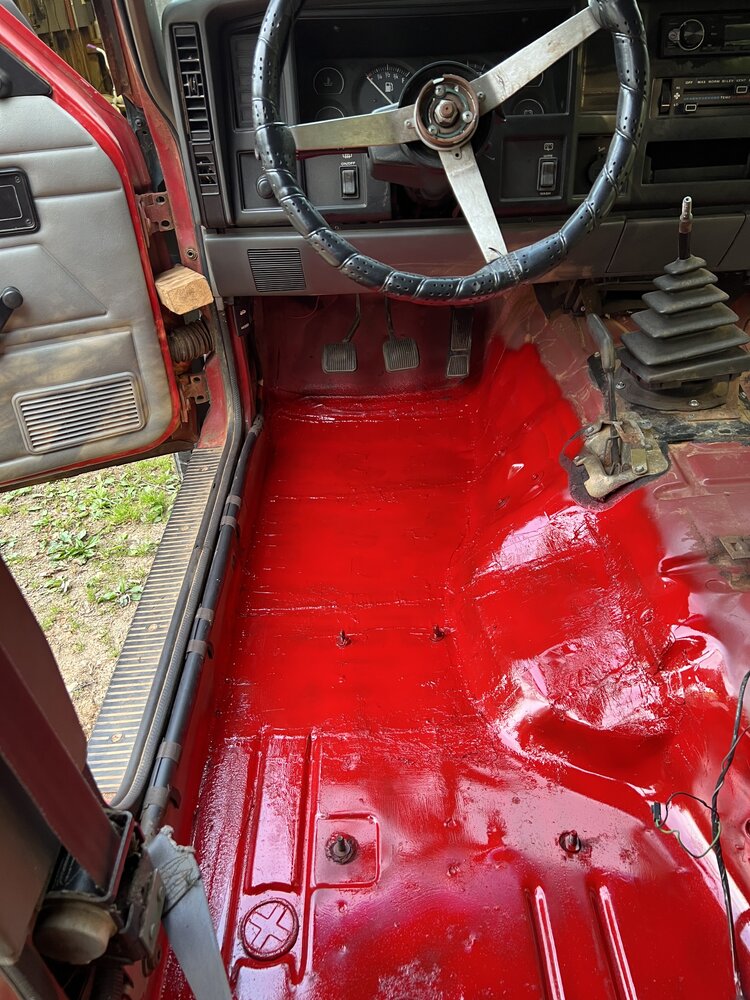

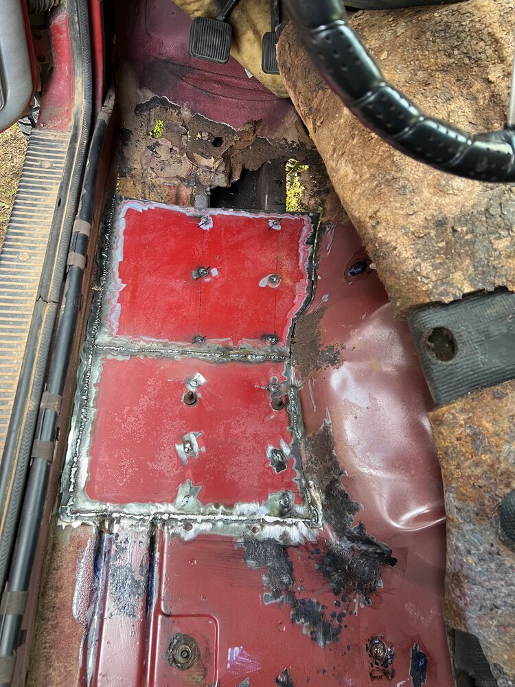

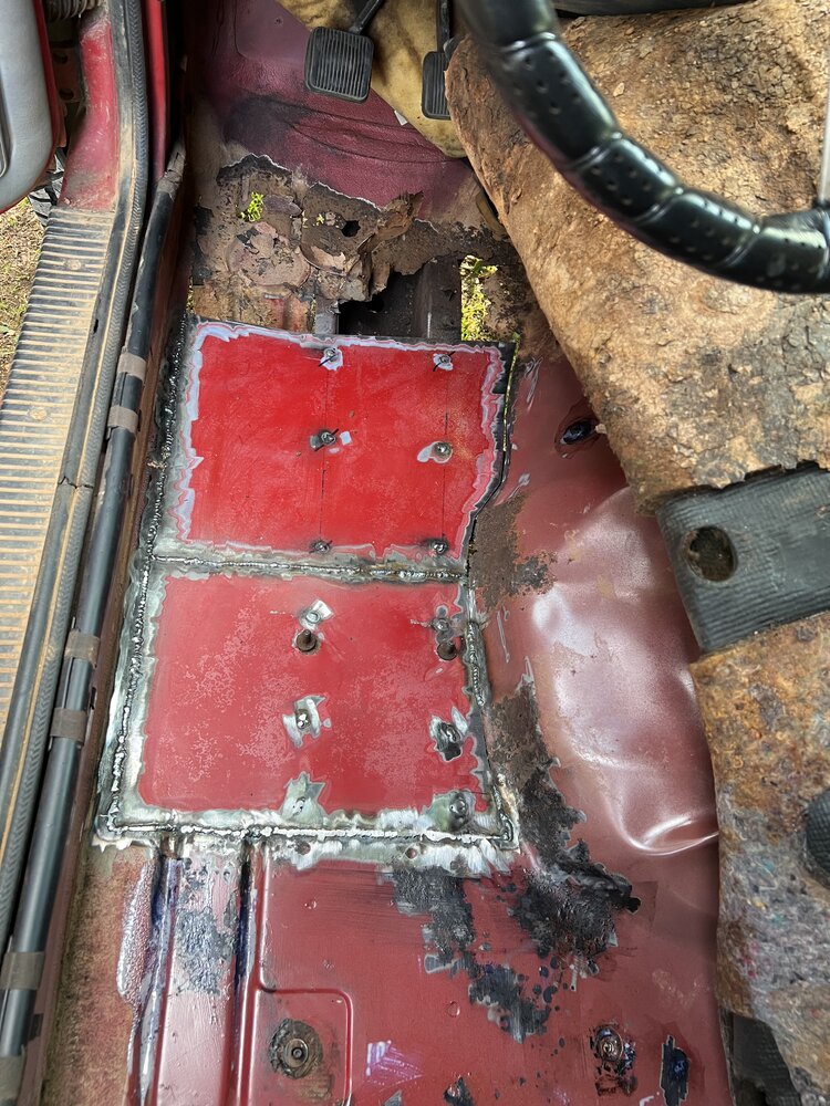

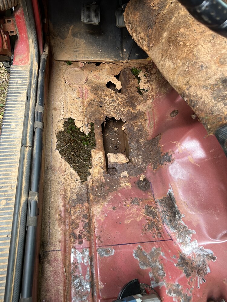

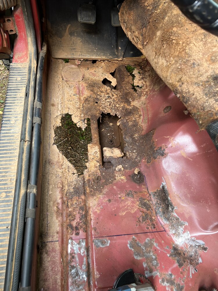

Nah, it's fine. Patch it up enough to keep water out and it'll be good enough. Slap a bunch of seam sealer over your welds and put the carpet back down. My old 2door was much worse when I started.Making brackets to stick some Amazon buckets in the XJ, and decided to patch the rust while I was at it. Big mistake. I’m in way over my head on this one. View attachment 416410
That is the plan, short of putting the carpet back in. I’ll leave it out for a while, at least until I’m convinced I don’t have major leaks.Nah, it's fine. Patch it up enough to keep water out and it'll be good enough. Slap a bunch of seam sealer over your welds and put the carpet back down. My old 2door was much worse when I started.
I hear flex seal will have your cabin dry when doing river crossingssMaking brackets to stick some Amazon buckets in the XJ, and decided to patch the rust while I was at it. Big mistake. I’m in way over my head on this one. View attachment 416410

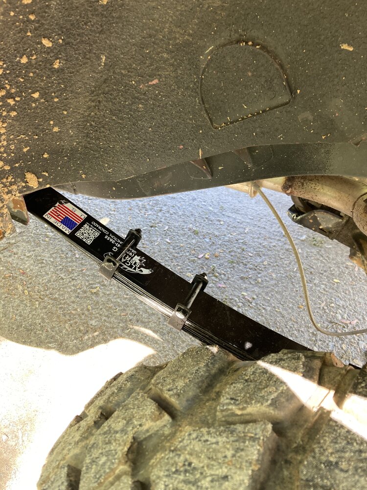

View attachment 416488View attachment 416489Only replaced one side but at least it sits level now. Also added some sights to help prevent grip it and rip it.

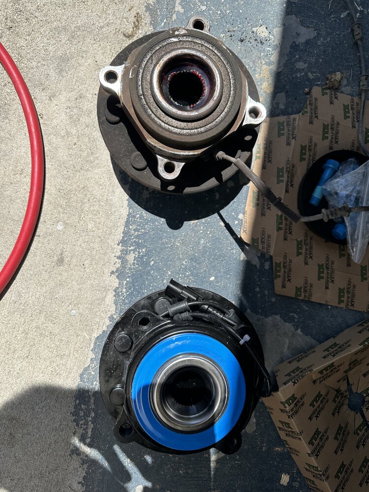

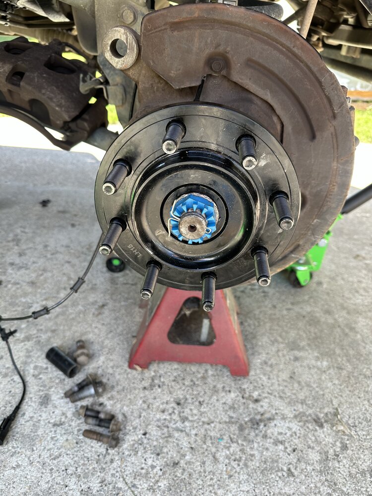

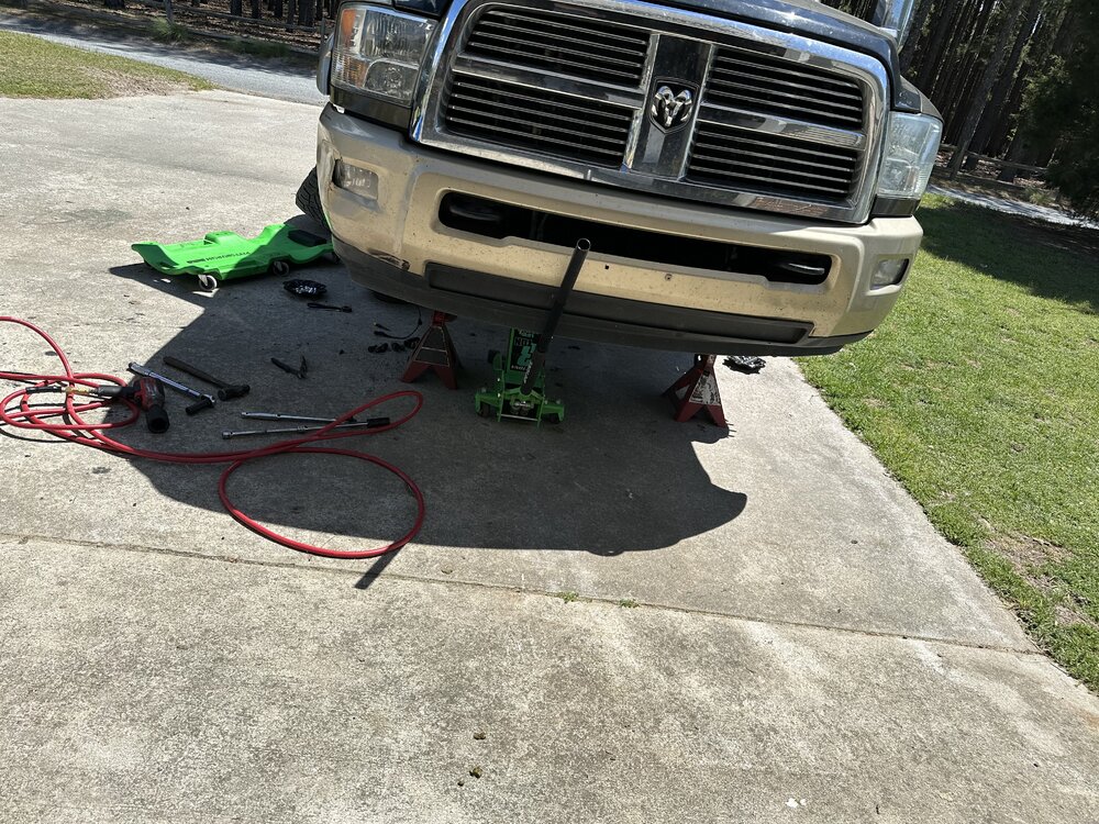

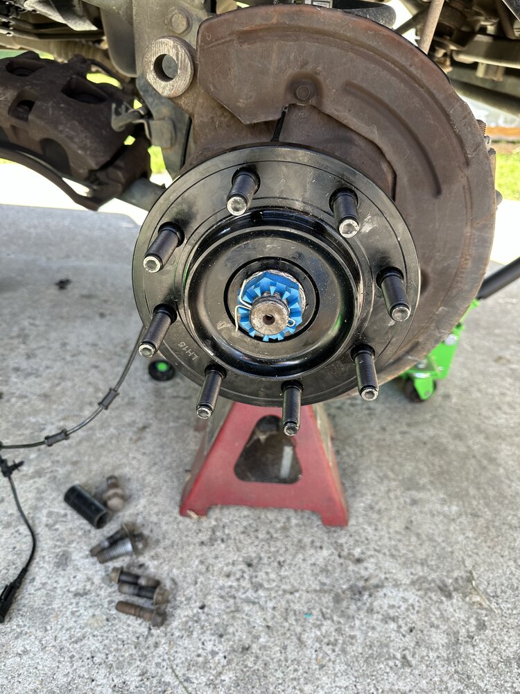

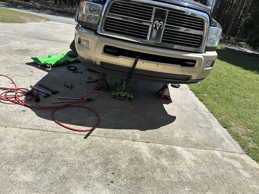

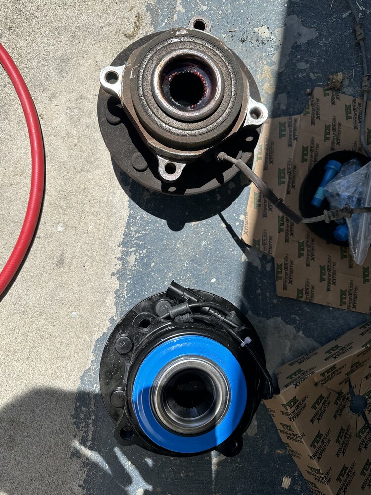

So to follow up. I’m thoroughly impressed with these new hub assembly/wheel bearings (time will tell the truth). Now to the facts. I installed the hub assemblies because the noise/ vibration I heard was coming from the front and was tell tale hub assembly getting tired. Based on time and mileage since I had installed the last set I was certain of it. Well, new ones in and the truck produced a new noise. Very high pitched squeaking that was in time with the speed of the truck. Thinking I had fawked up, or that these new hub assmeblies weren’t all they were cracked up to be I had the truck part no less than 4 different times checking, rechecking, and checking again that I hadn’t done or missed something. Final straw was the wife was headed to town and sent me a video where it seems like the front end was coming out of the truck!!! Got home from work, got it on jackstands and turned the tires over and everything sounds like the front diff. FUCK!!! Dropped the tie rod down out the way and pulled the front diff cover. Sitting under the front looking at the gear set I reached over and was spinning the drivers tire with my right hand and it was perfect. No shavings, at 300k the pattern looked great. FUCK. Now what? As I’m spinning the tire to inspect the gears again my eye goes up over the diff housing to the front drive shaft and it’s flopping back and forth like a dem at voting time. Well shit!!! Pulled the front DS and noise is gone!!Not mine but the wife’s. New wheel hub assemblies. Rock auto was the best price and I’m trying out the Mevotech TTX. They are supposed to be a “heavy duty”. We shall see. I will say the finish is very nice and comes with a new axle nut and the 4 mounting bolts that were also coated. View attachment 415851View attachment 415852View attachment 415853
Honestly I don’t remember the guys name I bought it from. He did all the tube work and it was his girlfriend’s jeep to begin with. I pretty sure she forgave him enough to marry him later.Noticed the 4x4Grace sticker on the back, that was the crew I rode with many years ago. I recognize the rig I think. Did it belong to Justin Whitt?
If that's the rig I'm thinking of, and I'm pretty it is, they did get married. She actually passed away a few years ago from cancer and he lives in California now.Honestly I don’t remember the guys name I bought it from. He did all the tube work and it was his girlfriend’s jeep to begin with. I pretty sure she forgave him enough to marry him later.
Go to look up a rebuild kit as the ball and socket in the front DS was toast. Honestly I can’t complain cause with factory parts at 300k I’m amazed it hasn’t given an issue. Interweb says $275 for all parts to rebuild the DS. Look on rock auto and realize I can buy the whole front DS complete, bolt in for $300. New DS is on the way.
TLDR; Moral of this check your front DS when noises are Preston in the front end of your truck…..
What a pain in the ass.

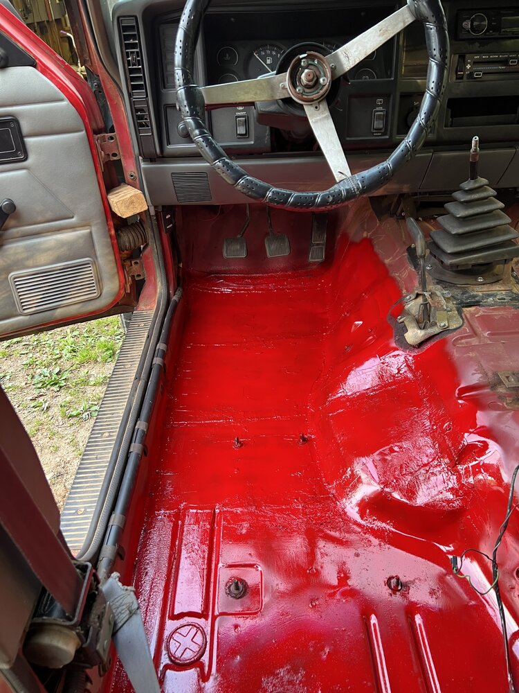

Can’t even tell I was in there, except for the slightly flatter trans tunnelNah, it's fine. Patch it up enough to keep water out and it'll be good enough. Slap a bunch of seam sealer over your welds and put the carpet back down. My old 2door was much worse when I started.
Have you considered putting a couple of drainage holes in there?
The goal is to not need drainage, but yes I probably will.Have you considered putting a couple of drainage holes in there?
