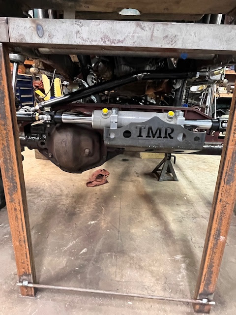

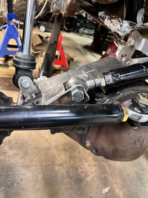

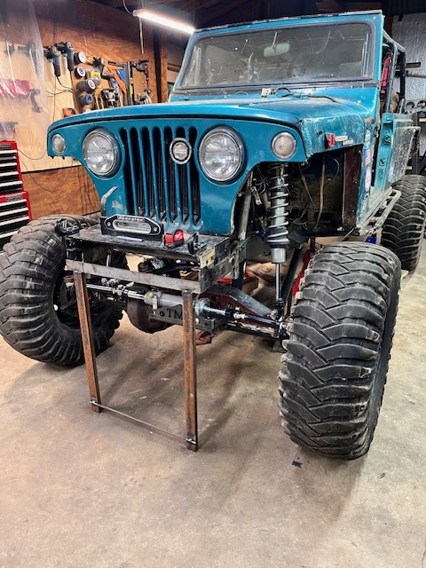

Rounding 3rd on the 3 link. Panhard gave me a fit but it's done and I just need to do bump stops now.

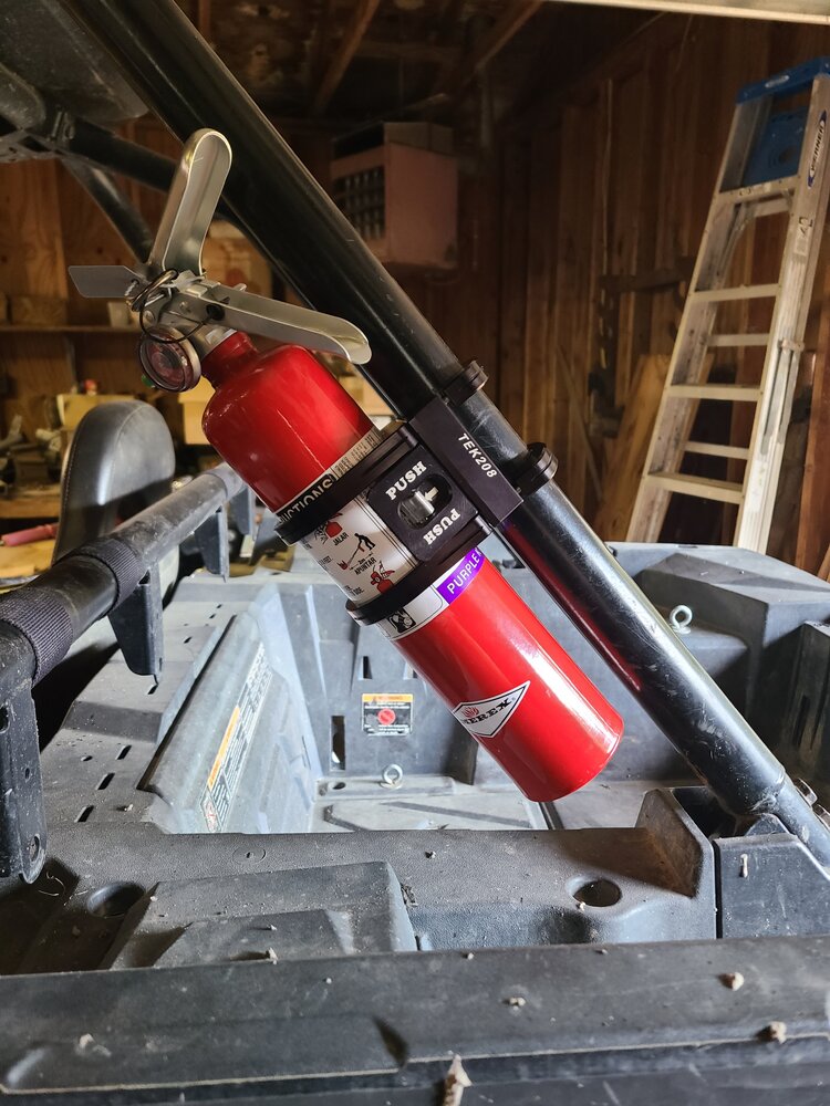

I ordered a few goodies for my RZR. Hopefully I'll manage to get in on a riding trip this year, but if not, oh well.

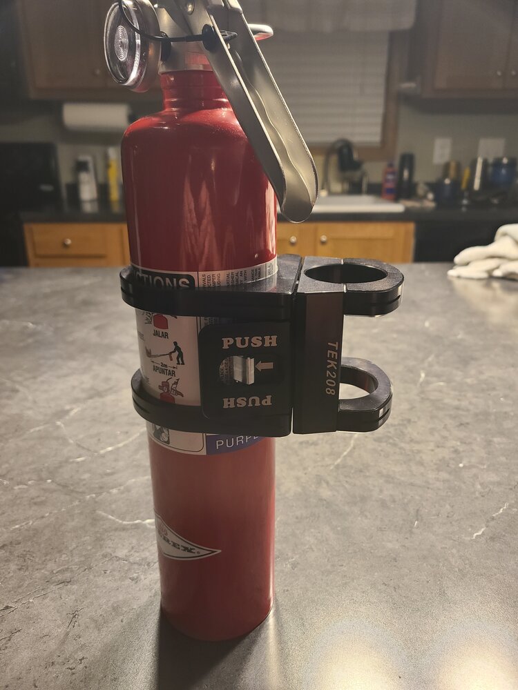

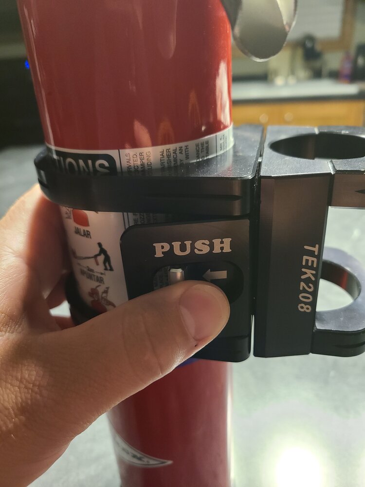

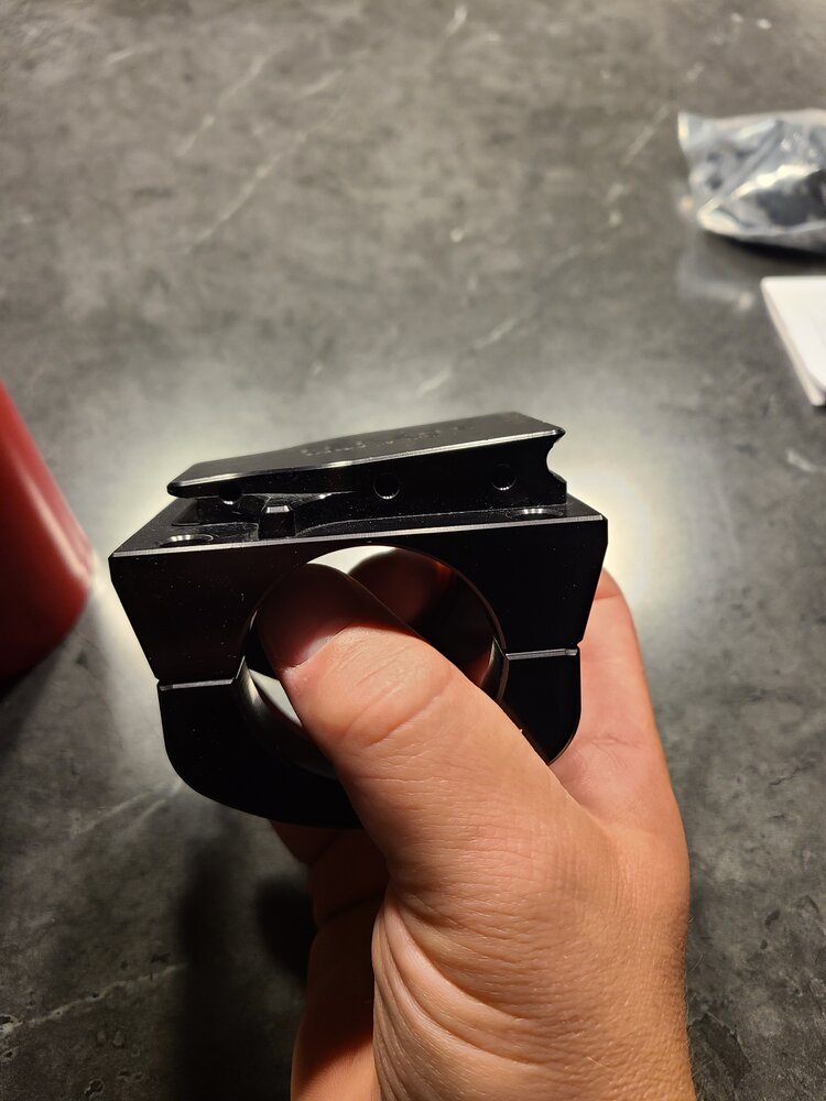

Anyway, I'm catching up on some actual *needed* items. Safety third...right? I'm pretty jazzed about the mount I decided on. It's simple, solid, and suuuper easy to detach and reattach with one hand. It shouldn't rattle either, but time will tell.
The mount is from Tek208. They make several different sizes and even a flat backed one that can be bolted to whatever you may have. This one has 1.75" clamps on the mount body and 3" clamps on the extinguisher side.
I went with an Amerex model B410, which is a 2.5 lb Purple K extinguisher. I figured it would be better suited to the SXS world since it was developed as a better alternative to put out grease, oil, and fuel fires. Plus, from what I've read, it's non-toxic. Of course, I wouldn't inhale any of them...ideally. Readings also have said it's less corrosive than an ABC after the fact.

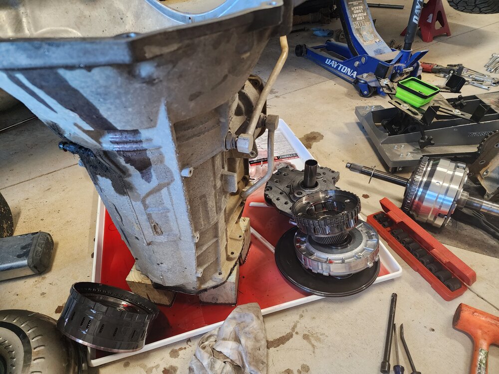

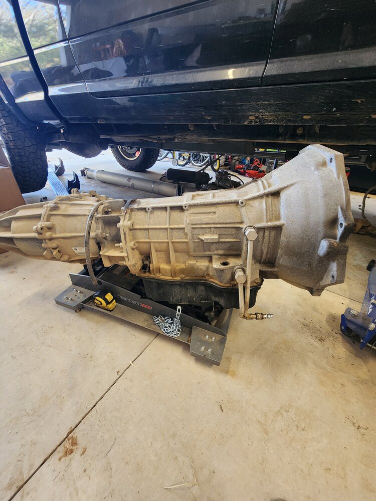

Oh you know, 68rfe things 🤦‍♂️
Randy's can send you out a nice, red one to go right back up in there! It may require a blank check though :rolleyes:

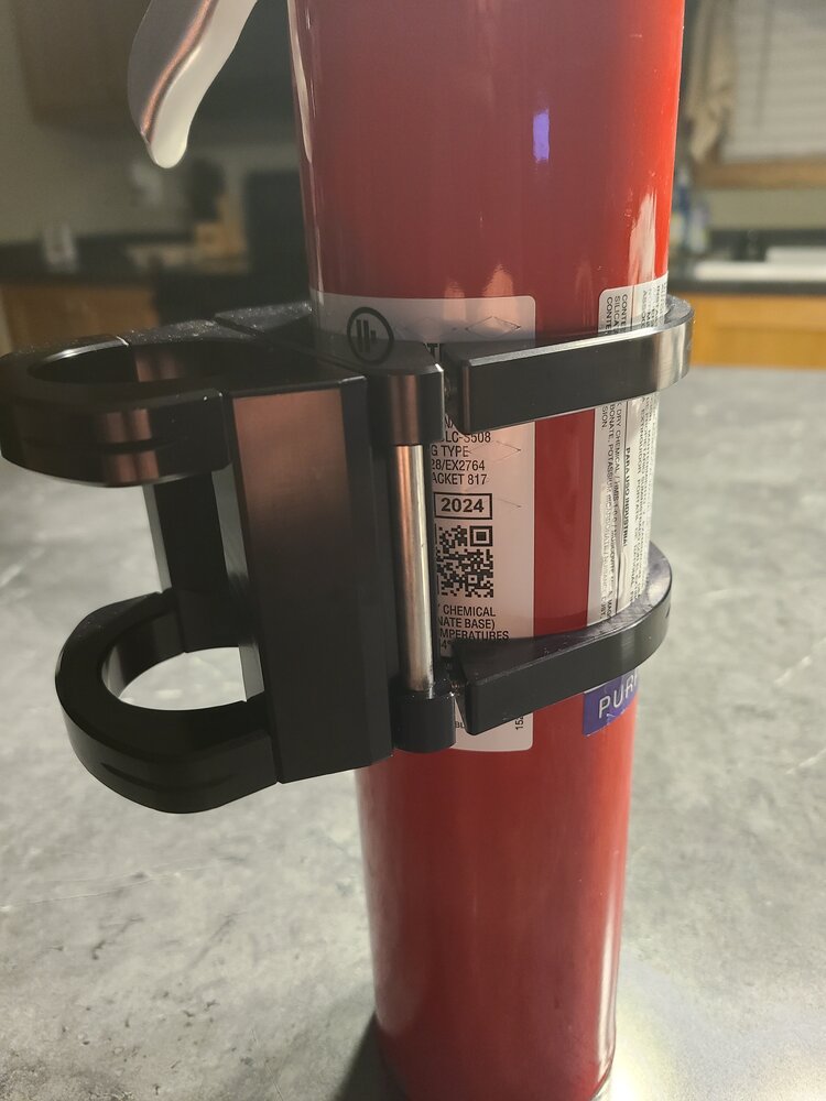

Oh, as a follow up to my pics a few posts back. It takes the sting out of buying boring safety equipment when it's really freaking cool! I had a spare plastic cap laying around that I stuck that on the end of the nozzle so it doesn't get packed with mud or dirt daubers. I know it's just a fire extinguisher mount, but it's kinda badass :D
