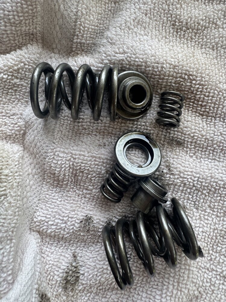

Put performance governor springs in the 98 Dodge.
Big difference 2000 to 3000 now.

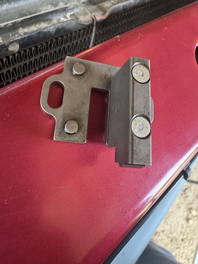

Well I put in a #11 plate cause autos don’t like much more…
Governor springs.

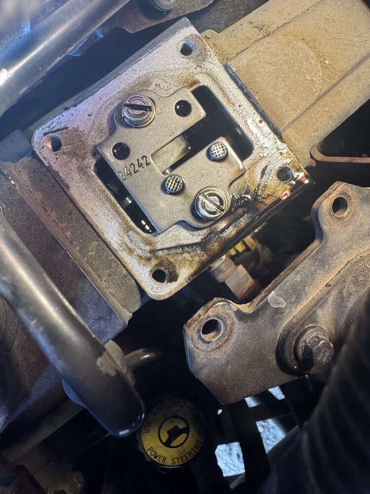

Set the plate 1/8” back from full. Set the AFC about 1/8” back from full. This made great torque increases and revving and making power to 3k easy. The smoke screw is probably really close to right. It gets defacto moved when you slide the cover forward. It had a puff of black from a dead git with zero boost but cleared up to nothing quickly.
Came home and turned the star wheel til the spring pressure was pretty light but still holding things against the smoke screw.
Holy heck batman that is what made it all come together.
Power all over, pulls great from zero….but a roll on from 1500 up is 😮

Governor springs.

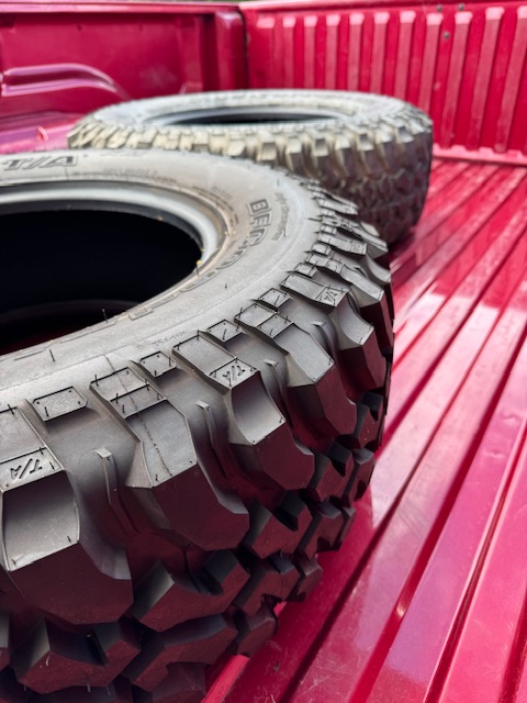

Dollar general, "totally awesome"
Should be on the bottom shelf. Buy a gallon. Don't cut it. Won't harm wheels and cleans tires better than purple power.
Errbody knows that's seent my tars, know I look for the best solution for shiney tires :huggy:
Troy, OMG dude you were right.
Unbelievable how well it cleans tires. Like that old Bleach White stuff years ago. I am amazed. TY 😎

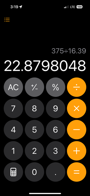

So I went to Fort Mill SC and then over to Hendersonville before back home today gathering 2 more Jeep spares.
Filled up in Elkin because $2.99 diesel and calculated my mileage
I am so freaking happy. Best before today was right around 20. So it now feels like I have twice the power and picked up almost 3mpg 😀

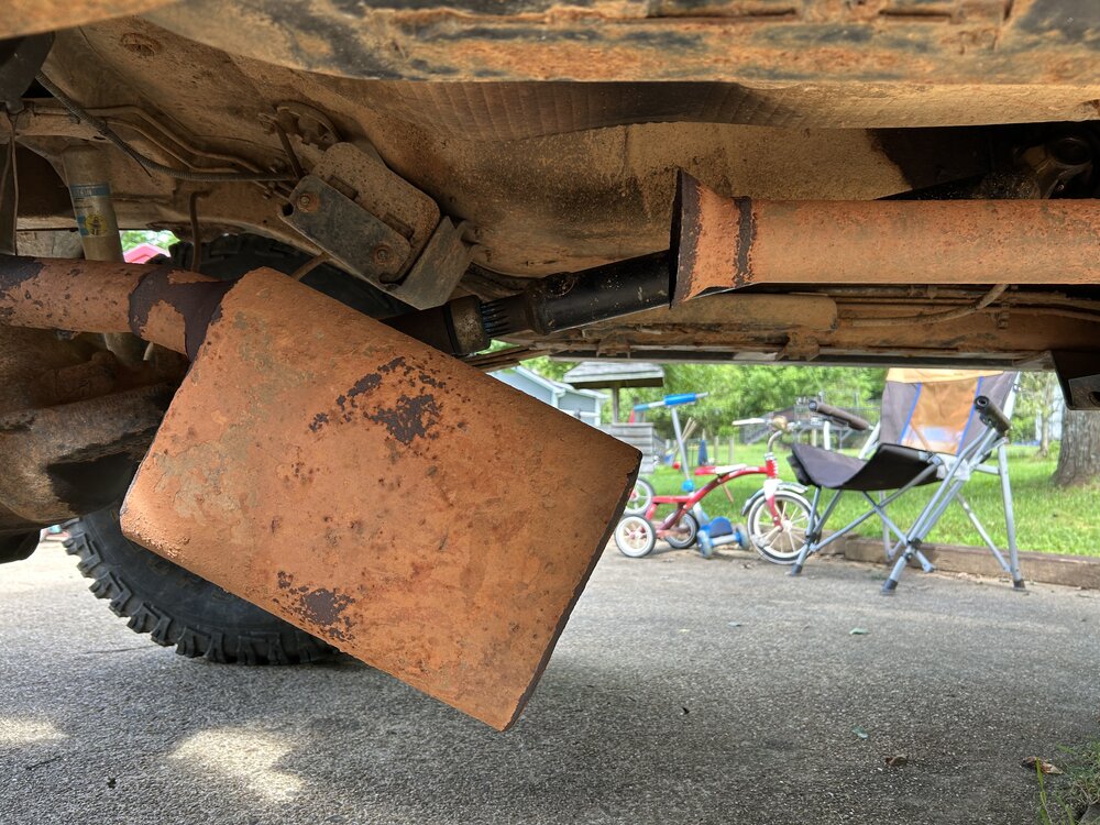

My tow rig / daily driver developed a sudden major exhaust leak on the way home Friday. Turns out the 1/4" for the back pressure sensor wiggled its last and broke in half.
Not sure if my tune even requires the back pressure sensor, but some brass compression fittings and some refrigerant line and it's back together... That little tube is $150+ from just about everywhere so that was a nope
