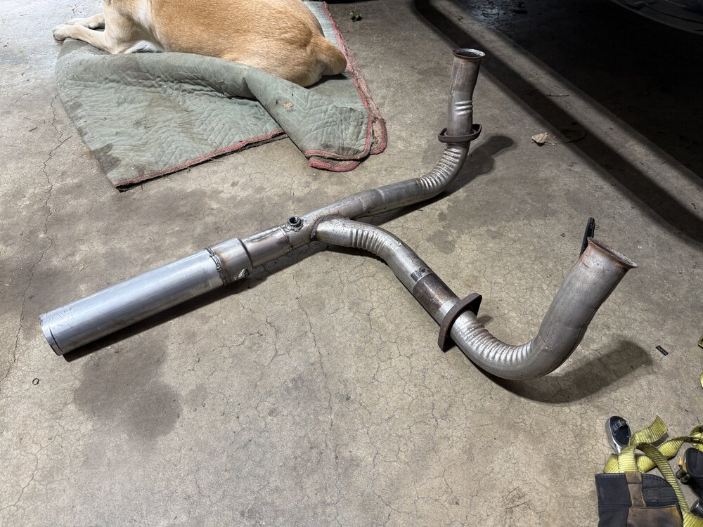

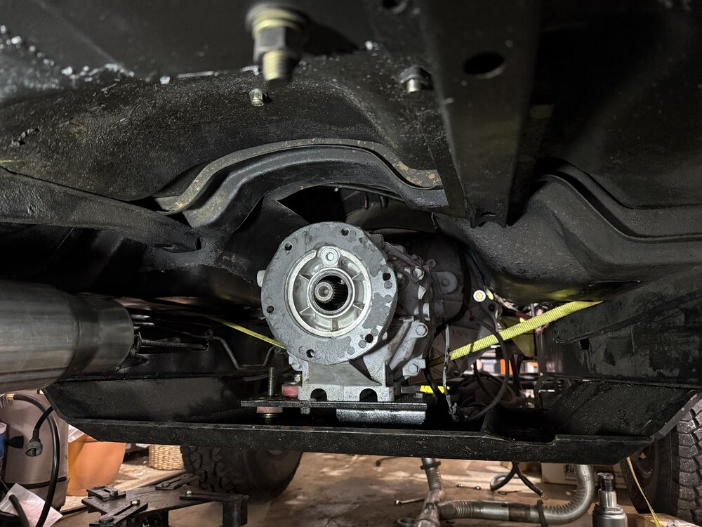

I was wanting to post up here all full of myself that doing the exhaust was pretty easy just because @Noel said it always bested him.
Wellllllllll I was ready to start tacking things together when it dawned on me that I’ve had the transmission jacked up higher than where it will sit on the cross member this entire time. Once I dropped the trans down on the crossmember the exhaust hung low enough that it was holding the drivetrain up. Dammit.
Back to square one with the exhaust.
Also now that the trans is down on the cross member the bolt holes aren’t quite lining up, which is annoying. Was thinking it would be a tad more plug and play.
Sounds like you need to raise the tranny!
you just need to shift the trans over some for that to line up
Yea. I'm single parenting this week and I was so pushed for time and flustered about the exhaust that I didn't even think about the fact that I need to loosen the engine mounts so I can scoot the trans over for the holes to line up :dumbass:

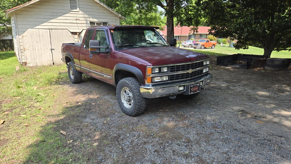

Swapped wheels on both buckets; put the Eagle Alloys and 285 Kelly's on the K3500 and the PY0 and 265 Dirt Commanders on the K2500. Not a big fan of the factory wheels on the red truck after having the 16x8 and 33s on it for so long.
This thing however, looks bitchin. Needs a bath in the worst way

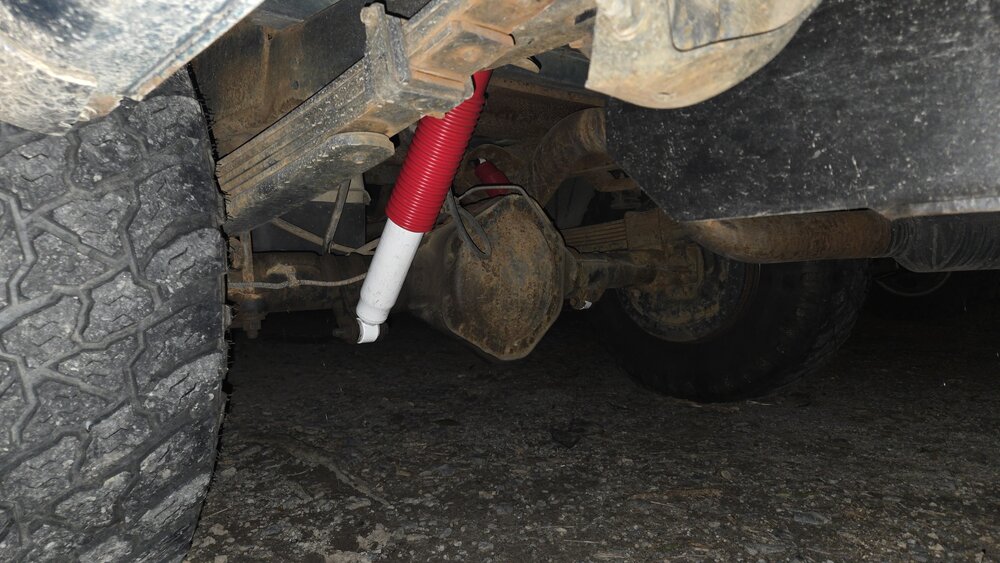

Also went ahead and threw a new set of rear shocks I've had laying around on the crew, needs front shocks and sway bar endlinks bad.

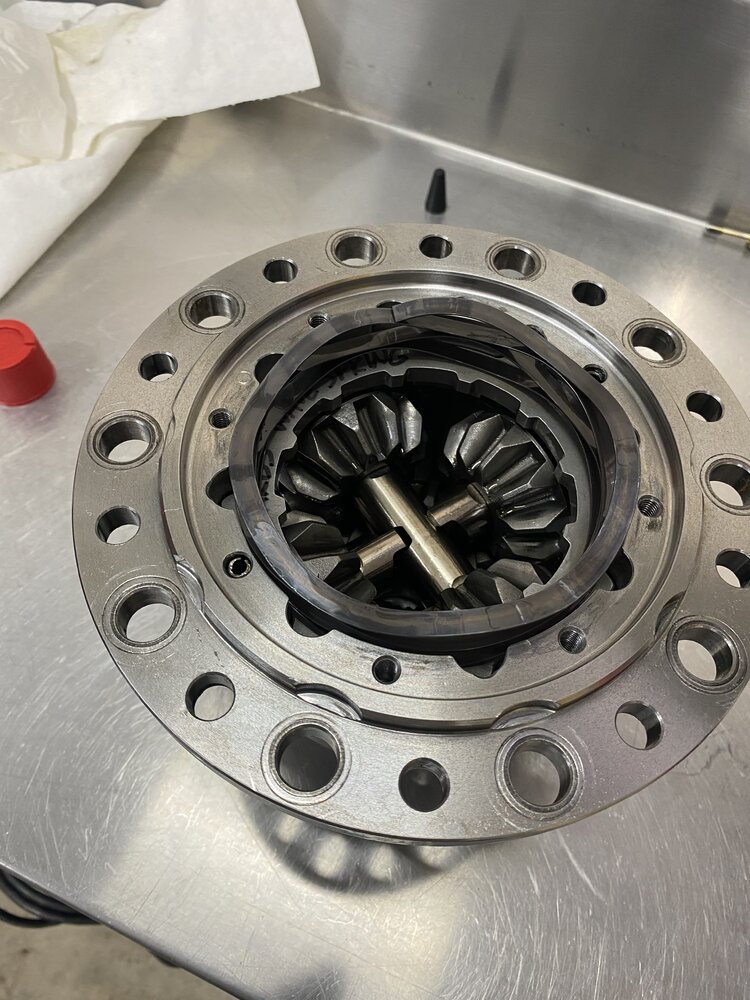

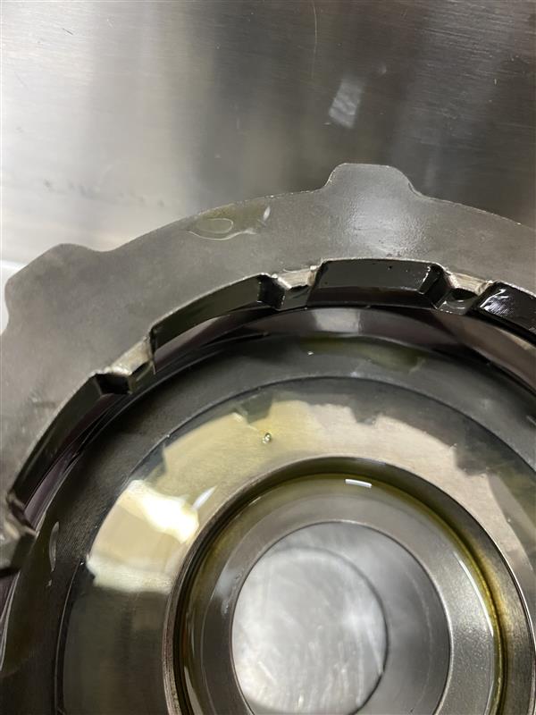

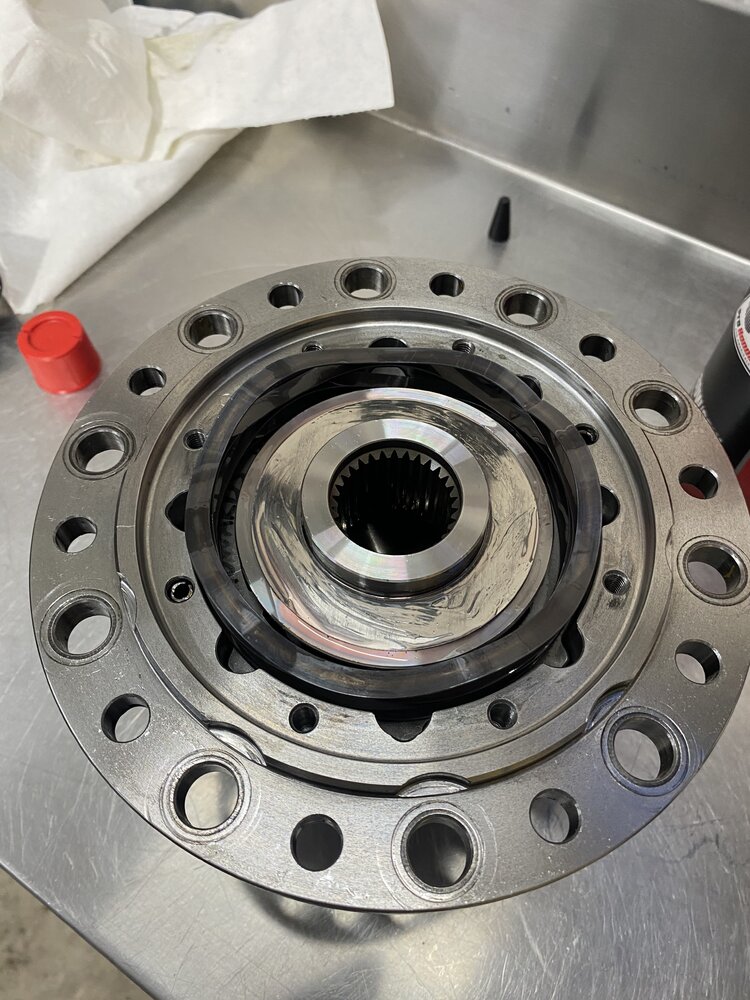

E Locker out of my rear 44 had some wear on the locking ring; case and side gear looked perfect. Eaton doesn't sell parts kits anymore which kind of sucks, but they shipped me out a new ring from their ENGR facility and back together it goes!

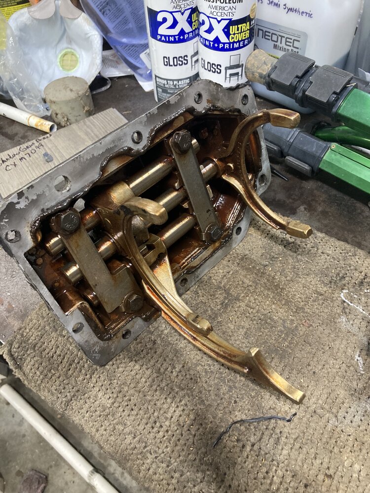

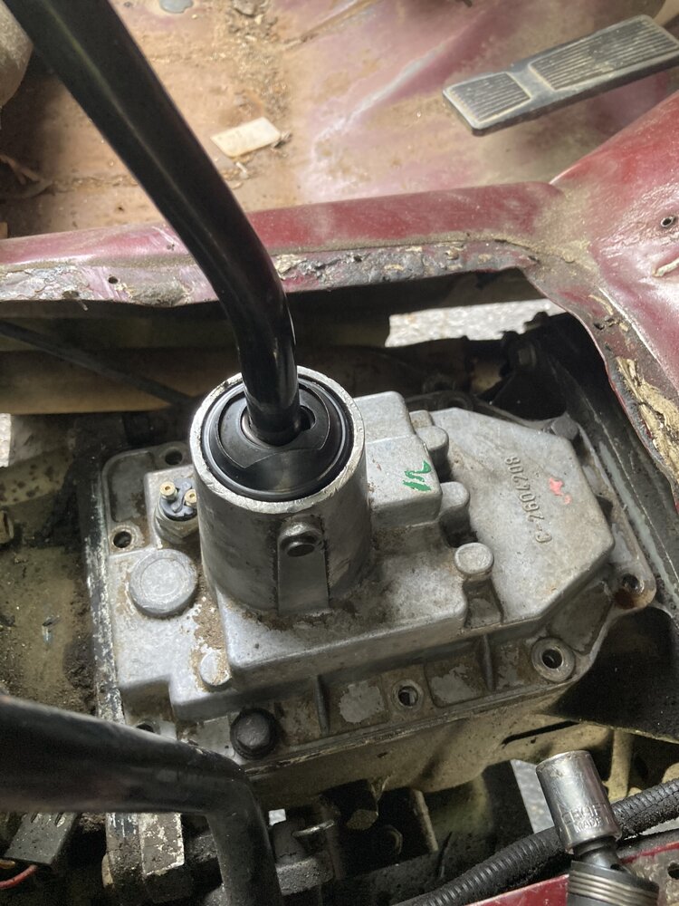

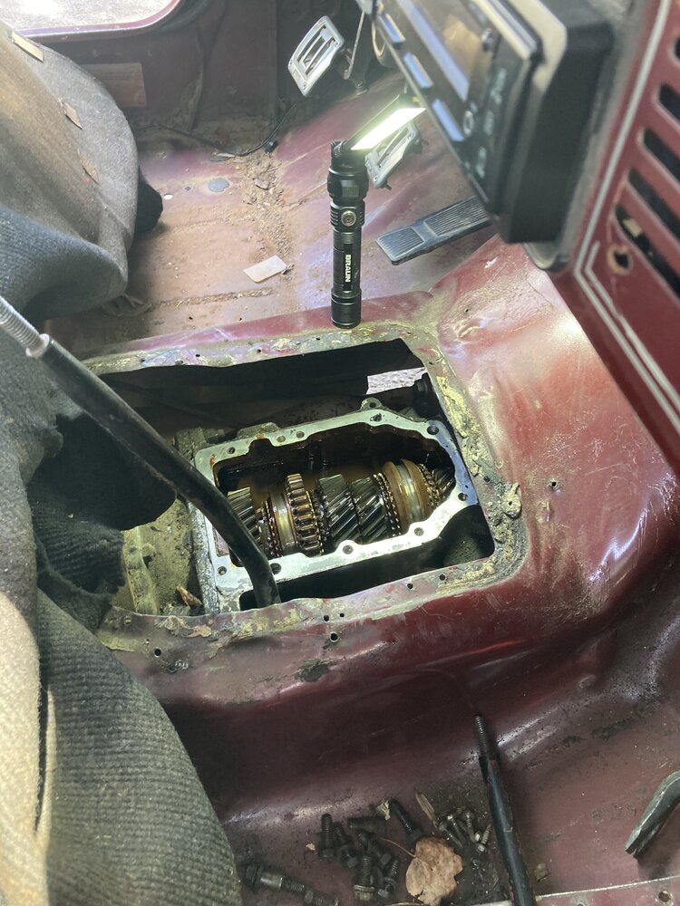

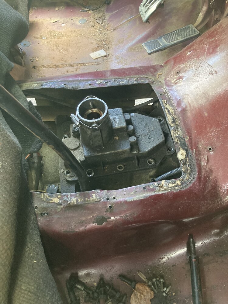

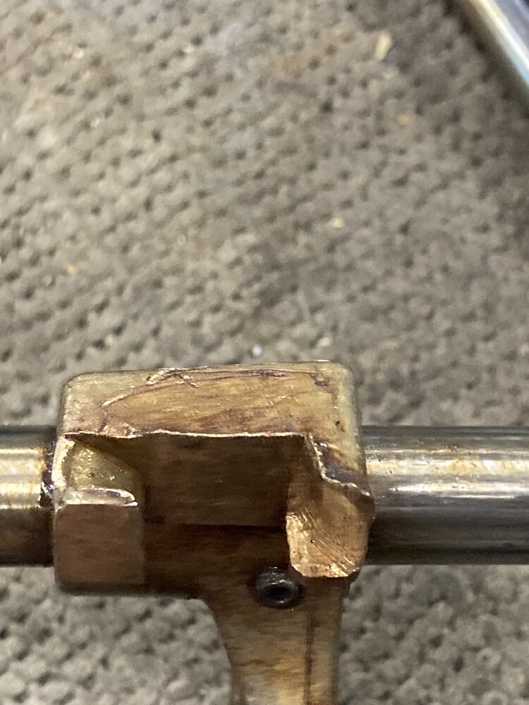

Gave the CJ7 some love yesterday. The shifter was all over the place and if not careful it would get stuck in 2nd gear when the shifter popped out. $65 1st/2nd shift fork and a $32 new shifter with spring, lock ring and boot.
Removed tunnel cover and shifter
Getting the top of the trans off was a fight, but finally gave in. Gear fluid was ugly!
Shift forks.
No wonder it was loose!

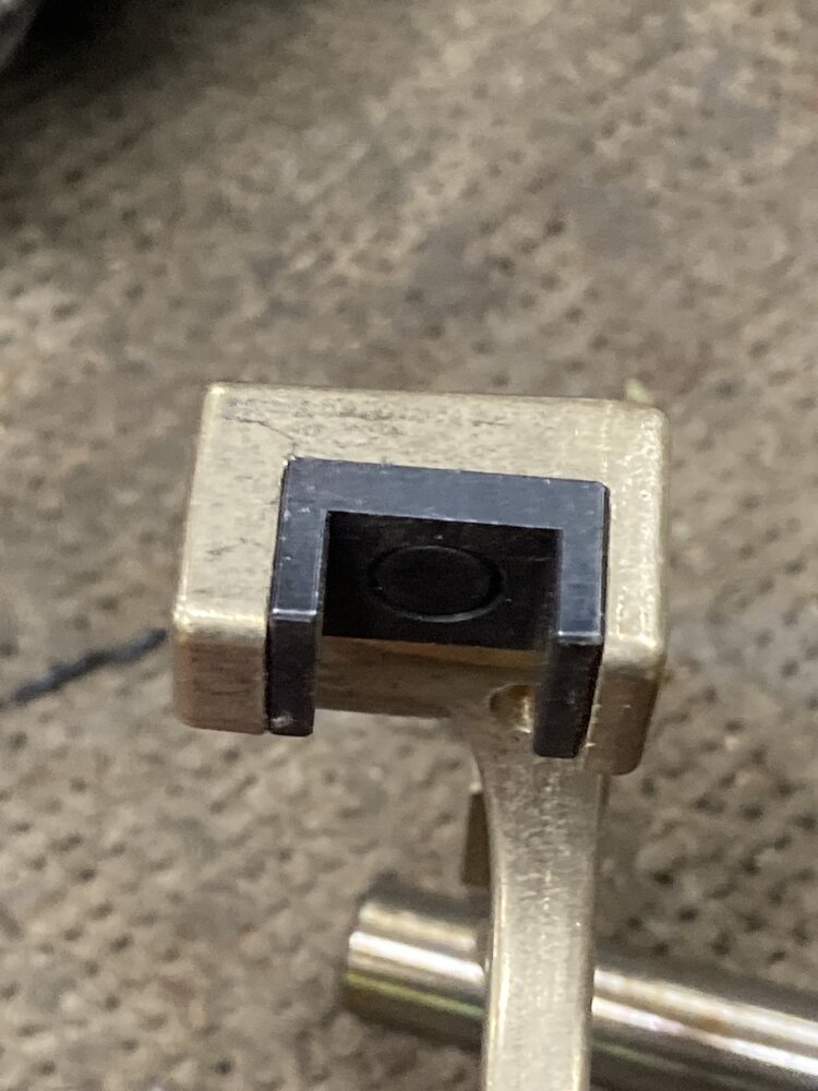

New fork for the win!
Reassembled with new shifter
Old shifter had a funky bend in it.

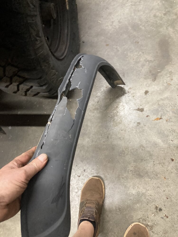

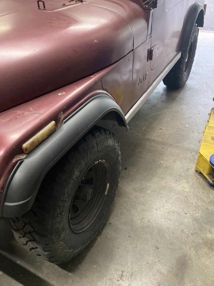

The front flares were shot, so I ordered new ones.
News ones!
Also while I was at it drained trans and installed new fluid as well as oil and filter changed. Ready for some road miles now.

What trans is that

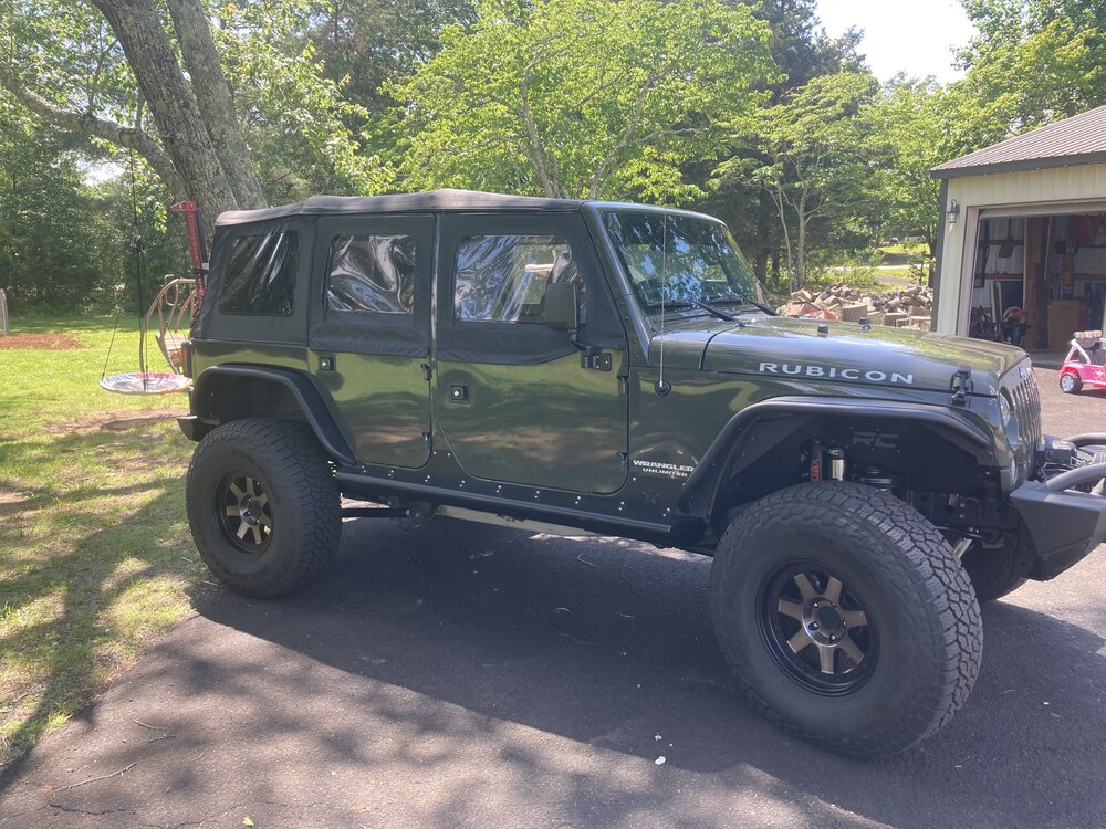

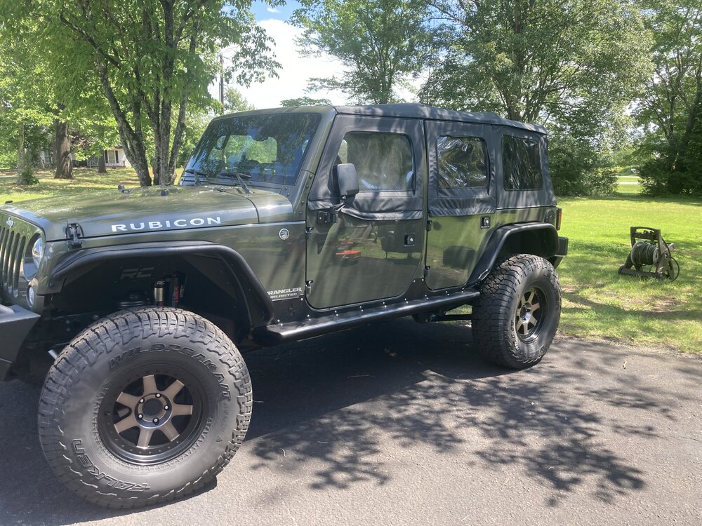

Installed the 1/2 doors and uppers on the JKU for the OBX trip.

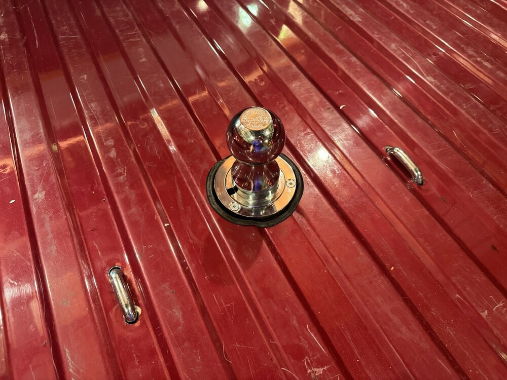

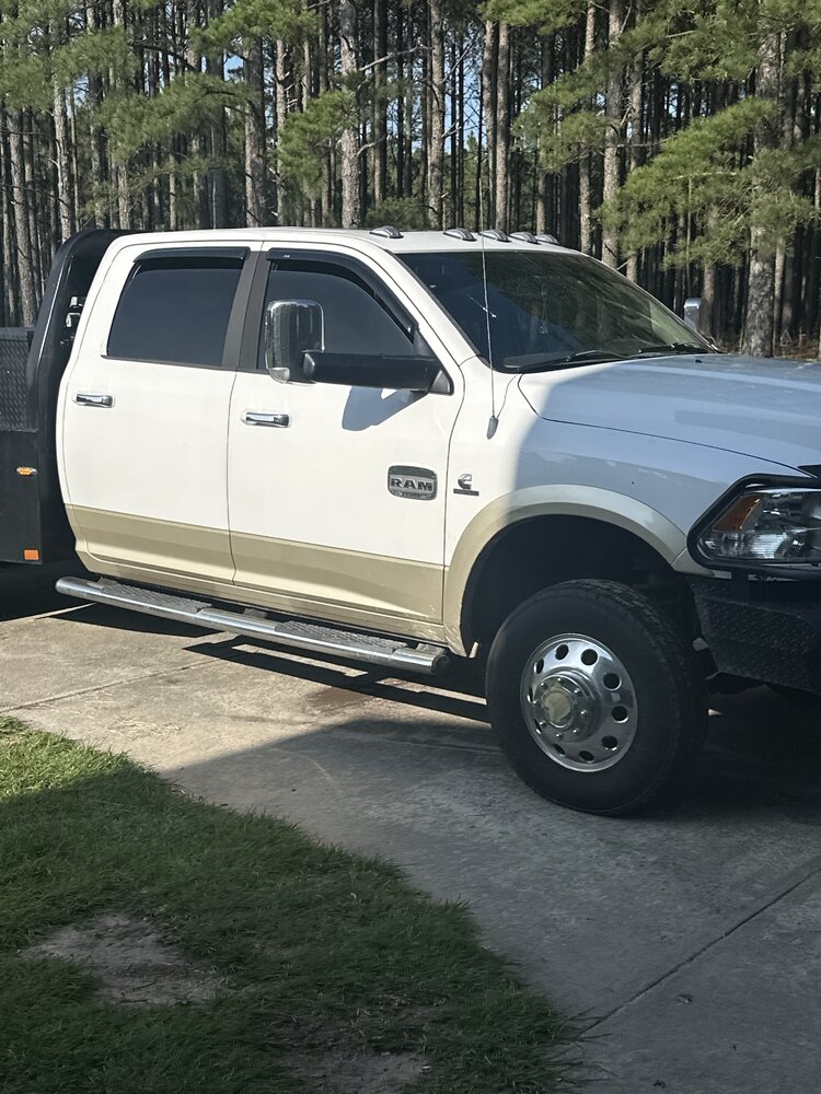

The Ram got its gooseneck hitch, and a good bath. I had to power wash the tires, they had that brown icky look and purple power and a stiff brush wouldn’t do it.
Dollar general, "totally awesome"
Should be on the bottom shelf. Buy a gallon. Don't cut it. Won't harm wheels and cleans tires better than purple power.
Errbody knows that's seent my tars, know I look for the best solution for shiney tires :huggy:
