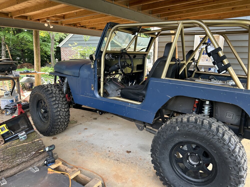

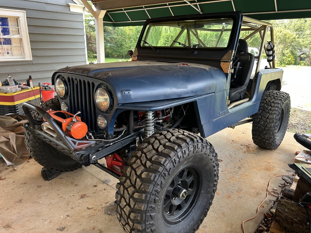

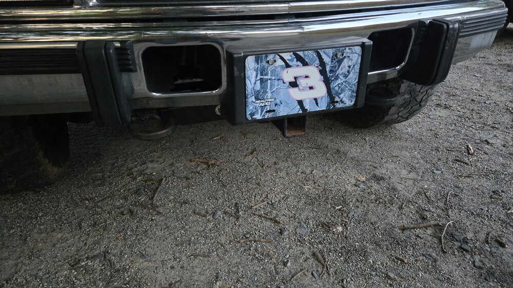

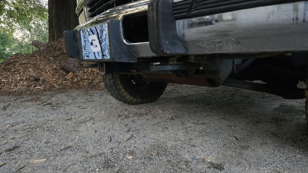

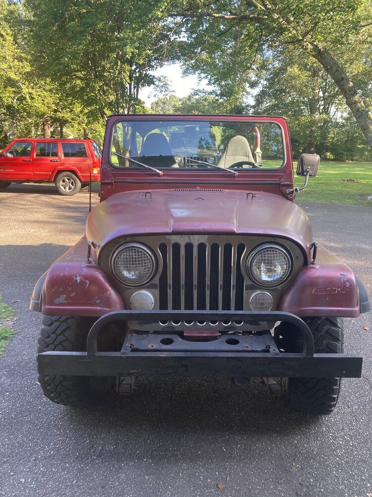

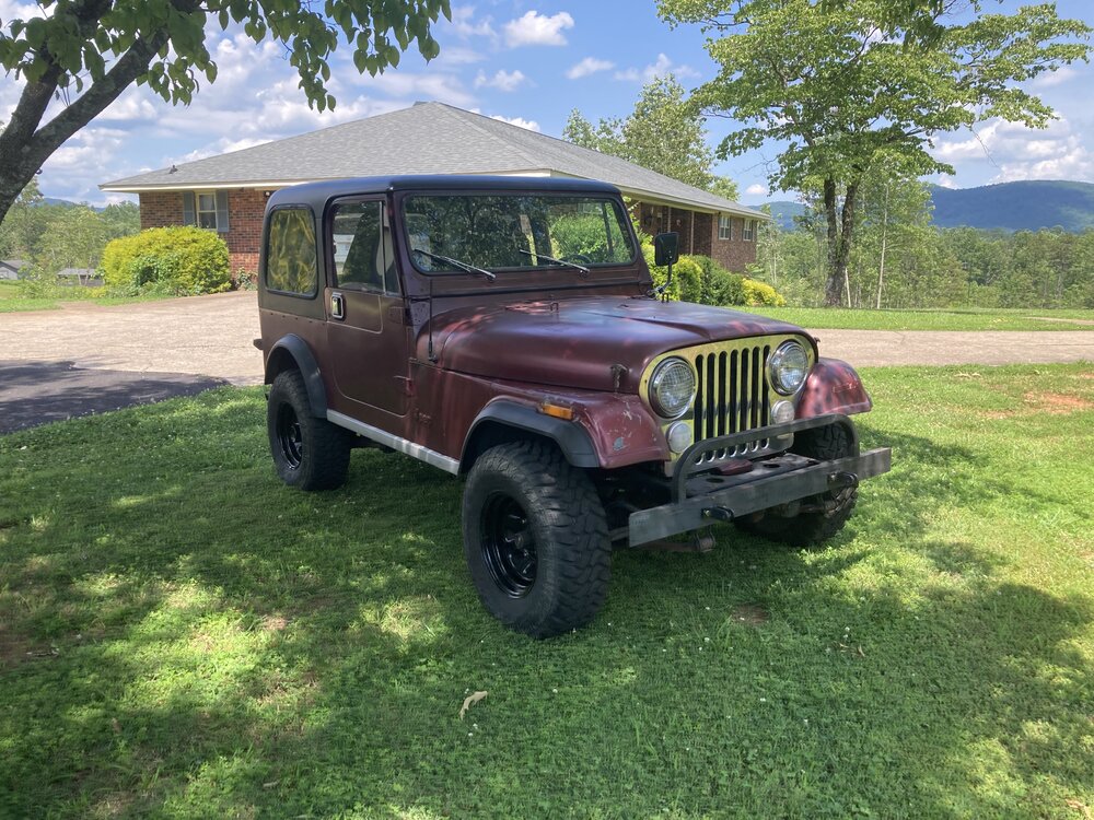

Added a little beef up front, seems I can't drive down a paved road without smacking it on something šŸ˜…

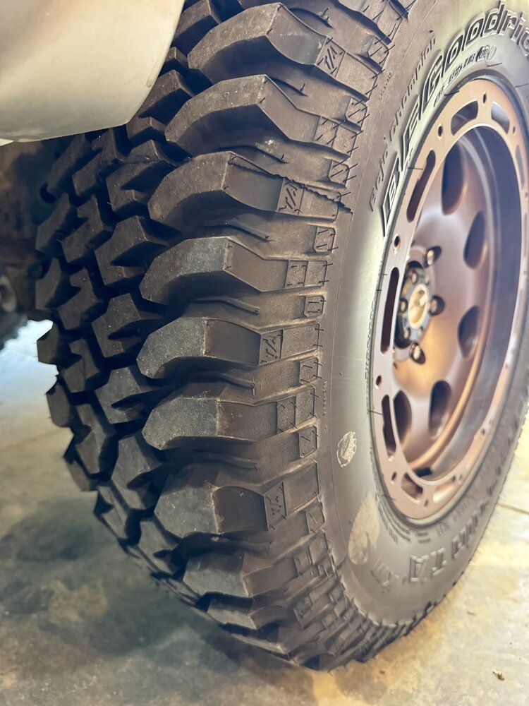

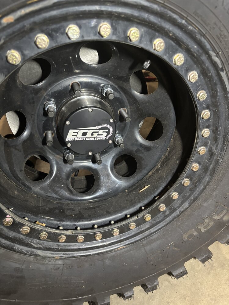

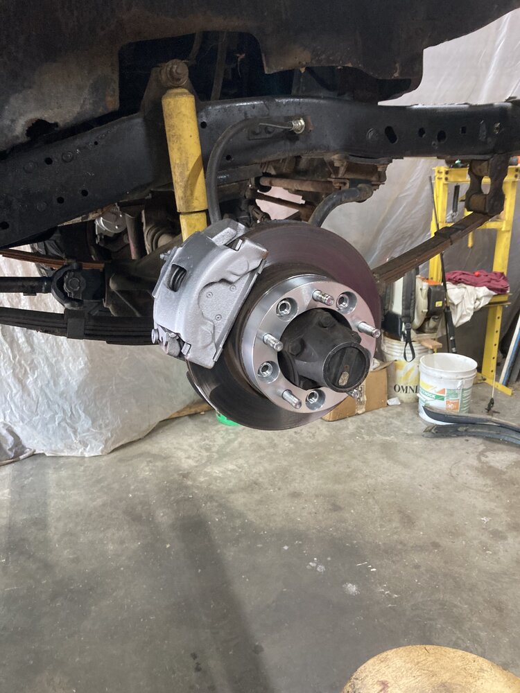

Installed the drive slugs this evening. Probably the easiest thing I’ve done with this one ton swap.
When you decide you need 40 spline shafts I have an extra set of 40 spline slugs from Branik who makes those for ECGS.

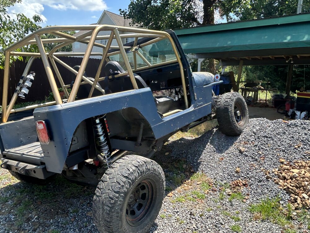

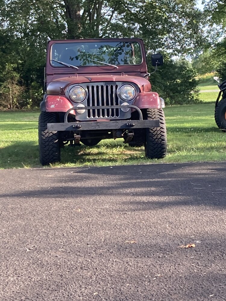

First test on public roads, worn out flat spotted 31’s from an old Xj until I cycle the suspension a few times and get it aligned.

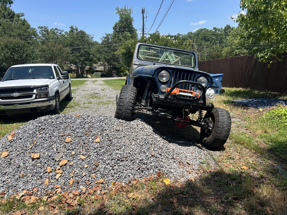

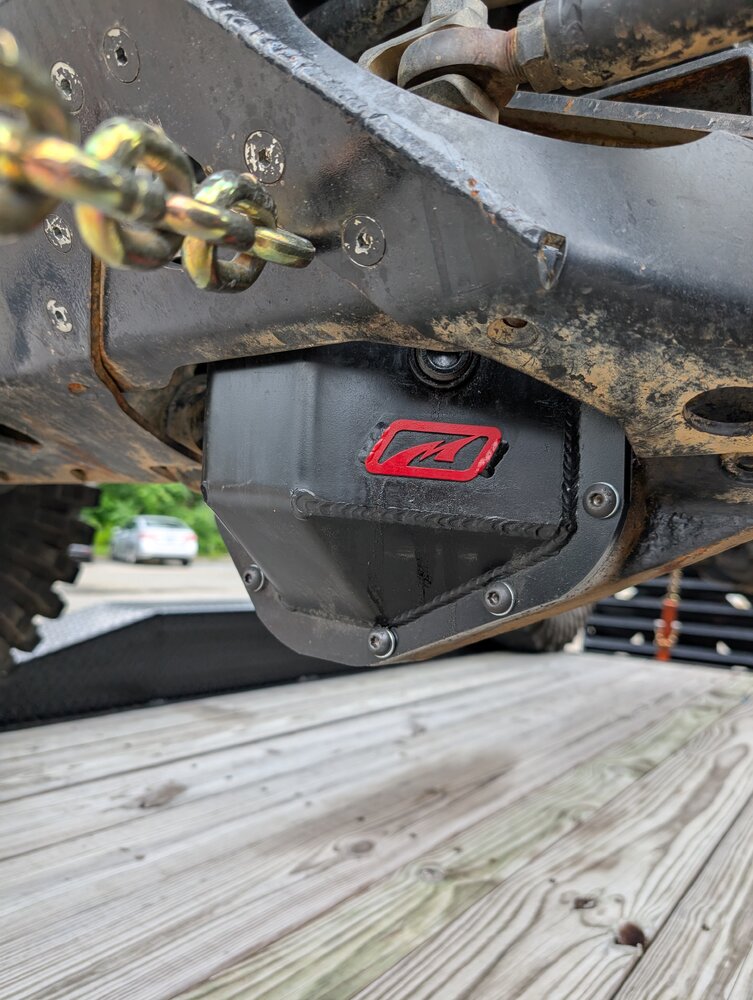

Also I had a pile of gravel for my French drain, poser picks were the obvious answer

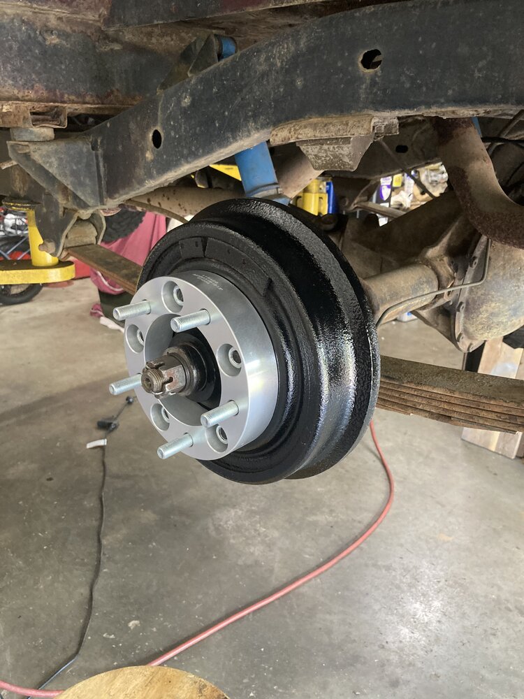

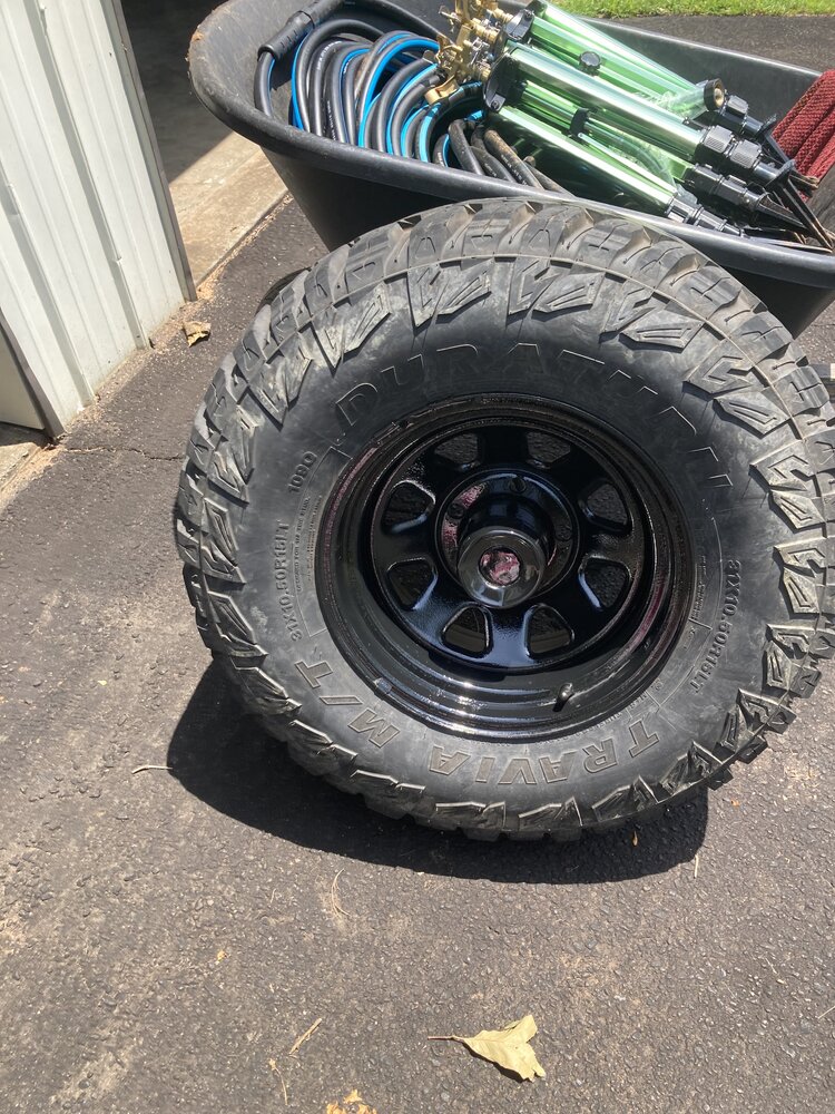

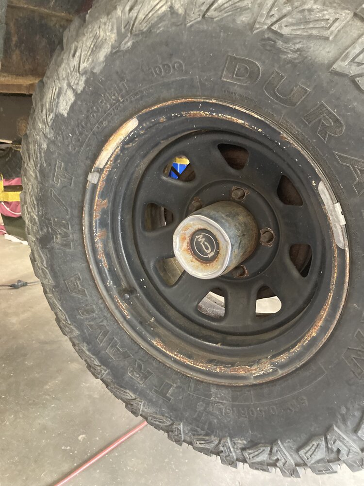

Turned the narrow track into a wide track. While at it figured I would clean up and paint the drums. Then decided to add some paint to the wheels.
Before
Front
Rear
Wheels before
Wheels after
Finished product
Better stance

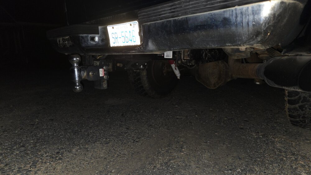

A couple of months ago, I was coming up the easement and there was an 8 lug wheel and tire off the edge of the drive.
I ignored it a few days thinking it must have fell off of a neighbor’s trailer or something.
Then I figured out it was off my Dodge šŸ˜… my cable for the spare had broken right at the end.
So finally today I used a cable clamp to repair it all and put the spare back under the truck out of the way.
It is so unusually hot here that I was soaked in the 45 minutes it took 🄵

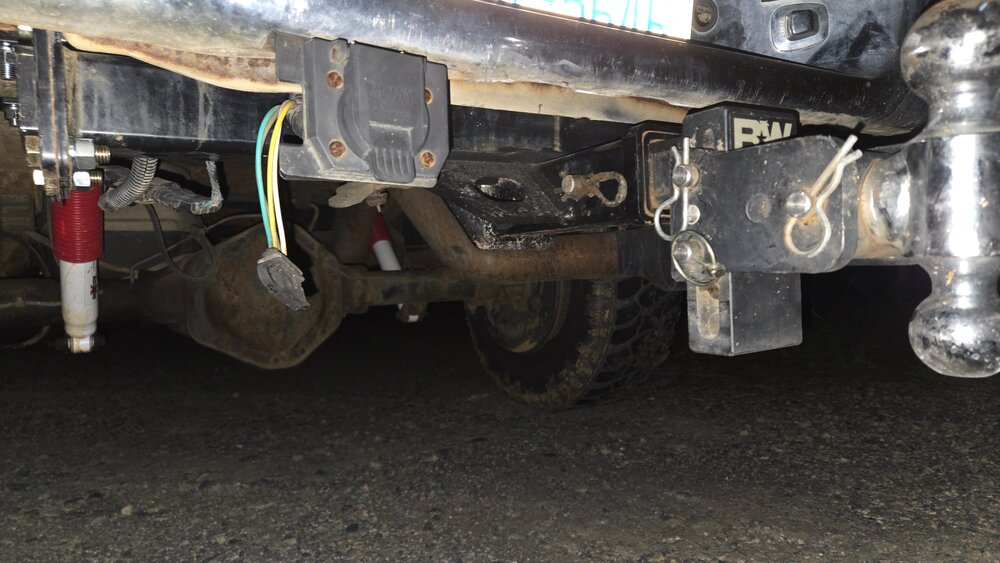

Chasing down a tail light failure, found 2 of the 7 pins on the turn signal connector loose, something about trying to fake having the right crimping tool with needle nosesšŸ¤¦ā€ā™‚ļø fixed that still didn’t work, got a new relay thinking it might be a relay not being rated for led.
After a day of frustration, the culprit, besides the 2 loose connections was a fuse. All systems go now!

5 degree caster, 1/8 toe in, within 1/32 centered, side to side wheelbase within a 1/32 as close as a tape-measure can do. Put the real tires on it aired to 30 and sent her.
First off, my trans controlled by terminator x max with art carr shifter is currently not set up for drive, so you have to click between gears. I also don’t have a speedo. So, 2300rpm in 4th is roughly 70, first speed test and I don’t think I’ll be doing much highway driving without a topšŸ˜‚
The hydro boost sponginess is gone, must’ve just needed cycled to bleed out air
