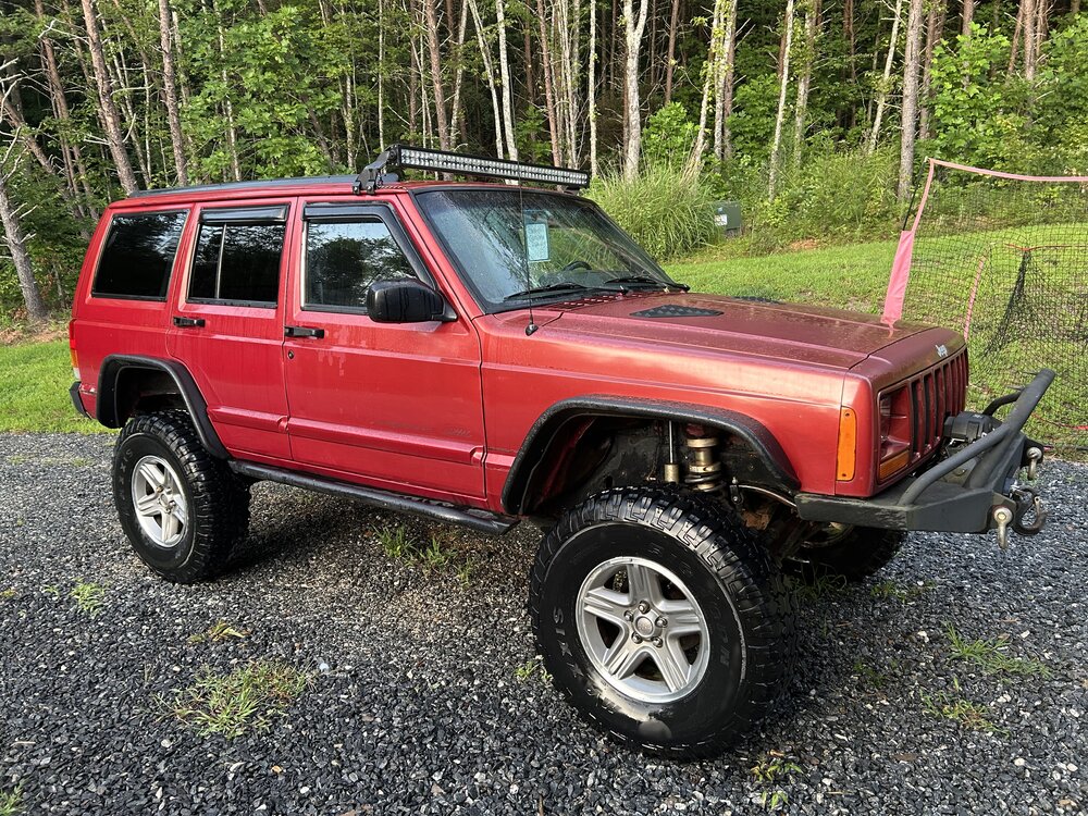

Washed it, adjusted tire pressure and put some stuff in it to go tow a camper back from SC tomorrow For my SIL.
Photographed it. Soon enough I will be healthy and hopefully wealthy enough to drive it through the yard

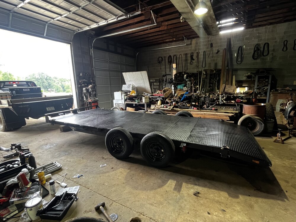

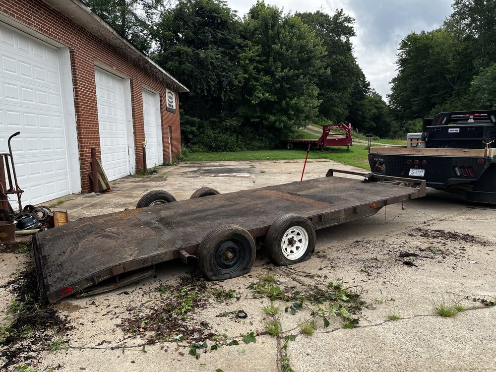

Prepped the YJ and got it back together with the new front driveshaft then dragged the old car hauler out of the weeds. New paint, lights, wiring, greased, wheels and tires. Still want to build some drive over fenders for it and some ramps. The old ones have been missing for as long as I can remember.
Before
After

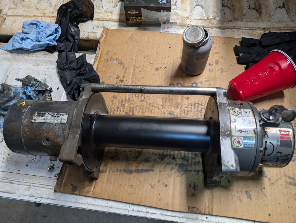

Reinstalled my winch and ripped the stereo out of the Tacoma to be replaced with a switch panel and I may move my EQ to the dash.

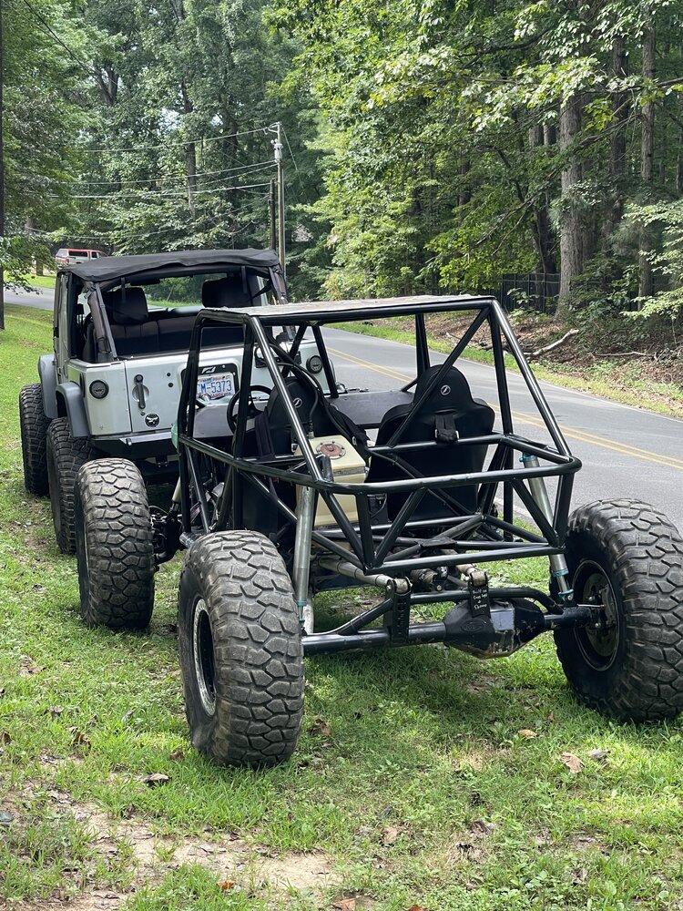

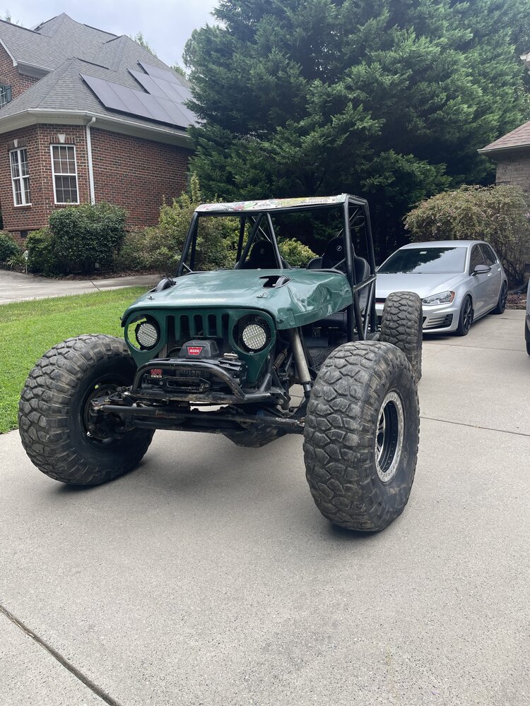

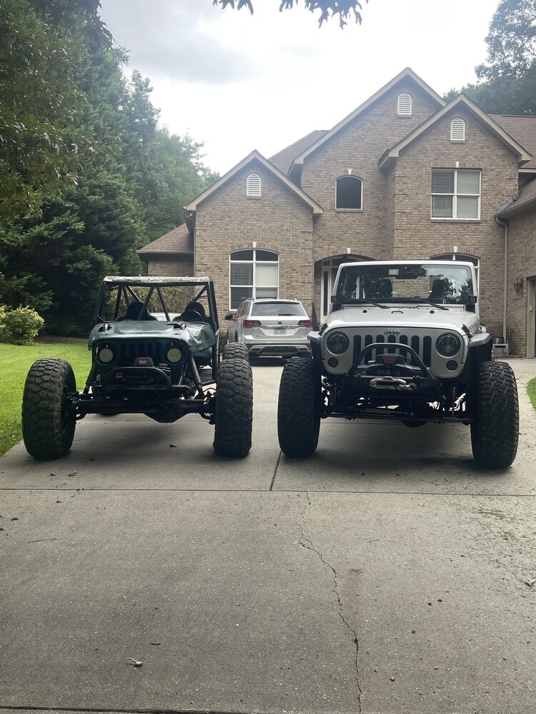

Got a buggy to go along with the Jeep. Got a good base, needs a few little small things, but it’s ready to go like it sits.
