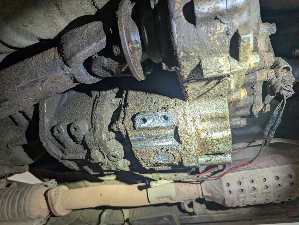

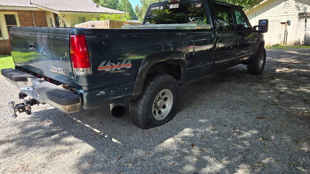

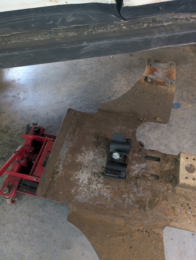

Transmission is in and cooler moved. Will do a URE shake down to verify no issues, then on to the 3 link conversion.

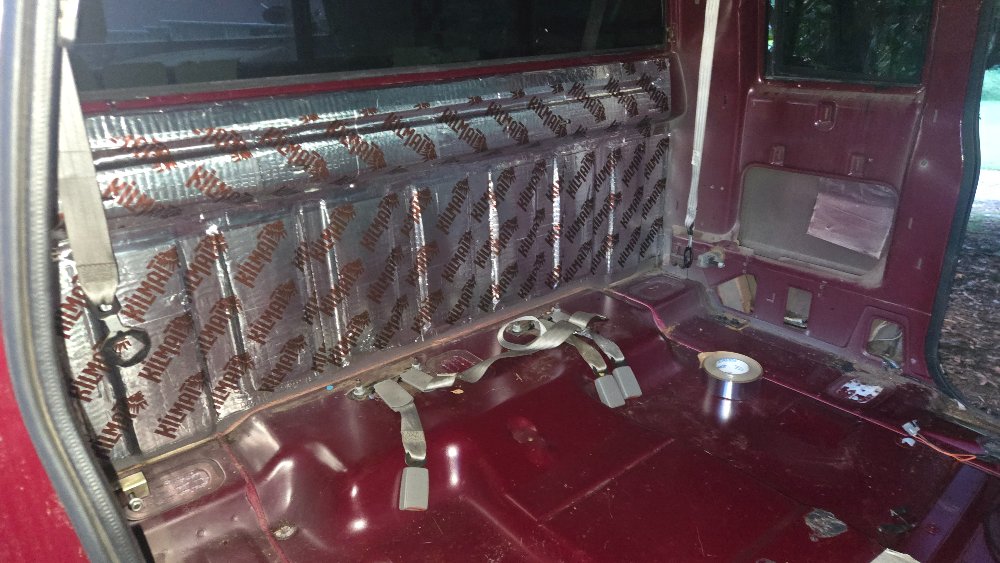

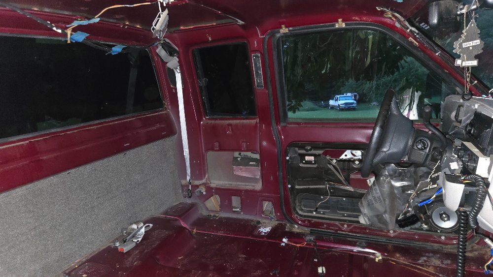

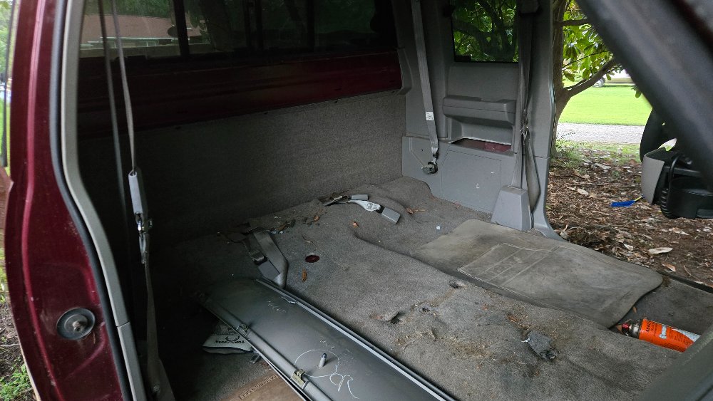

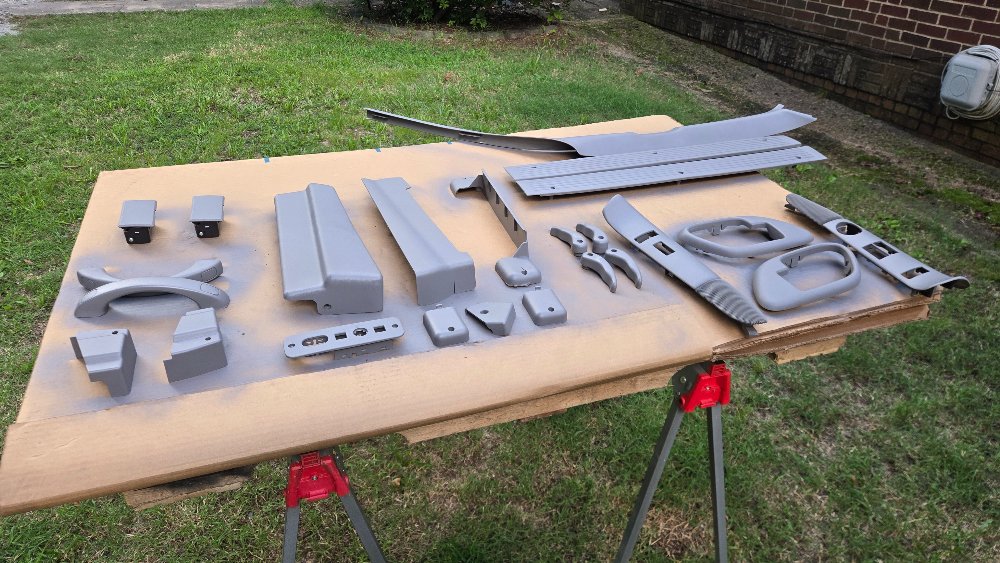

Started gutting the interior to deep clean, paint, and put in sound deadening
I didn't really clean this thing up before I parked it; I think October 2025 was the last time I drove it? Yuck

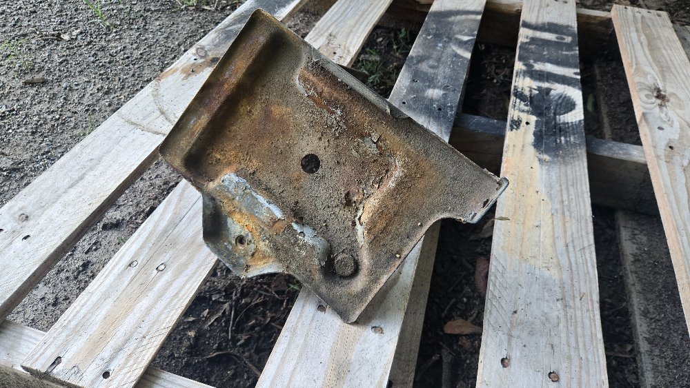

Pulled out the battery tray to repaint it before I slam the charging system back together.

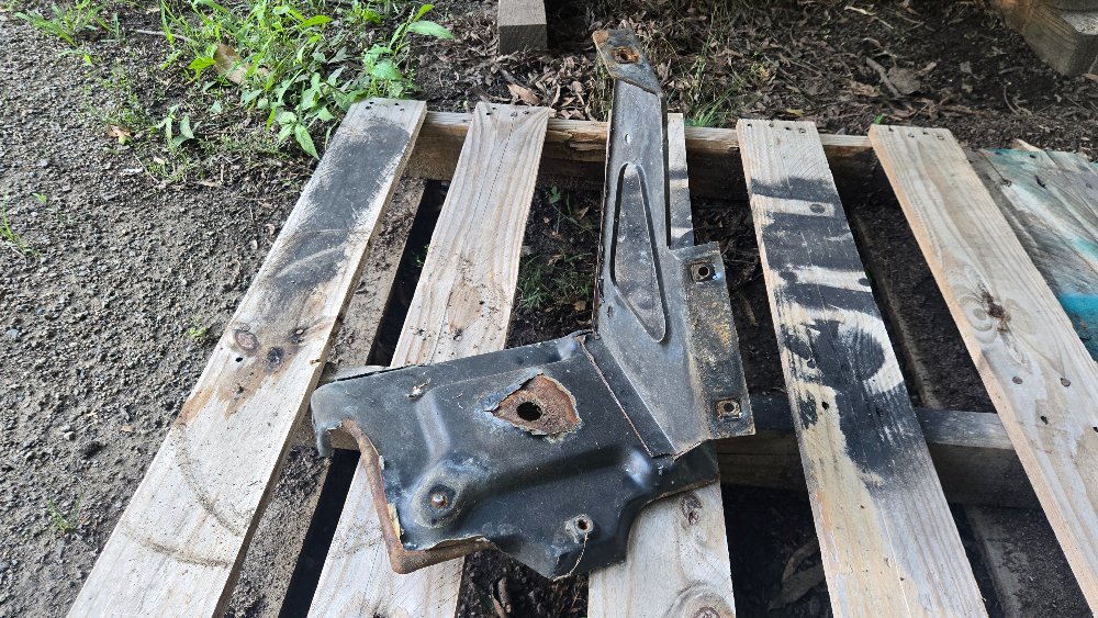

It's pretty nasty looking and as I was doing that I started thinking about pulling the inner fenders out to free up some room, there's a broken exhaust bolt on the passenger side and since I've got headers to install the extra room would be nice
I'll probably wait until I start working on the suspension to do all that since I'd be right at it anyway
Deep cleaning the interior and getting everything freshened up shouldn't take too long, but the carpet is what is going to be a challenge.
Hopefully with enough heavy duty upholstery cleaners, passes with shop vac, the pressure washer, and carpet cleaner with some liberal application of elbow grease will bring it back?
Had a dude tell me he let all his carpets set out in the rain a couple time before he cleaned them......i was gonna try it on my Dodge carpet that smelled like wet dog but decided to just buy vynil replacent
This is one place where I vote buy brand new since you have the interior pulled apart already. It is amazing how much smell is trapped in vehicle carpet, and how much better the interior will look with fluffy new pile. Buy good stuff with mass backing and you will not regret it. A standard kit is less than $200, the "good stuff" is less than $300.
Here's one place I was recommended, and while not terrible price wise most of my projects are on a shoe string budget these days
StockInteriors.com - 88 to 96 Ext. Cab FSC
The factory carpet has a couple of pretty bad spots but I've also seen worse and brought worse back. I may pull it and try my hand at cleaning and if I'm not happy with how it comes out then seek a replacement; my only concern is fitment
A buddy and I did something similar to a flip truck that smelled like a hog pen; left the carpet out on a trailer deck to air out and get rained on before we hit it with with carpet cleaner in a pump sprayer and a Hotsy pressure washer.
It cleaned up pretty decent and the funk was gone; a couple passes with a carpet extractor after putting everything together and aside from the sun fading it didn't look half bad
