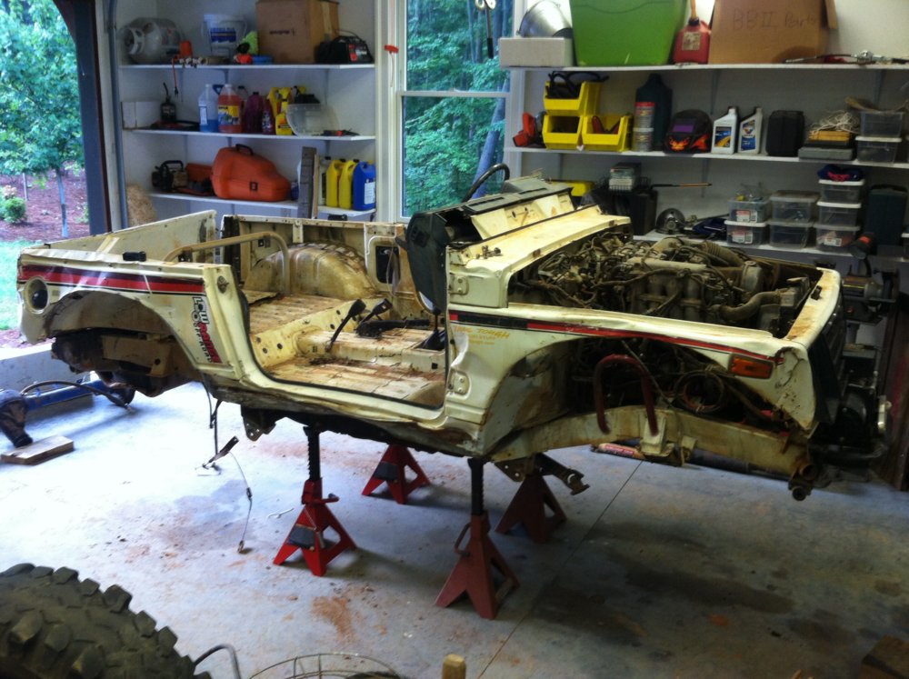

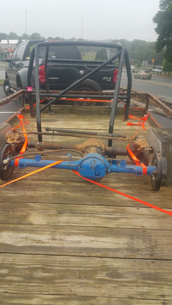

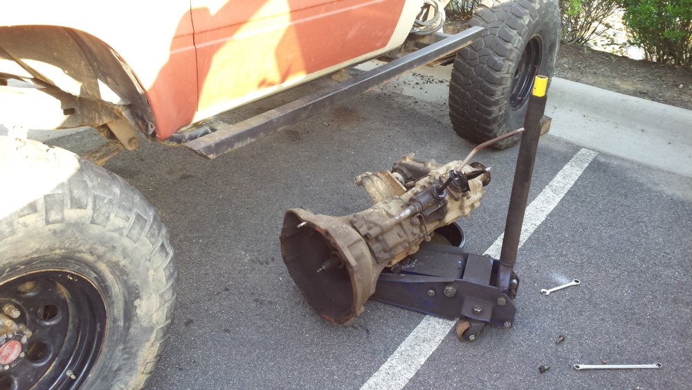

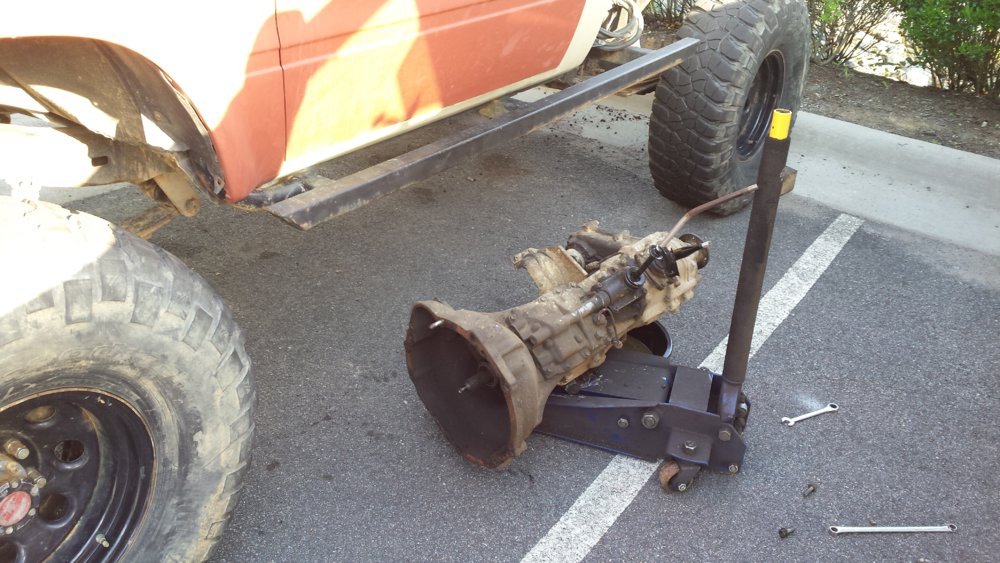

Started taking it apart this morning while everyone else in the house was still sleeping.
In your yard lol. I'm borrowing one from a friend for Potts, will prob pick it up Friday or next week.So where's the trailer?![]()

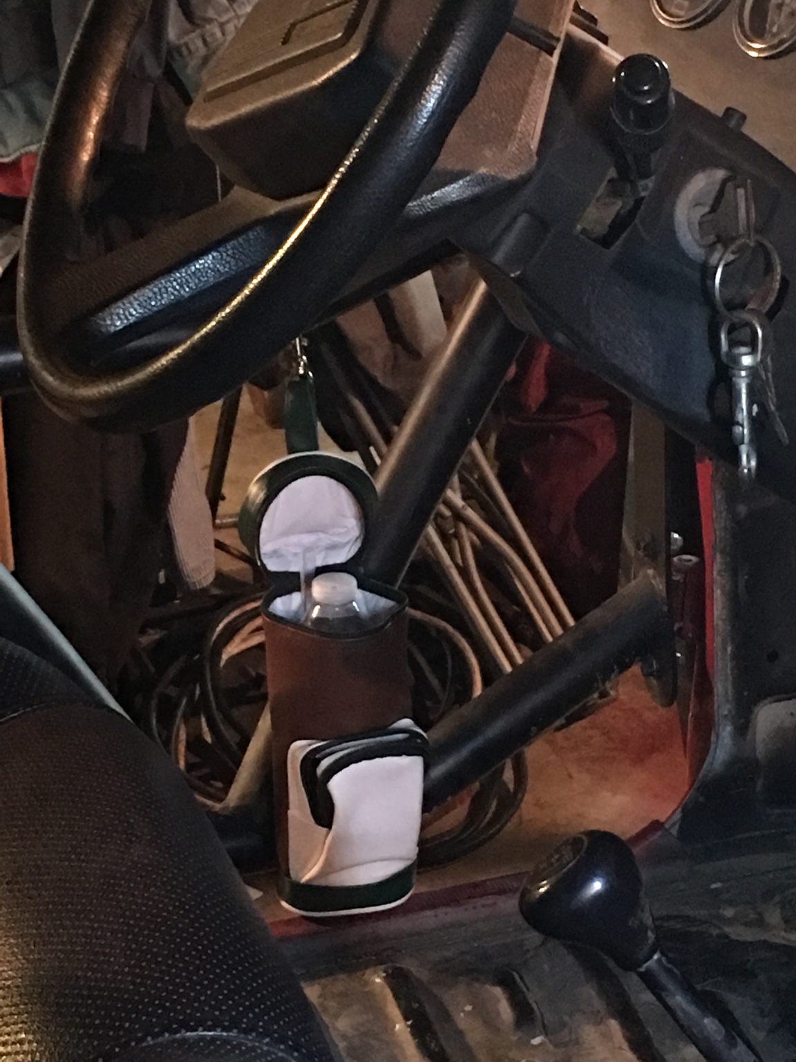

It had a little, but not bad for a 33 year old trans.Might sound strange but does your old shifter have a ton of play in it

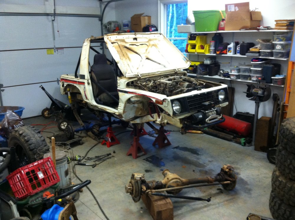

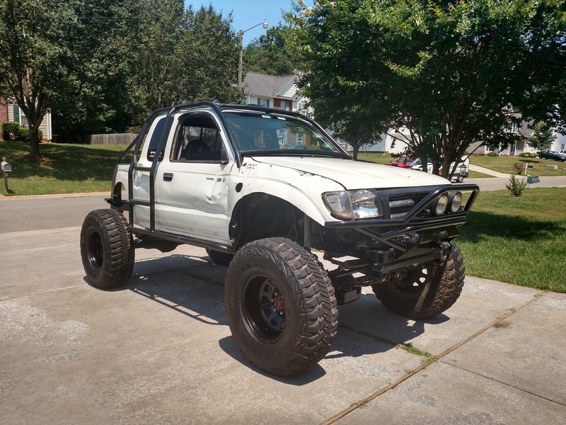

Plans? I have developed a love for sami buggies
Yota axles, 102-105" wheelbase, new cage, 4-link rear, 3-link front, 36-37" tires, coil springs or air shocks, and some good suspension seats.
Leaving the 1.6 or whatever it is that comes in sami's?
They come with 1.3 liter carb'd motors that put out 58hp. I swapped in a 1.6 16v motor from a 97 Sidekick about 9 yrs ago. It puts out 95-100hp which is good for a very small light weight rig. I may want more though after building it this time. If so, I will most likely go with a 2.3 liter from a Suzuki Aerio.
Is the VW diesel swap worth it? I used to have a sammi and wanted to do that swap, was thinking of a trail rig with good road manners and fuel mileage. Just wondered if it would have much throttle response and power.

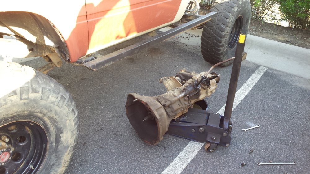

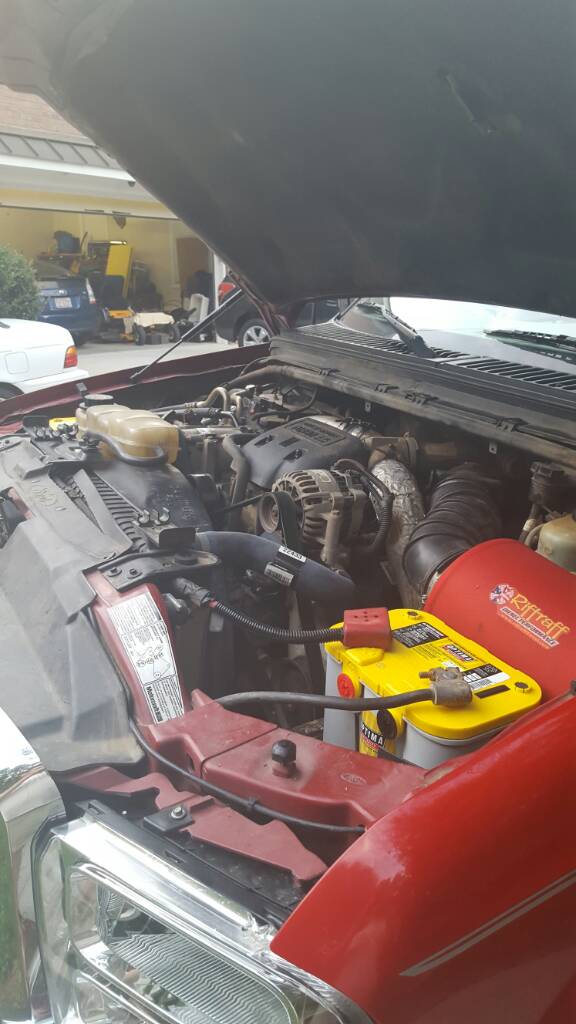

Nah, I'm sure Keuster is pleased to have you living at the complex. Your vehicles make it look like a high end family style apartment.Pulled my l52 to swap in a w56, in the apartment parking lot. This may be pushing the limits of what I can get away with
