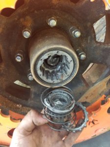

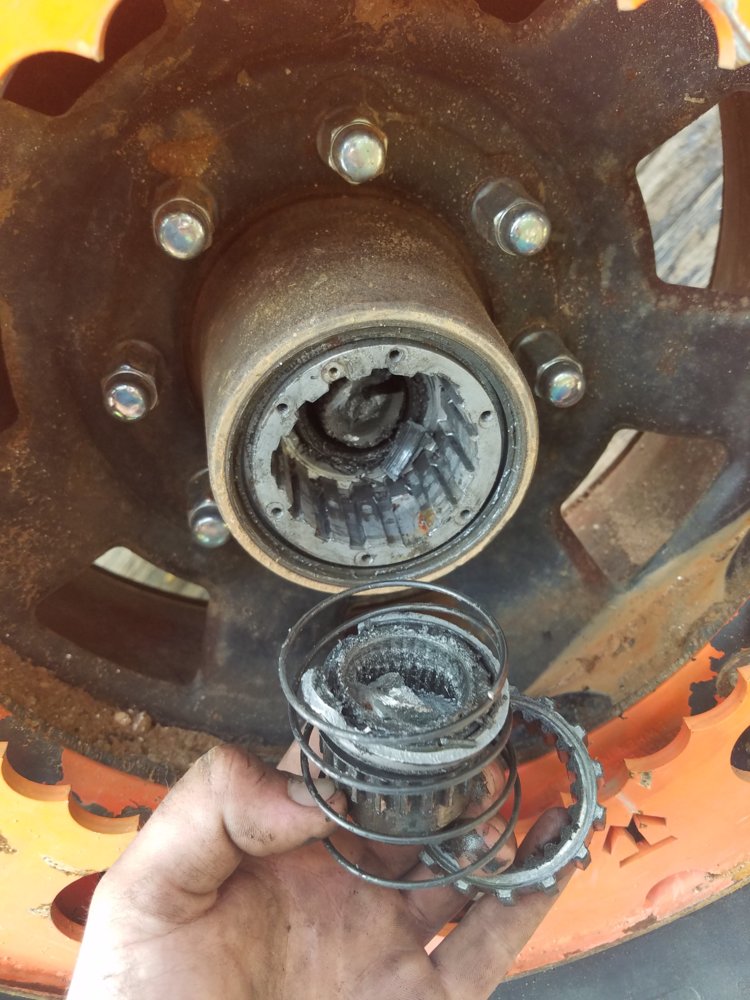

Was gonna replace my hub that I thought was broke.. d60 stub Shaft broke too :( ordered 35 spline stubs and yukon hardcore hubs

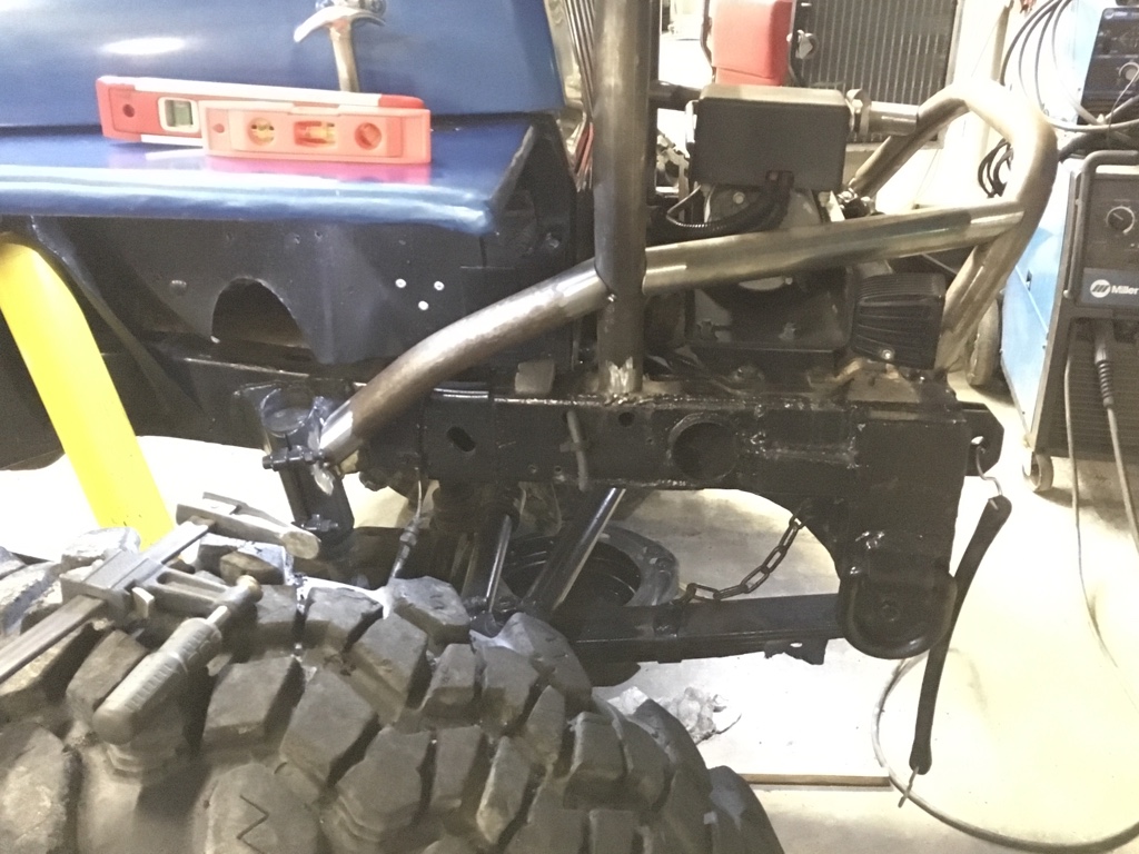

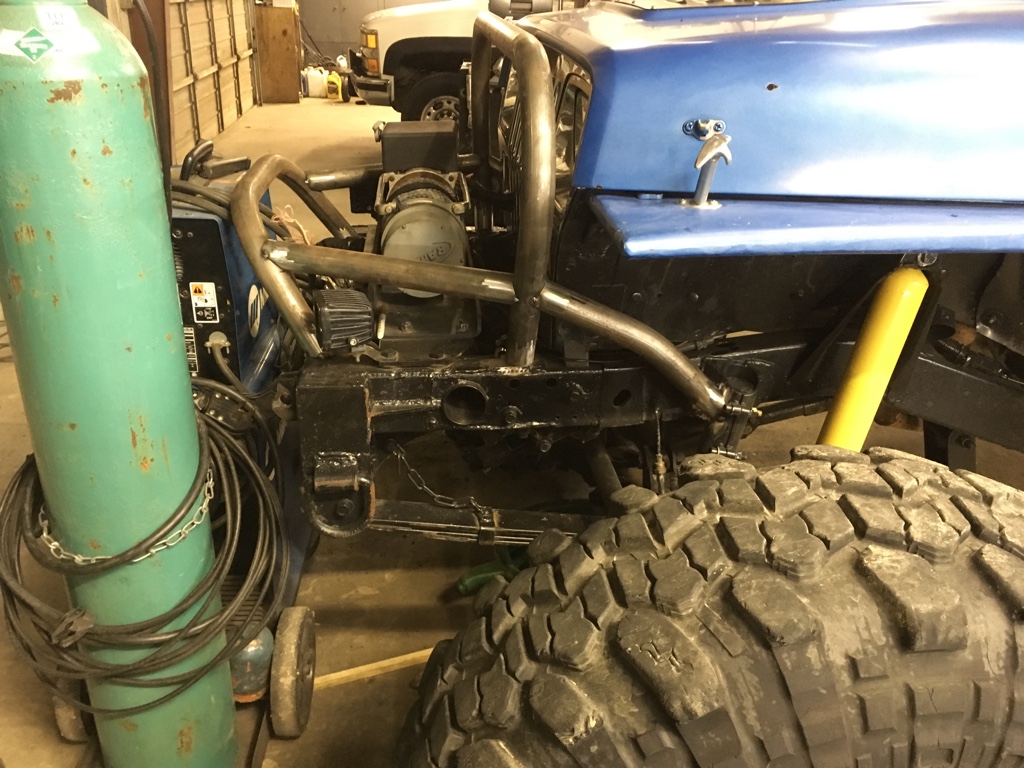

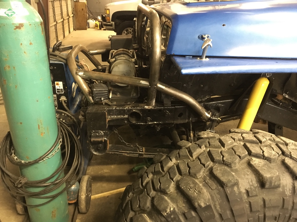

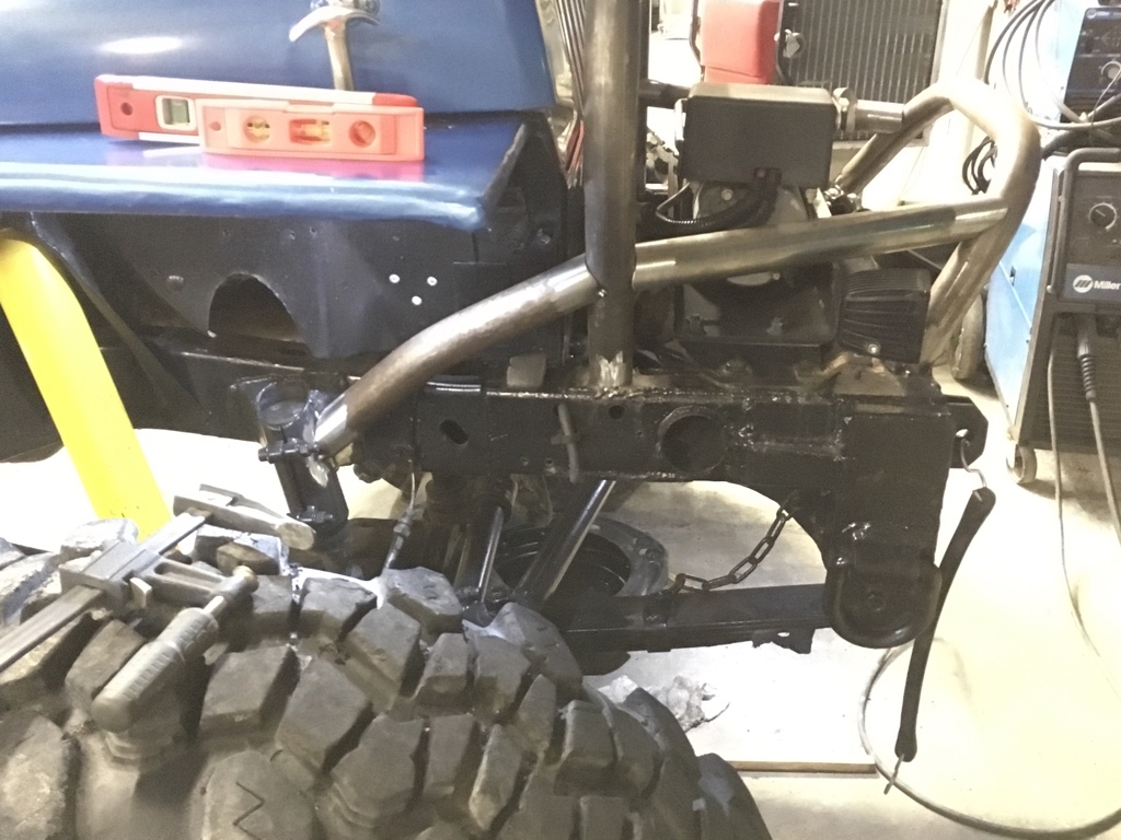

Finished the last tubes on my bumper.

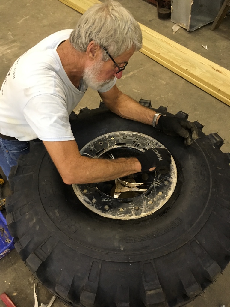

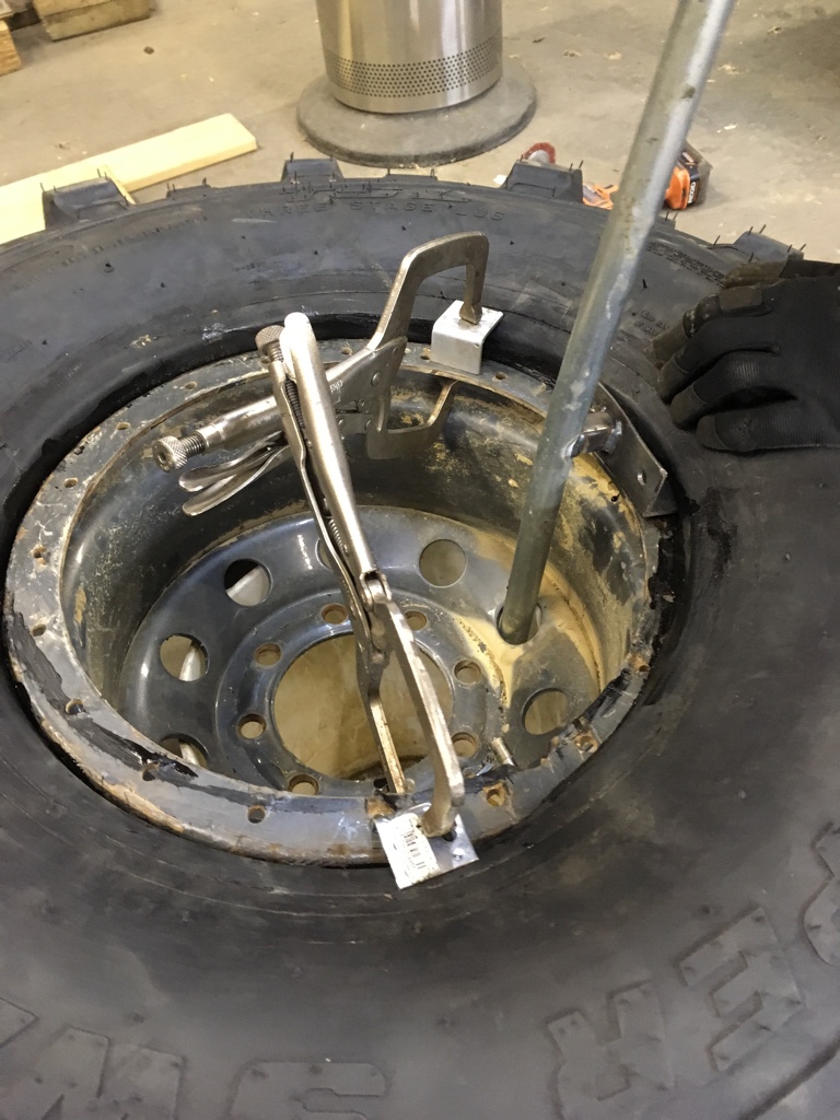

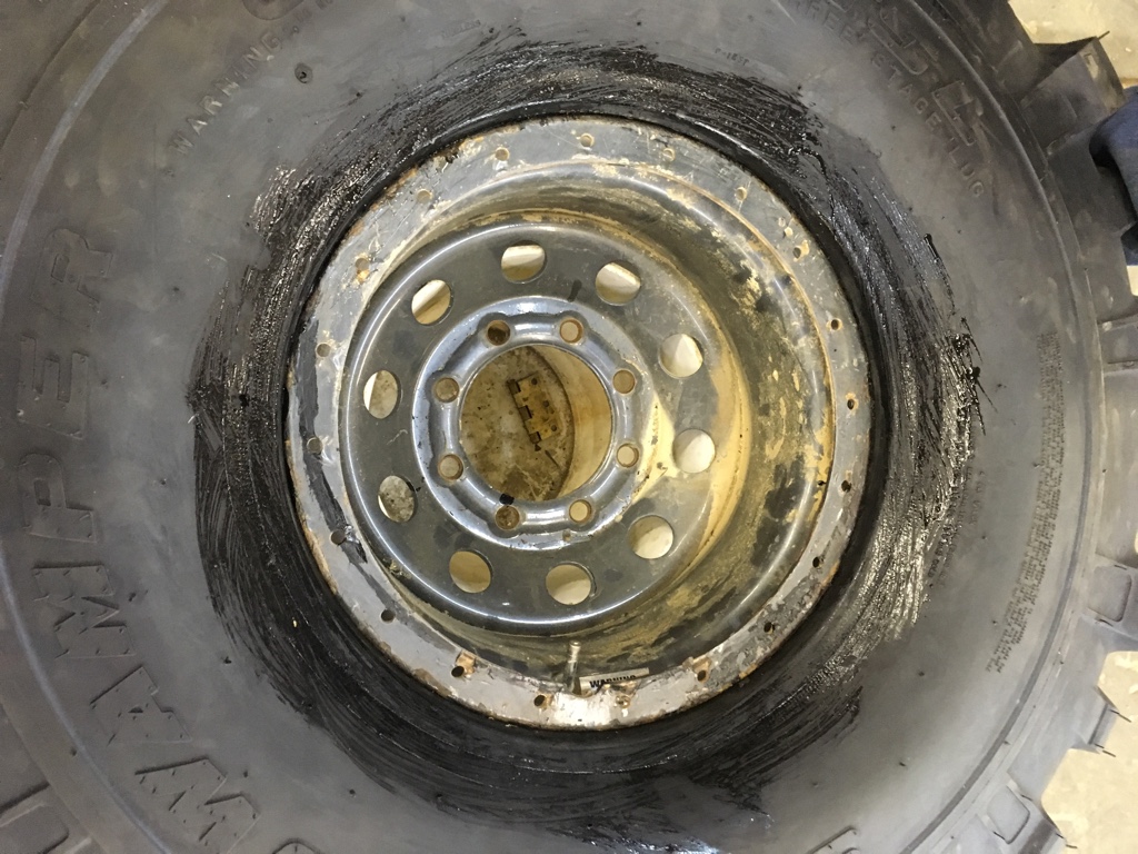

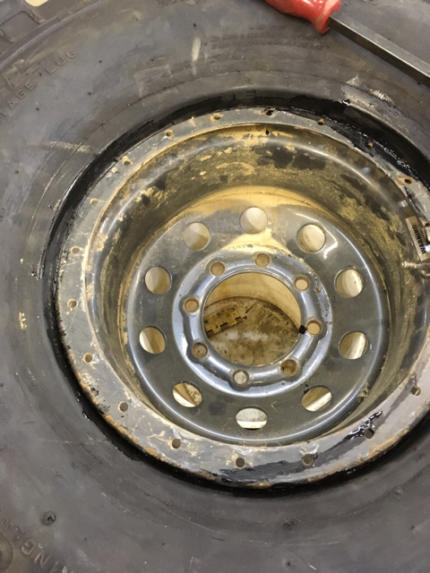

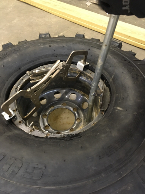

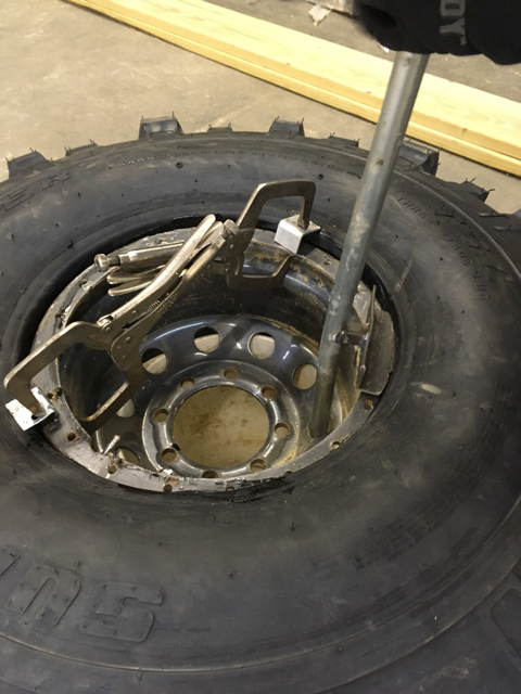

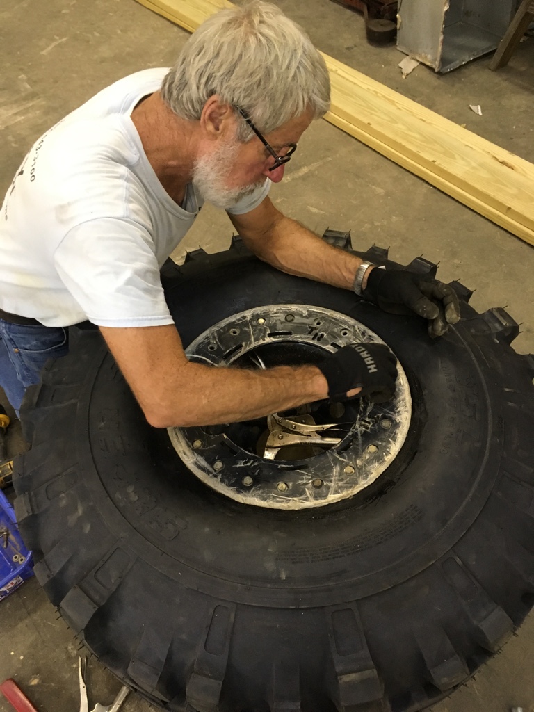

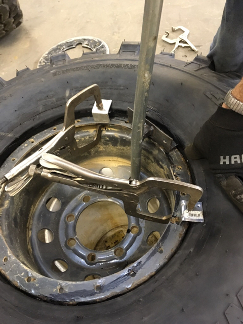

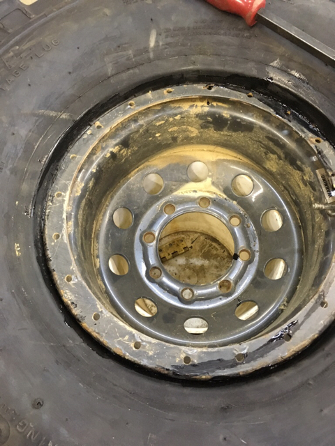

Then helped my dad @moldman05 make a tool to get the bead into position on his bead locks and mounted up a 42 tsl. He is going to try cut tsls instead of his iroks if we can get them all mounted and installed.
May be cutting them in the parking lot lol.

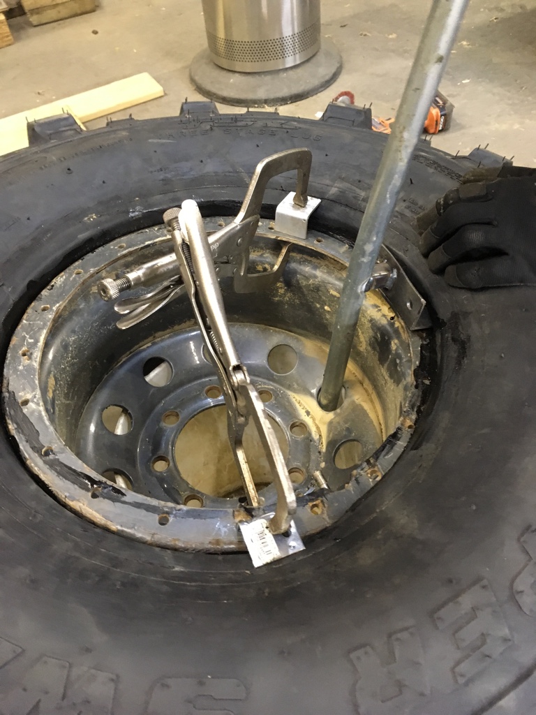

Keep working clamps closer together.

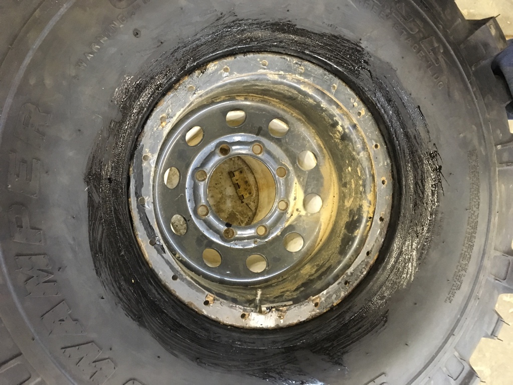

Before you know it, entire bead is started where it should be, ready to bolt on the ring.
A little soap to help the ring slide on the tire while tightening the bolts.

I really want to learn how to do tube work. I got the plate shit down but never messed with any tubing

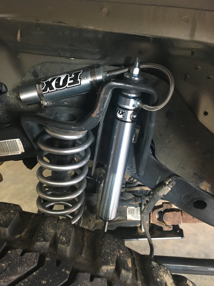

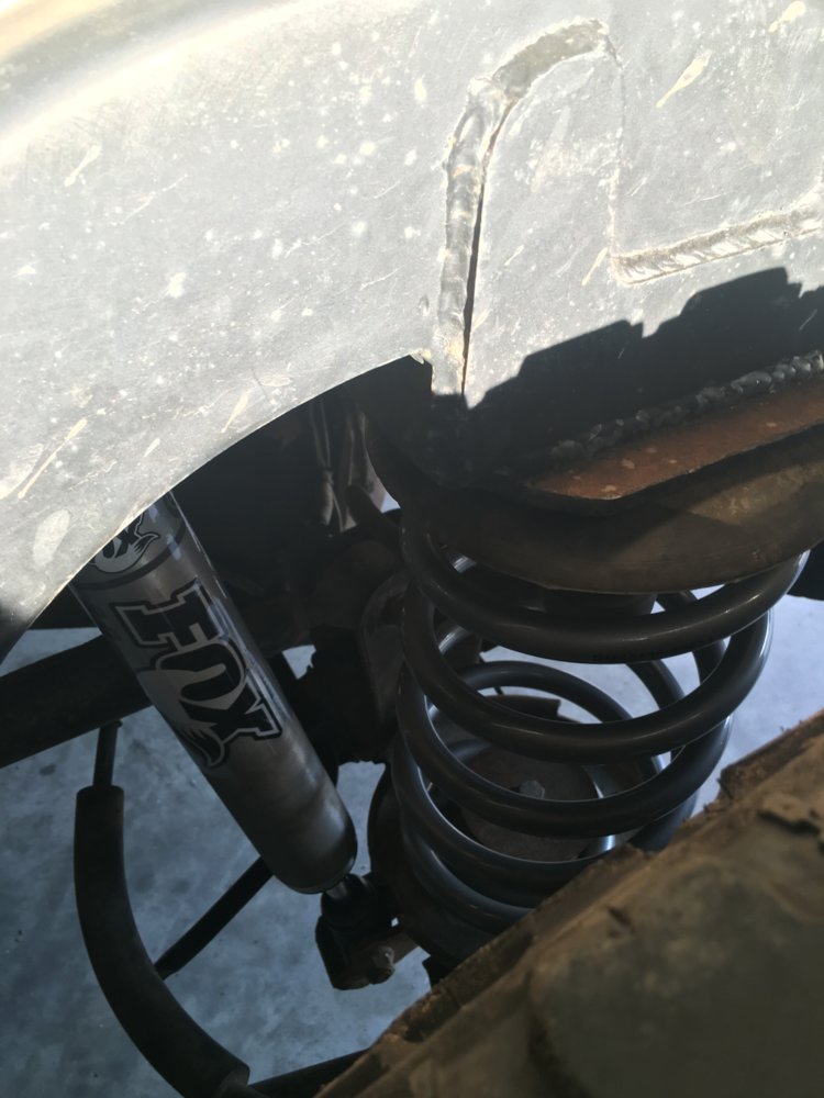

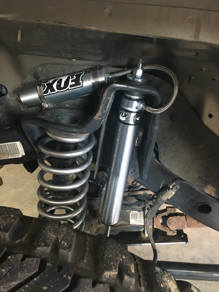

RE springs and Fox shocks for the TJ. I know that the damn Fox label is upside down but that's the only way I could get them secure. You can read it better when I get on the shiny side at the SHOP on the next ride. Gained about 2" more clearance for the 37's. View attachment 226550 View attachment 226551
Easy fix just let the nitrogen out and the canister will rotate on the hose end so you can turn to the label on the other side that fox turns the opposite direction.
