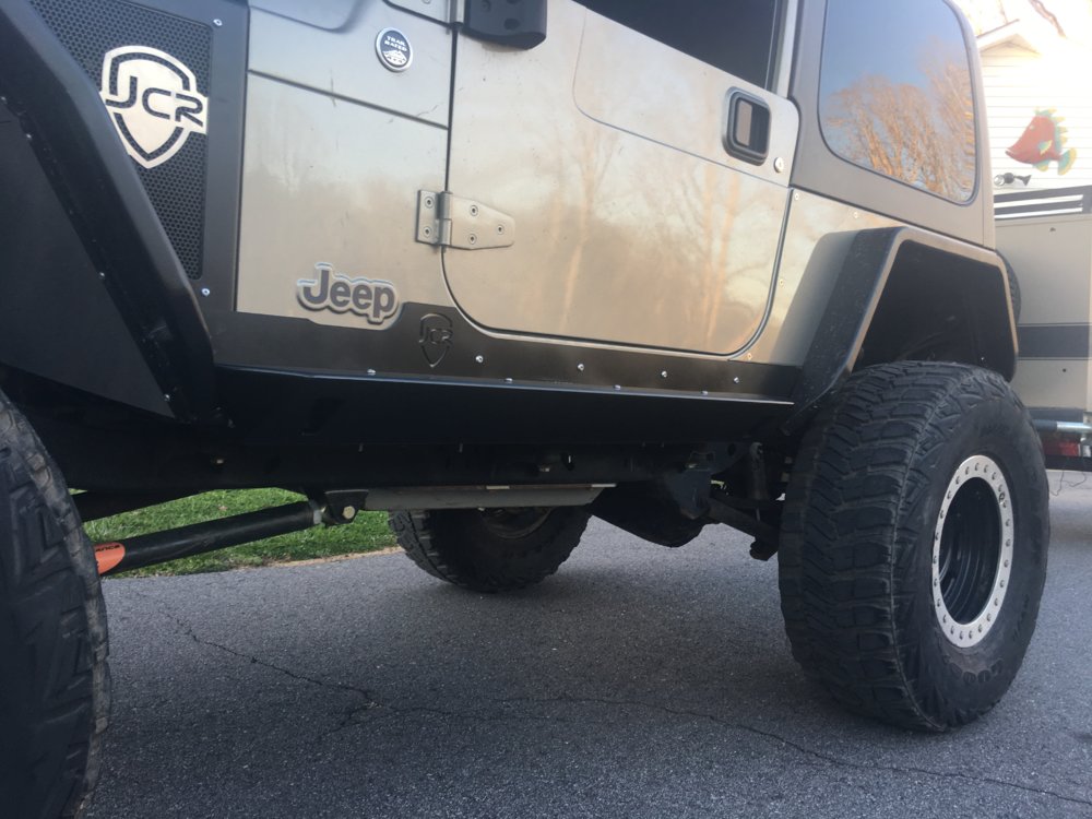

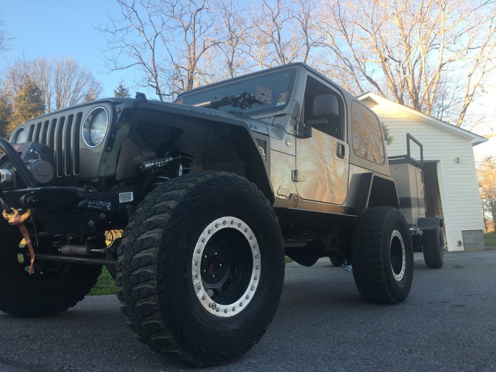

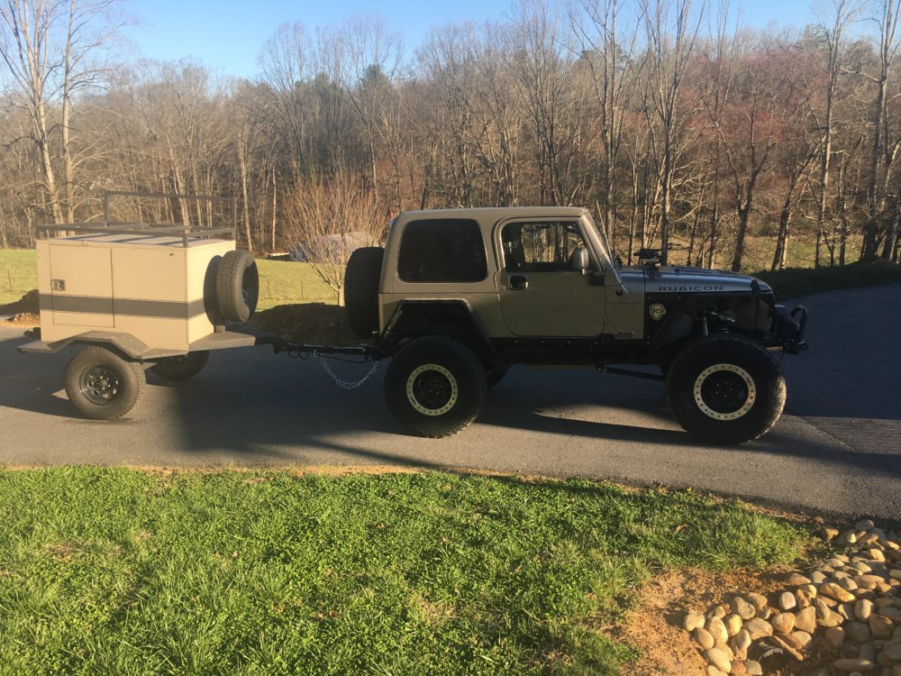

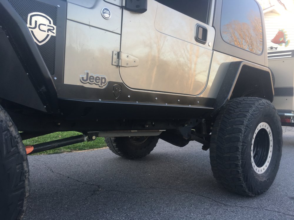

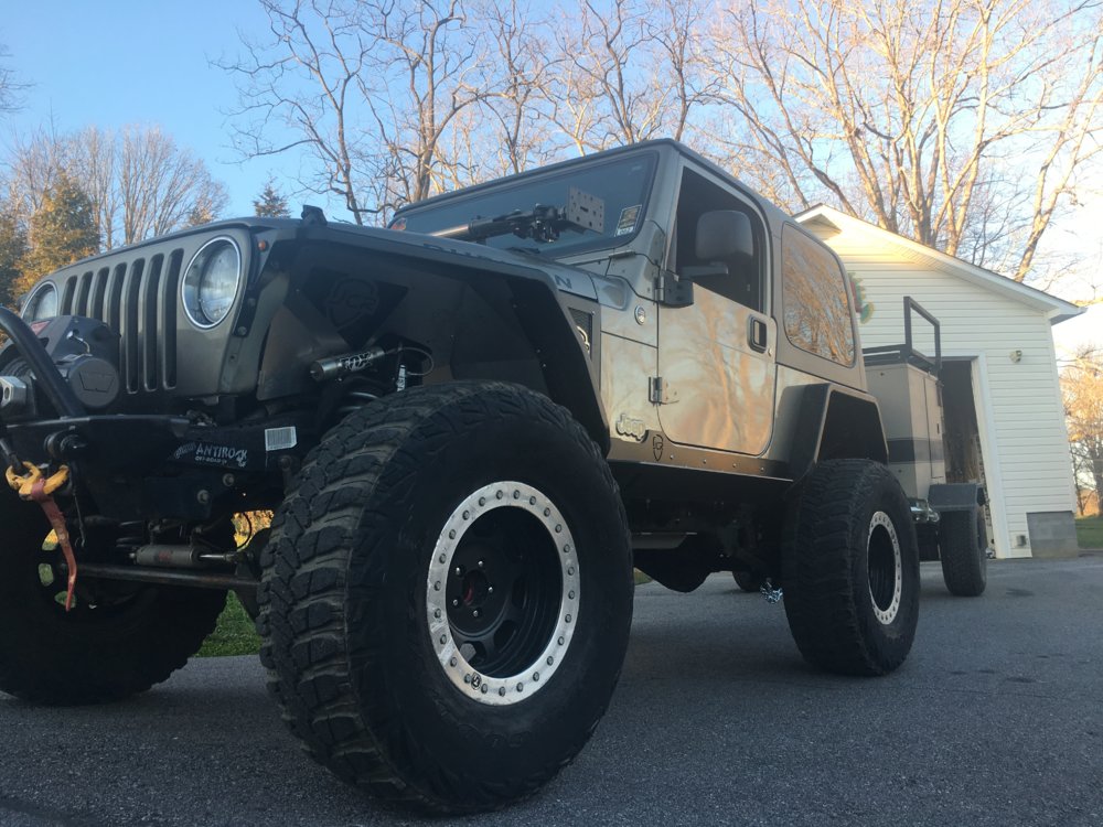

All finished up with sliders View attachment 263931 View attachment 263932
Not enough black to be a "shot callah" just yetMy man, between your Jeep and your trailer, you are ballin'! Maybe getting into @CasterTroy territory. LOL!![]()

JCR@obullfish what brand sliders are those?

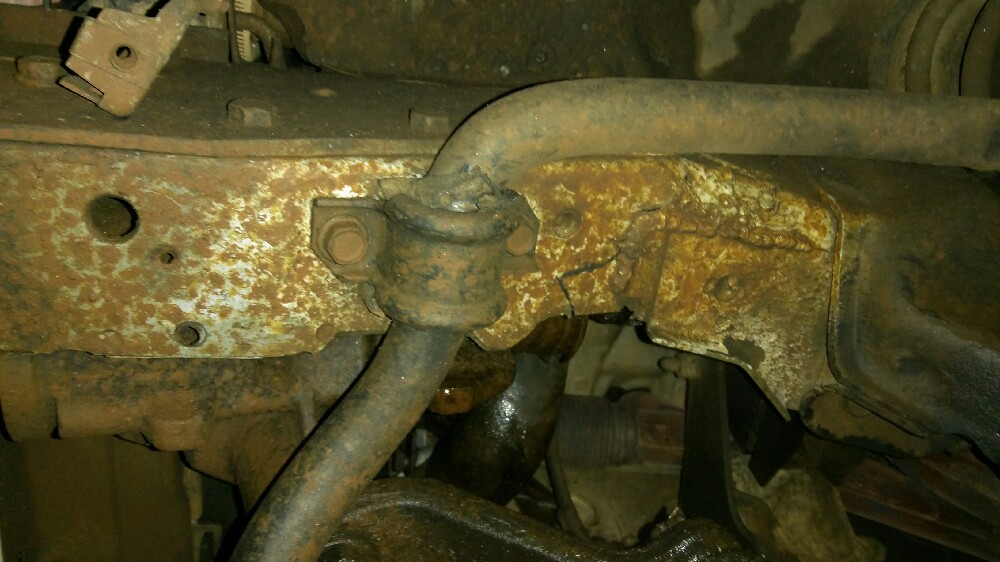

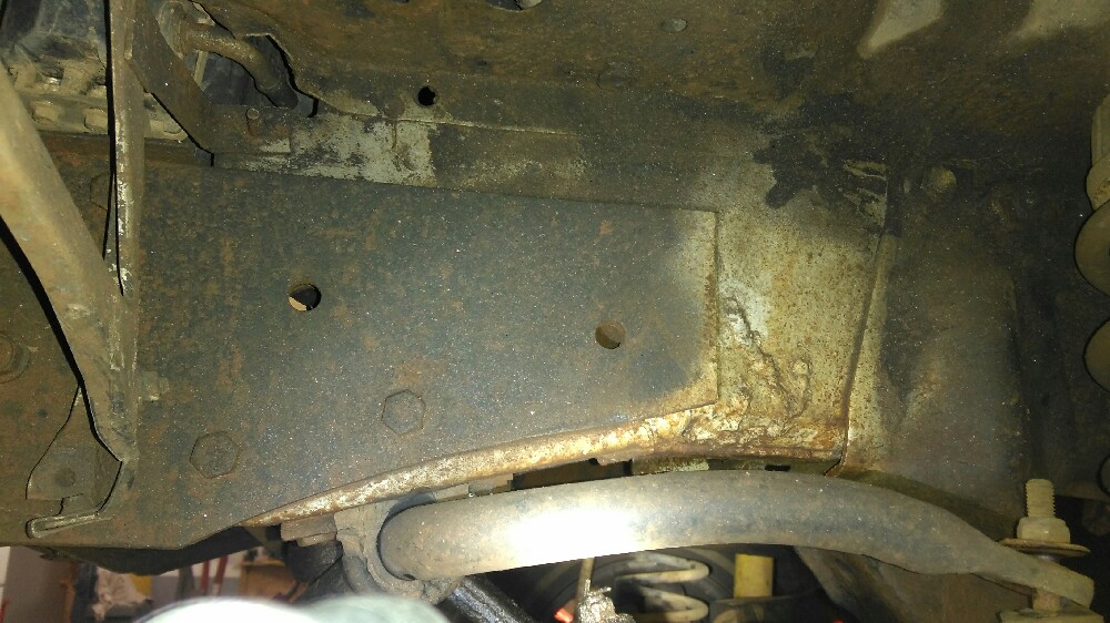

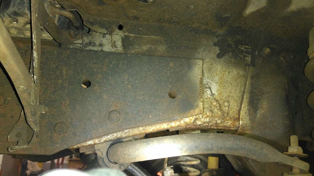

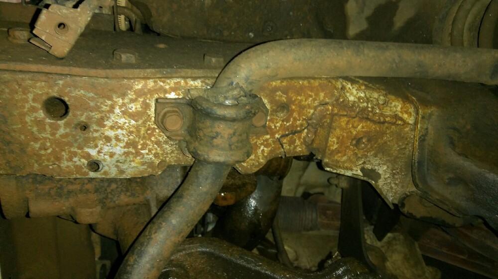

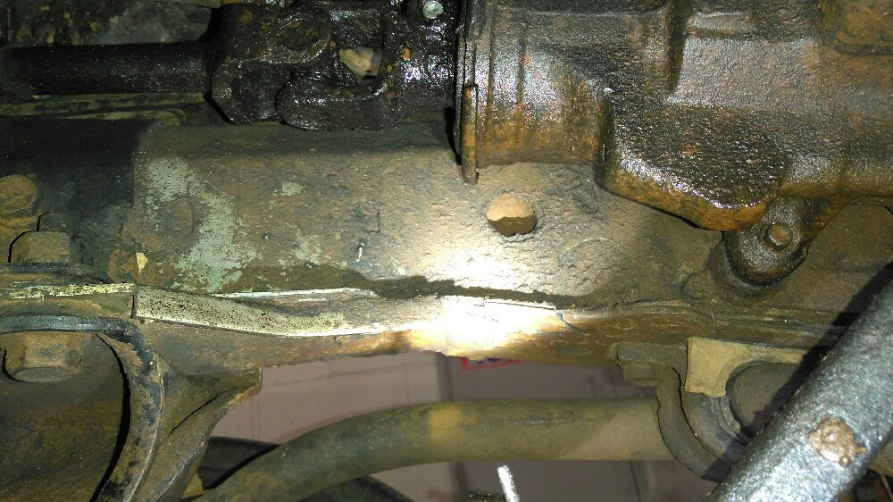

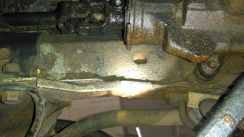

Checked out my shaking at speed after hitting a bump.. fixed this once already.. this time I'm going to plate from the bumper to the track bar, I suspect that is what caused the cracking because they are prone at that area anyway.
View attachment 264028 View attachment 264029 View attachment 264030
At least it didn't crack along the original weld except in one spot, so I must have caught the ends when I stop drilled prior to welding.
