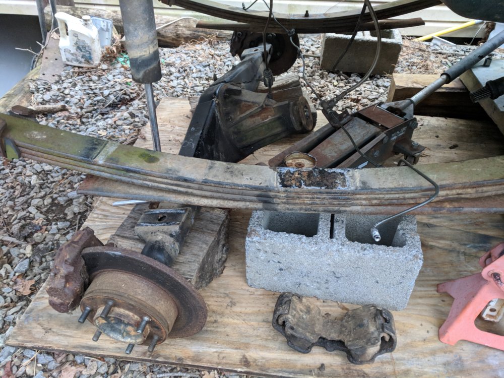

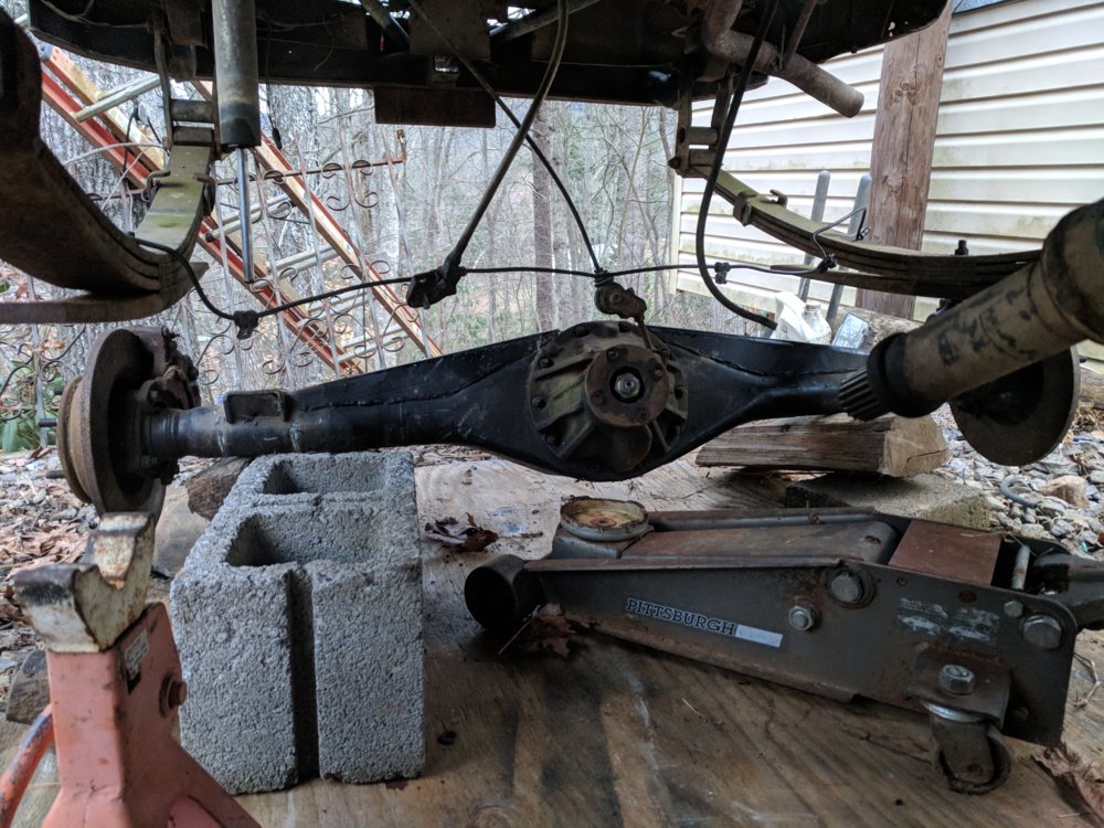

pulled it out. discovered a front axle leak out the long tube. discovered the prop valve is leaking. guess need to pick up some teflon tape? wired up the speakers and took a test drive to test the brakes after another tweak - stops much better. found the rear lines were pinched shut with the flex tube.
Should be inverted flare, in which case the seal is the flare. Tighten it up or reflare it.

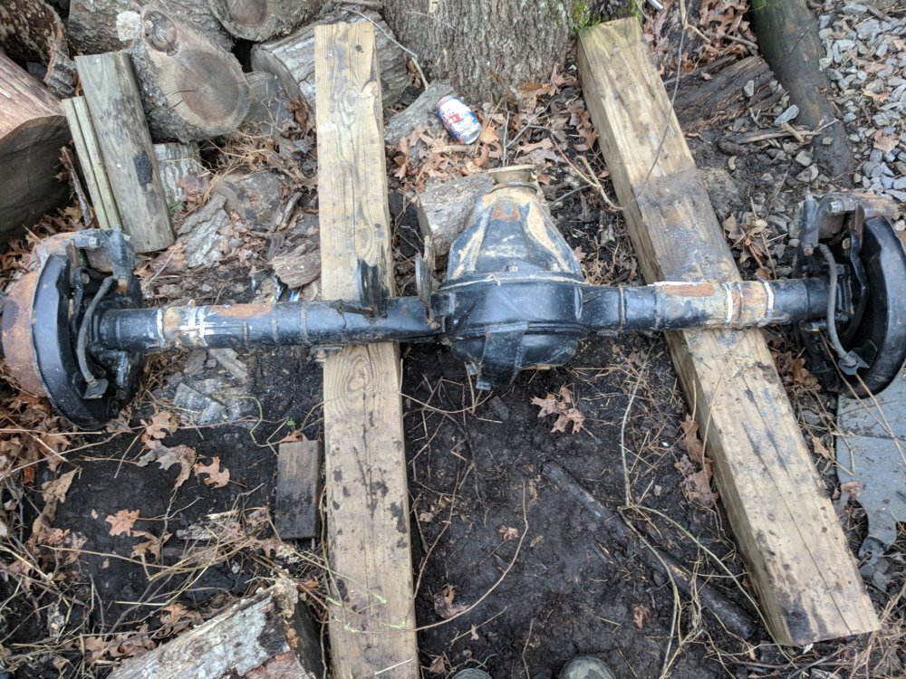

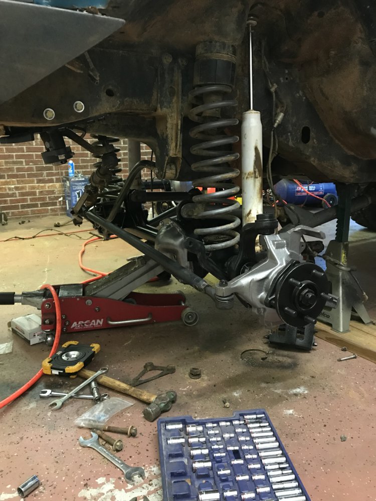

Got my new front axle in. It’s been completly gone thru with new seals, Spicer joints, Chromoly shafts with full circle clips, and gussets on all brackets. It also has 4:88 gears and a Spartan Locker. The matching 8.8 goes in next.

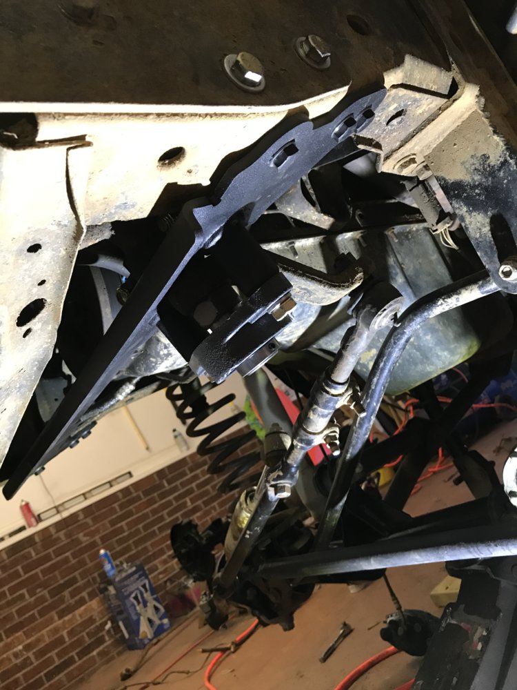

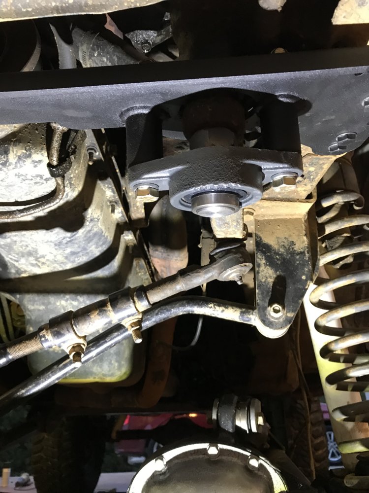

Here is a shot of my steering box brace. It clamps onto the box, and uses a pillow block below the pitman arm. It runs to both sides of the “frame” and my bumper also braces the steering box. I got the brace from @IronManAndy and I’m very happy with it. Install was super easy.

That steering box brace is Awesome.

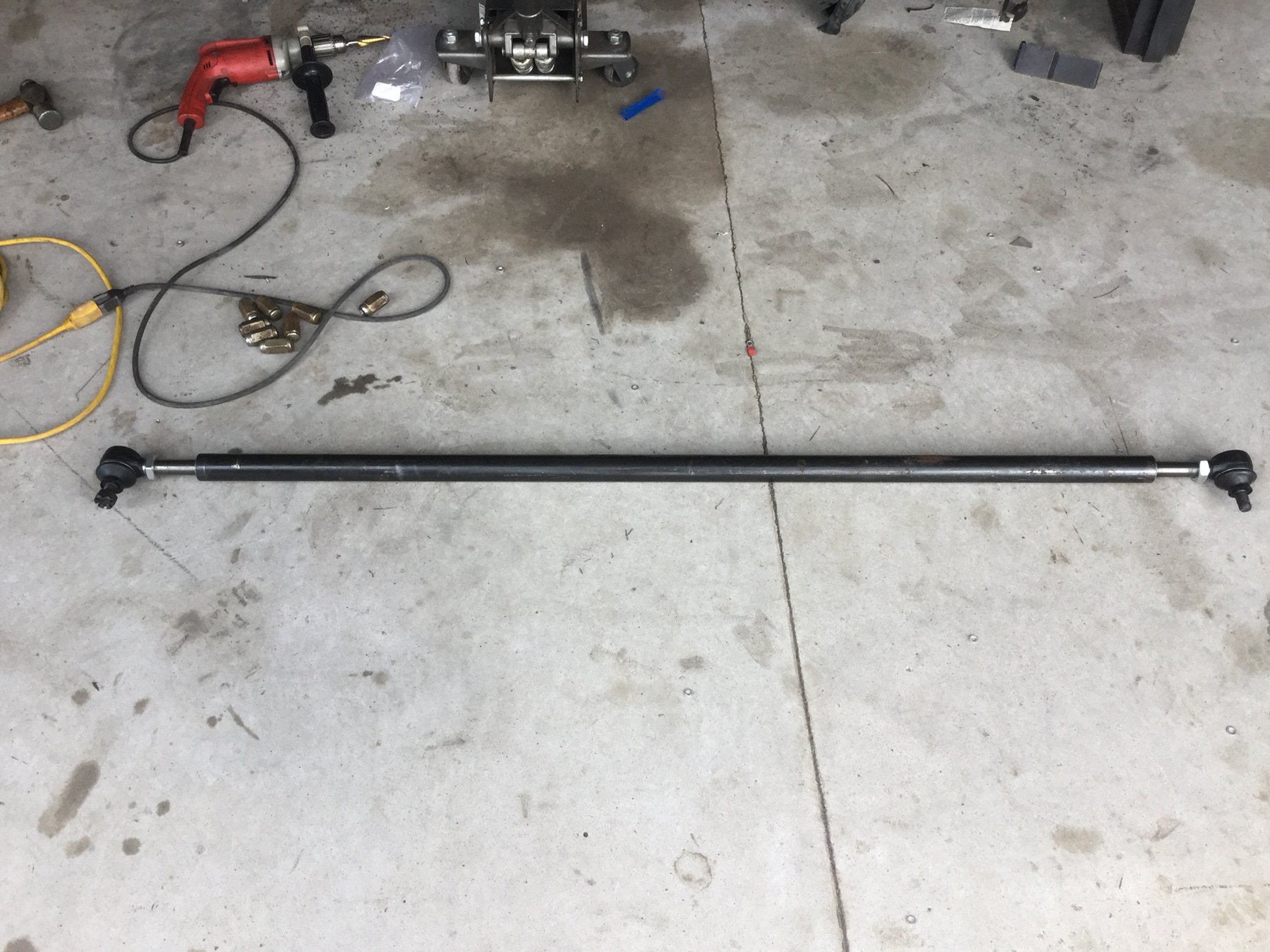

Finally fixed a messed up tie rod hole and installed the rear driveshaft, found a caliper that won’t let me bleed it, and I’ve still gotta put the intake manifold back on it and top off the fluids.
