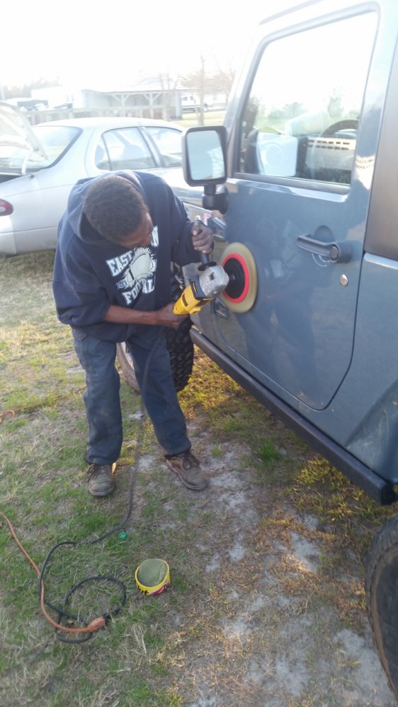

Not me but old fellow that's works on the farm. Makes Scratches disappear. 20160114_164938.jpg

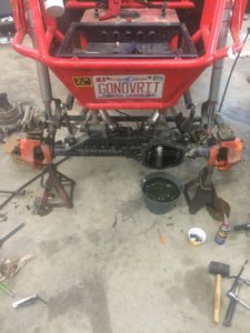

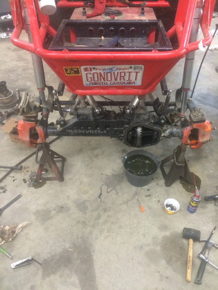

Tore my rear axle down to install new ujoints and inspect the R&P. Then I proceeded to break not one, but two pair of HD snap ring pliers:kaioken:

Yes sir. But I tried 5 different damn brands of snap ring pliers today with no luck. Any suggestions? Don't say oem, channel lock, craftsman or lisle.
Like Jody said spend the money and get u a good quality set of Snap On pliers.The 205 cases have some stiff ass snap rings in em and the Snap Ons were the only ones that would bring em off w/o the help of a flat screwdriver. IIRC mine was about $75.
Snap On. I grabbed some a few years ago off the truck in Boone a few years ago. Worth every penny.

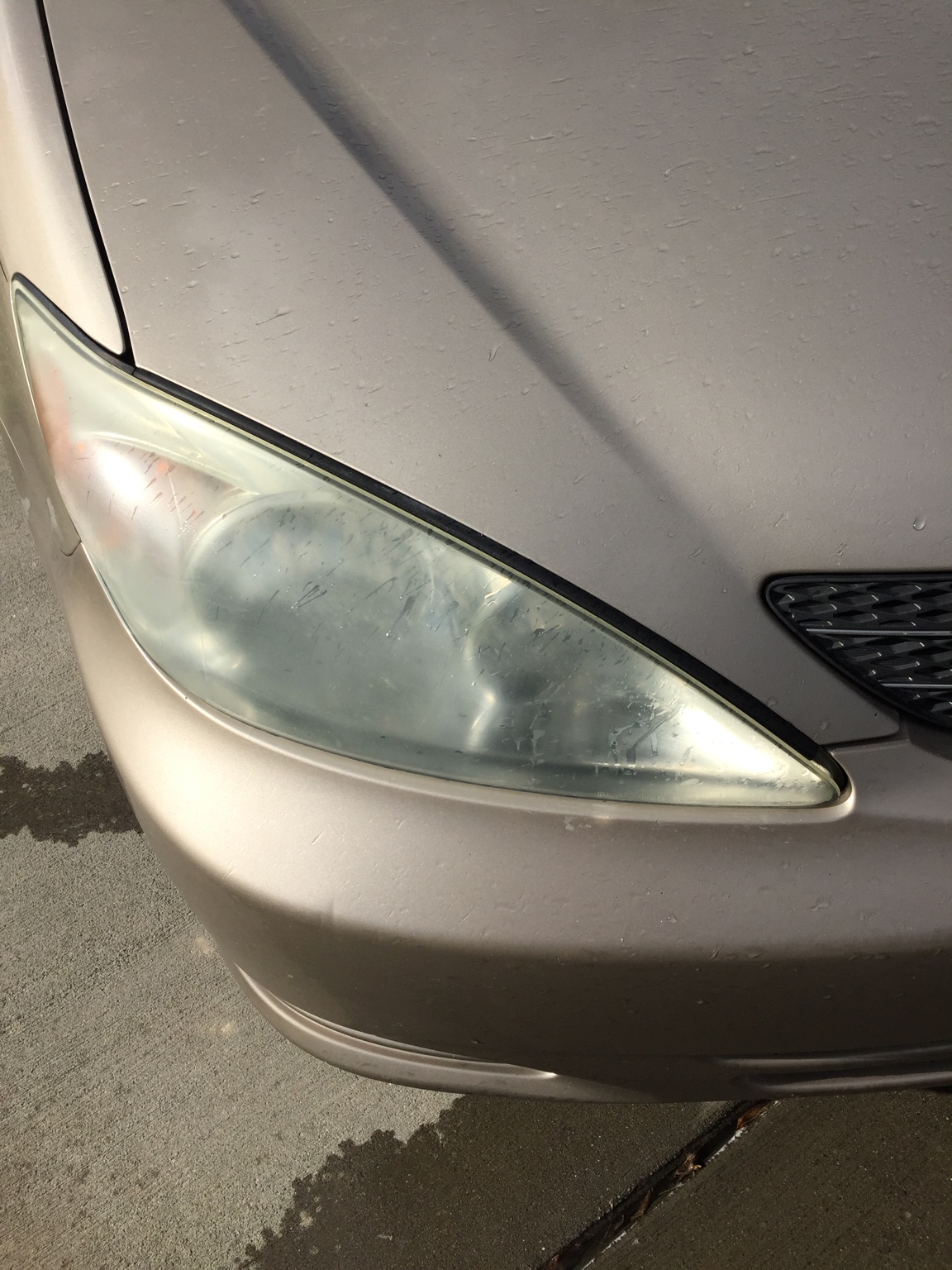

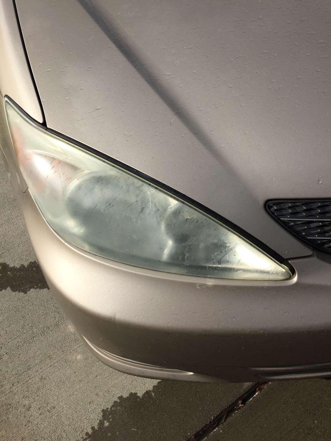

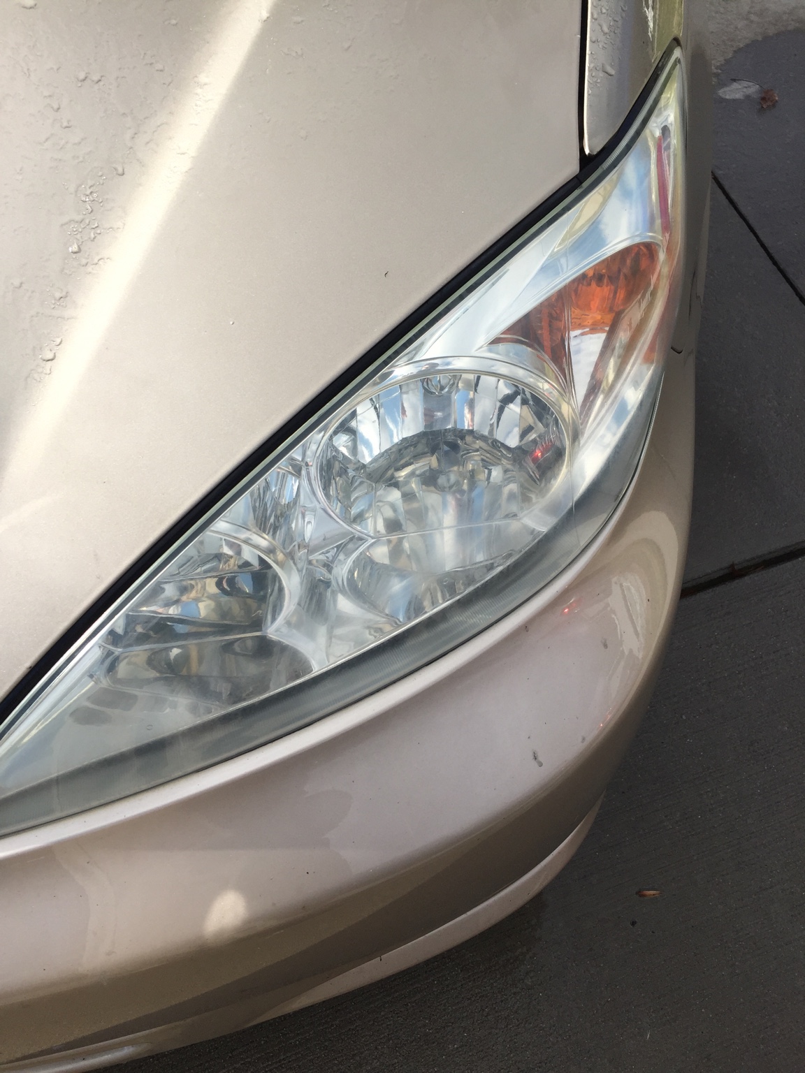

Not my rig, but installed some HID lights in my car and cleaned the lenses with toothpaste.
By the time they dried they didn't look as good, but still a big improvement. Need to do it again with a grittier toothpaste and put wax over them after.
I bought this stuff a while back and did my father in laws headlights. It left them looking pretty good. I used a mini air buffer and a foam pad set at medium speed. It leaves a wax on them that keeps them from clouding back up.
Turtle Wax/Headlight lens restorer kit T240KT - Read 9 Reviews on Turtle Wax #T240KT
