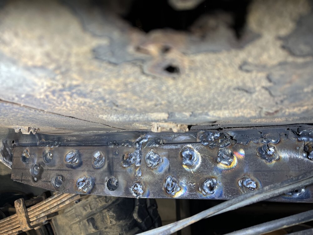

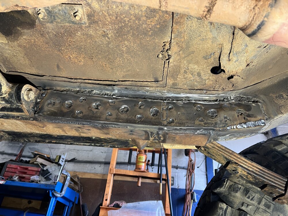

Going to declare the welding/grinding on the passenger rail done. On to drivers side.

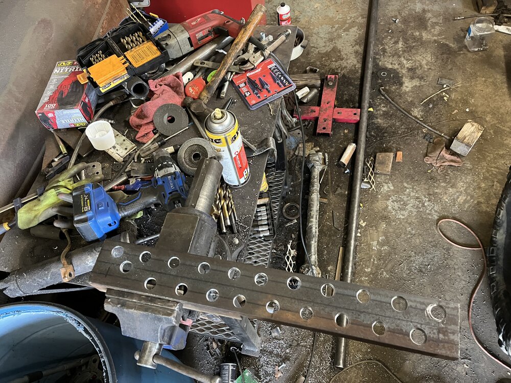

Drilled the driver side a little different.
Note the messy shop.

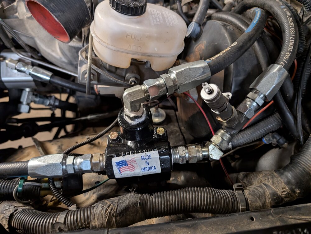

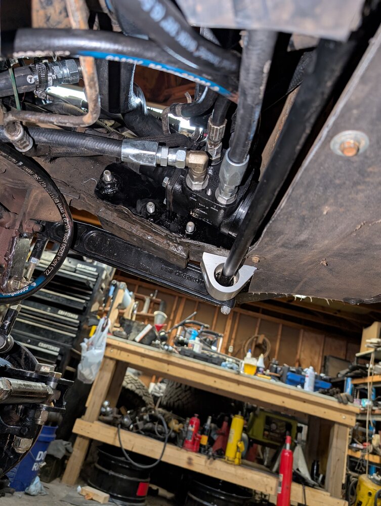

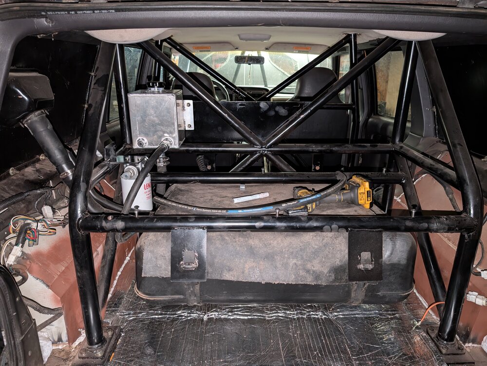

Hydraulic steering is getting a bit closer.

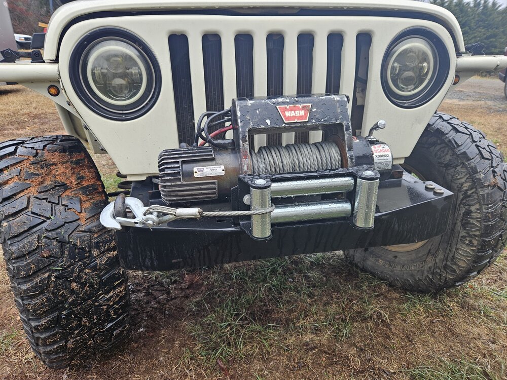

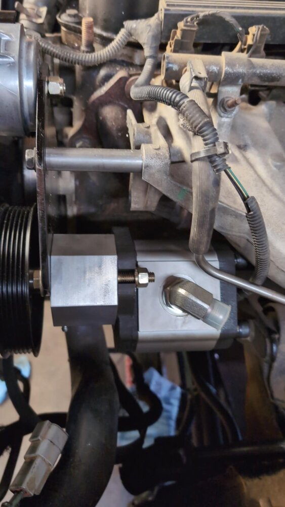

yes, it's made for a TJ however I am making it work on an XJ.
good fella to deal with.

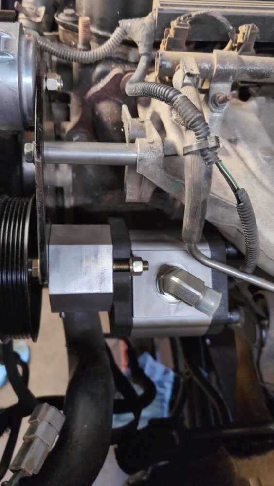

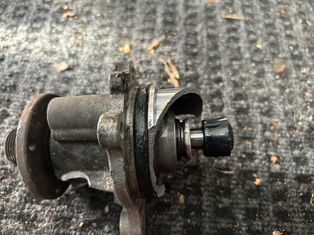

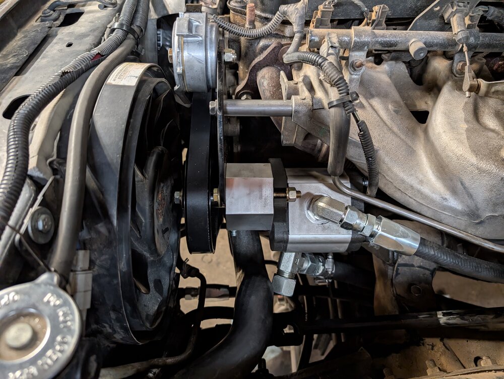

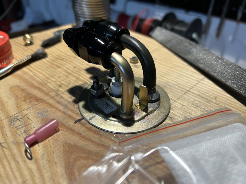

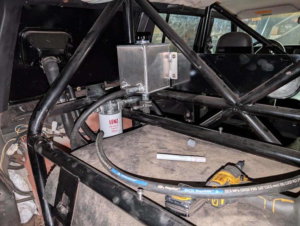

I still have some securing of the hoses and some re routing. Waiting on a couple re usable hydraulic fittings. Thought you fellas would like to see some pics ofthe gear pump set up for my hydraulic steering.
I guess the gear pump does a better job of pulling the fluid?
I have the reservoir above the pump, so it's gravity fed, not sure of its pulling abilities, the factory vane pump will handle more RPM's. But the 4 speed TC and 4.7 stroker keeps my rpm lower, it fits my needs better. There is also bragging rights and kewl factor.
