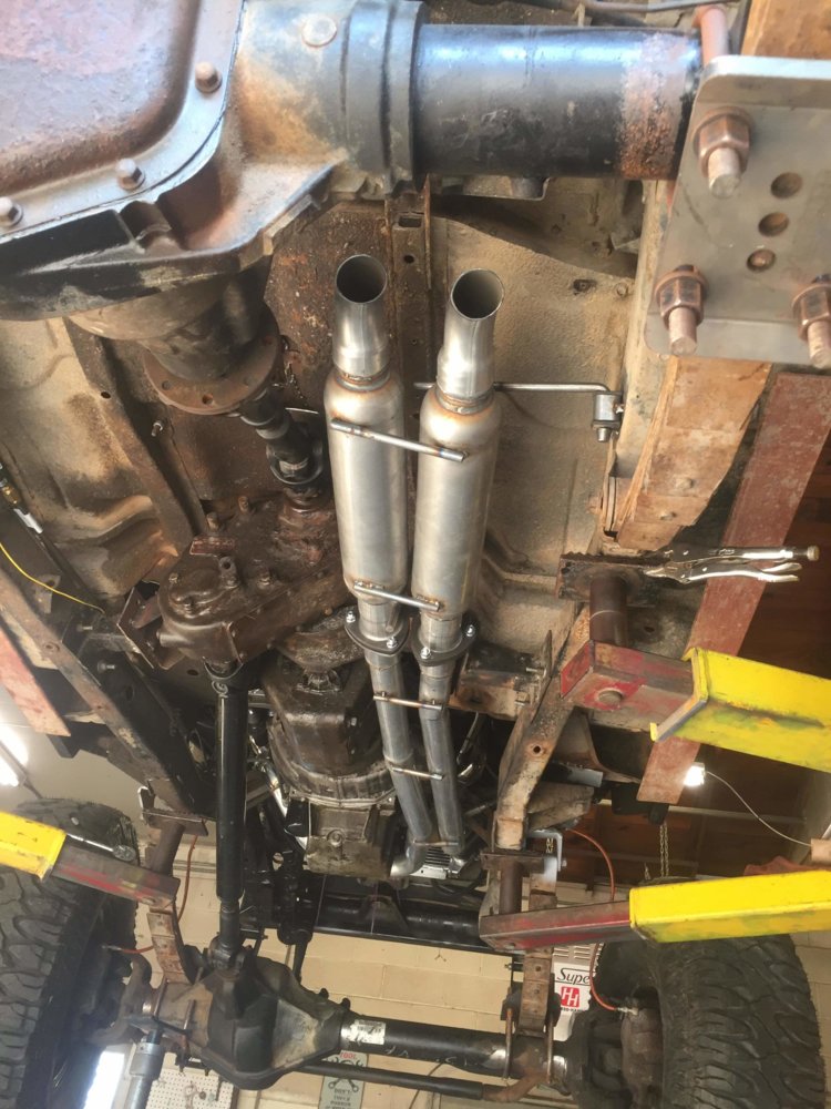

Here's a pic of the exhaust work and of where she sits for now. Ready to put some miles on the build.
