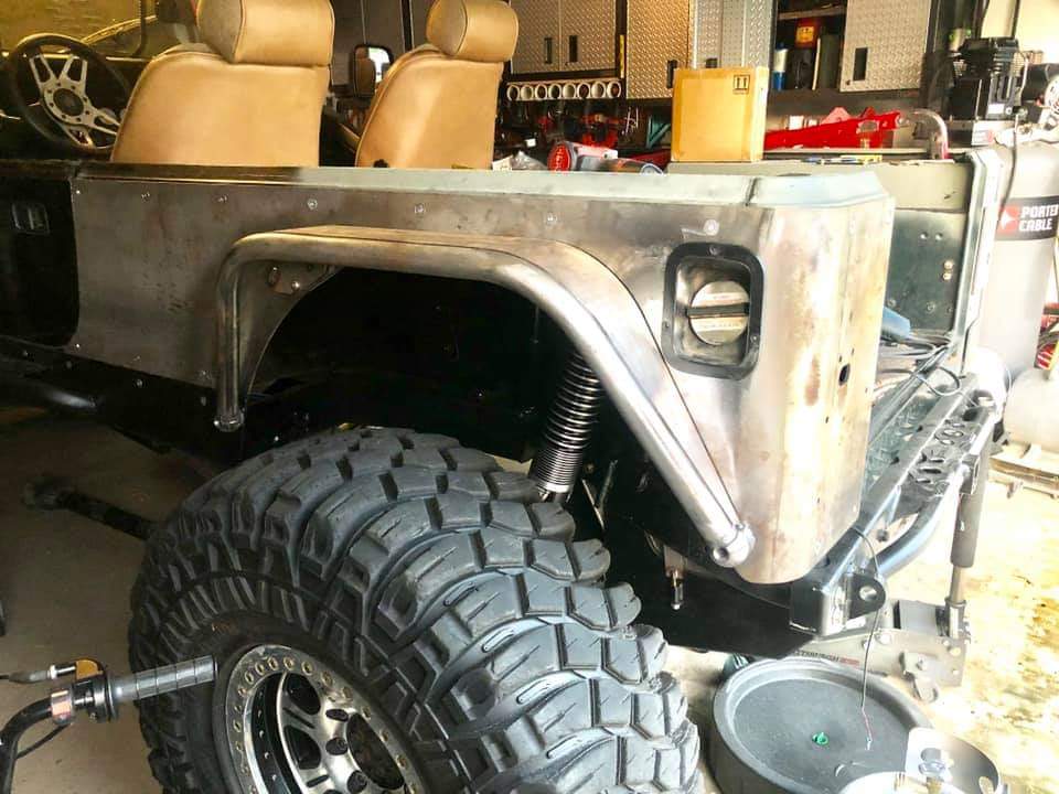

Messing with the clutch rod more and it feels alot better. Still a very stiff pedal and the clutch arm looks twisted but I can look into that later on. For now I'm happy that it is disengaging predictably. Still on the lookout for a dual diaphragm booster to replace my current one. I am starting to think I may have a vacuum leak and that's the only place I can imagine it being with how dry the grommet is. When i hold the brakes after the jeep has warmed up (doesn't so it cold) the rpms will drop from 600-400. Something to look at. Also looking into all the parts to move my filler neck to the outside of the tub from the fuel cell
similar to this. Then working on covering up all the exposed holes in the floor. The project list is getting smaller at least!
