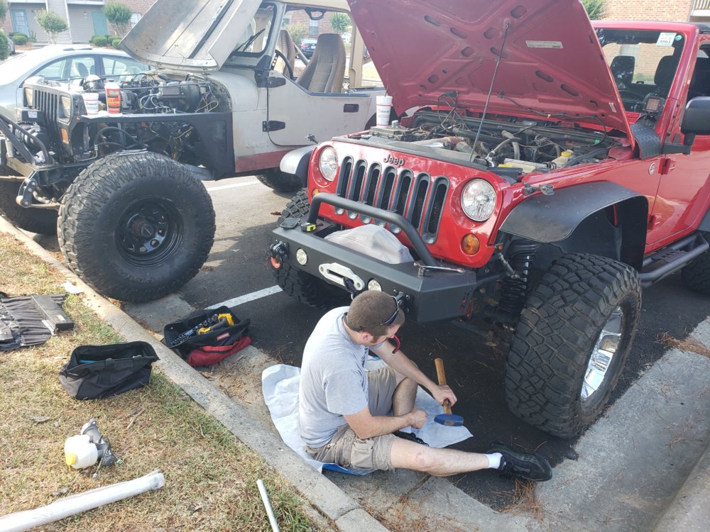

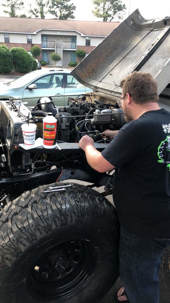

Helped a buddy swap out his tie rod on his jk for a barnes aluminum one and installed the e350 master cylinder today after having some lines made. Brakes feel about 80% better. Still not quite where I want it but I think some more adjustment is needed. Braking force and pressure feels alot more consistent though. I had to egg out the mounting holes and sand down the outside of the mounting ears to get it installed. If anybody in the eastern nc area needs custom hoses. Phillip's hoses in Greenville has always done good by me. I got the e350 master cylinder and hoses made for less than what the ram2500 master cylinder cost me.

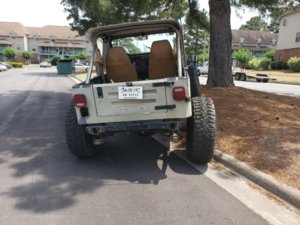

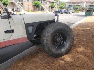

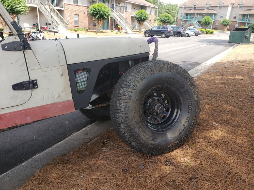

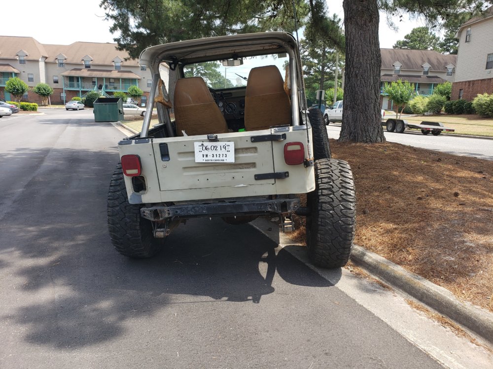

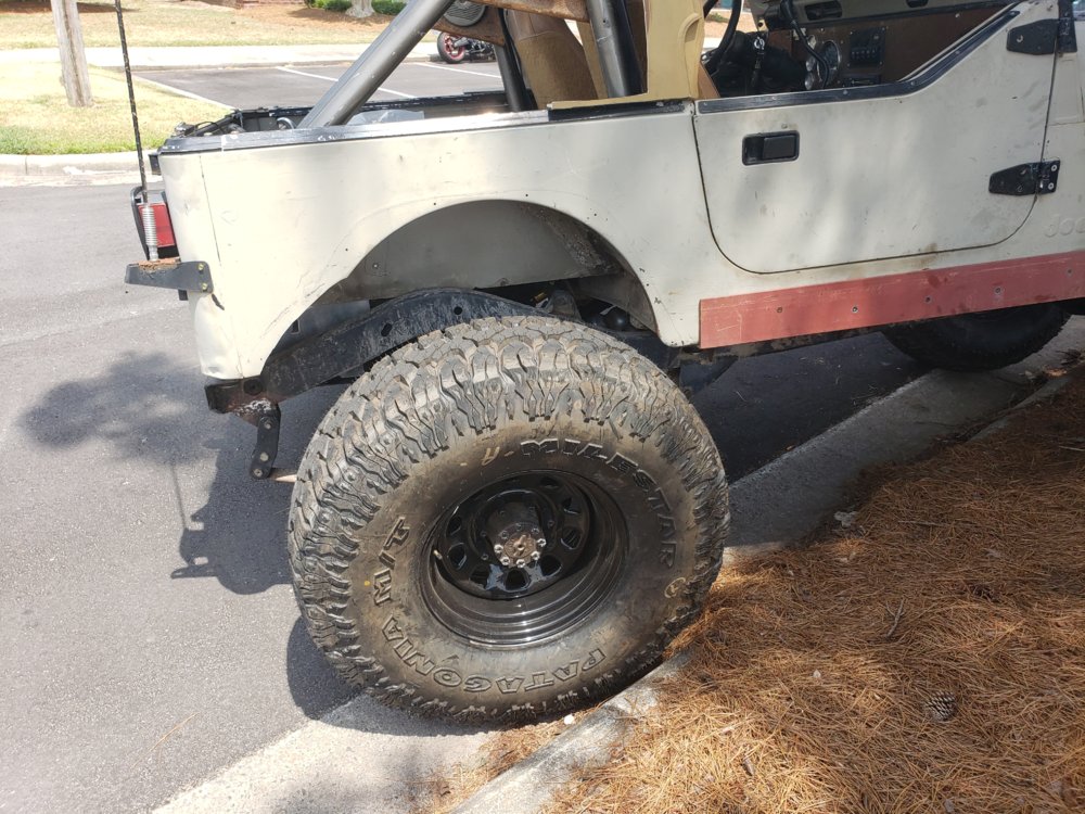

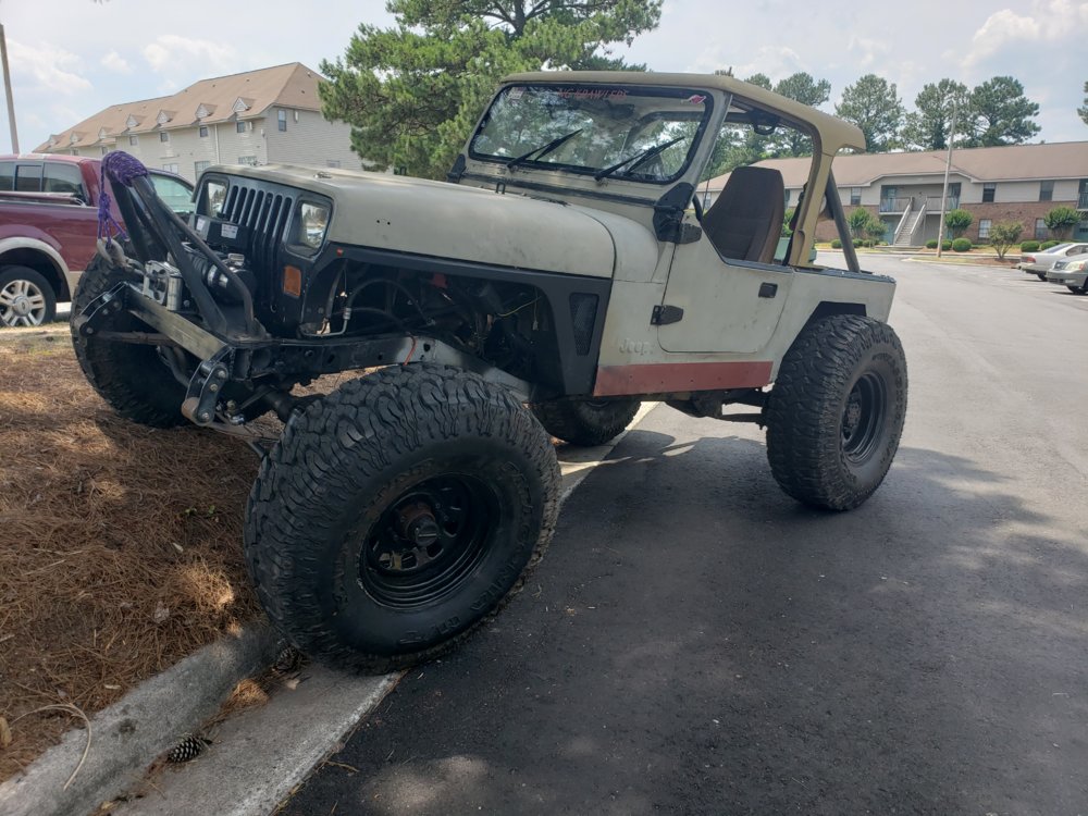

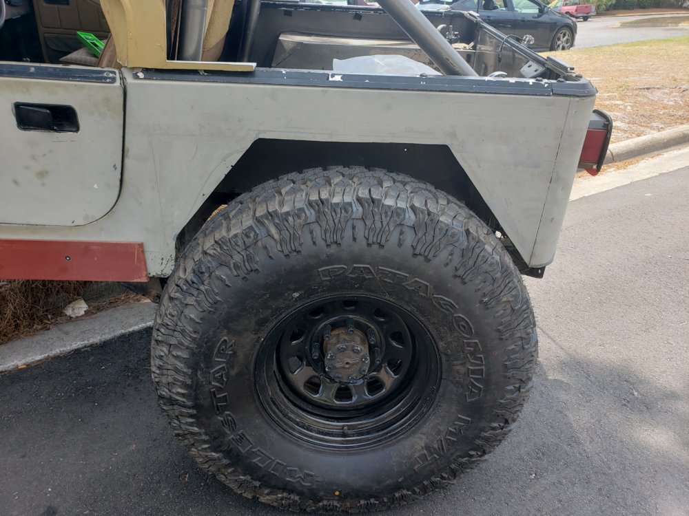

Gotta finish up the cut for the rear tires. Get the shock mounts on and install a horn then find someone to inspect it. Checked out the clearance after the cut and looks good so far might stretch the rear cut a little further. Got a video I can post later of how slow the jeep is in low range reverse. Got the coolant system bled finally so the jeep runs a cool 188-195 at idle in the sun without a fan shroud.
