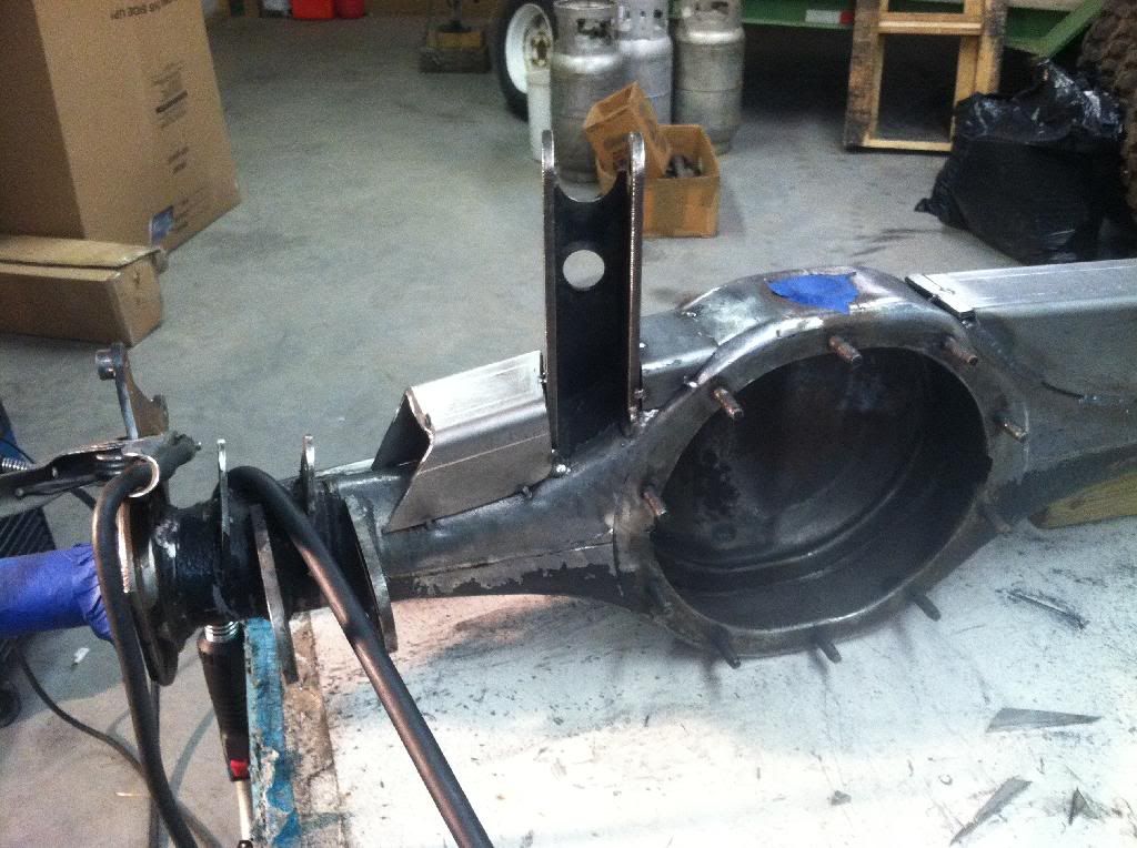

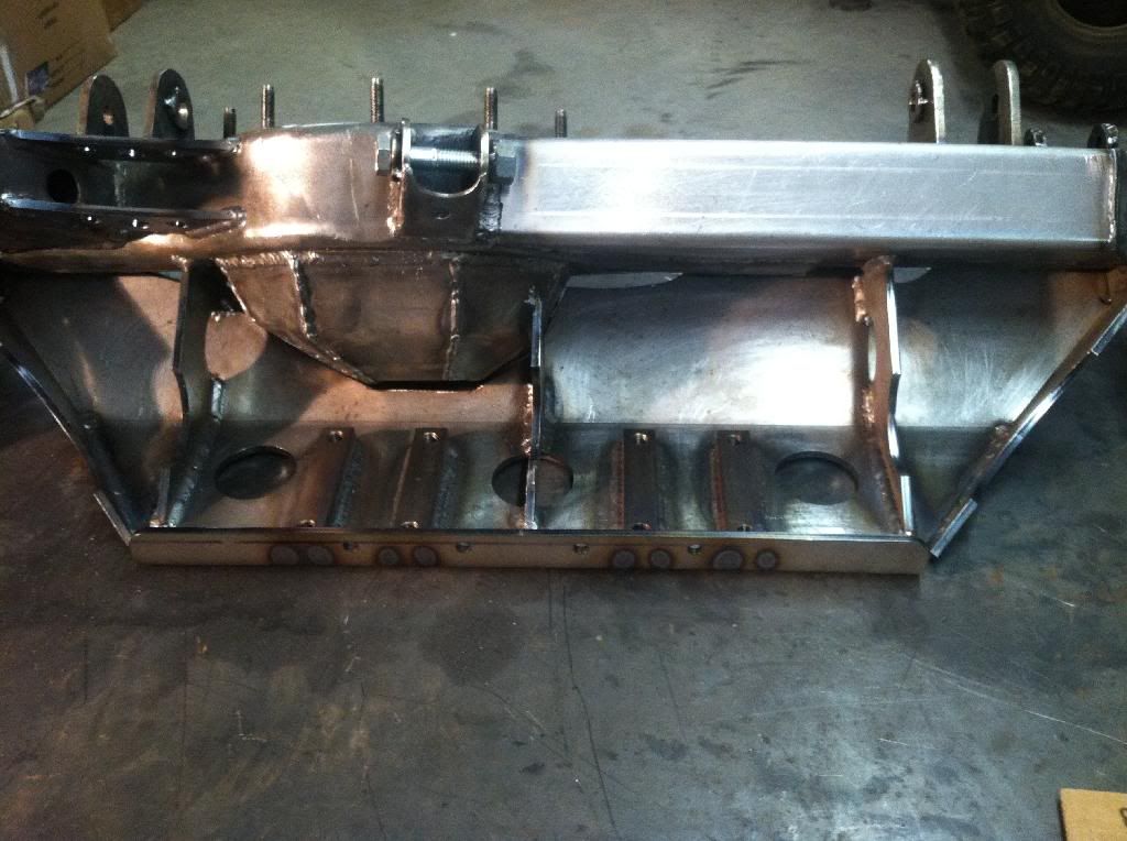

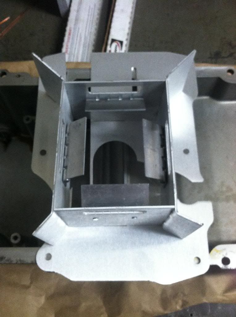

The factory 9" housings needed a little beefing up so I got a couple of DIY diff cover kits from BTF. I've got a couple ideas for trusses for both axles. I just need to pick up some steel and start making sparks.

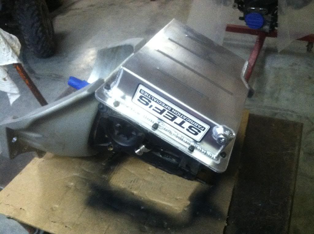

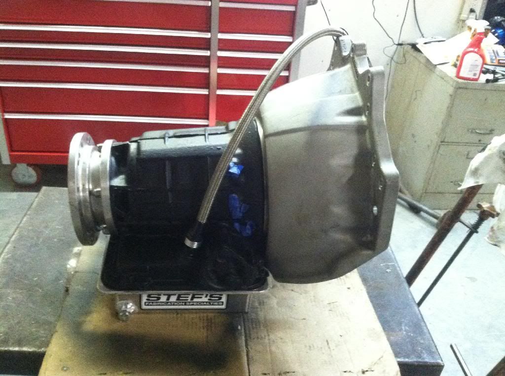

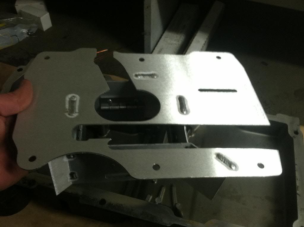

Then I bolted on the Atlas adapter, and added a Stef's Fabrication deep aluminum pan and Lokar locking dipstick.
I didn't get a picture with the tape, but it's right 18.75" overall length. That's why I chose a Powerglide for this build. Space is tight, and it offers a lot of strength in a small package.

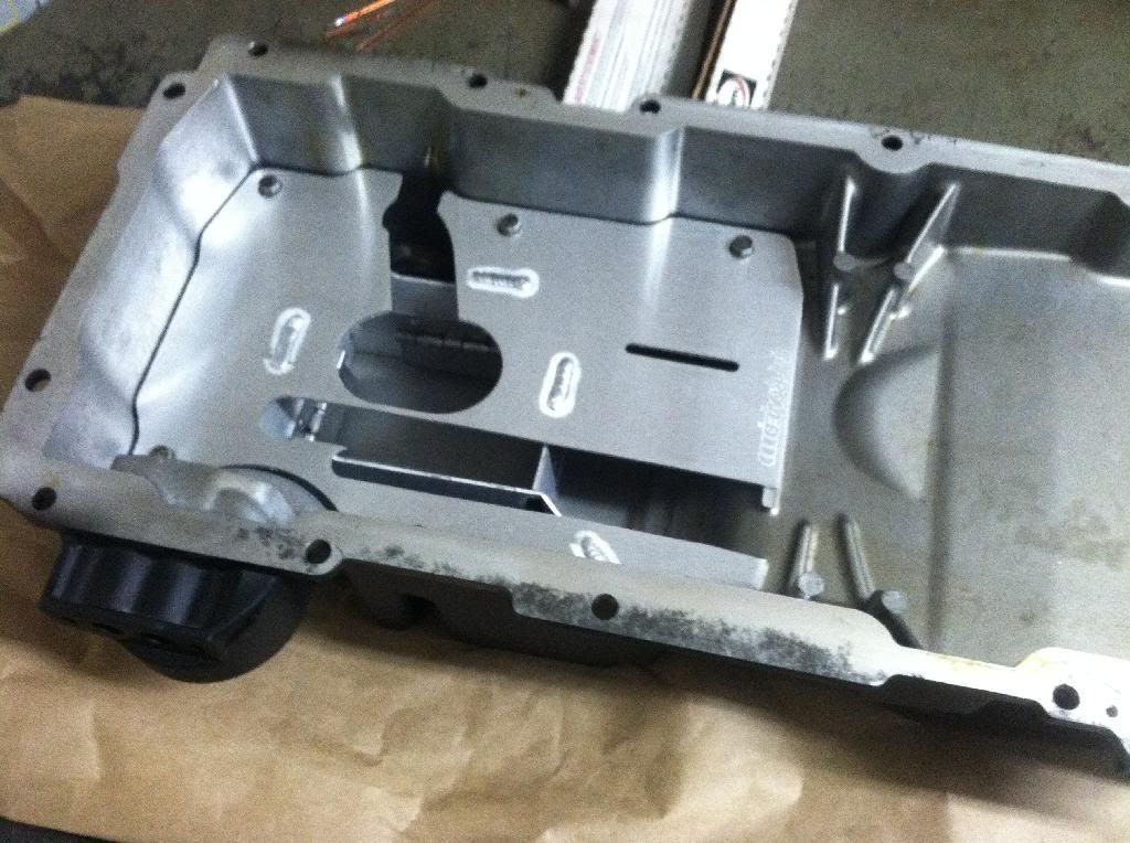

Since this is a rear engine buggy I'm runnin a front sump pan from a GTO. I got a trap door baffle that bolts in place of the factory baffle from Improved Racing. I plan to also add a 3 Qt. accumulator so hopefully oiling won't be an issue.

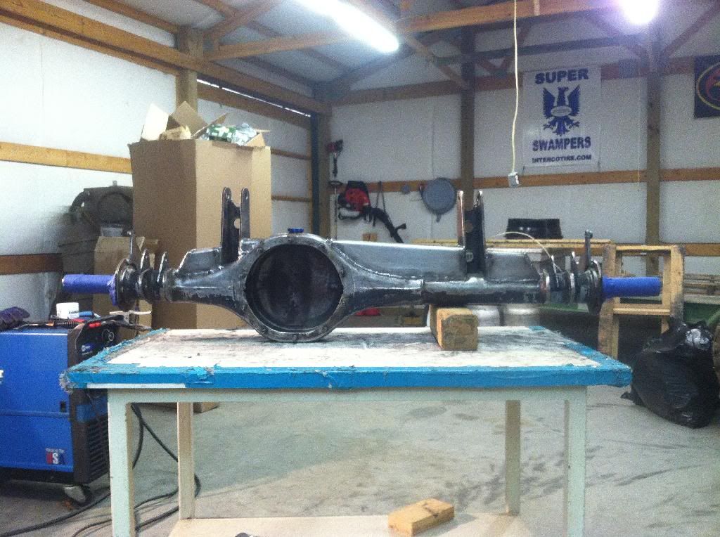

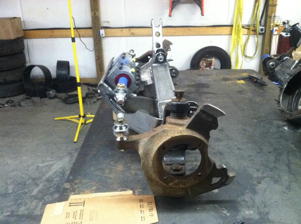

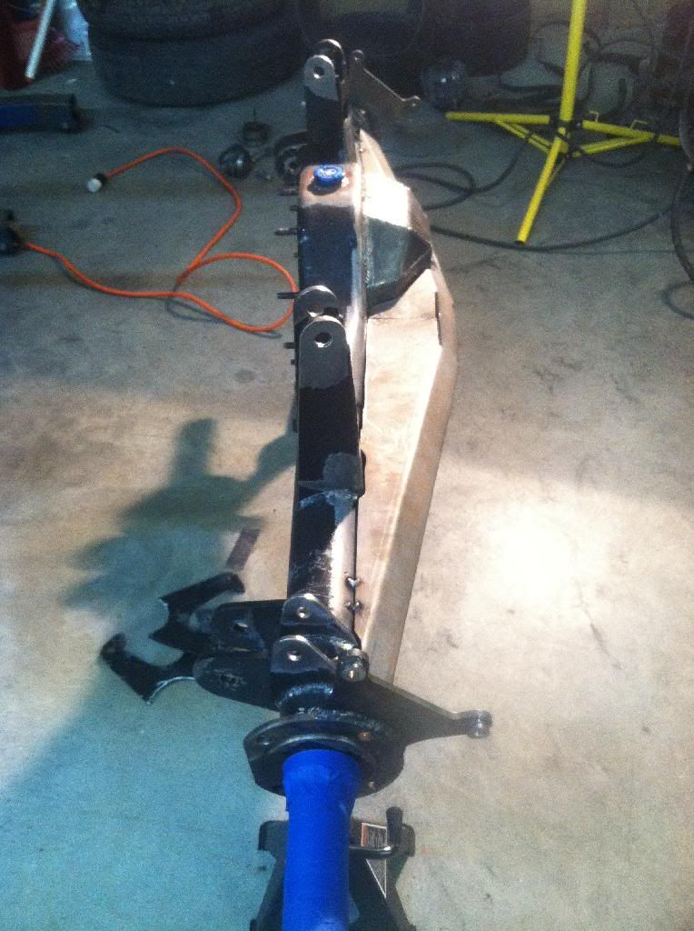

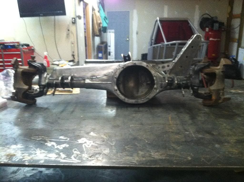

I've also been working on the rear axle. I decided to run Spidertrax/Wilwood brakes on all four corners to save some weight, plus they're pretty cool looking too.
I'm still kicking around the design for a bracket to bolt them to the Dodge knuckles in the front, but the rear was pretty simple. I had the hubs turned down so the rotor hat would slip on from the front. I got the caliper brackets from Racing in the Dirt, and I just had to weld a little spacer on them to get the spacing right.

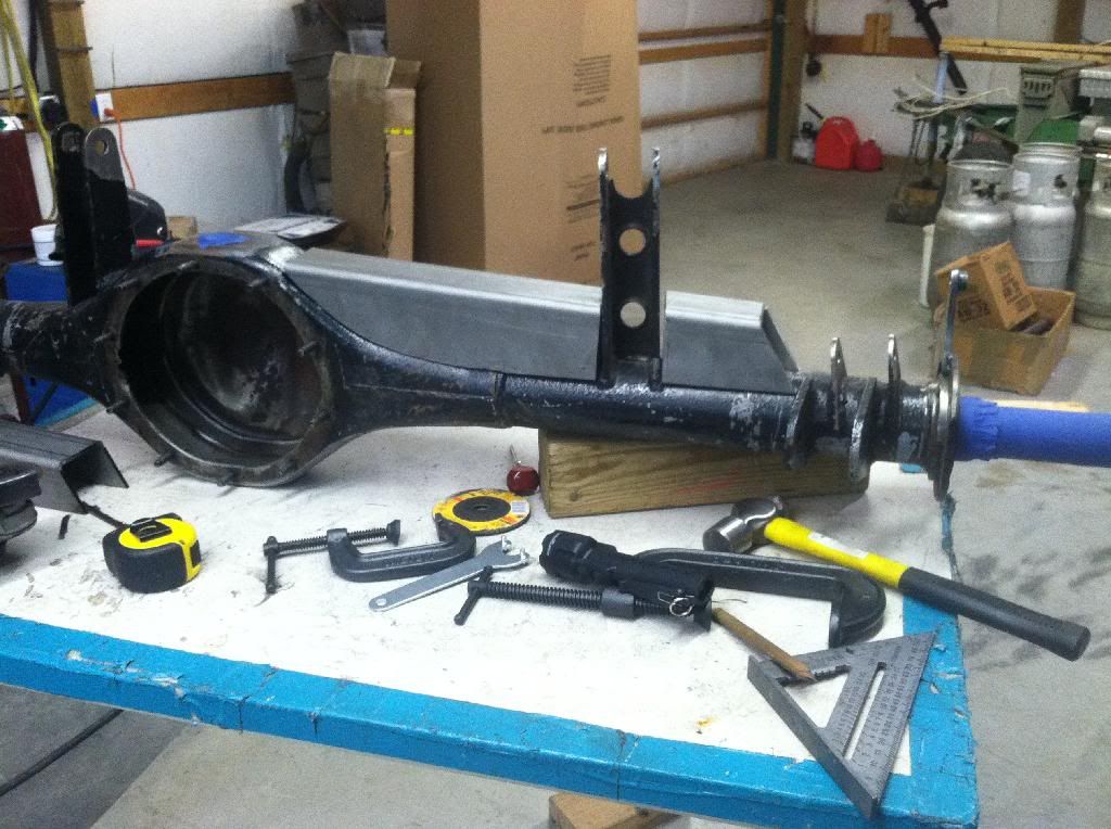

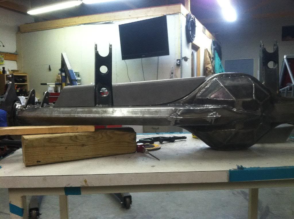

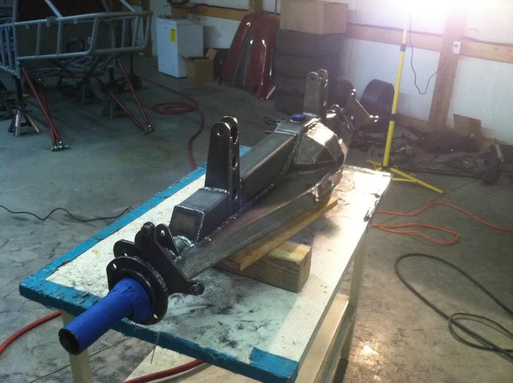

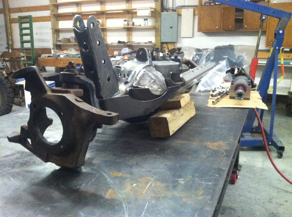

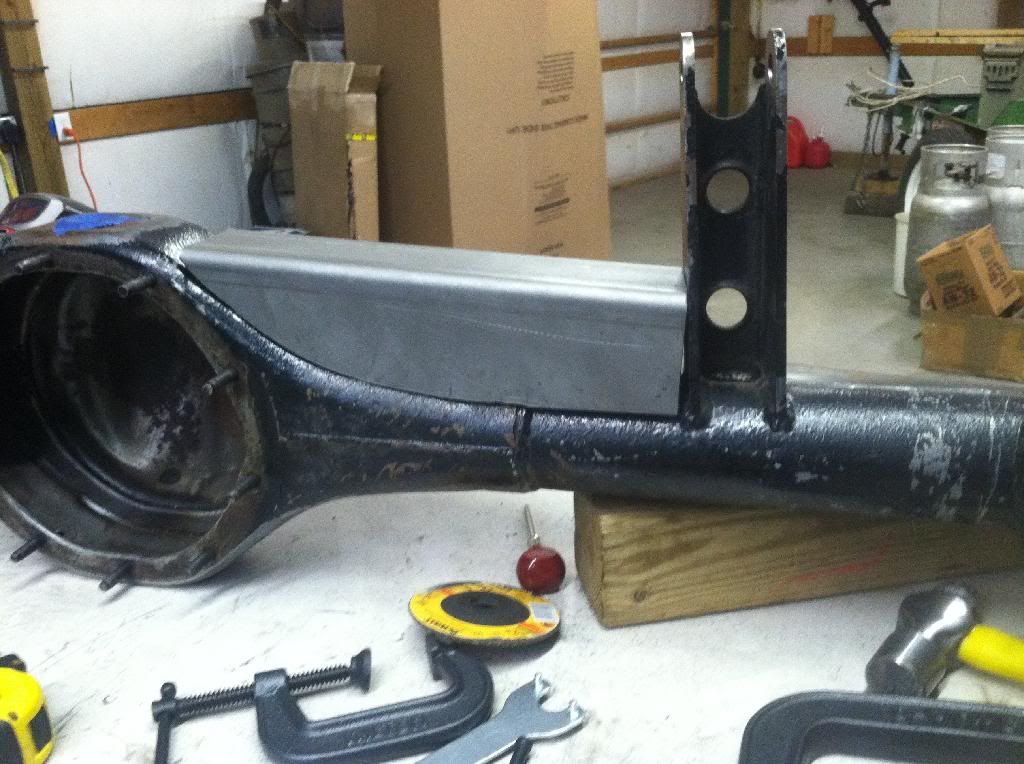

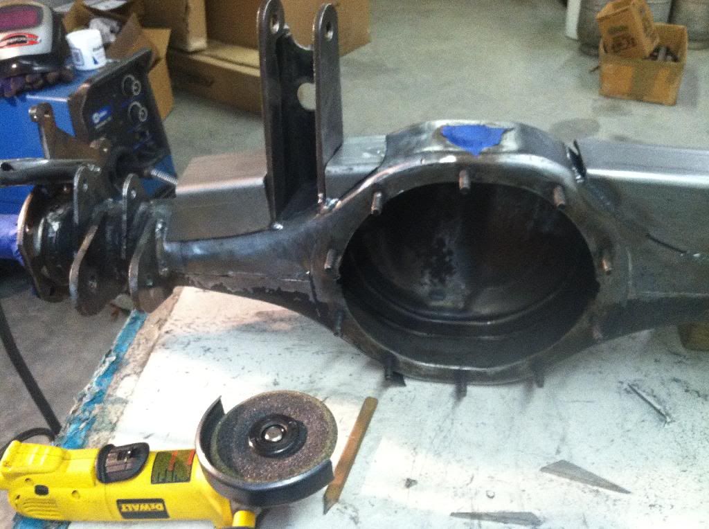

I also added an Artec backbone truss. It's made to go on a fabricated 9" housing, but I chopped it up and grafted it onto my housing. It's tacked on, just waiting on my new blue welder to show up before i burn it in.
I can't decide if I want to truss the top of the housing or not. What do you guys think?

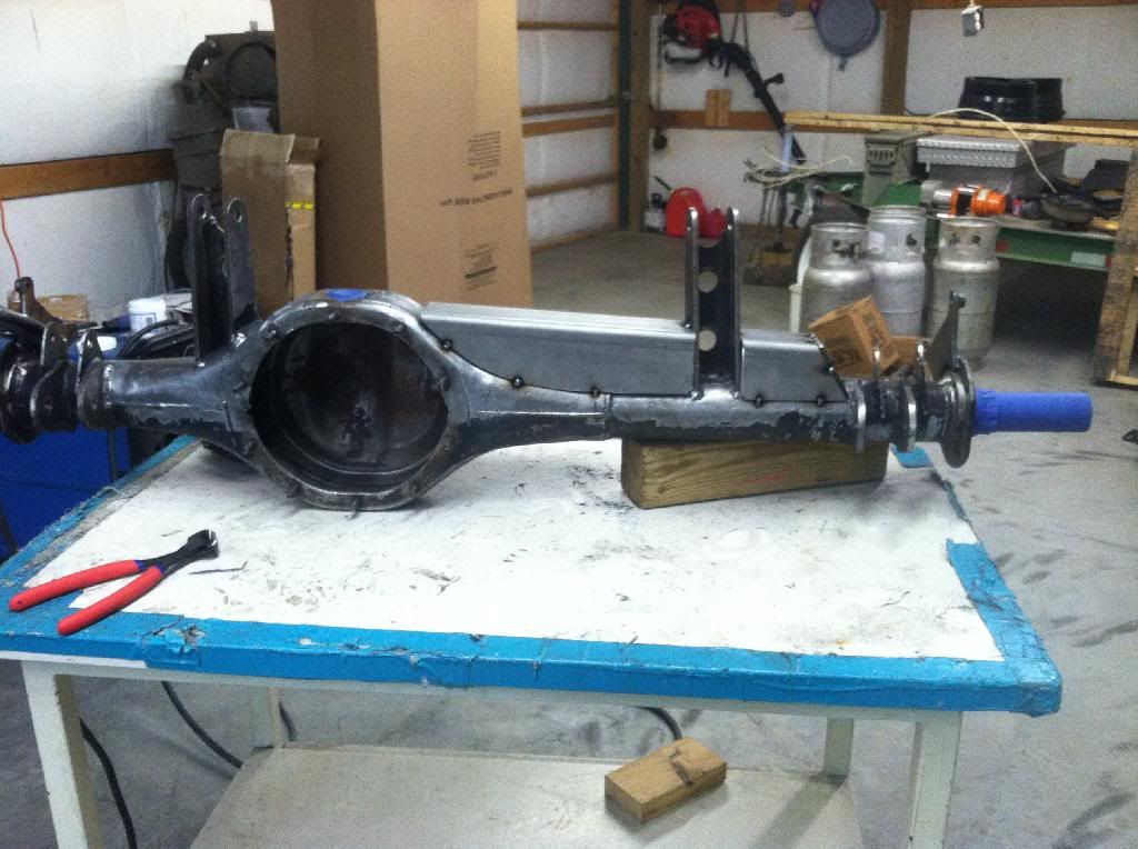

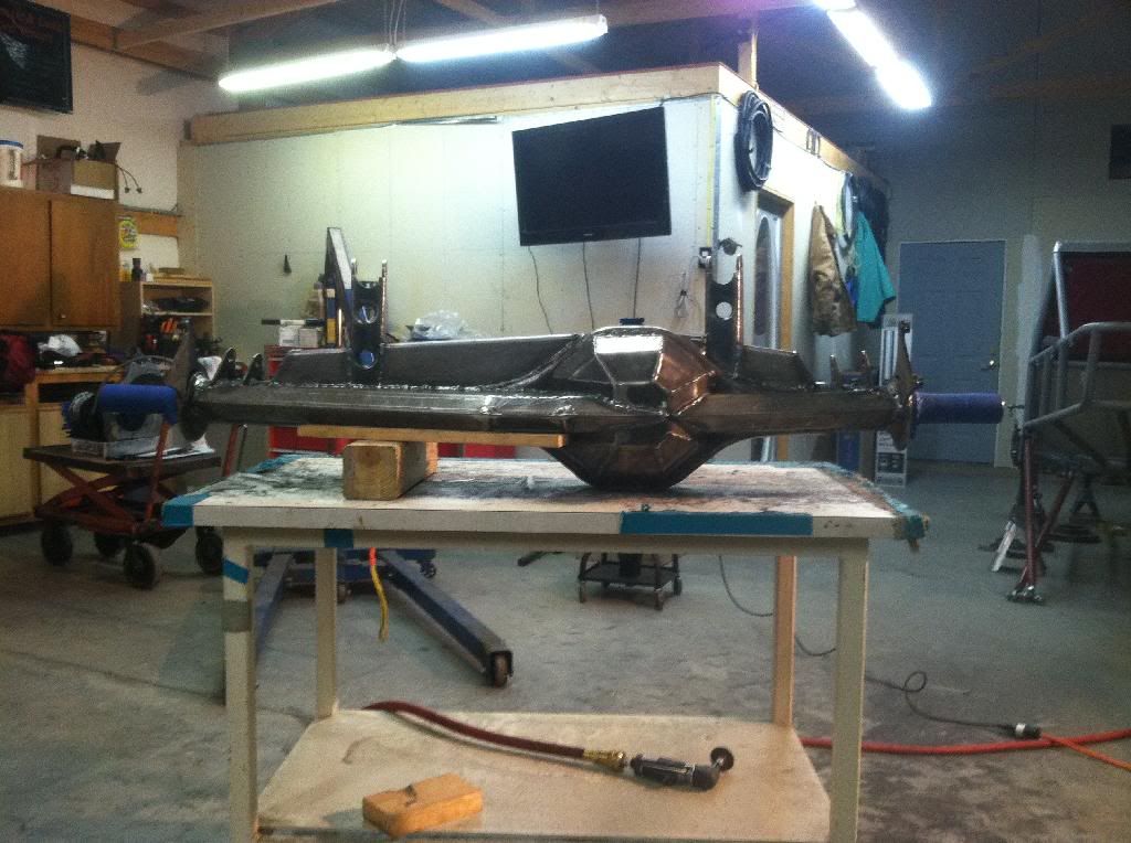

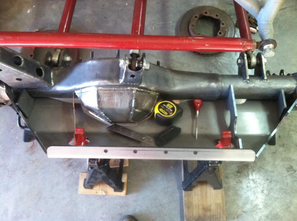

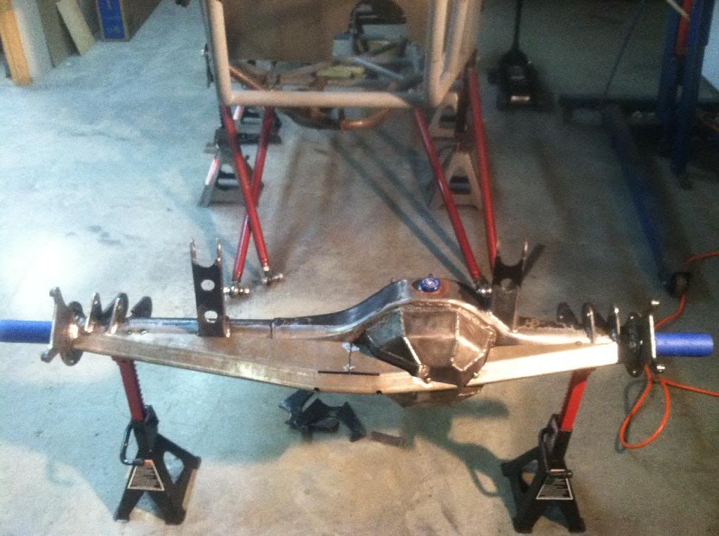

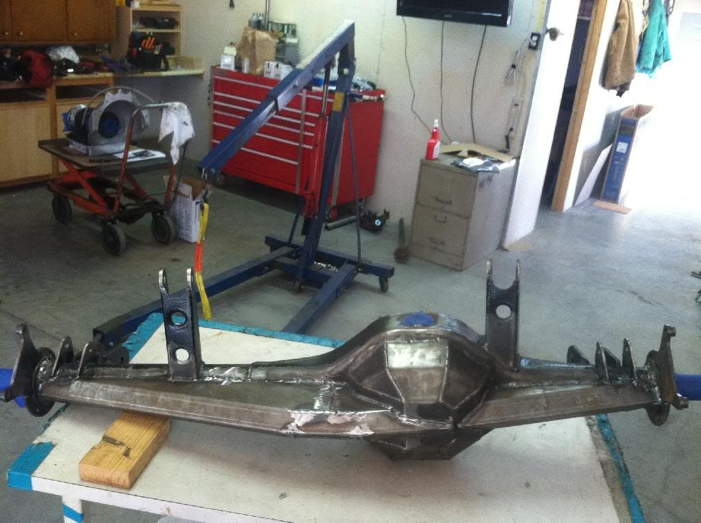

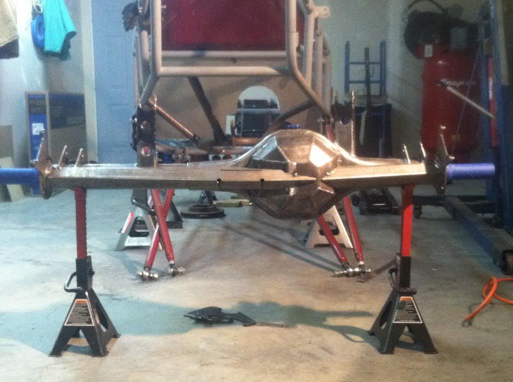

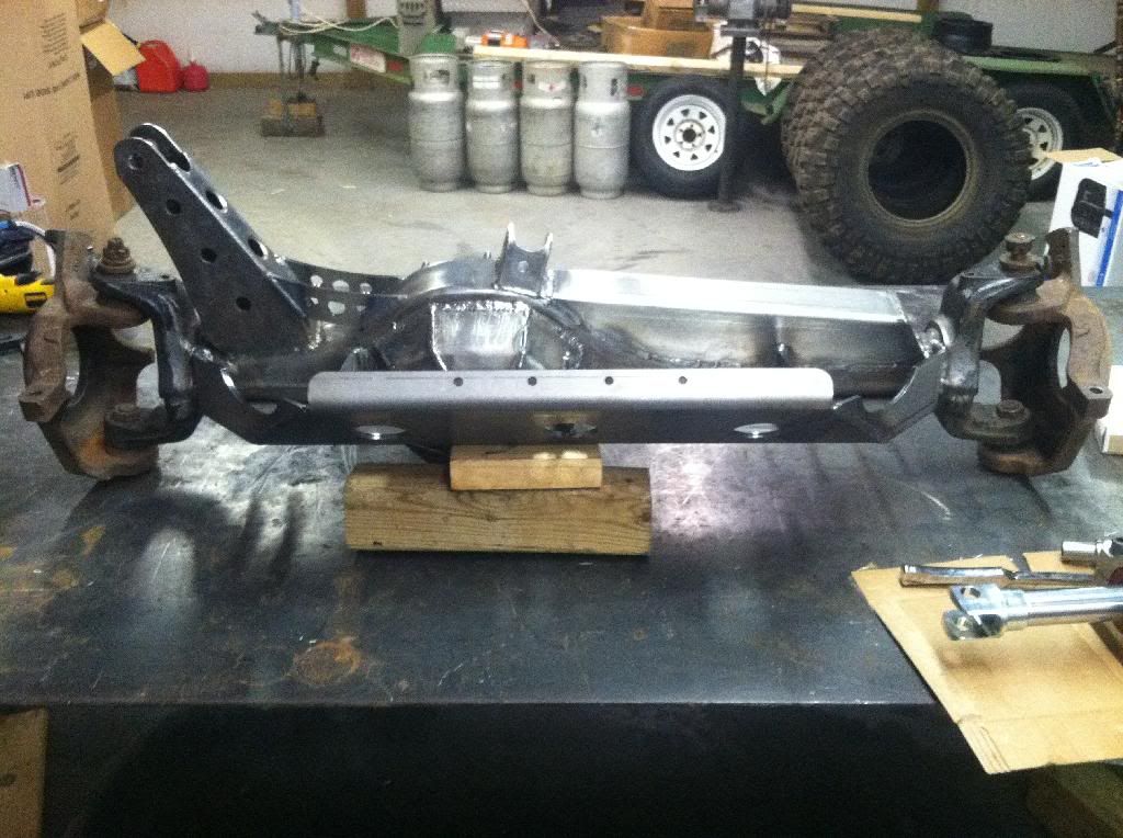

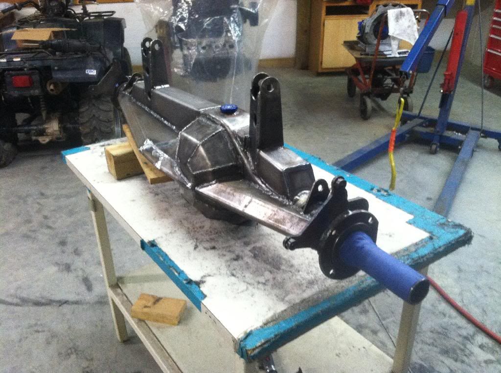

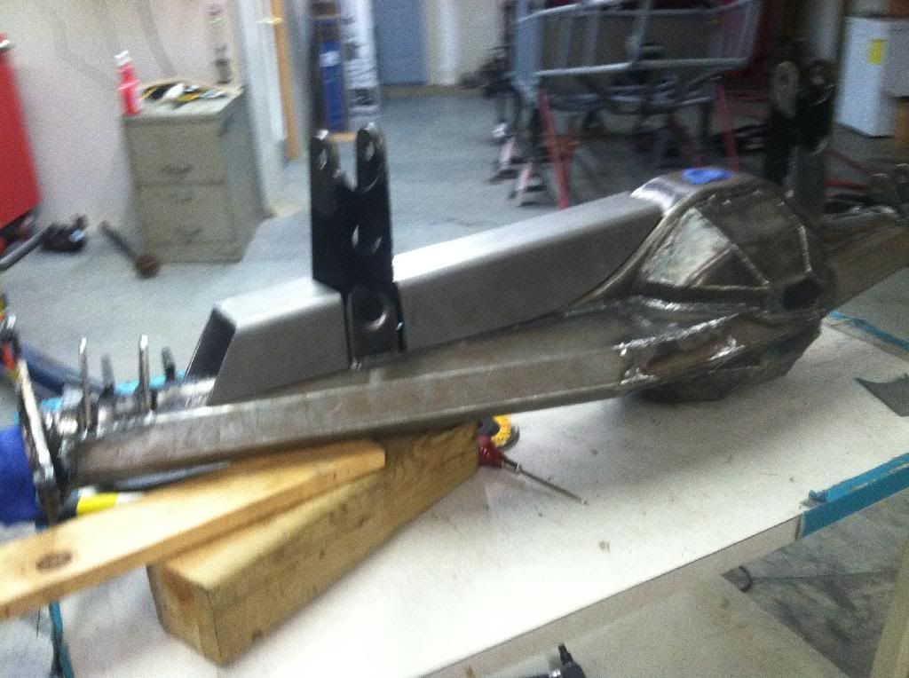

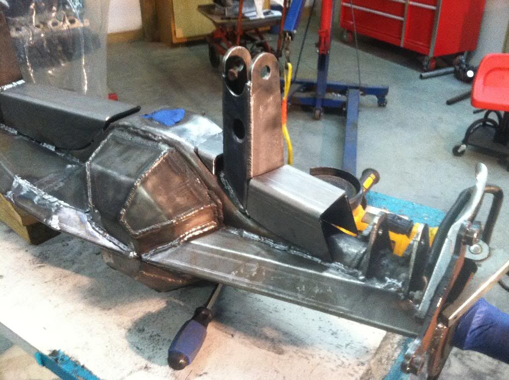

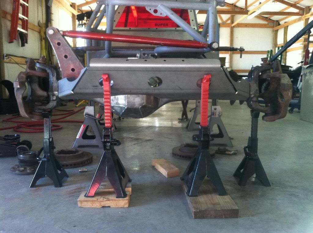

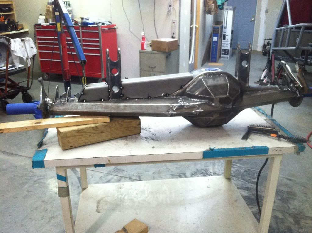

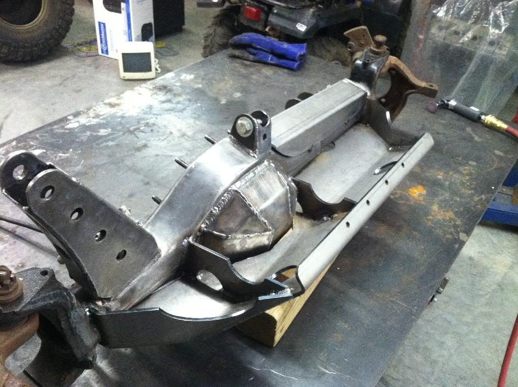

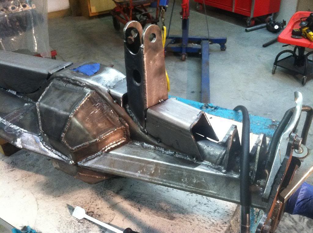

I've made a little progress the last couple days.

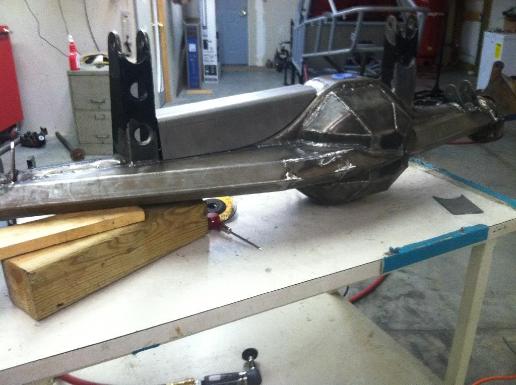

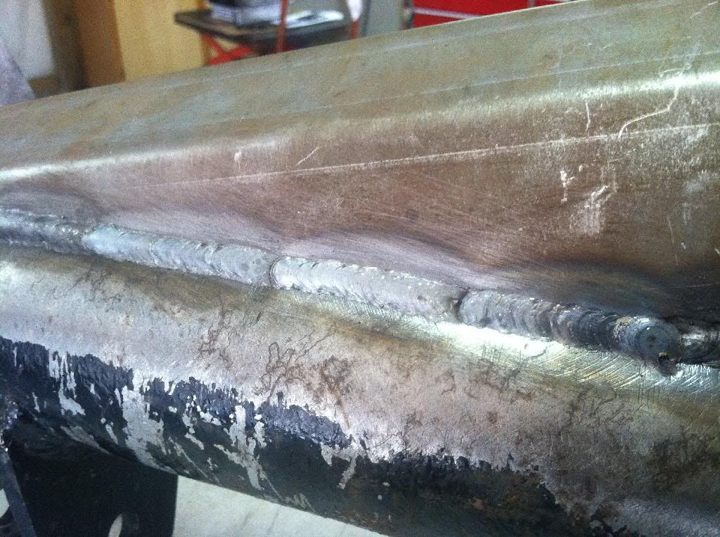

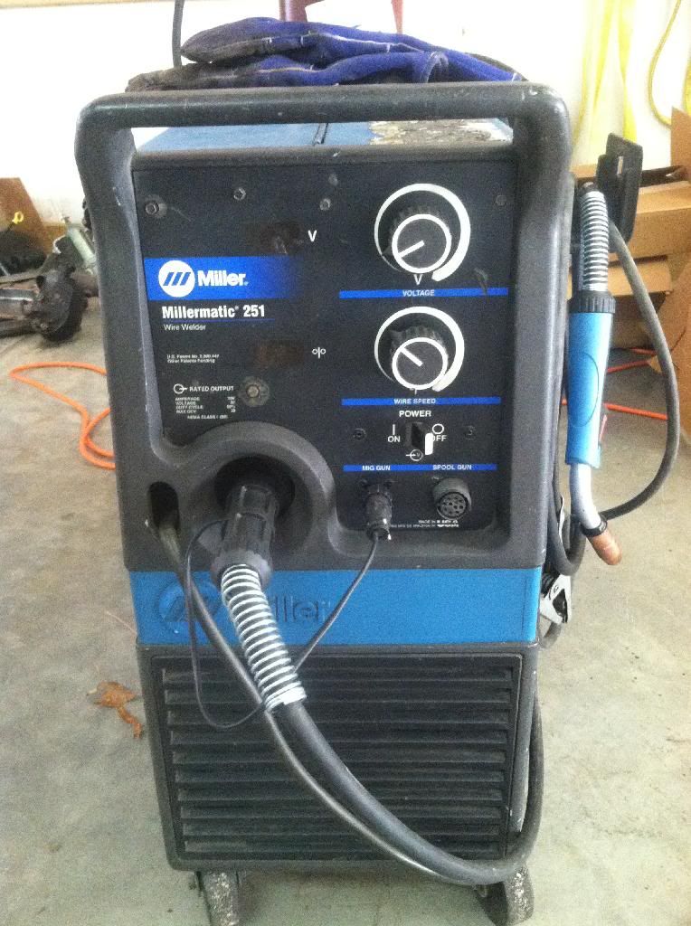

I picked up my new to me welder yesterday. It's way more welder than I'll ever need, but it's nice to finally use a real machine. The only problem is now I can't blame the machine for my horrible welds.
I immediately put it to work welding up the backbone truss on the rear axle. I spread the welding out over two days. I used the lowest settings possible and just made 1-2" welds in different areas, and let it cool. Hopefully I didn't warp the housing too bad. I guess we'll see.
This machine can even make a hack welder like me look halfway decent.

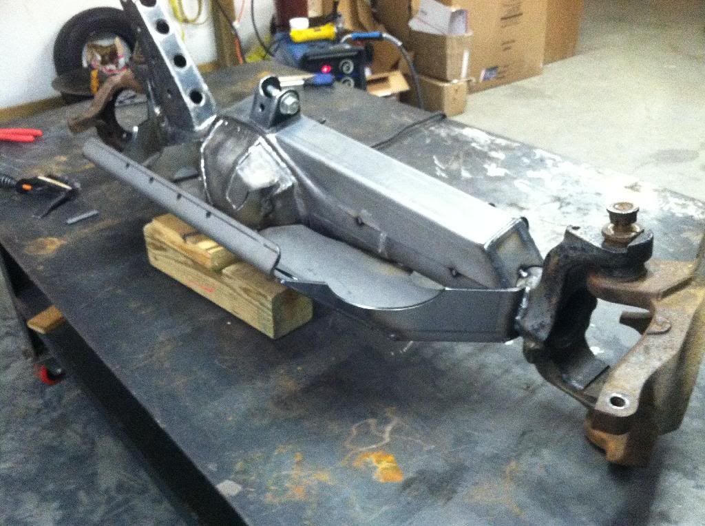

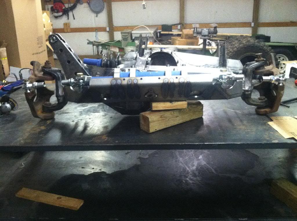

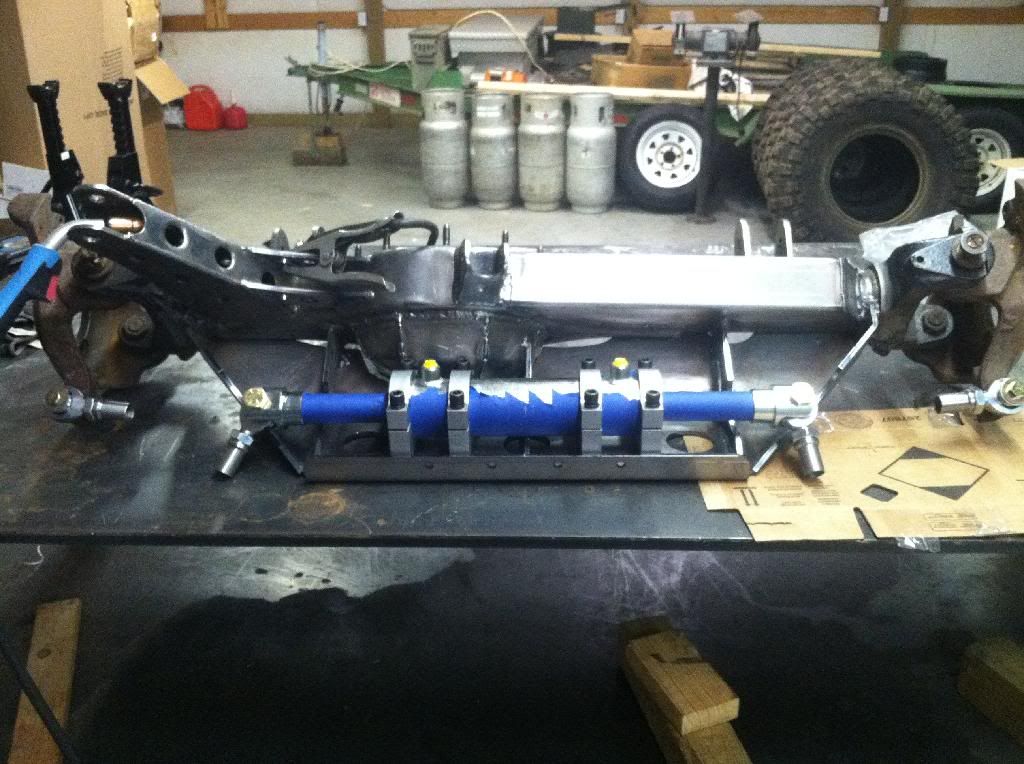

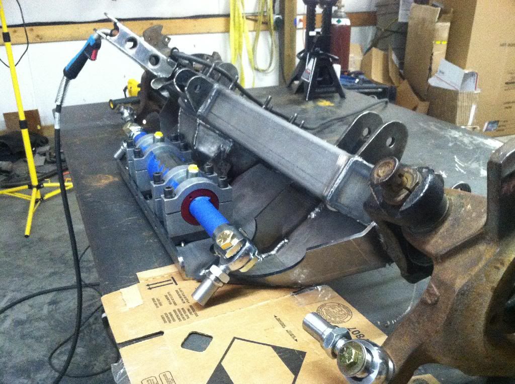

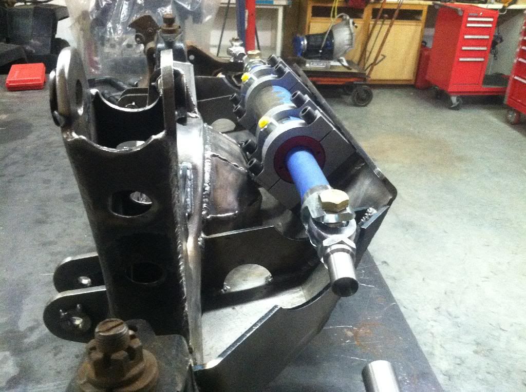

In between welding on the rear axle I started mocking up the Artec ram mount on the front axle.
Tomorrow I'll start trying to hack up the RuffStuff trusses for the top of both axles.

I worked some more today on the rear axle. I got the long side of the truss cut out and about half welded. Tomorrow I'll finish welding the long side and start mocking up the short side.

I finally finished the rear axle today. That was a lot of cutting, grinding and welding! I think I've blown a whole stick of DOM out of my nose the last 4 nights.
That's one RuffStuff Toyota truss hacked into 4 pieces. It's not fancy, but I think it'll get the job done.
I also added RuffStuff weld washers on all the link and shock tabs. I'm not posting pics of those though, the welds are UGLY. LOL
  • ai38.photobucket.com_albums_e102_boomboom33_Project_20Redneck_db7e5049825d59ff87bb010536e4f2e9.jpg

Lots of overtime and the cold weather have kept me out of the shop for a couple weeks, but I finally got a little more done this week. I got the truss and ram mount finished on the front axle. Not a lot of progress, but here's some pics.
I've got the knuckles off now and got the tie-rod hole drilled out for a 3/4" bolt. While they're off I'll mock up the Spidertrax brakes, and make my caliper bracket to bolt to the knuckles. I'm going to run Dynatrac Pro Steer balljoints. They're pricey, but hopefully they'll be worth it. I hope they'll hold up ok to the full hydro and 39s. I've got a set ordered and they should be here by the middle of next week.

I got a little time in the shop this afternoon. While I've got the knuckles off the front axle I figured I'd work on getting the Spidertrax brakes mocked up.
You can see I had to modify the knuckles just a little to make everything fit. The "wings" had to be cut off the knuckle because they interfered with the rotor, and I had to grind down around the original caliper bolt holes to clear the mounting ears on the Wilwood calipers. The original caliper bolts are a funky M11 thread that I couldn't find anywhere so I tapped them out to 7/16"-14.
ai38.photobucket.com_albums_e102_boomboom33_Project_20Redneck_d8a504ab8ec096643e73de4c143baf80.jpg
I just made a simple, ugly, but functional caliper bracket out of some 2"x.25" flat bar and some .5"x.6875" spacers. I drilled and tapped the spacers to 3/8"-24. The caliper bolts to the bracket from the front, and then the bracket bolts to the knuckle from the back.
ai38.photobucket.com_albums_e102_boomboom33_Project_20Redneck_afd70fe56b21accc296ffa51f4bd30a9.jpg
ai38.photobucket.com_albums_e102_boomboom33_Project_20Redneck_c35e43f4a1f2cf407388ec45fba0df13.jpg
ai38.photobucket.com_albums_e102_boomboom33_Project_20Redneck_ba5f7572de1eda2b0b30b7e04f3f5566.jpg
ai38.photobucket.com_albums_e102_boomboom33_Project_20Redneck_cb8d7eef5bc00ee227b42d6a90653d9a.jpg
ai38.photobucket.com_albums_e102_boomboom33_Project_20Redneck_bc7122e4172243b3caeb7c2d2c78579d.jpg
ai38.photobucket.com_albums_e102_boomboom33_Project_20Redneck_394b7123758bb2ad01600376dcc034ca.jpg
ai38.photobucket.com_albums_e102_boomboom33_Project_20Redneck_4c43bd05d55357d497fc323557041594.jpg
Like I said, they're ugly, but they'll work.

After that I put the GTO oil pan on the engine, and put on the fittings to adapt the steam ports to -4 AN. And I figured I'd stick the headers on for a test fit. They're OBX LS turbo headers. They're supposed to come up and froward, but it makes them too wide to fit the chassis. This way they're narrow enough, but it's gonna be tight with the steering pump. I've got the engine bracket kit from Wide Open Design that I think will move it up high enough, I just have to get a new water pump before I can put it on. I also put in new spark plugs, and Taylor Thundervolt plug wires with heat shield boots.
ai38.photobucket.com_albums_e102_boomboom33_Project_20Redneck_e9b300027fe4ad6b718c6e8d89ceedaf.jpg

Today I cut a couple of pieces of 1/4" plate and formed them to the bottom of both axle housings to act as a skid plate since the housings are just 1/8" thick. Definitely not fancy, but it will work.
ai38.photobucket.com_albums_e102_boomboom33_Project_20Redneck_787617664046f622103a9850722b88a5.jpg

It may not look like a lot, but by my standards I've gotten quite a bit done the last couple of days.
First off I installed the inner axle seals in both housings. I used the seals Trail-Gear sales for their 9" housings. Mine used the 2.75" I.D. seals. Even though the rear is FF I'm using seals on it too. The center section will have to be over filled for the flipped pinion and I didn't want to have the tubes full too. I didn't get any pics, but they were a pretty simple install.
Then I got the axles and ORI's hung.

Then I got the Dynatrac ball joints installed and the knuckles back on the axle. The unit bearings and brakes bolted up to check clearance. And mounted the ram and measured for my tie rods. I'll cut them tomorrow. I can't bolt the front wheels on yet because I'm a dummy that didn't order lug nuts when I ordered studs. They'll be here sometime this week though.

ai38.photobucket.com_albums_e102_boomboom33_Project_20Redneck_7f3d920c7ec726878f6c10d972e36e1e.jpg
ai38.photobucket.com_albums_e102_boomboom33_Project_20Redneck_067dd6fcfaa9bd7e64ae6a0c658bf527.jpg
ai38.photobucket.com_albums_e102_boomboom33_Project_20Redneck_c71b1e0afc54dcc7bef42573f27ec1bf.jpg
ai38.photobucket.com_albums_e102_boomboom33_Project_20Redneck_47246d85341cd09dc4b8d45e595204a7.jpg
ai38.photobucket.com_albums_e102_boomboom33_Project_20Redneck_3fdbf75bb1a4964096f6368243d8fe5f.jpg
I'll be working on it more this week. I may start tomorrow on putting the drivetrain together and getting it ready to set in the chassis. At least it's kinda starting to look like something now.
I got a little bit of time to work on it today. I got the Poweglide and Atlas mated together.
ai38.photobucket.com_albums_e102_boomboom33_Project_20Redneck_118098bcb43f7287766dbbfac5c480ab.jpg
ai38.photobucket.com_albums_e102_boomboom33_Project_20Redneck_8eed8bb61bd8b14ec1bd42ae7096033a.jpg
I also got the tie-rods cut and the inserts welded in. Each insert got two passes with the TIG and two plug welds with the MIG. Then I hooked the tie rods up and used an air hose to cycle the steering. I don't know yet if I can use the full 8" of stroke, or if I will have to limit it.
ai38.photobucket.com_albums_e102_boomboom33_Project_20Redneck_0a8ff7b65c76fa9f0ca195c6eb119286.jpg
ai38.photobucket.com_albums_e102_boomboom33_Project_20Redneck_88d87d74ed1f2905b98eb73889f895c6.jpg
ai38.photobucket.com_albums_e102_boomboom33_Project_20Redneck_17a29cfcc551591eea292b3e829e6292.jpg
ai38.photobucket.com_albums_e102_boomboom33_Project_20Redneck_5d91afdc2858fe98113b8069398bd324.jpg
ai38.photobucket.com_albums_e102_boomboom33_Project_20Redneck_18200ee2d498cd988f1f8a71ff67d1c2.jpg
I know the angle of the tie-rod at full lock is not ideal, but the ram is as close to the axle as I could get it.
I spent a few hours in the shop this afternoon. Not a lot of progress, but I got a few things done. I put the wheels and tires on the front and got it off the jack stands to get some better pictures.
ai38.photobucket.com_albums_e102_boomboom33_Project_20Redneck_3bf1fb3cadb1c72616416d2b66665758.jpg
ai38.photobucket.com_albums_e102_boomboom33_Project_20Redneck_88d5c7216285327a78795616194dfea5.jpg
ai38.photobucket.com_albums_e102_boomboom33_Project_20Redneck_3ef80cce8d24890729a548b9e6d4019b.jpg
ai38.photobucket.com_albums_e102_boomboom33_Project_20Redneck_254d014af41363b8320d9d894a3d09dd.jpg
ai38.photobucket.com_albums_e102_boomboom33_Project_20Redneck_7d8cfdc538a80367efab2f47f6d5f66c.jpg
Then I used the hoist to flex it out and see how everything looks. There's a couple of issues there, but I kinda expected them. The rear tires get into the shocks pretty good when it's flexed out. And the front passenger side shock hits the chassis just a little. The front will require re-doing a small section of tube, not a big deal really. I don't know whether to try to run bigger spacers on the rear to clear the shocks, or if I should just get new wheels.

I sat the drivetrain in today, it's a VERY tight fit. It's just sitting on blocks right now. I still have to do a lot of measuring and checking before I start mounting it, but it's a start.
One issue is the oil pan. I'm going to have to go back to an F-Body style pan. The GTO pan just isn't going to work. The the oil filter and part of the sump want to occupy the same space as the pinion yoke. I was hoping to get farther along today, but it was slow going and I didn't get as much time in the shop as I hoped to. I snapped a few pictures, but they don't show much really.
